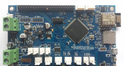

Details of the Duet WiFi have now been published at http://www.duet3d.com. Yes, it does have new stepper drivers supporting higher microstepping - up to 256x in fact. Enjoy!
[img]https://dl.dropboxusercontent.com/u/193 ... .27.56.jpg[/img]

According to your website, the new Duet uses an Atmel SAM4E8E.
The SAM4E8E is only available in a 144 Pin package (LFBGA or LQFP)
The image you posted of the new Duet confirms that you are using the SAM4E8E. I can read the part number and the pin count is 144 on your board.
SAM4E8E LQFP144 on Board
I find it odd that you would say an 84 pin CPU is "way overkill", while using a 144 pin CPU on your board.
I also find it a bit unnerving that you suggest that it was necessary to omit wired Ethernet because it would have forced you to pick an Ethernet Enabled MCU that you imply would negatively impact the cost or size of the board, but you fail to mention that the CPU that you are currently using on your boards IS already Ethernet Enabled.
That's right. The ATSAM4E8E on the Duet indeed has an Ethernet MAC built in.
All you need to add Wired Ethernet to the current board is a PHY (about $1.00) a crystal or oscillator ($0.50), an RJ45 with integrated magnetics ($1.50), and a handful of discrete resistors/capacitors totaling no more than $0.05 in cost.
I don't know what you're paying for those ESP8266 WiFi modules, but you show one with FCC certs in the image (I assume that you're not going to ship product with the certified modules, since you show it) and those cost about $5.00 each.
In conclusion, there is no price or hardware advantage to making a WiFi version over a Wired Ethernet version, as you insist in your post. Most everything you mention against Wired Ethernet is just plain factually incorrect. That does not give me warm fuzzies about the product in general.

U.S. Water Rockets wrote:I find it odd that you would say an 84 pin CPU is "way overkill", while using a 144 pin CPU on your board.
That CPU is static, it has to be there its what is running the show. An extra 84 pin CPU for one extra function is way overkill because thats a lot of extra board space.
Also it seems you missed this:
dc42 wrote:To replicate what the ESP8266 gives us (i.e. web server running on a separate processor), we'd also need an Ethernet-capable processor,
The web server is on a separate processor in a package smaller than what is available for ethernet. The 84 pin CPU (what they found from Atmel) would be necessary to emulate the functionality they are getting from the wifi module, in addition to the current CPU on board. A lot of extra board space it seems.
From my point of view, they haven't lied about anything. They aren't using that interface because they don't want to tax the CPU with the web server load too.
