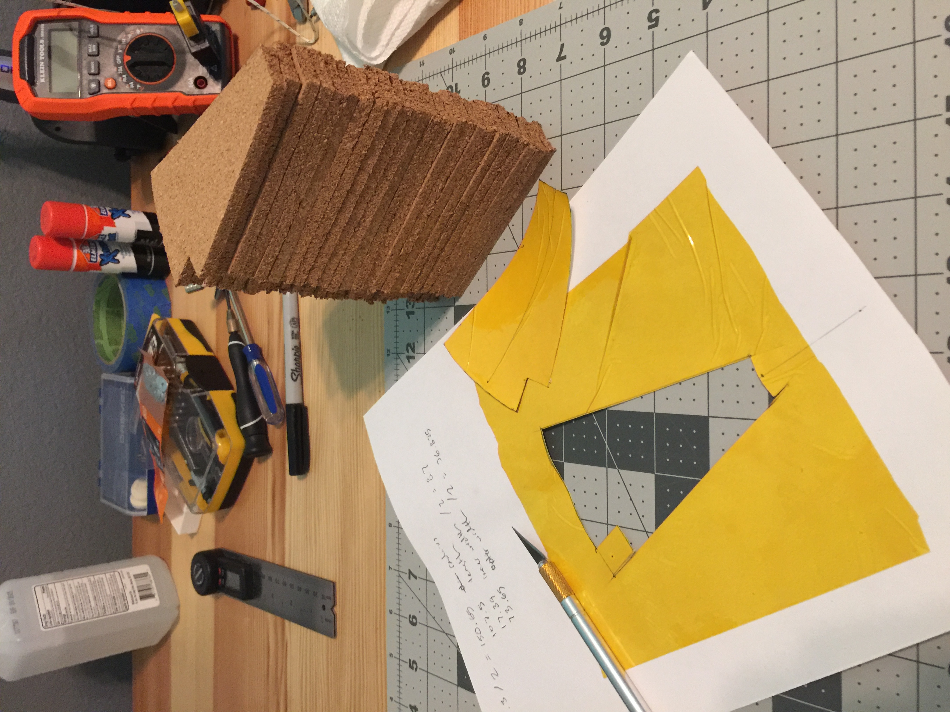

For a few bucks and several hours of work I added a cork insulation under my bed. I can get the bed to 110c in 30 minutes, all firmware settings and PSU are stock. Still takes time to heat up, but it gets there.

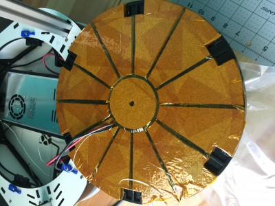

I've seen a few other threads showing their insulation, seems to be the non-standard standard practice for setting these up, I will probably add in some forum links to the build manual for people building theirs since it's definitely a lot easier to insulate the bed before running wires.
As for my v3 I only get 2-3 times a week to mess with it so I'm planning on taking pics and showing results after I insulate mine, hopefully by Friday.

So, insulated the bed. It's warming up slightly faster. Like 5 minutes faster to get to 60-70 instead, but still 25-30 mins.
Ambient temp in our machine shop is around 25-30 C.
The new issue I'm having is that on certain prints, once the hot end fans kick on they cool the bed down by a good 20-30 degrees and the system errors out and the heater decouples.
I am printing with PLA, so the fans are fairly necessary.
For sake of ruling things out, when I set the bed temp to zero and use my FabLam plate my prints come out just fine. So it's definitely something in the bed temp affecting things, and no, I can't just keep my heated bed turned off, I will need to use it later.
Any new ideas? I'm still trying to learn the Kisslicer/Octoprint combo which I've read might help, but I might do some more digging and then make a new thread if I don't find anything...
