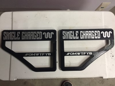

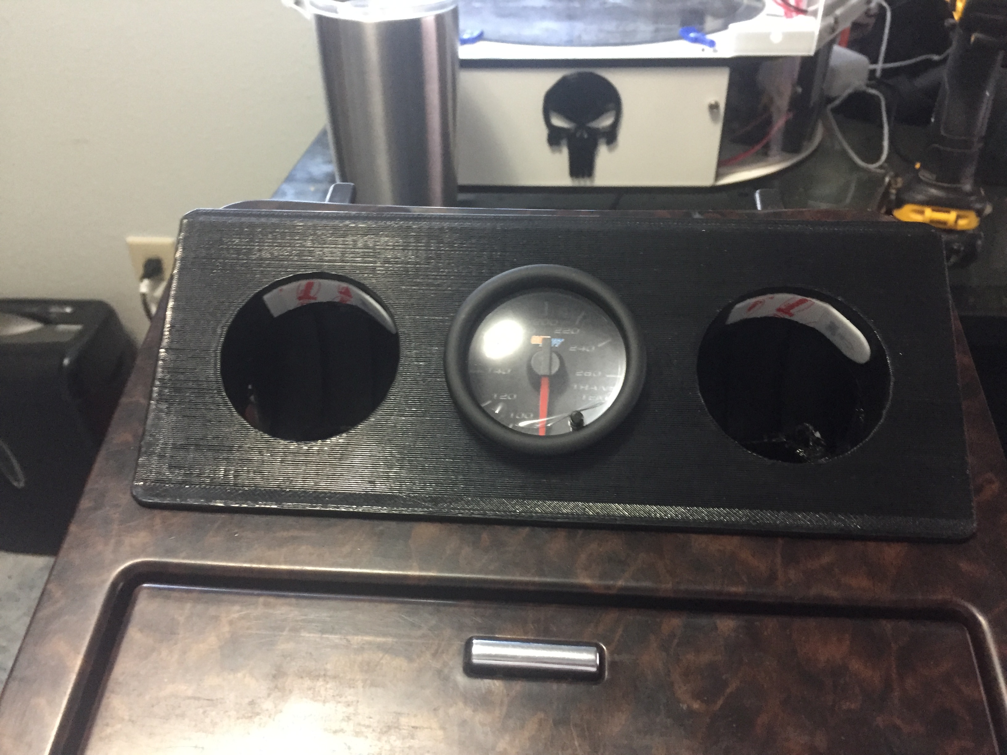

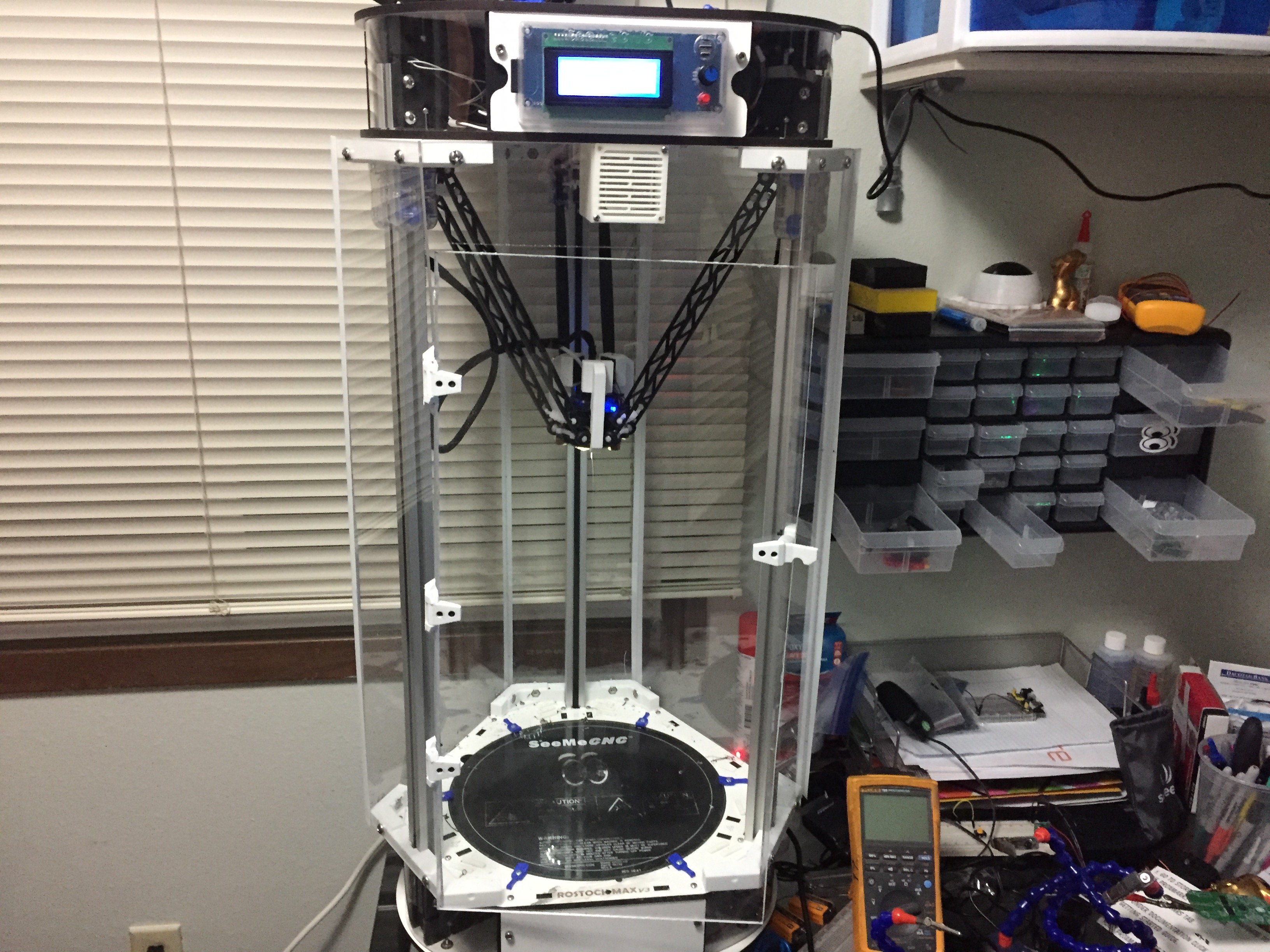

I am a complete noob since December but I learn fast. The V3 is my first real 3d Printer (last year I bought a Micro3D and it's been collecting dust)
Print quality wise I think it looks great but compared to some of the vets here it can be MUCH better. For about a month I have been a bit back and forth with MatterControl and prints were a bit hit or miss, but I recently got the hang of it and loving the fun of printing.

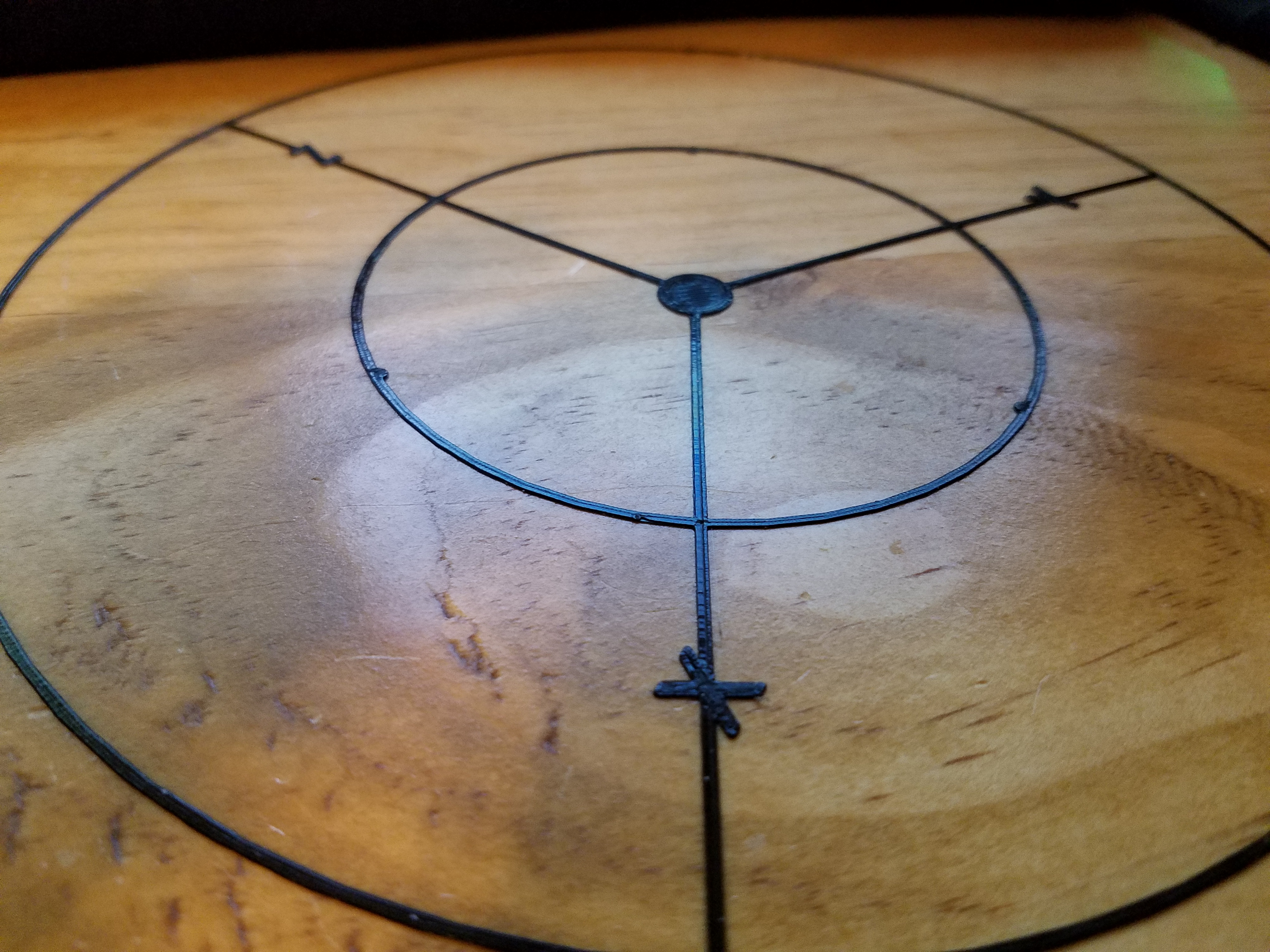

- Autoleveling is fairly easy and straightforward. Use 3 clamps instead of 6 and then send G29 command. I can get good results with stock setup, but better to upgrade to FSR though which I am doing soon. With proper mounts, it's been reported easier to swap to multiple surfaces without having to fine tune everything, it is much more reliable and very consistent.
- I am okay with the stock hotend, it gets the job done with .5 mm nozzle and average print speed of 60mm/s (it can reach up to 120mm/s) . I am upgrading to E3D V6 soon because I like the silicone boot to keep things clean and multiple options.
- I think x y build area is great, it still offers one of the biggest build volumes on the market for $1k.
- I tried printing TPU but it didn't come out great (possibly from inexperience as well) but I plan to get a BondTech QR soon.
- I have the PEI sheet and they sell both the circle sheet and adhesive on amazon. Worth every penny and easily the best addon as I struggled to get some prints off. I sanded the surface with 800 grit and bevel sharpened the spatula (thanks mhackney for the tip) and makes tough parts come off clean and has great outer matte look. Plus it can be repaired with cyanocrylic glue or whatnot.
- I haven't had anything break or fail since owning it. Be aware that the hotend connector can come loose (there is a clip you can print, just look up whip clip for he280), make sure belts are tight and polarity on all connections are correct. Other than that, I didn't have much issue with anything hardware wise. Software is a different story, just depends on your experience. I never used Python, Arduino/Repetier, MatterControl, Octoprint, Cura, so tweaking print settings can be a daunting task but stick with it and it'll come to you.
- V3 forum may seem inactive because I think most everyone has V1/V2 and just upgraded to V3 with their upgrade kit, or have different mods. But these forums are VERY helpful and polite.
A lot of my ranting seems to be geared towards upgrades but as a stock printer it can definitely get the job done with great results. The kit took me 14 hours and instructions were very detailed with pics and drawings. They also sell the preassembled version on their website. You can also opt for the Raspberry Pi so you can print over Wifi to eliminate USB stutter issues and have remote print. This also let's you use Octoprint and have time-lapsed recordings. You can use MatterControl for slicing, or others like Cura/Kisslicer/Rhino and upload into MC.

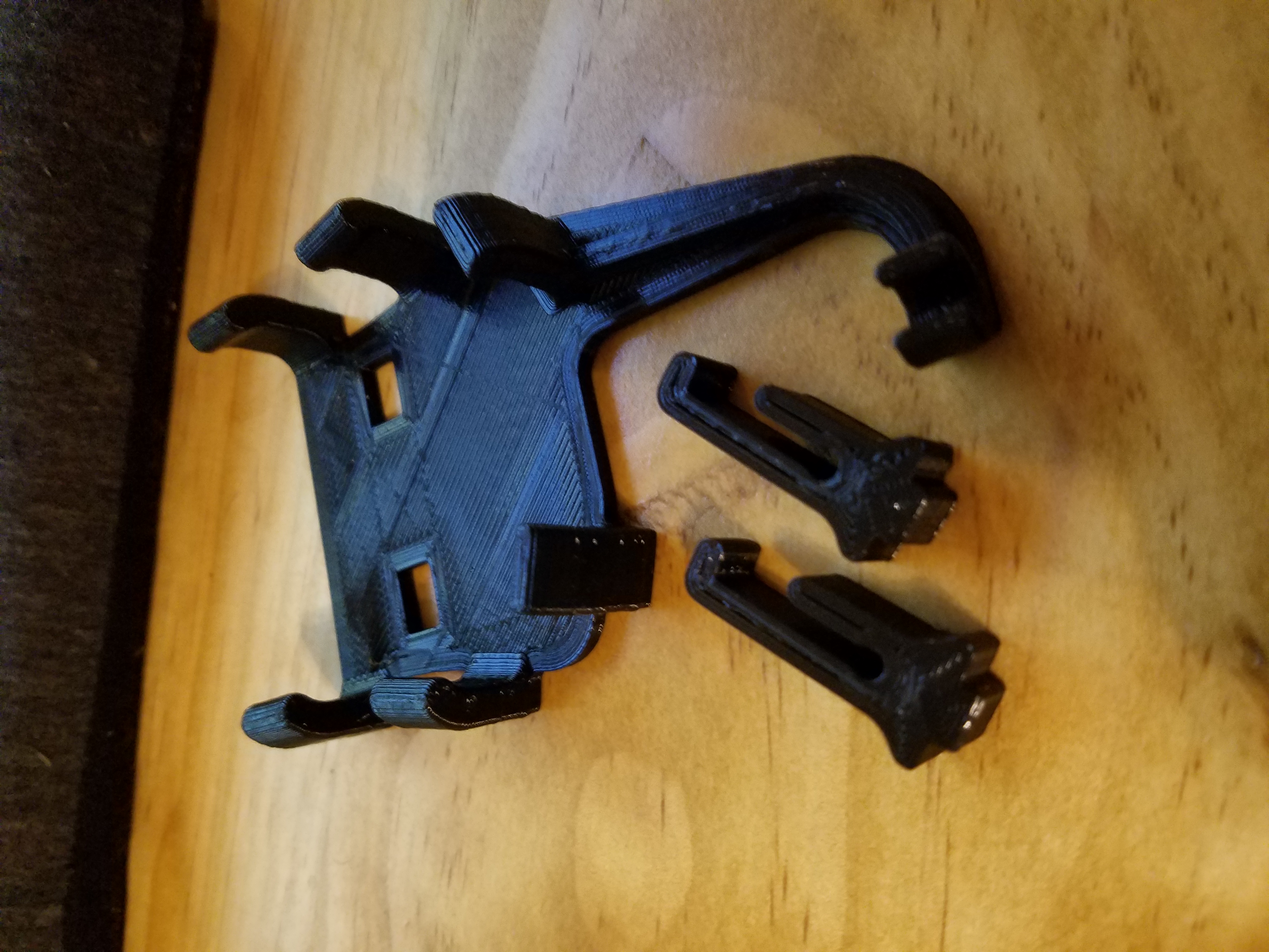

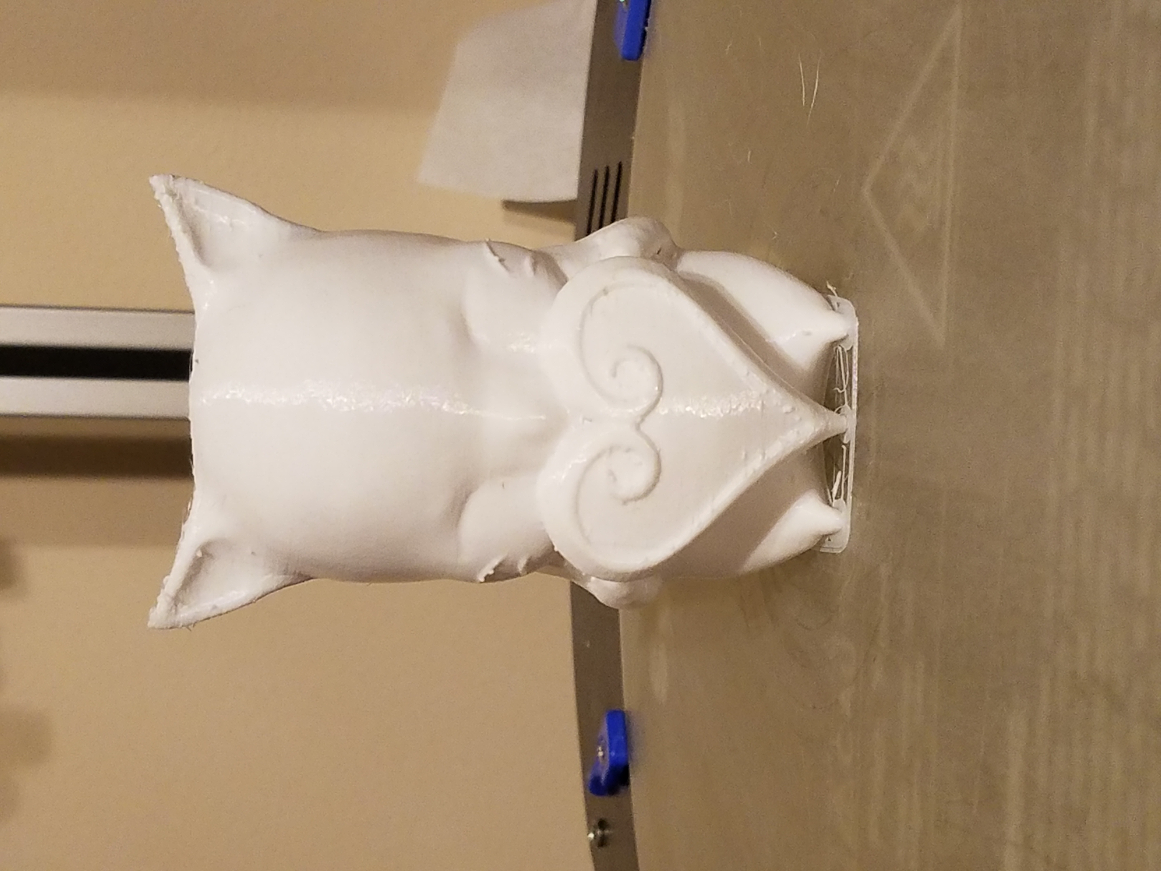

I bought the diy kit 6 months ago and had a blast building it! Took me 36 hours. I have had many small problems but all due to inexperience. It has been very fun learning how to fine tune and upgrade the machine! I have a total of 18 days of print time on it now, and have been able to produce some cool print and some very usefull prints. I have had fails and many of them but this is not a makerbot, it needs tlc and patience. For 1000.00 it is by far my best payback in entertainment and quality
