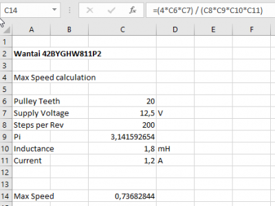

I checked the formula above but I get some nonsense value out of it (or I just don't understand it
What I do understand is that I am running my steppers way to low, is that correct?

Out of curiosity I checked my steppers: Wantai 42BYGHW811P2
I googled for specs: http://www.phidgets.com/documentation/P ... asheet.pdf
Here it shows that they are rated for 2.5 Amps, which looks to be much higher then most others?
I recently had some problems with missing steps on the extruder motor which I solved to up the current a bit. The motors do not get hot at all. My current current settings:

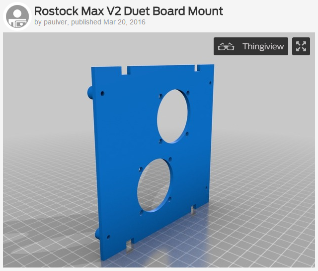

Higher current will reduce the likelihood of missed steps. However, if you increase the current much above the 1.2A that you are already using, then you will need to use a fan to cool your Duet 0.6 board. The best arrangement is a fan that blows cool air along the line of drivers on both sides of the board.

Funny of you to mention this... When I first build in the Duet board, I used a self printed backplate with room for two 40mm fans.dc42 wrote:Higher current will reduce the likelihood of missed steps. However, if you increase the current much above the 1.2A that you are already using, then you will need to use a fan to cool your Duet 0.6 board. The best arrangement is a fan that blows cool air along the line of drivers on both sides of the board.
https://www.thingiverse.com/thing:1429433
I mounted the fans with the air direction pointing away from the board (which is a mistake). I saw the board temp during print pretty steady at about 40 to 42 degrees. Last week I made some upgrades on my machine, and also took out the board to turn over the fans. But I see no change in board temp while printing at all. What strikes me is that the webgui already says 40 degrees right after power up. So maybe that temp is not very accurate. What temp can the board endure without any problems?

The uncalibrated MCU temperature on the Duet WiFi and Duet Ethernet should be within 13C of the true temperature. For the Duet 06 and 085, it could be up to 45C off.

My Duet 0.6 was off about 15 degrees C. Thanks for the tip!
