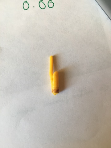

I've been having the strangest behavior with one of my HE280s recently. No matter what I do, it seems to clog repeatedly, lasting scarcely a print before failing. At temperature, the filament goes through smoothly at first, but clogs quickly and becomes hard to bush through. After a cold pull, the filament is really hard to push through once clear of the extruser, and seems to be wider in diameter as if it had expanded to fill the bowden tube well above the heater block.
Things I have tried:
-Checked for pucks: Haven't seen any since using the PTC tool method.
-Cleaning out nozzle with guitar string: Seems to help get one or two prints out of it before it clogs again.
-Replacing nozzle
-Full Extruder rebuild (cleaned out heat break, new nozzle, flipped heat sink): Did this after I blew a thermal fuse trying to get the filament to flow nicer
-The procedure outlined HEREwith the PTC tool
-Printing at hotter temperatures: Doesnt seem to affect the issue.
-Verified temperatures with thermocouple
-Sliced at 0.4mm, helped a little, but not enough to matter.
-Swapping Extruders: Using another HE280 that belongs to another printer, and printing using the same filament, with the same gCode, the same bowden tube, and the same setup seems to solve the issue, but that extruder is needed elsewhere.
-Retracting at 35 mm/s for 1.8 mm.
Result of Cold Pull (Strongly suspect that the wider diameter shift may be the actual cause of the "clog"):
[img]http://i.imgur.com/eFUsyvo.jpg[/img]
Slicing at 0.5mm
[img]http://i.imgur.com/l9RFwBj.jpg[/img]
Slicing at 0.4mm
[img]http://i.imgur.com/Uum15YV.jpg[/img]
Only "Successful Print". Snapped due to underextrusion.
[img]http://i.imgur.com/Y8Eyksg.jpg[/img]
Things I suspect:
-My PTC retainer may be damaged. It seems to hold the bowden tube in place pretty snugly, and the mark on the tube doesnt seem to move too much when printing.
-I have yet to retrofit to the EZR Extruder, but since a different HE280 worked, I dont think this is the problem.
-I strongly suspect that the barrel fan may be bad. This would be supported by the accumulation of thicker filament above the heater block, and would also explain why the thermal fuse blew despite only being told to heat the printer to 240C. Upon removal and testing, it seems to be vibrating badly.
Thoughts? Any insight anyone can provide would be much appreciated! :D

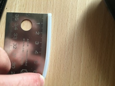

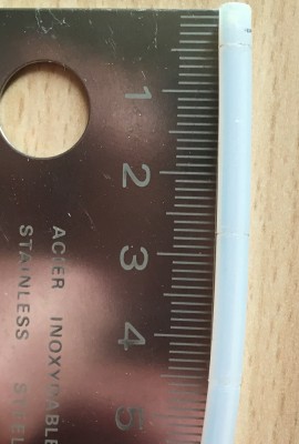

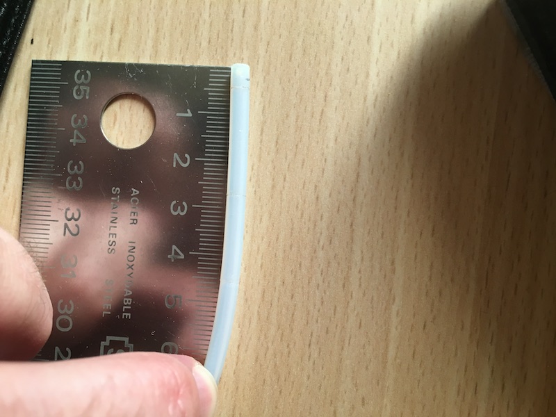

Installing the HE280 brought a lot of hassles and clogging I had never experienced before. In the picture you can see my last piece of art. Just last week. Anytime I touch the bowed tube (lately was for the dual kit installation) I experience clogging.
Solution for me was 100% Bowden tube seating.
It must go in 4,6cm from fully seated to the top of the PTC adapter and retainer. Attached picture is not perfect but you can clearly set the notch at 4,6 cm. Sometimes you just can't push it further, chamfer it then, little bit, and it go down much better. This is not stressed enough in upgrade instructions and was even absent from first release.
Anything less that that will result in clogging, straight away.

Well, It was the barrel fan after all. Upon receiving the new fan, it had a lot less slop and was a lot quieter than the original fan. Once I installed it, it extruded fine (Although I'm still tracking down retraction issues). It was also bought to my attention that the installed fan had had a previous life on a V2 Hotend, so maybe it was just old. Anyway, another thing to keep track of, although much less frequent than pucking or nozzle clogs.
Thanks for the help, learned a lot here!!
EDIT: For the record, this whole thing started when I tried refining retraction parameters in the past. I have a feeling that I may have started the clogging by having my retraction waaay too high, but it seems like I just picked a bad time, namely the time in which the barrel fan was in its death throes. Well, lesson learned. ¯\_(ツ)_/¯
