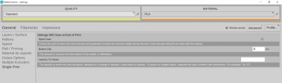

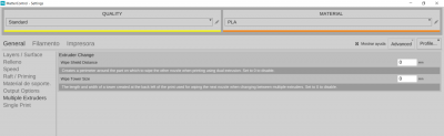

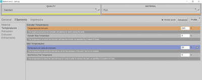

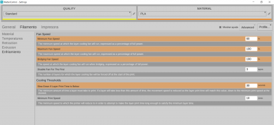

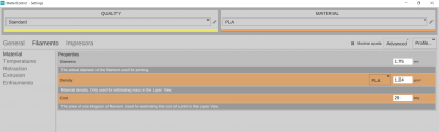

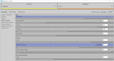

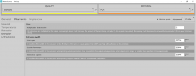

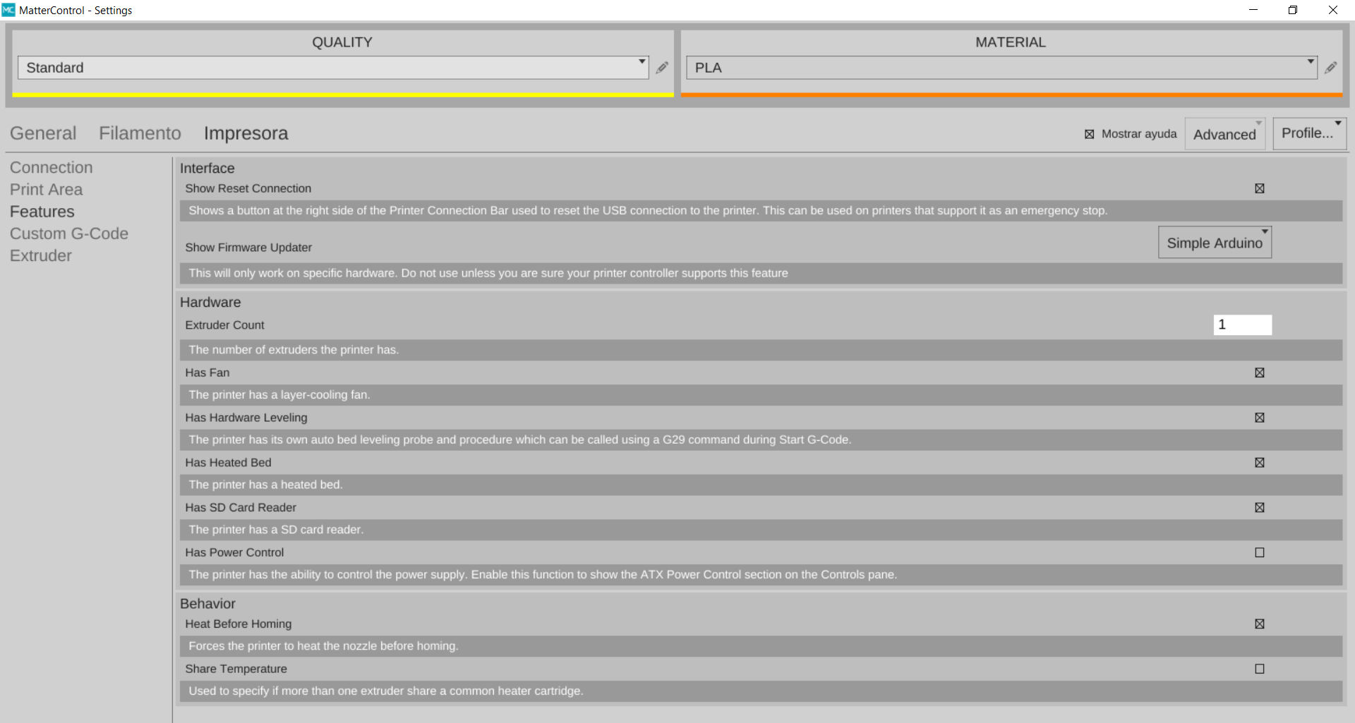

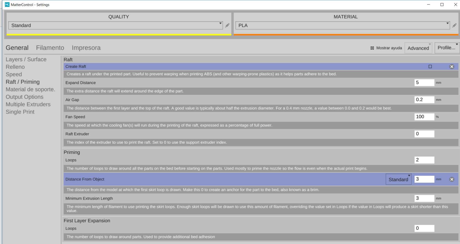

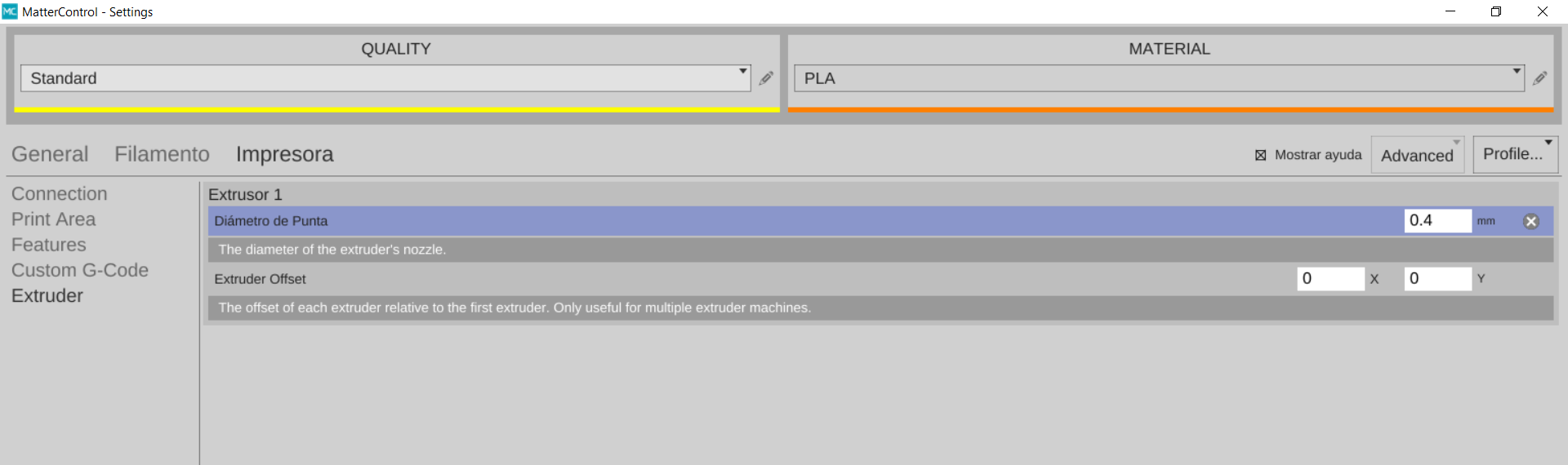

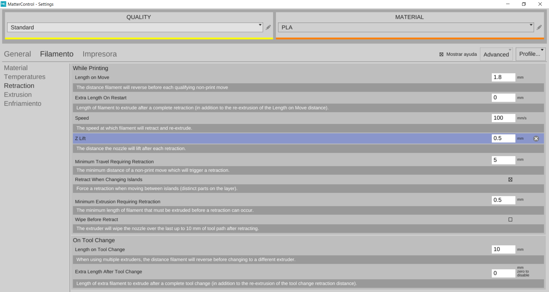

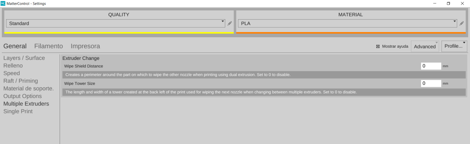

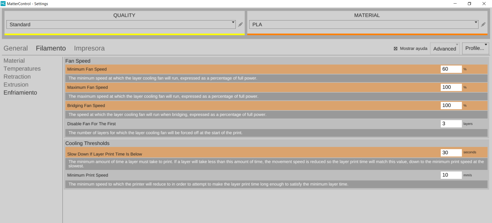

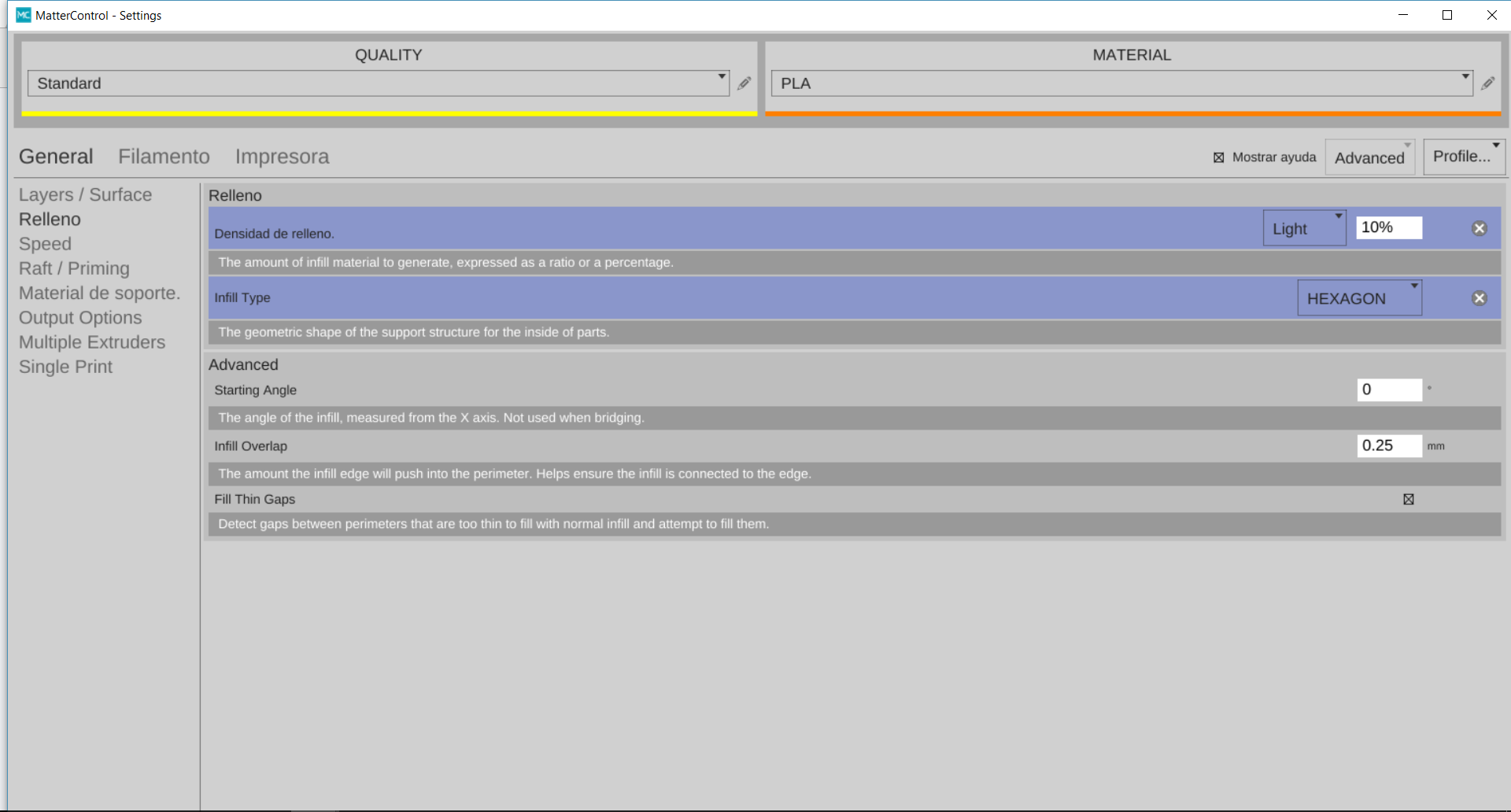

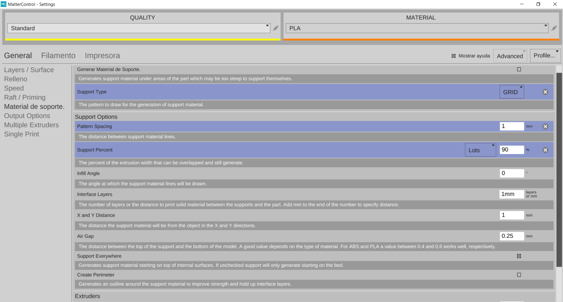

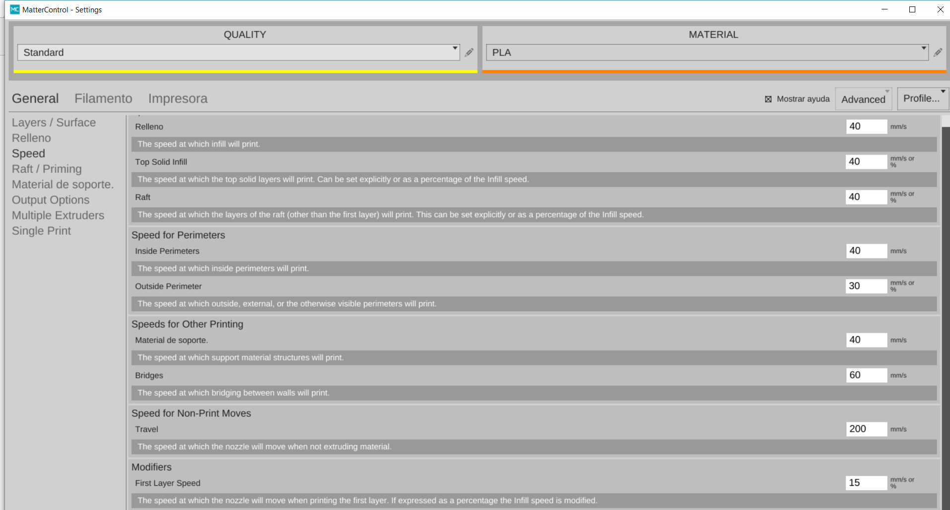

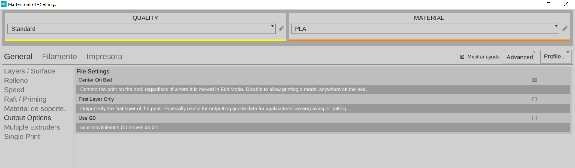

Please ask me to help me my printer has defects when printing, as it generates a few small balls at the time of printing and the quality is not good, I am using a 0.4 mm steel extruder because I want to print in another class of materials but if in Pla does not work well for me, thank you very much, I hope your help is attached to the screen of all the parameters that are set
