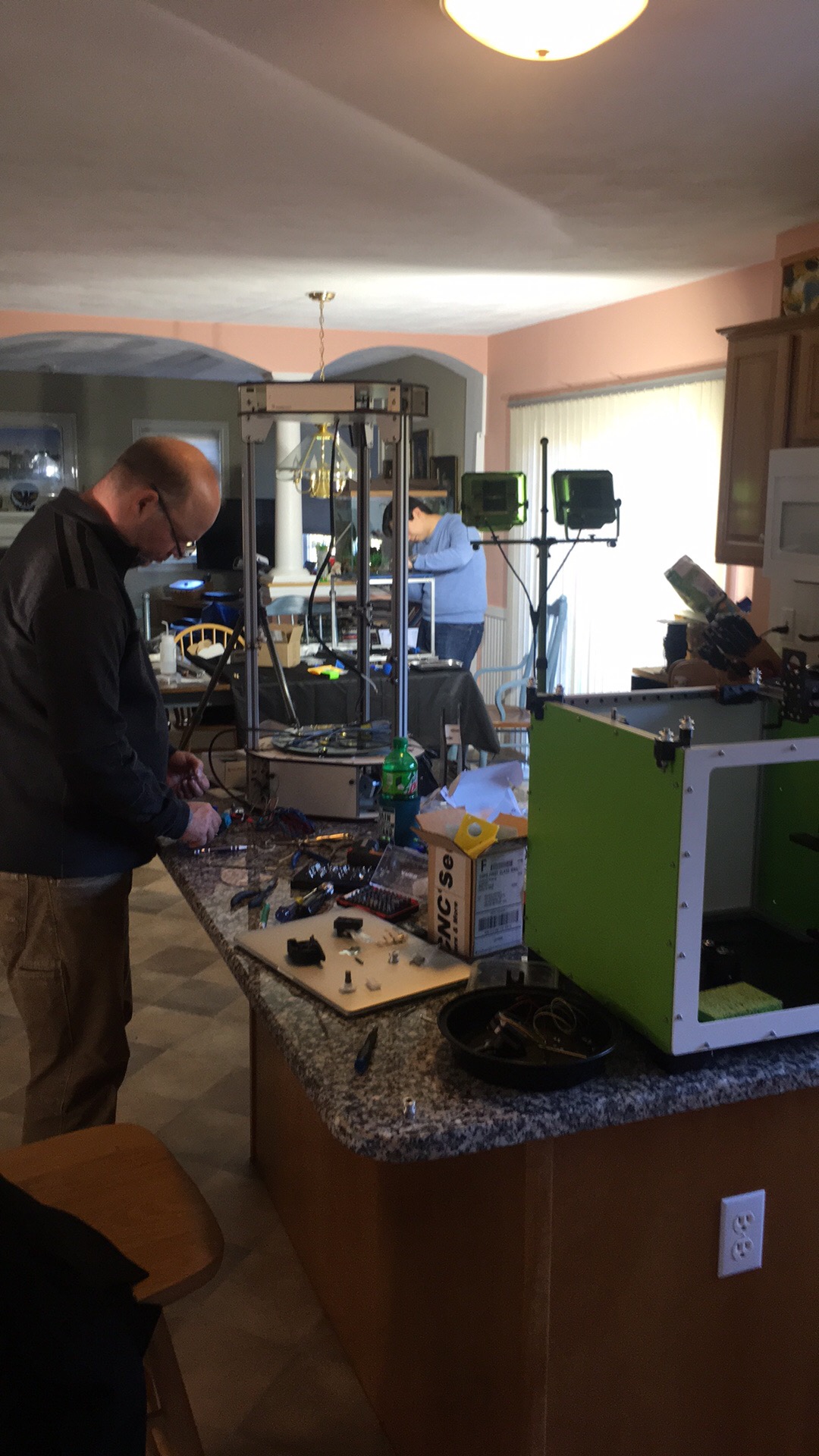

I hosted a couple of sessions in my kitchen for RailCore builds and as you see in the photo, a friend doing a Duet Wifi, Trick Laser arms, and Bondtech BMG upgrade to his RMax V2.

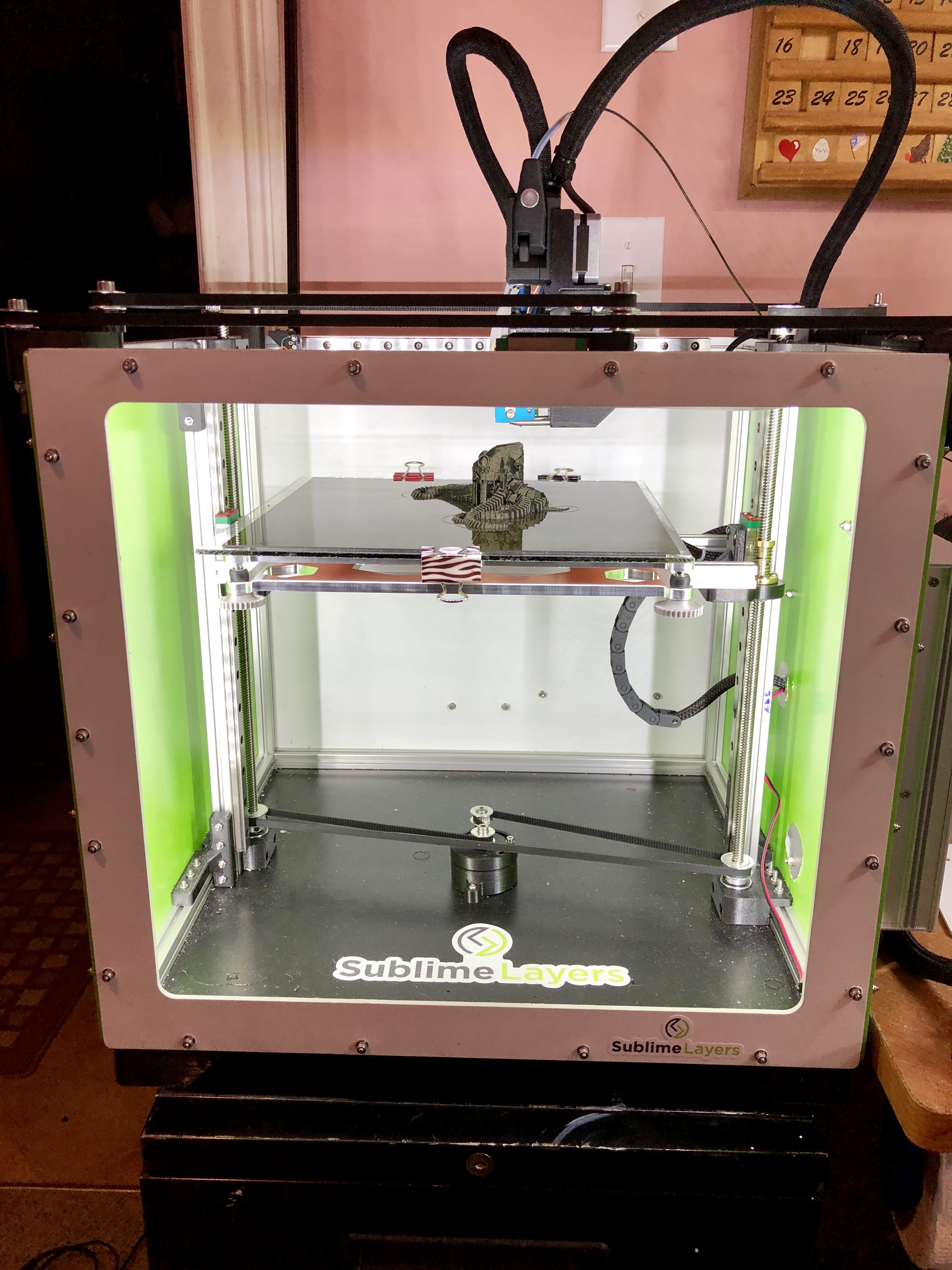

I painted my aluminum with PlastiDip spray cans in Sublime Green (I kid you not), white and a black bottom. The results are really nice.
And of course it gets my logo on the back.

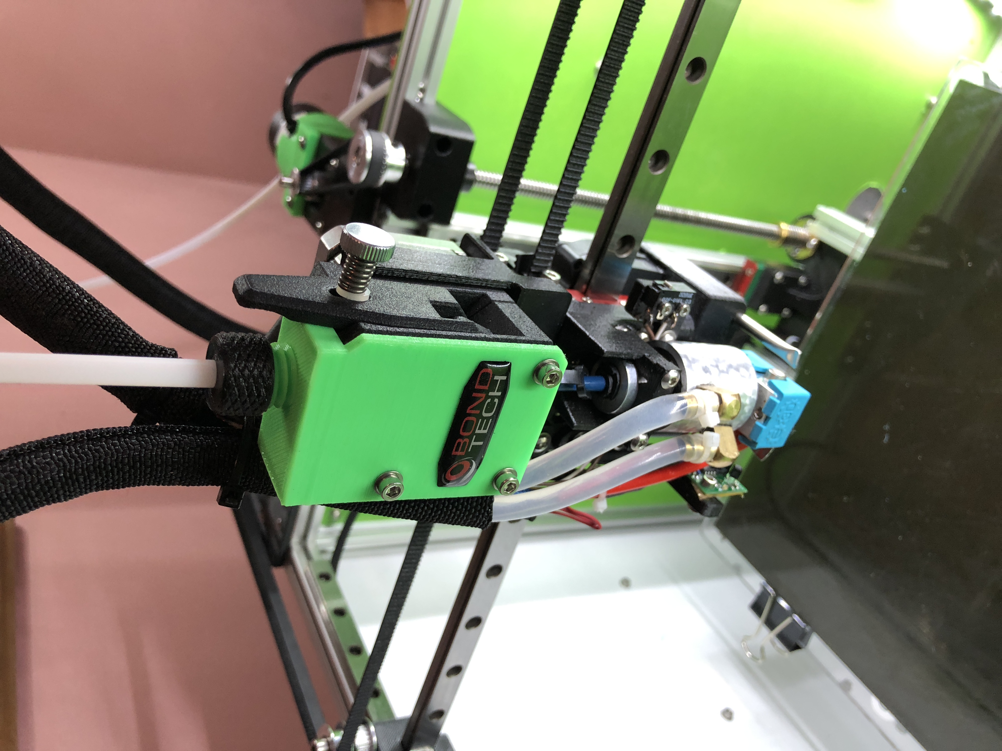

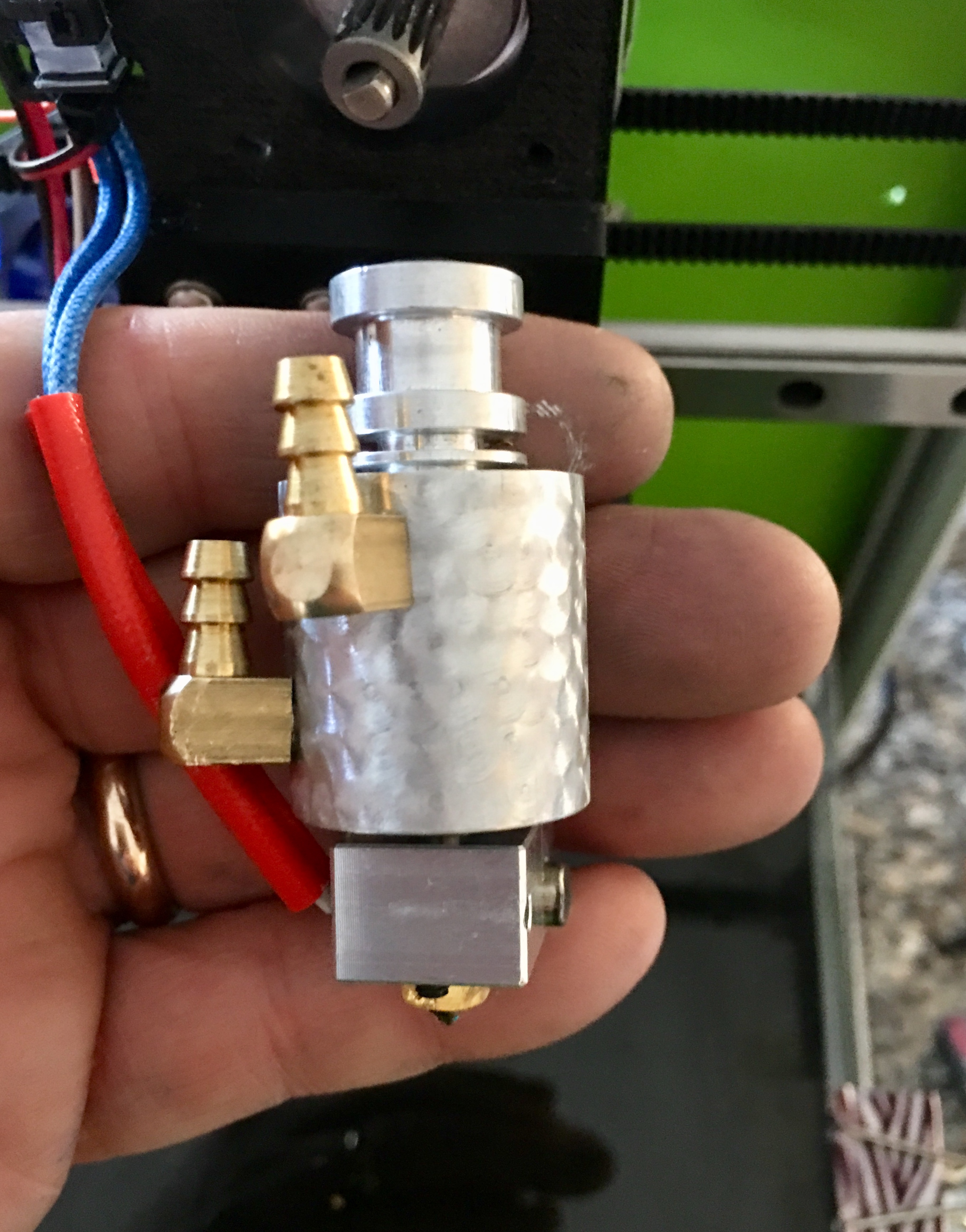

and my custom water cooled V6 hot end:
Palette+ tubing mount
The specs are:
.9° steppers
Duet Wifi
AC heated bed controlled through an SSR
borosilicate glass with PEI adhered on top
Bondtech BMG extruder
Modified E3D V6 hot end with water cooling jacket
I am also using one of my Palette+ with this printer

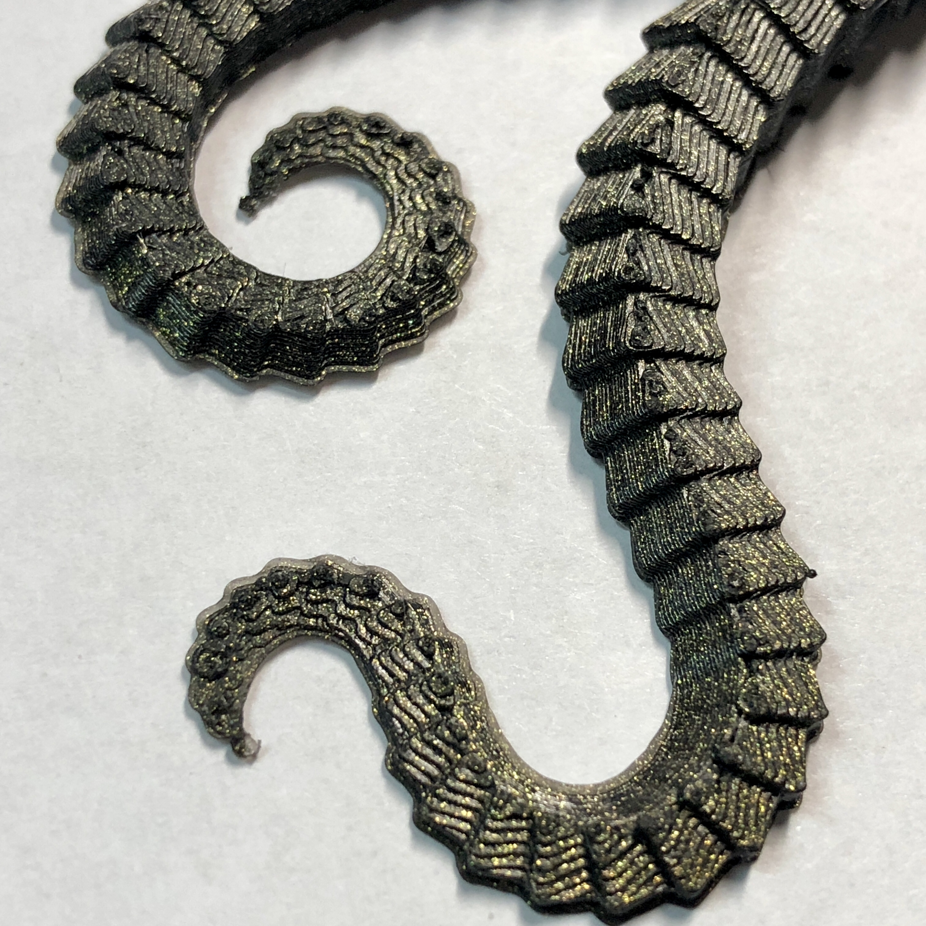

Overall: I'm very impressed with the print quality and print speed. I'm becoming a believer in CoreXY. This printer is becoming my go-to workhorse for a lot of jobs and it is getting dialed in nicely. Here are some prints.

What's that extruder? Looking at pictures on their website I cannot figure out which one it is.
And why is it wearing a "jacket"?
Edit:
Hmmpf... Just read it's a BMG, just the lever looked longer in your pictures ;-)

The extruder is a stock Bondtech BMG, the jacket (green) is the mount for my Palette+ filament delivery tube. The hot end is a stock E3D V6 that I modified with a water cooling jacket.

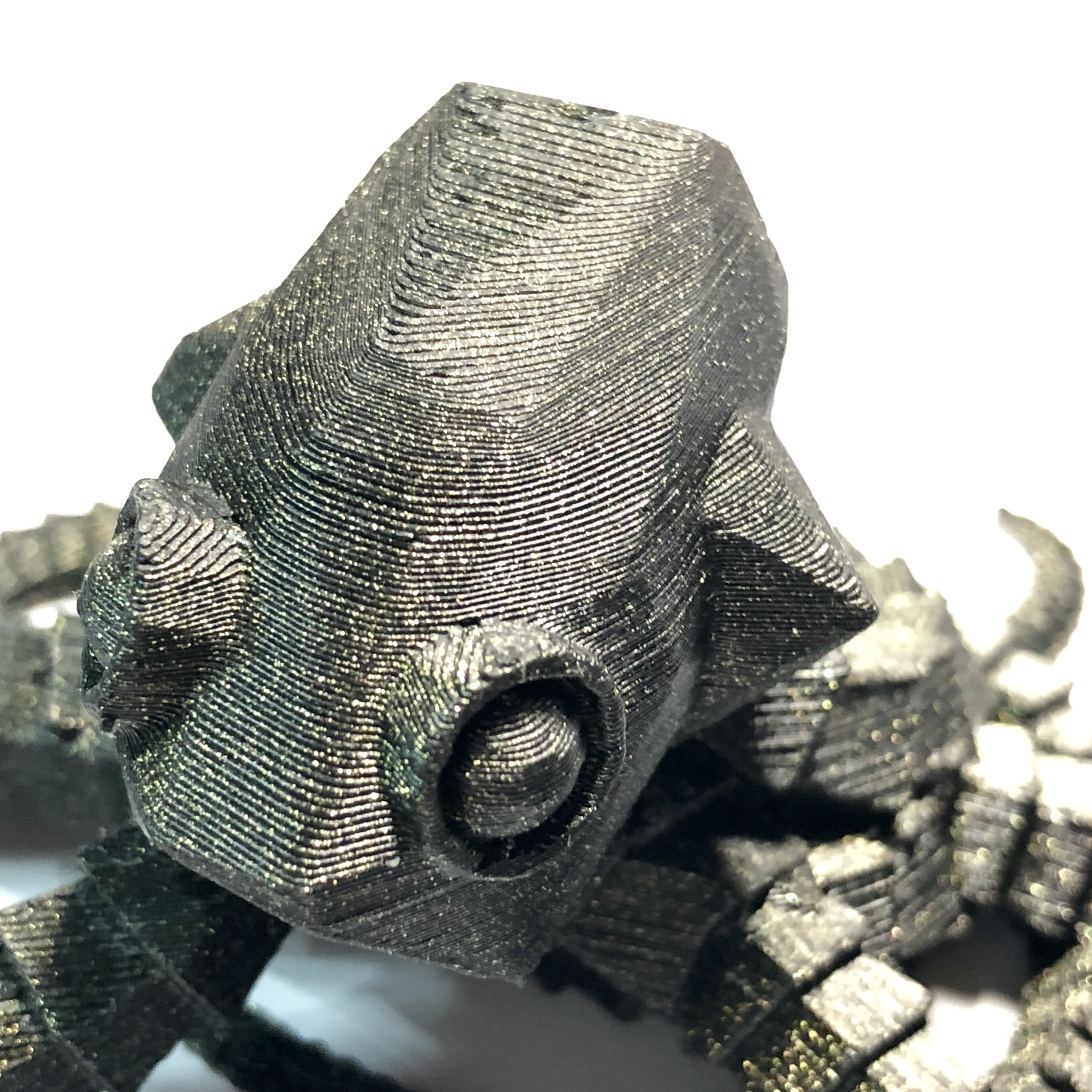

This was my very first print on the RailCoreII (can we call it RailCore // for convenience?)
Re: My RailCore
Posted: Thu Jan 18, 2018 3:35 pm
by kraegar
I still chuckle that you dove right in with that as a first print - still, turned out great!
And yeah, I usually just say "RailCore" as well.
Re: My RailCore
Posted: Thu Jan 18, 2018 4:27 pm
by mhackney
No guts, no glory as they say. But as a 3D printing maestro (not my words!), I can make any instrument sing. Plus the "slicer trickery" is more a function of hot end and extruder and I have lots of Bondtech BMG / E3D V6 water cooled experience. Cake walk!
You can see that I hadn't even sanded the PEI yet, all glossy!
