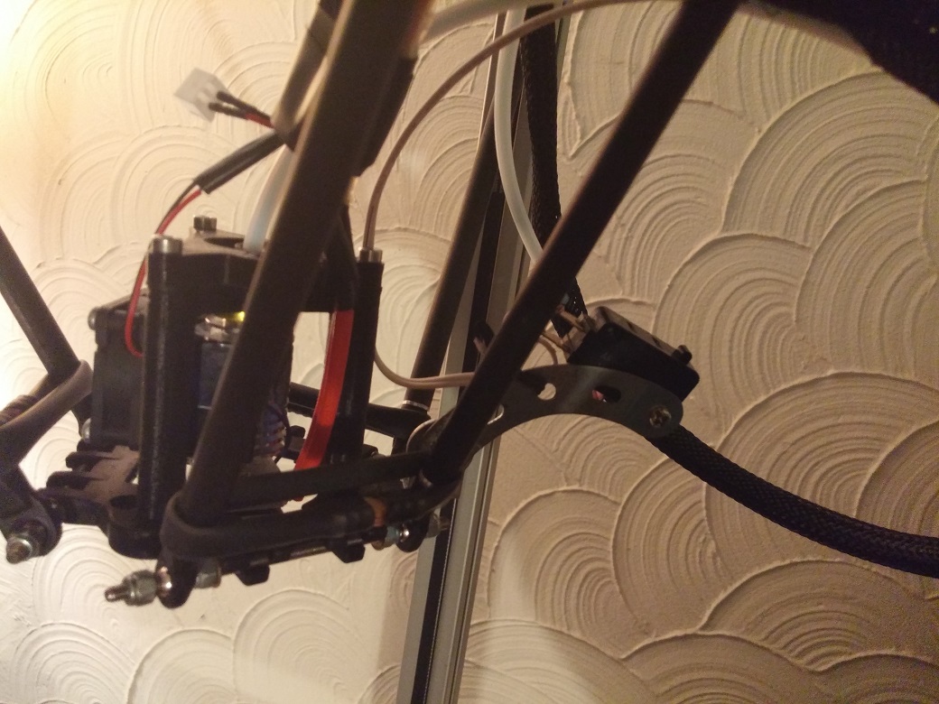

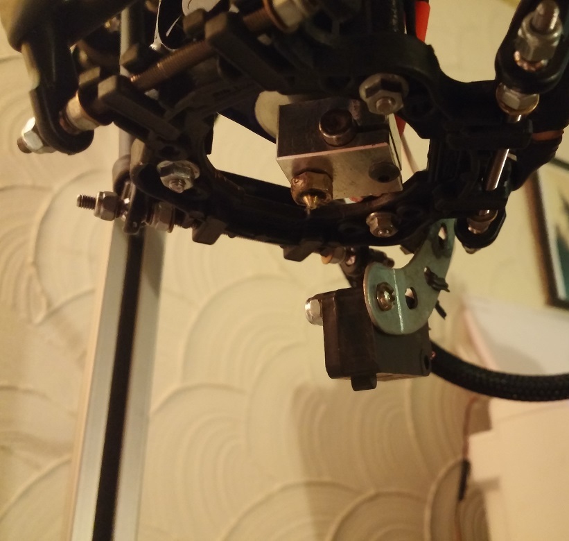

duvdev
Posts: 167
Re: Delta Automatic Calibration Tool - For Repetier Firmware
Post by duvdev »
thanks a lot - that sounds very ggod.
can youplease upload some pics of how you assembled the probe?
thanks
RollieRowland
Posts: 226
Joined: Fri Jul 17, 2015 5:30 pm
Location: U.S.
Post by RollieRowland »
duvdev wrote:thanks a lot - that sounds very ggod.
thanks
Yes I can! It is a rig but it works for now.
For measurments
For measurments
For Prints
For Prints

duvdev
Posts: 167
Post by duvdev »
Thanks.
What about the high difference between the probe and the hot end?

duvdev wrote: Thanks.
The Z-Probe height? What I did was I measured from the tip of the hot end to the tip of the switch. Mine is around 31.5mm. It doesn't make a difference with calibrating the bed, although if it is set right then your bed should be ready to print on.
