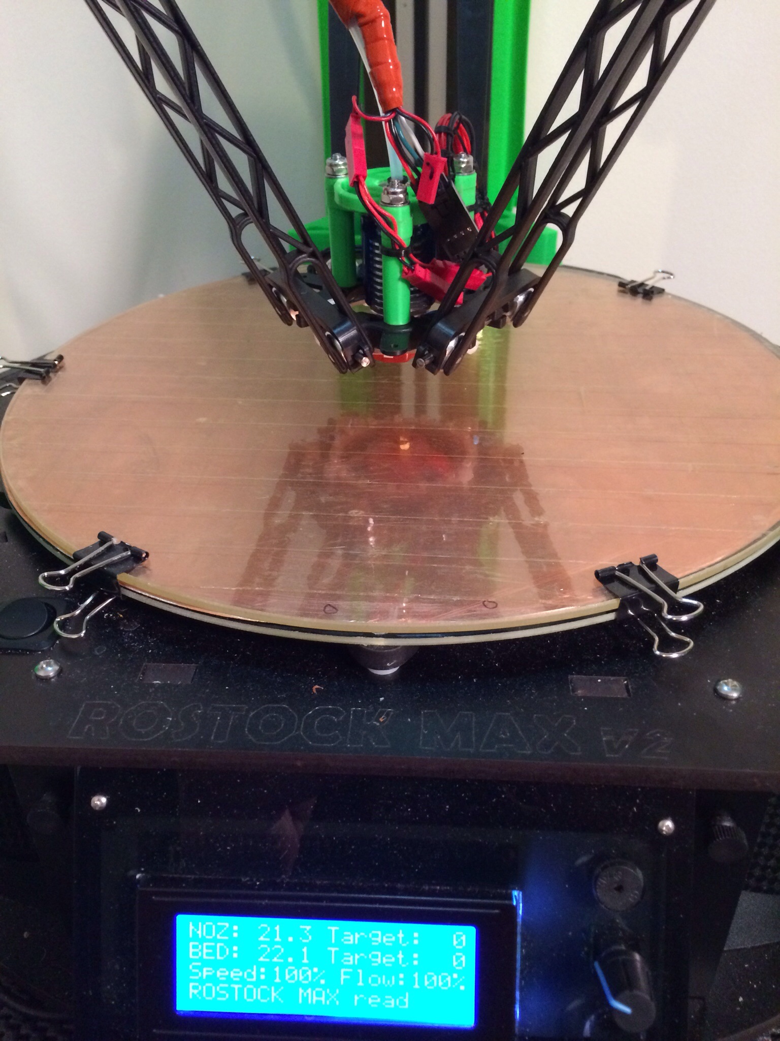

Re: PEI print bed surface experiments
How do you clamp down the aluminium, glass pei combo to the onyx.
On my last few prints it has shifted rather badly...
I use the industry standard 3-D Certified Paper Clips (5).
