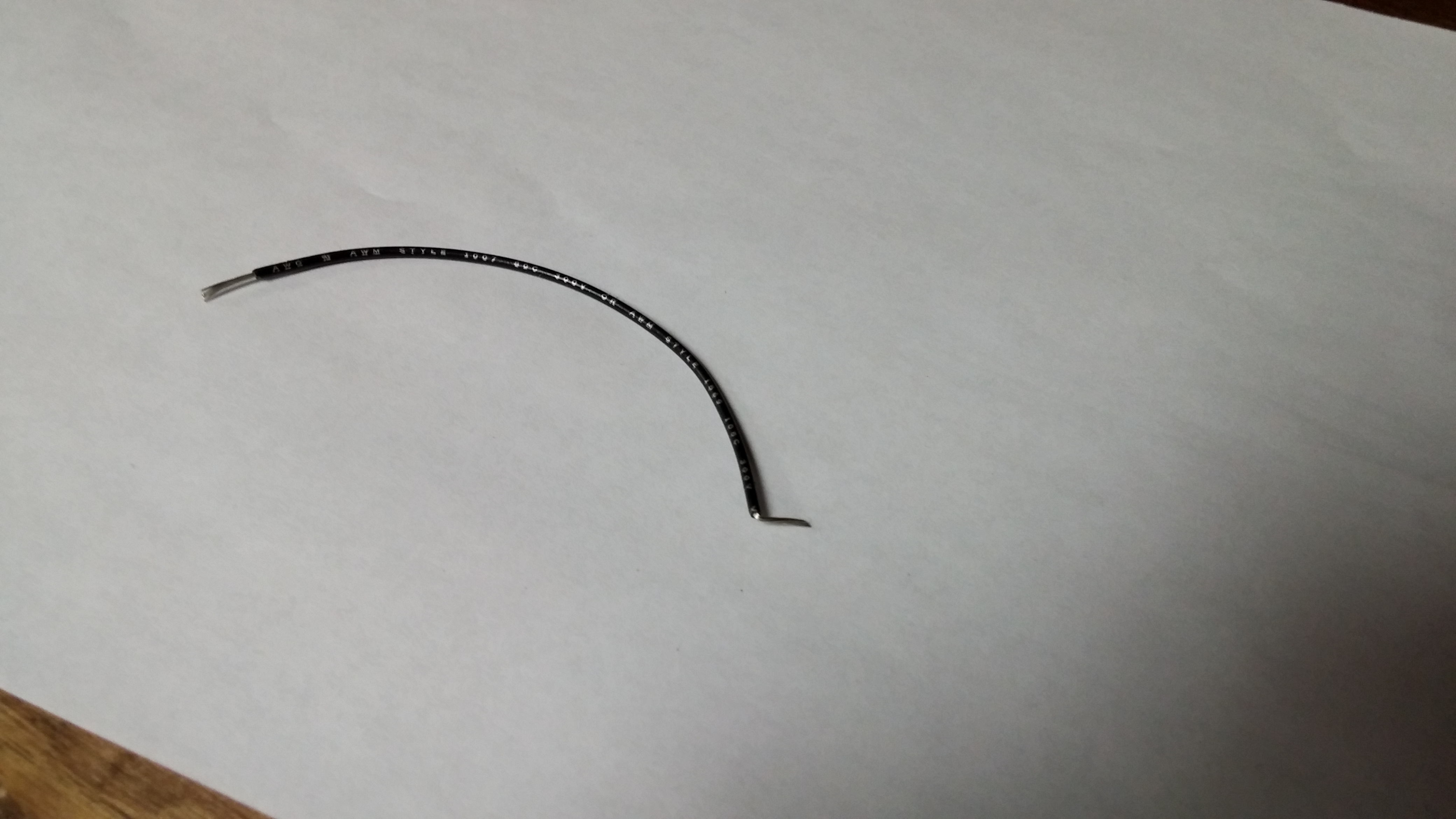

Take your fuse holder and strip about 1/4" of wire off of each end.
Then bend the wire at a 90degree turn.

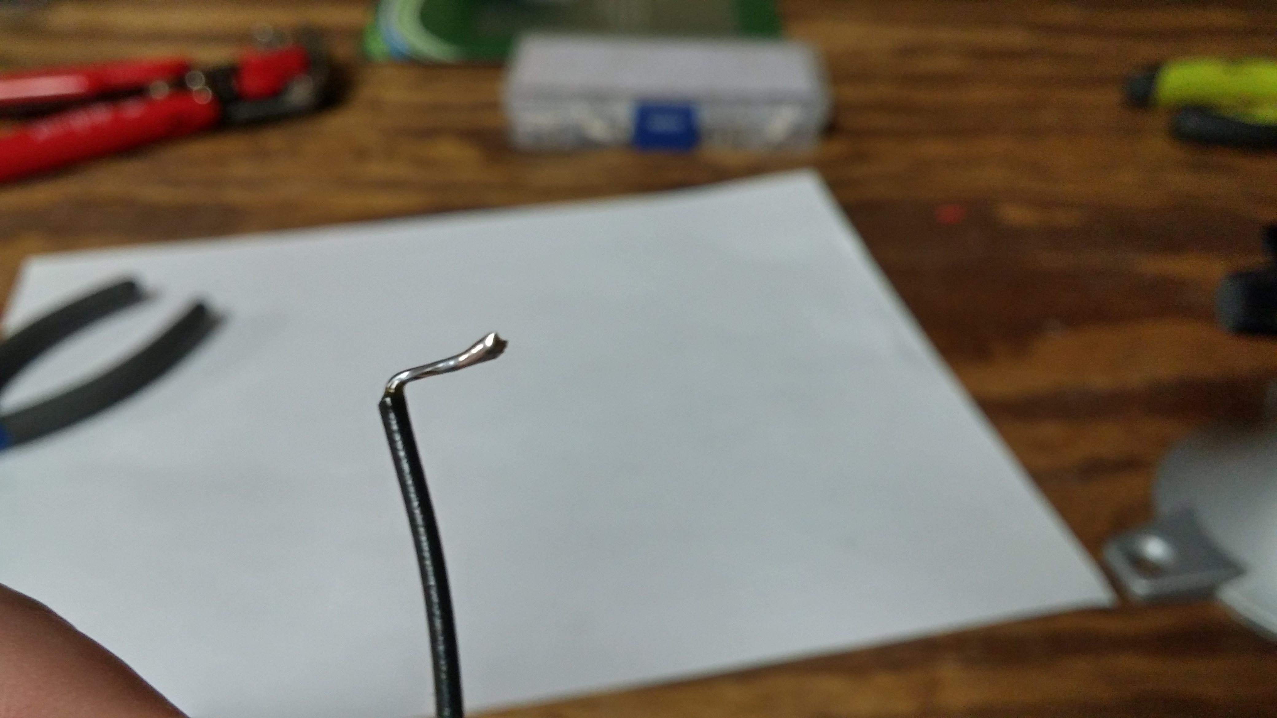

Go ahead and heat up your soldering iron. Once it is heated up, tin the ends of the fuse holder. For those of your who don't know what that means, it means put a thin layer of solder over each end.

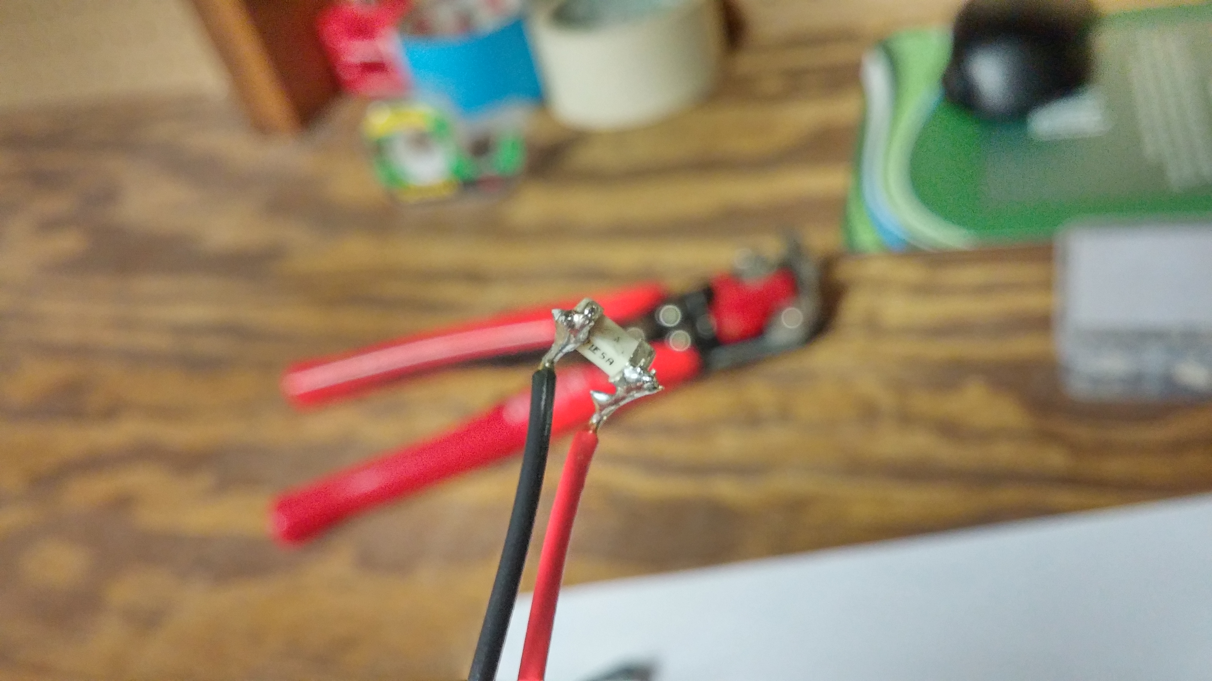

The broken fuse has text on one side of it. This is the top, so orient the fuse so that the top is facing up. With this orientation, you want to put the fuse in a vise so that it is aligned with the top of the vise. This prevents solder from getting on the sides of the fuse and preventing it from plugging in again.
Once it is in the vise, take your soldering iron and put a bit of solder on there. You want a little bit of a glob. With one hand grab a wire from the fuse holder and place it directly on top of the metal portion of the fuse(left or right side, it doesnt matter). With the other hand, grab your soldering iron and press it on the wire(with the glob of solder on the iron touching the wire). It should very quickly melt the solder and flow to the fuse. Do a stress test to make sure it is pretty strong and that it is not a cold solder joint.
Repeat for the other wire.
Quick Test: Plug in a fuse to the fuse holder, turn your multimeter to ohms and press the leads directly against the broken fuse. It should read close to 0 ohms now. This means everything is soldered correctly.
If you took the fuse out of the vise, go ahead and put it back in. Now layer some liquid tape over the metal so that it does not short against anything. Try not to get any on the sides or on the body of the broken fuse because it will not fit back into the holder.
Now plug in the broken fuse and get the wiring out of the way. You're done.

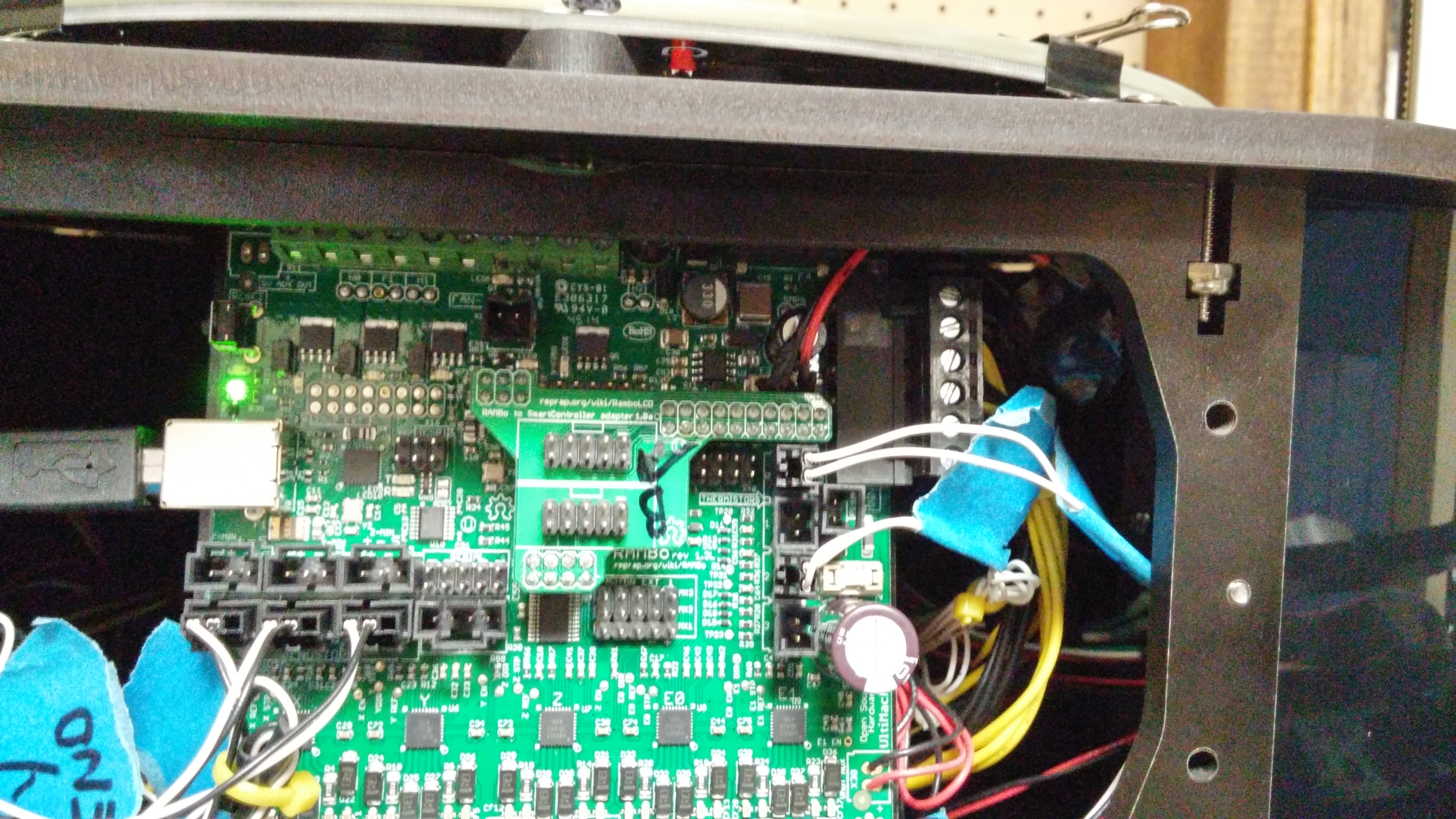

Here's one I prepared earlier.
[img]http://i.imgur.com/Kvt5Pfr.png[/img]
Same situation as you - didn't want to wait a couple of weeks to play!
