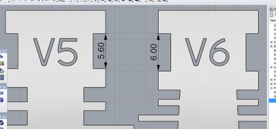

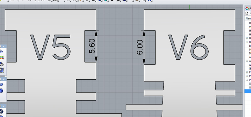

There are two versions of my E3D mount, one for version 5 and the other for version 6. If you use the older one on a version 6 hot end, it will wobble because (for reasons I cannot understand) they changed the mounting profile.

Re: E3D V6 wobble
Yup! it's slightly different, 0.4mm
V5 vs V6: Made this mount some time ago and it's working fine.
