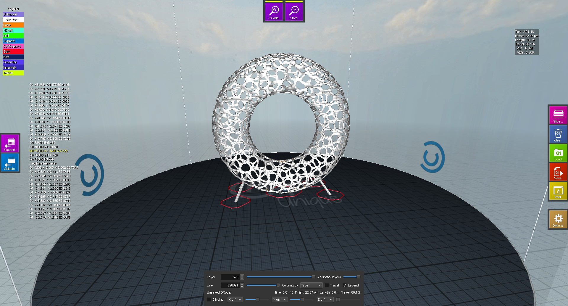

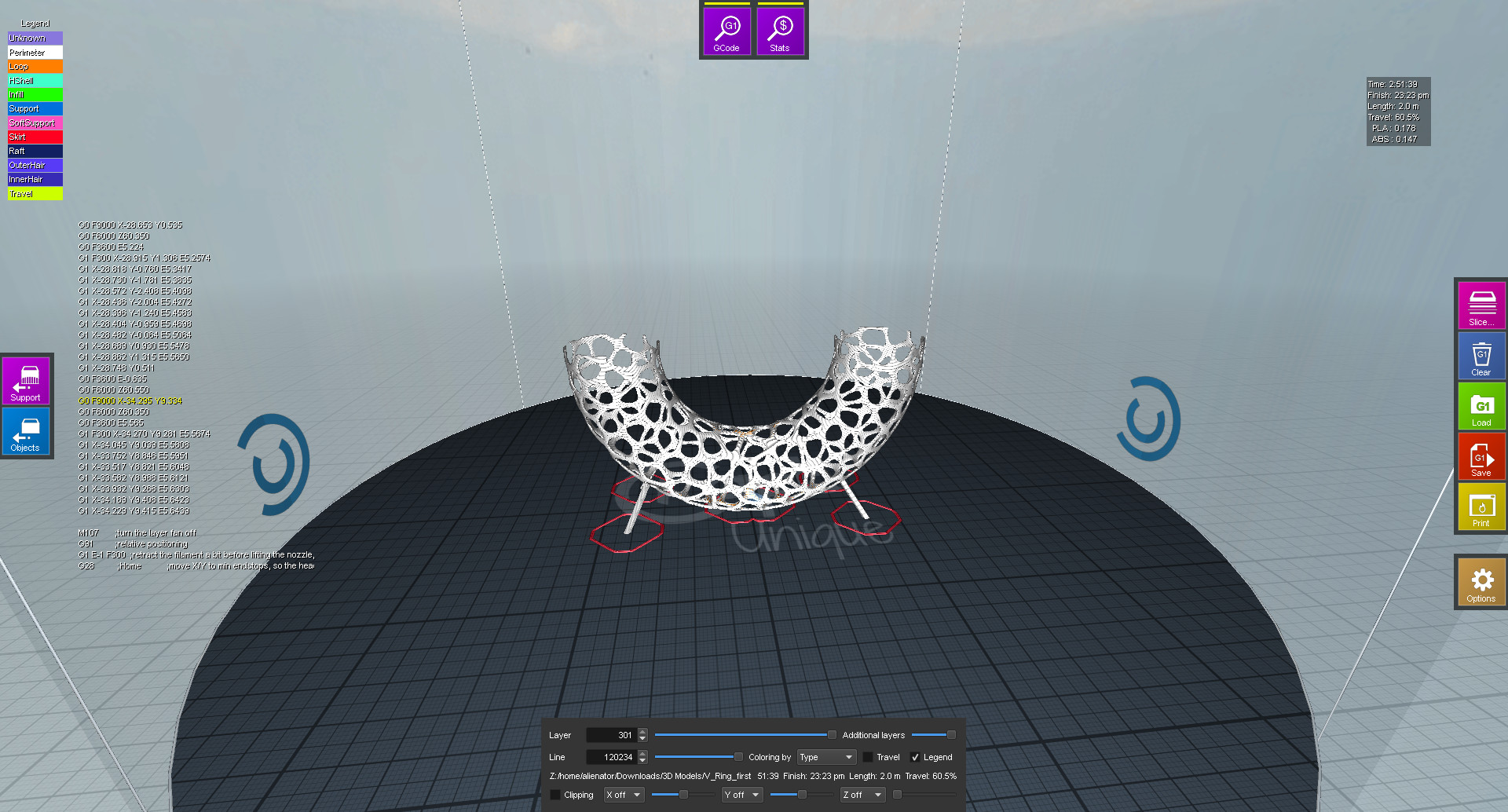

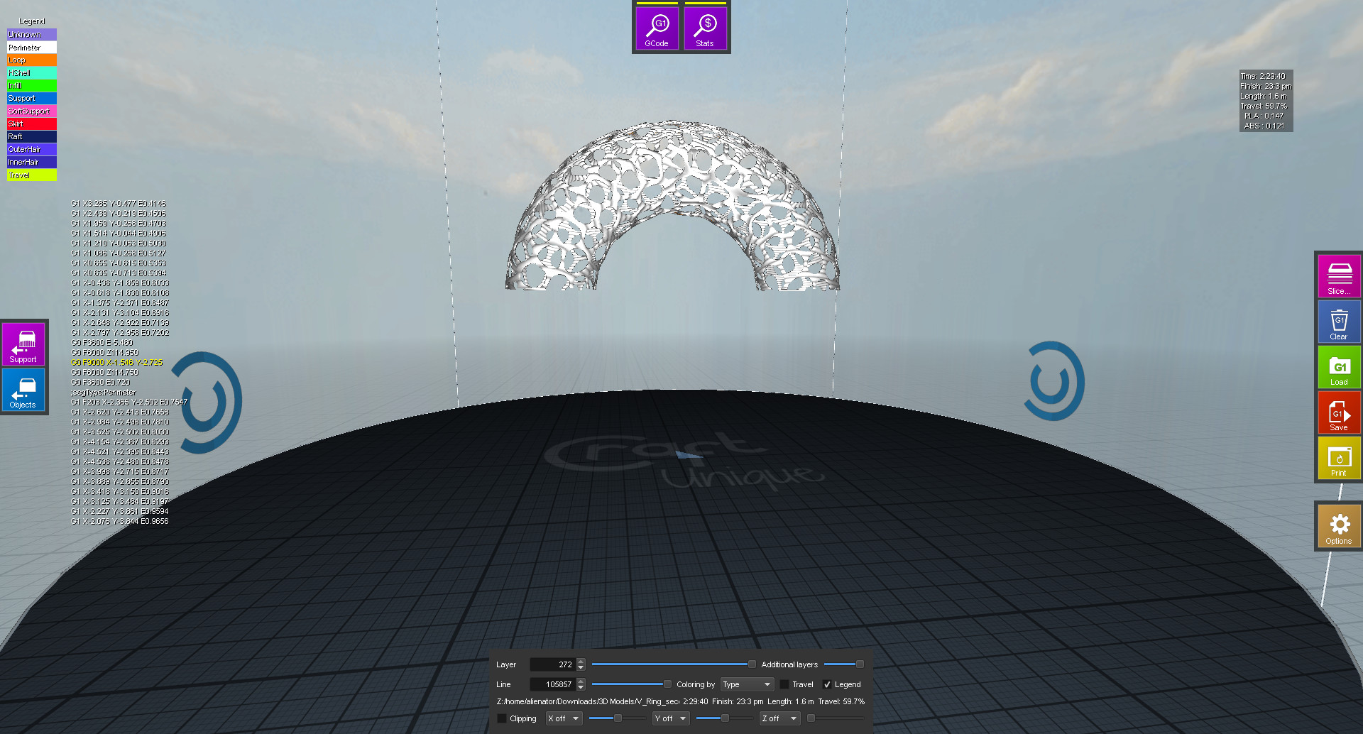

I use a bit of a convoluted and manual system to do this, but it allows me extreme precision with my filament changes and other settings changes.
In a nutshell, I make separate gcode files for each portion of the print. You start off with the full gcode file, and then cut and paste the portion that begins at the layer you want the pause to occur at, into another text file and save it as a second gcode. I modify my header for the second file to ensure that the nozzle doesn't come crashing down into the print during the usual lower and prime, and modify the footer of my first file to make sure the machine essentially finishes the print, but does not reset and does not lower the temp of the heated bed or nozzle.
What I end up with is something that looks like this when observed in a gcode editor

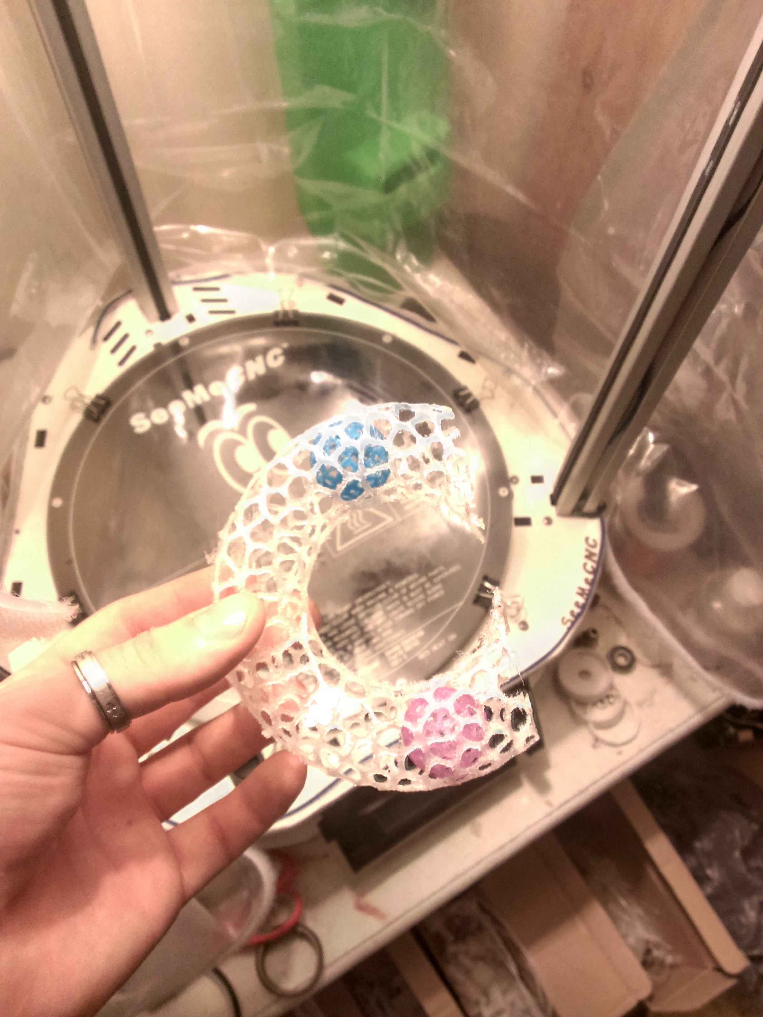

This particular print, I had the gcode separated so I could then insert two spheres that had previously been printed. If the print hadn't broken loose from the bed, it would've been perfect, but as it stands, I still ended up with a pretty cool print.
Admittedly, this workflow is not exactly ideal, and is kind of clunky, but you really only need to do it once to create your separate gcodes, then you can change the filament to any color you want and print the separate files as many times as you want.
I actually use this particular method to do things such as change the infill midprint (by splicing together two different gcodes, first half being for instance 20% infill, and the second half being 100%) and I have also had success with printing ninjaflex on top of PLA for the endpin of my electric cello (which is quite close to being completely finished by the way).
