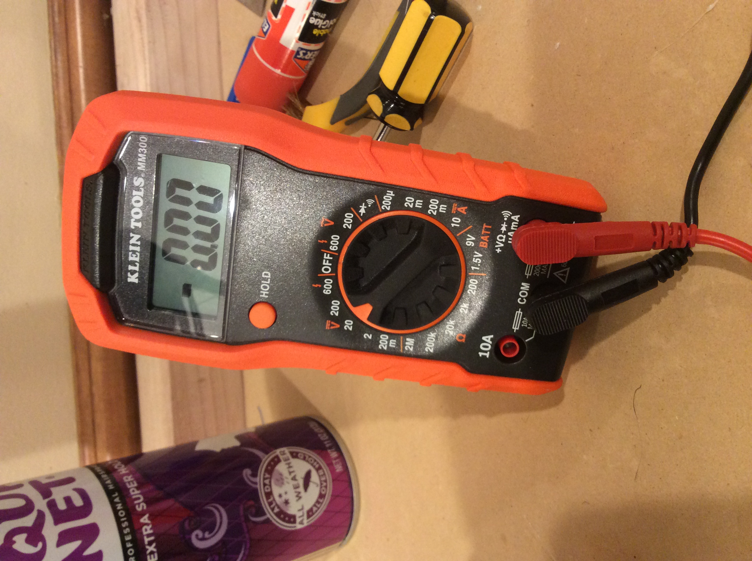

Ahhhhh, it appears I may have bought too sissy of a multimeter. It's says not to test on D.C. Greater than 10A and the power supply sticker says 29.7A. Sorry I'm being such a pain with the questions, this is what getting raised by a single mom gets you, completely stupid on man tasks.
Attached pics of my wimpy multimeter to confirm or deny it's too wimpy for the task.

The 200 milliamp and 10 amp restrictions only apply when you're measuring current, not voltage. In addition to selecting the selector dial and hooking things up differently, to use the 10A scale you actually have to move the red probe over to the 10A socket. I'd suggest learning more about electricity before attempting to measure current...and start out with small battery circuits.Ravitch wrote:Ahhhhh, it appears I may have bought too sissy of a multimeter. It's says not to test on D.C. Greater than 10A and the power supply sticker says 29.7A.
Your limit on measuring voltage is 600 volts. Not an issue in this case, and as you discovered, it worked fine.
