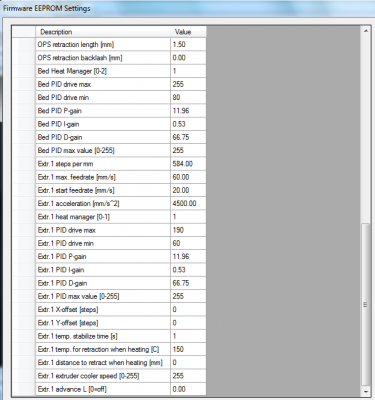

My prints have been 'ok' but I decided to go back and try calibrating again. I decided to start with the single wall cube.
I printed a single wall 20x20x20mm cube with 1mm perimeter, 0% infill, 3 bottom layers (0 top), and 4 layers of raft. I set my nozzle diameter to 0.55mm in Slic3r 0.9.9, but when I measured the actual thickness, it was approximately 1.08mm (used a digi caliper, buying a micrometer tomorrow morning). Otherwise, the print turned out surprisingly well (probably the 10th item I've printed on this Rostock)

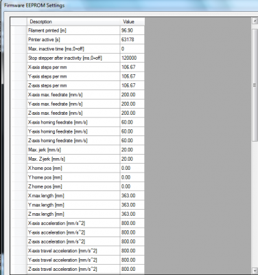

Lol, thanks, except it's too thick! It should be close to 0.5mm thick, not 1.08!
Here are my EEprom settings - I suspect it's my extruder steps per mm that's off - I did double the default eeprom value, but perhaps that was incorrect?

Cassetti- in your first post you said you printed with a "1mm" perimeter. And you measured 1.08. If both are true you need to set the extrusion multiplier to 1/1.08 = 0.93.
The way polygonhell wrote up the extrusion help was to have a single 0.55mm perimeter. So you want to compare with your perimeter settings. Not really an issue but for better resolution you probably want to print with .55 perimeters in the slicer for a .5 nozzle. That seems to be the standard.
The higher the perimeter width to nozzle ratio, the higher the pressure in your nozzle for the same speed. This will most likely result in problems with ooze during lifts and retracts.

There are two distinct settings in Slic3r. One for nozzle diameter which if stock should be .5mm. And another for wall thickness. In your original post you state 1mm walls. That is why I was thinking you only need a minor extruder multiplier adjustment. If you can, post a screen cap of the Slic3r settings or the start of the g-code that should also have the settings.
With your EEPROM, an easy way to check if it is advancing as expected is to put a mark on the filament at 50mm before the extruder entrance. Send a 50mm extrude command from the host and see how far it moves. (May want to put a couple of marks every 10mm or so after the 50). Then check which one is closest to your entrance. Looking at your settings for the steps/mm of the extruder they are close to mine, so I don't expect it to be off.
