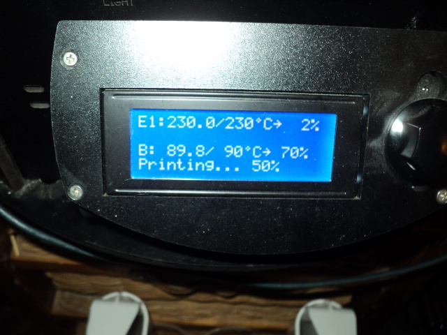

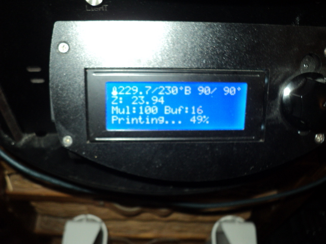

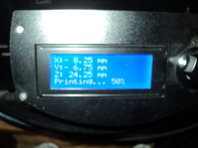

Re: Not recognizing sd card?
On the printer, I have these 3 screens and that's it.
You're pushing the knob while the printer is idle to bring up the menu, right?
I didn't know you could push the knob, lmao. Ok, as soon as this print is done, I'll take the black knob off and see if i can push it.

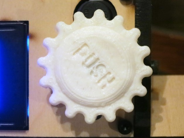

Isn't funny how all the ORION owners were told, but not us poor old RS-Max owners? lmao
This should also help: http://www.thingiverse.com/thing:194457/#files" onclick="window.open(this.href);return false;

Now I'm LMAO. That knob made me almost fall out of my chair! Thanks for finding and sending that.CJGerard wrote:Isn't funny how all the ORION owners were told, but not us poor old RS-Max owners? lmao
I'm printing that sucker out and using it, it's worth it just for the funny factor.
CJGerard, you made my day.
