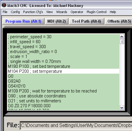

That's a great tip John and one I plan to document in the Operations Manual. I've been doing that too since I noticed a big variation between my orange, blue and green ABS with respect to extrusion temperature. It will be very useful to be able to capture extrusion temperature too and have that set in Mach. However, if you enter the temperature and bed temperature on the Printer and Filament tab in Slic3r, it will output the M codes to the gcode file. You can then look in the gcode display and see what temperature you need to set as you can see here!

Good idea Mike! To anyone reading this, I'd say lets get in the habit of setting the temps in the slic3r boxes now! We can always comment out those lines in the G-Code until we come up with the custom Macro (M-Code) but it would do alot of good to know what temp you posted the code for, and if you make changes, you can go into slic3r and update the configuration so you will know.
