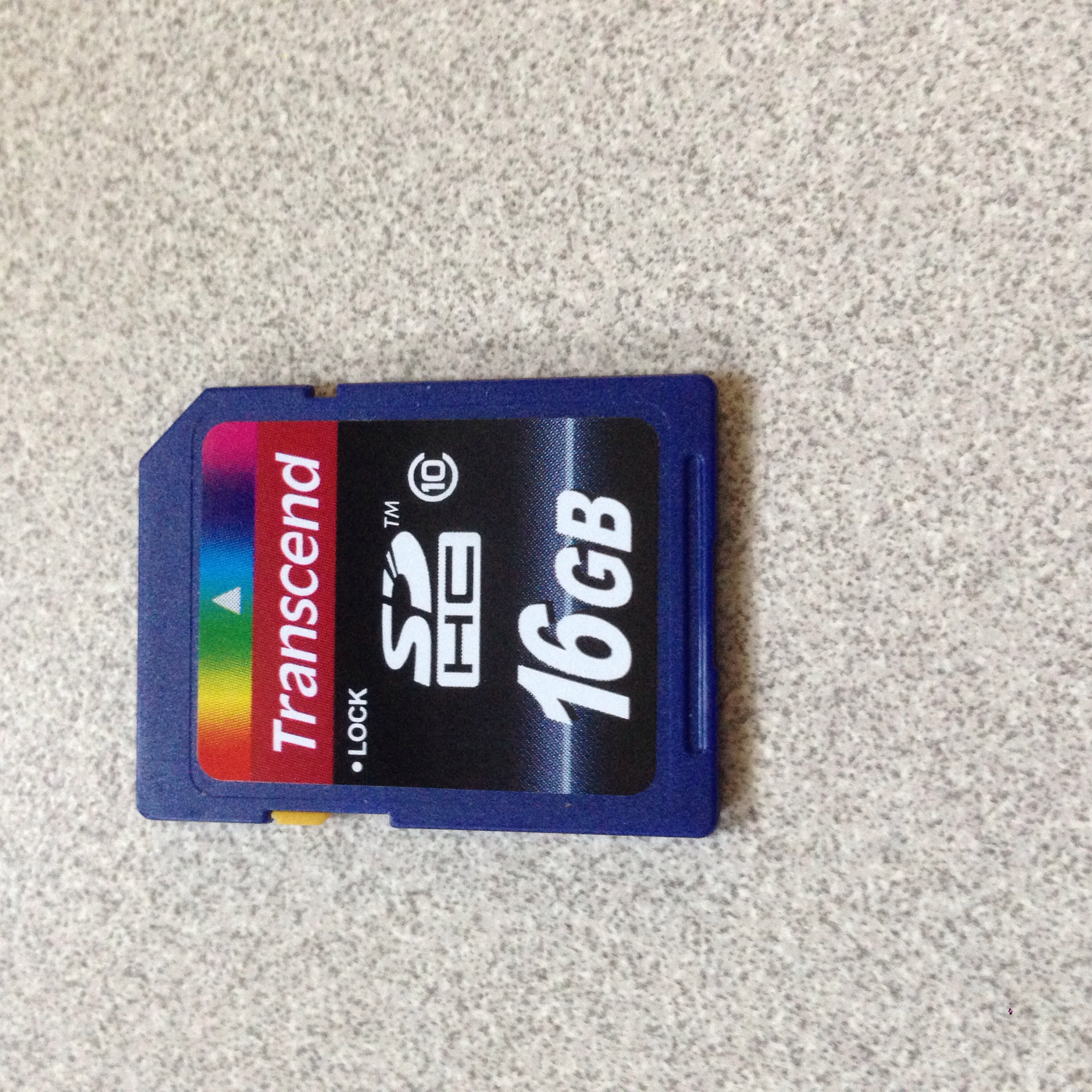

New build of a rostock max in black. It can see the Sd card, can see file, and it beeps when selected. But the print will not start. Suggestions?

thanks, I will try that this evening. In addition I will completely disconnect the USB cable because I saw another thread where it was mentioned that the printing stops when the screen saver kicks in!??
Re: Sd card, can see file, print will not start
So I tried disconnecting the USB completely. RAMBO is powered from 110v, not USB.
-I preheat for ABS. I can read files from the SD card.
-I can execute GCODE from the SD card, like scripts to home to towers and other delta ballet style pieces.
-Everything is hot and at the expected temps, so I select a file to print "simple.g".
-Extruder drops to the bed, prints the brim, proceeds a bit more, then stops. Nothing more.[/list][/list]
one more thing, all files were sliced with Cura. However I can successfully load them into Repetier-Host and print the GCODE through that interface over USB.
Suggestions?????

I would believe that its the sd card itself.. if its the one that came with the machine, is it a white label that just says "high speed"... because those are crap.. lol.. if you can try a different card... class 4 or higher, not kingston brand, but most other major brands would be fine...

thanks- just ordered a class 10.
Bought this one, same problem. I preheat for abs. Then one it's heated, I insert card and select a small file. Print starts, but stops before the brim is even finished. Slicing is done with cura.

Last night I pulled off the front cover, stretched out the ribbons. Printed directly from the sd card without issues. Guess it needs the ferrite cores!
