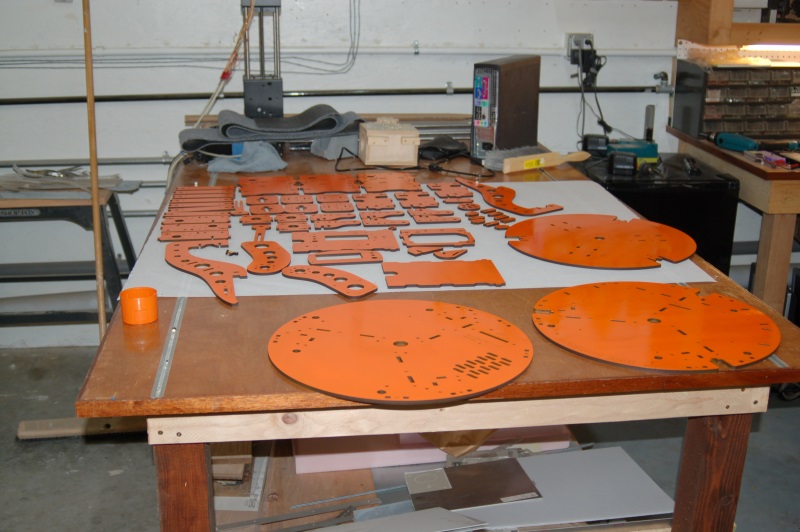

SeeMeCNC sent me a full set of current production melamine parts this week. The plan is to revise the assembly manual using all the current parts to make sure the manual is as accurate as possible.
My intention is to completely disassemble my working machine and rebuild it using the new parts. All new photos, etc. I'll also be using the new gears and new plastic parts with the exception of the acetal bearing covers.
My plan was to get started this weekend. However, due to me forgetting sacrifice someone else's blood to the Tool Gods, I've now got a nice gash from the tip of my thumb to the base. This will of course slow things up considerably.
I did get the parts painted, so you'll definitely be able to spot the new photos.
Picture of the parts: [img]http://www.geneb.org/images/orange-max.jpg[/img]
Since there's going to be a short delay in starting work on the 2nd ed. I'd like you guys to start coming up with things that you'd like to see in the 2nd ed. that were either vague, wrong, or flat missing in the original manual.

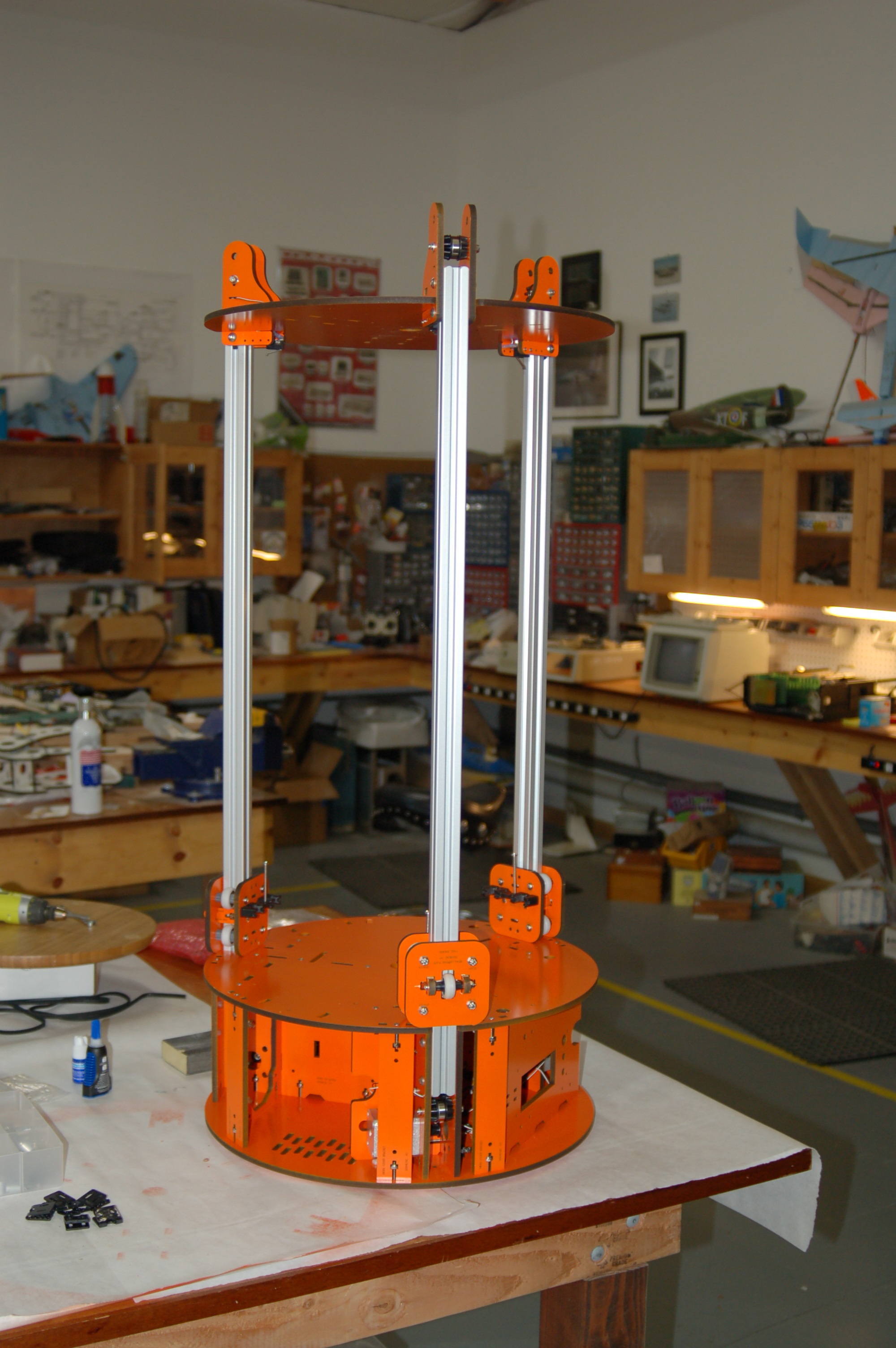

Hand is all healed up so I started working on the new build yesterday. Took a couple of hours to completely disassemble Betty Goop.
This time around I'm going to recommend some pre-assembly steps - most notably, popping all the countersink rings in ALL the parts at the same time instead of doing it as you go.
Instead of doing the tri-supports like last time, I'm treating each one as an assembly that gets completed (stepper & belt guides) and then loosely installed in the base. This should alleviate the cramped-space issue with installing the steppers & belt guides. Thread locker is used on the drive gear grub screws as well as the stepper motor mounting screws.
Inserting the lock nuts from the lettering face of the parts makes it a lot easier as well - you're taking advantage of the laser kerf to ease the fit.
All the tri-support and circumference supports are all the same height, so having an out-of-square base won't be an issue. Looks like they got the issue they had straightened out.
I would have gotten started on Saturday, but I noticed a few poorly painted spots that needed a second coat.

I finished the basic mechanical assembly on Saturday (not including installing the arms & effector platform).
Here's what it looks like:
http://www.geneb.org/images/orange-max2.jpg [It's an un-resized image]
The photo doesn't show the belts installed, but that was done as well. Up to this point I've got about 120 pictures taken. The RAMBo and LCD installation will be covered last in order to have a firm line between the mechanical and electronic assembly. I do have the new machined arms, so those will be featured.
I'm writing the 2nd ed. using LibreOffice Writer so that you won't need MS Office 2010 to make changes to the document once it's up on GitHub.
