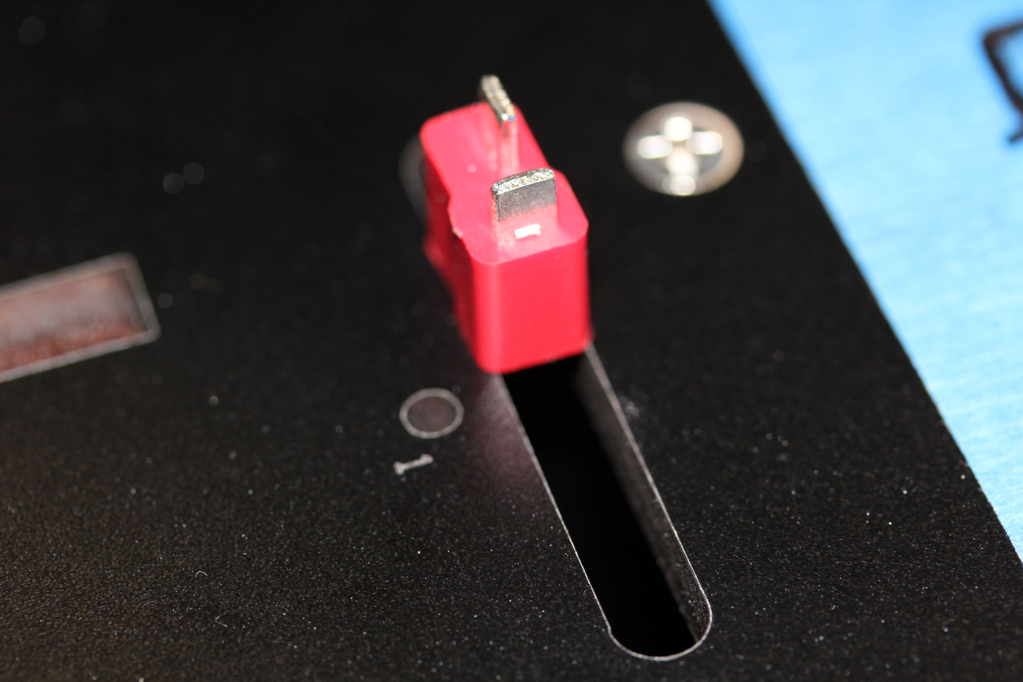

Gene, I tried your way to install the belts using forceps but still had a devil of a time pulling the belt through the hole in the carriage. I suggested an alternate approach in my sorta-build thread (http://forum.seemecnc.com/viewtopic.php?f=42&t=1590) that works for me in seconds. I think it's worth a look and a mention.
- dan
- dan
Re: 2nd Edition Review Thread
I did a similar trick to dbarrans. I used a thin metal ruler I have in place of the plastic. I also rolled the end of the belt so it had a little curve in the direction of the slot in the carriage. If you push the thin "ramp" of material to the back of the slot in the extrusion, and push the belt in from the top, it will slip through with no problem. It really does work very well.
Noted, thanks guys.
dbarrans, do you mind if I use your description & photo verbatim?
tnx.
tnx.
I don't mind at all.

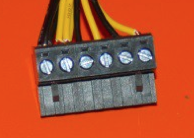

- P. 95, Fig. 13-7. Please use a close-up of the connector. Something like this (only less pixelated) would show the needed detail.
kbob, this is absolutely brilliant! THIS is the kind of feedback I wanted to see! I'll only comment on some of these, but I've printed the message out in order to use it as a reference this evening.
