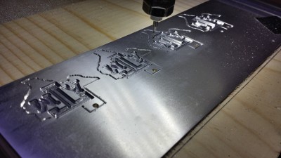

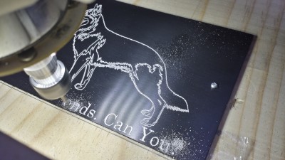

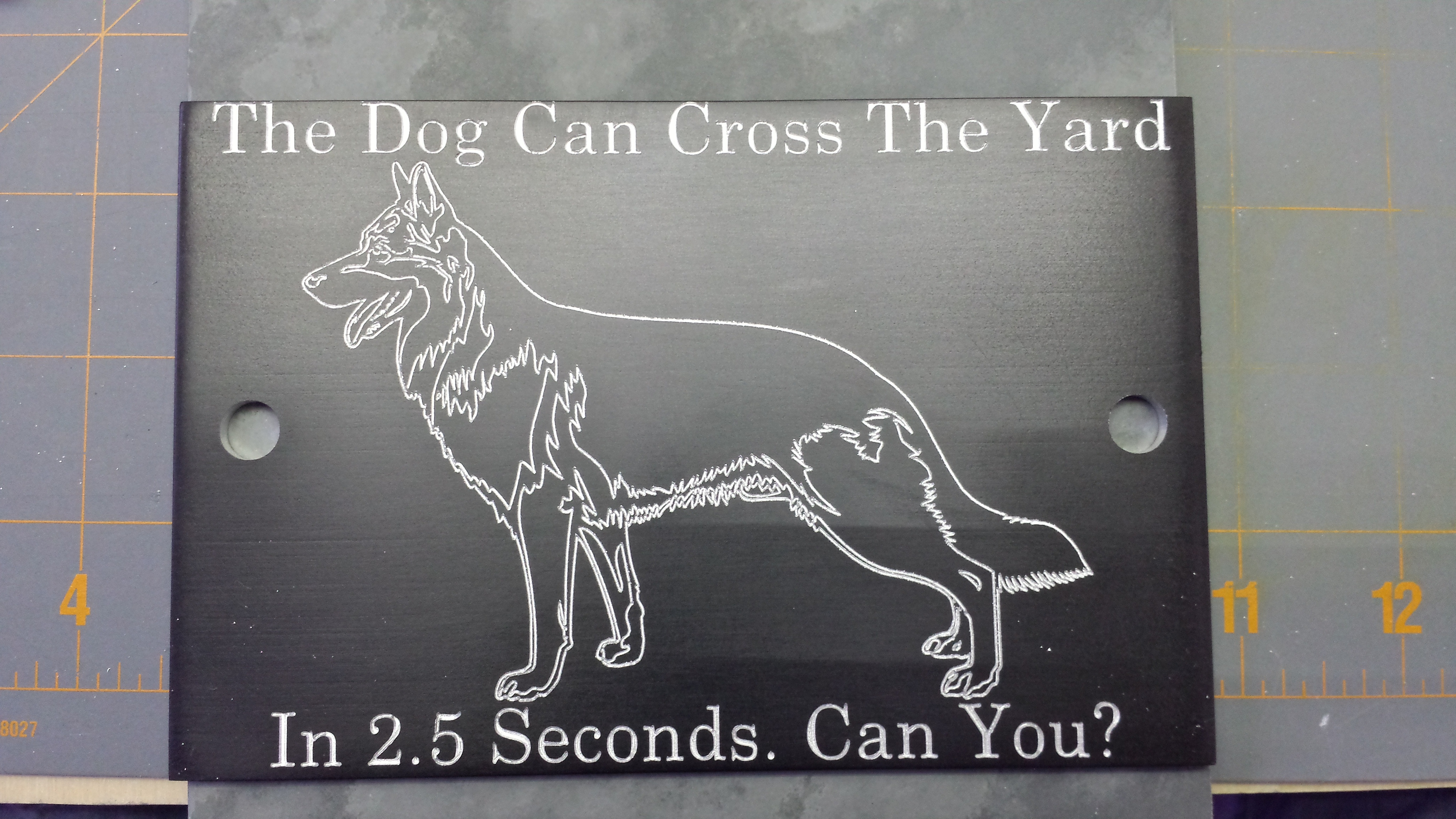

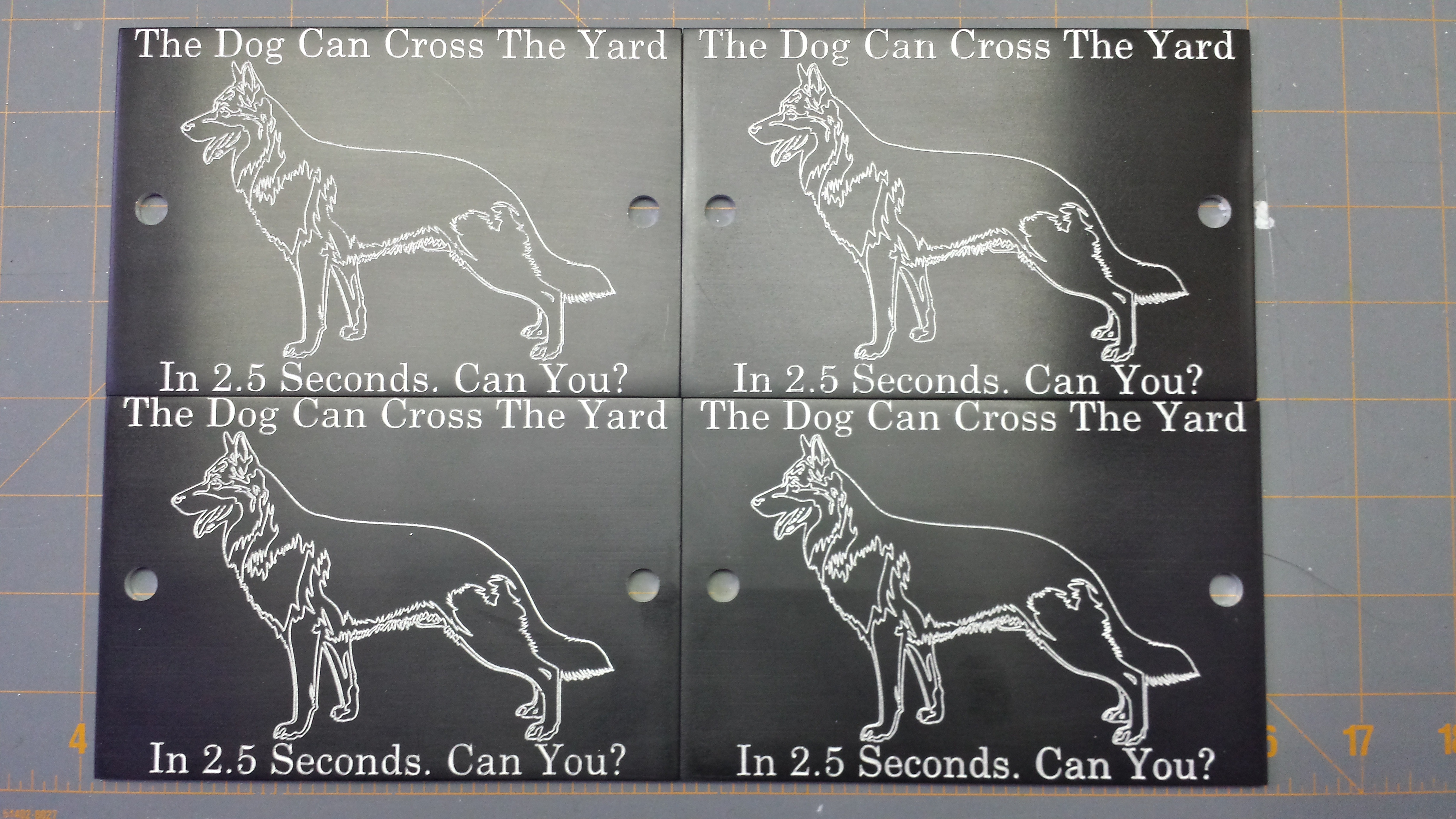

I have used the very same bits in metal and they work great.. Here is a shot of a sign I did for my folks and their new german shepherd

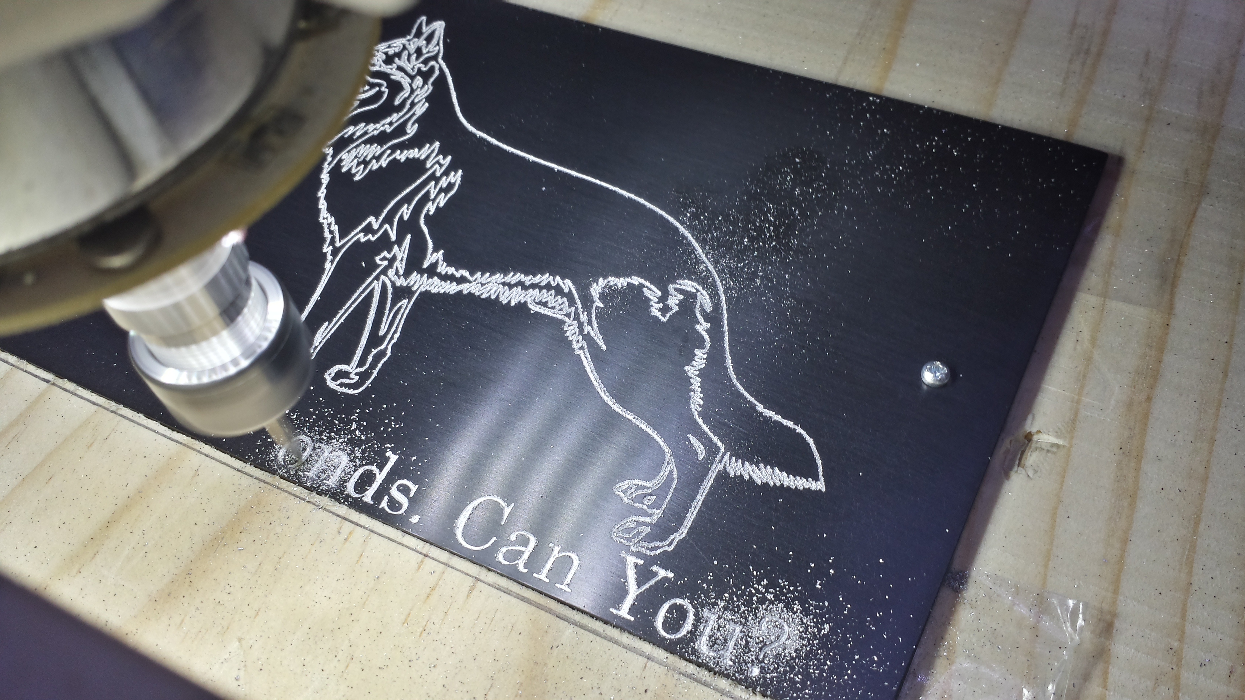

The dog was done as just a 1/4mm deep etch. the lettering is done at .5mm v carve with aspire 4 for this one.
All four signs were done with the same endmill and it was still sharp once finished. The blanks were cut from the stock sheet then prepped and anodized black. Then mounting hole were cut with a 1.6" endmill and the sign was engraved with the 30 degree .2mm engraving bit.
I get mine here http://www.ebay.com/itm/10x-Carbide-PCB ... 418193a5ce" onclick="window.open(this.href);return false; they work great in metal, stone and also good for a fast PCB prototype, but I do not use them for final PCB cuts. I use another bit for that.

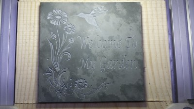

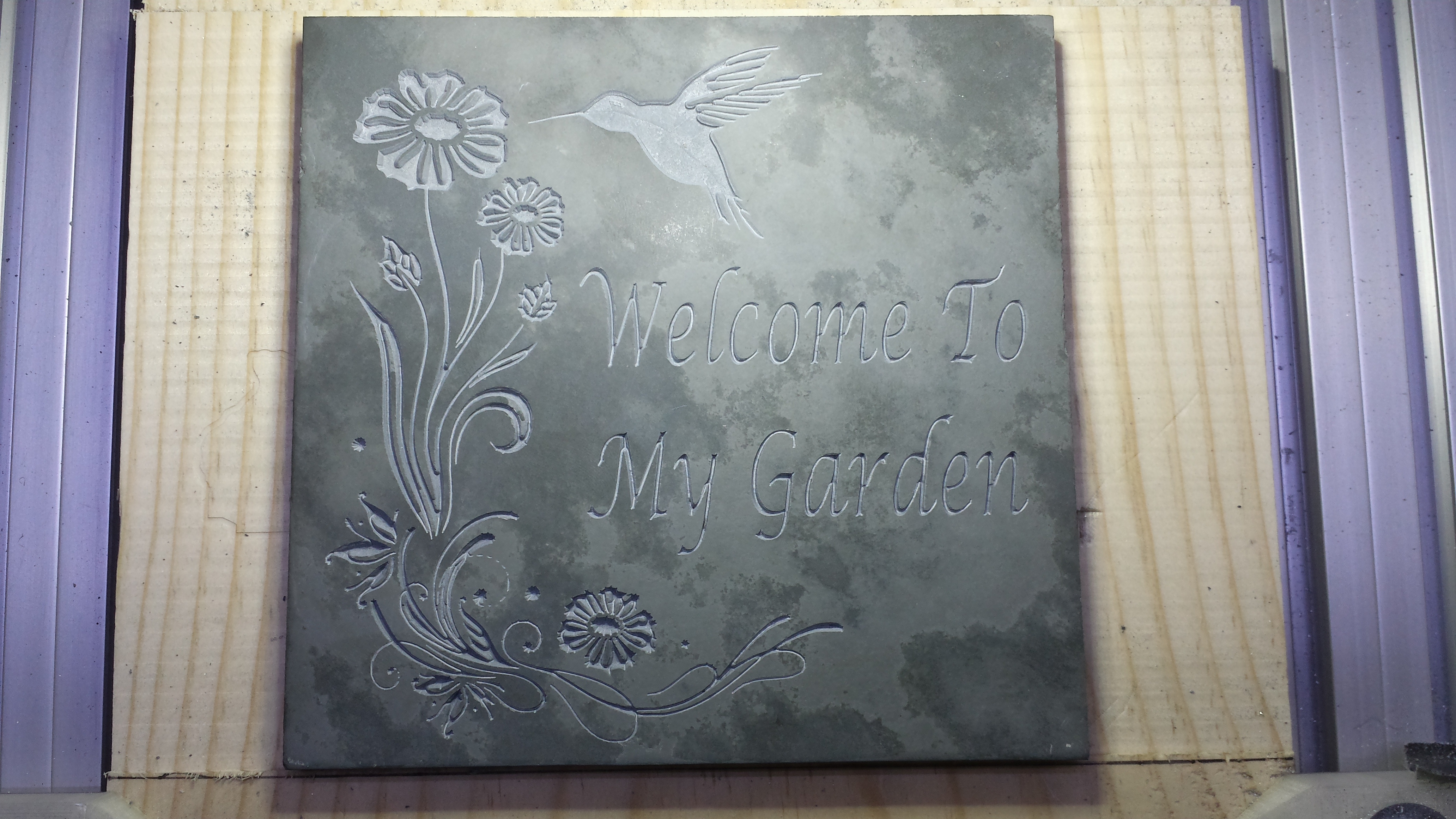

This is Spanish green slate milled with the same 30 degree .2mm tip bit. Garden sign for my sister's humming bird garden.
It is cut about .5mm into the stone. total cycle time on this whole 6x6 sign is about 7 hours give or take.

I use http://www.ebay.com/itm/381043625814?_t ... EBIDX%3AIT" onclick="window.open(this.href);return false; for my aluminum most of the time unless I need something smaller... Of course I tried another bit on the stock SEEMECNC mount I used in the tumbler shots and as you can see it was not near as good of bit.
I run the endmill above at about 100mm M taking a .1mm cut each time.. I tired the new endmill at 65mm M and tried to cut it at .25 and it chattered on me as the pics showed.

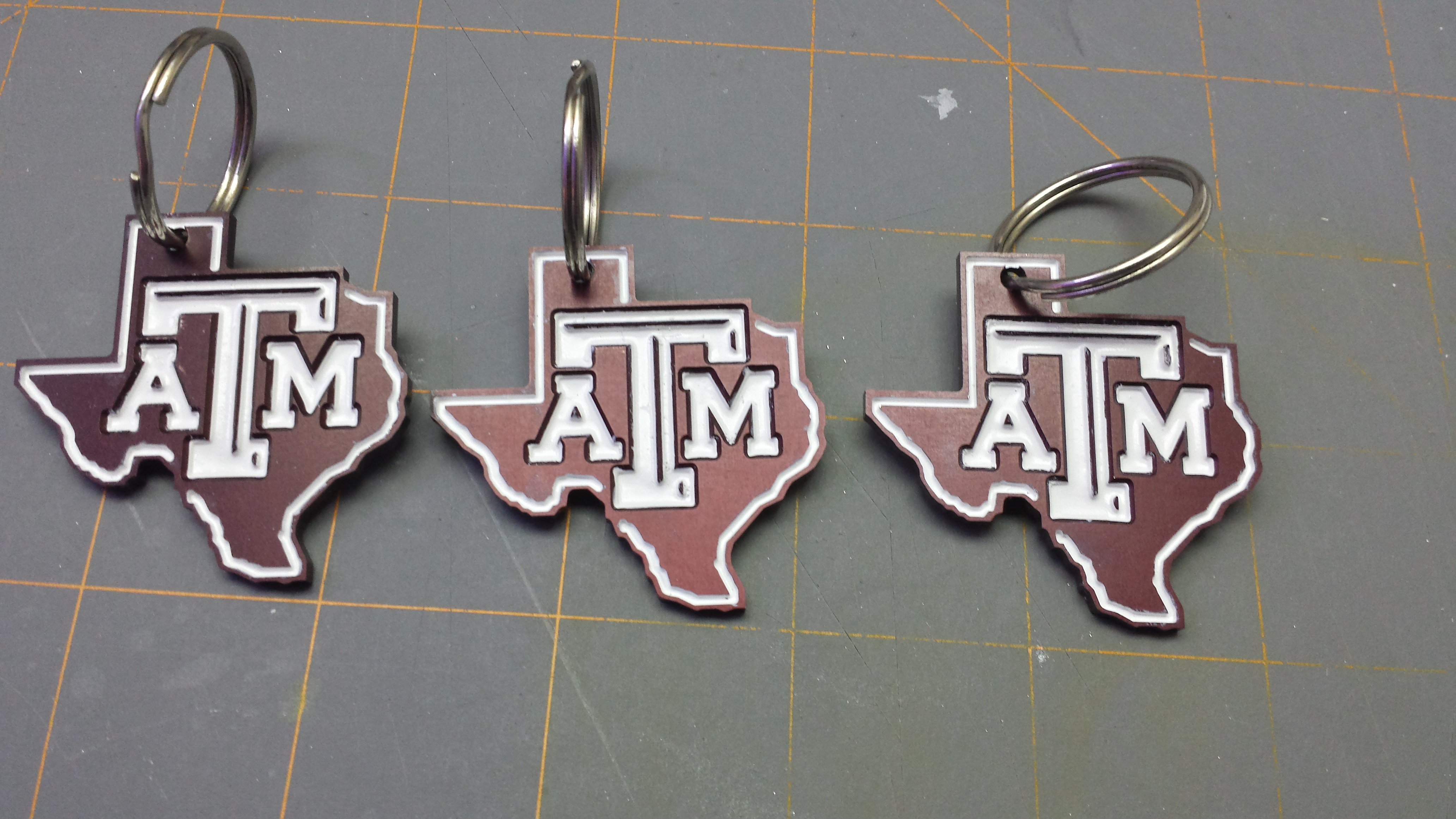

I did this with a .80mm endmill from drillbitsunlimited
Then anodized it and filled in the mill work for a contrasting color. Custom blending the Aggie maroon anodizing dye was interesting to say the least. This was a one off gift and NOT SOLD so I THINK I am OK with not being hunted down by the Aggies!

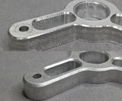

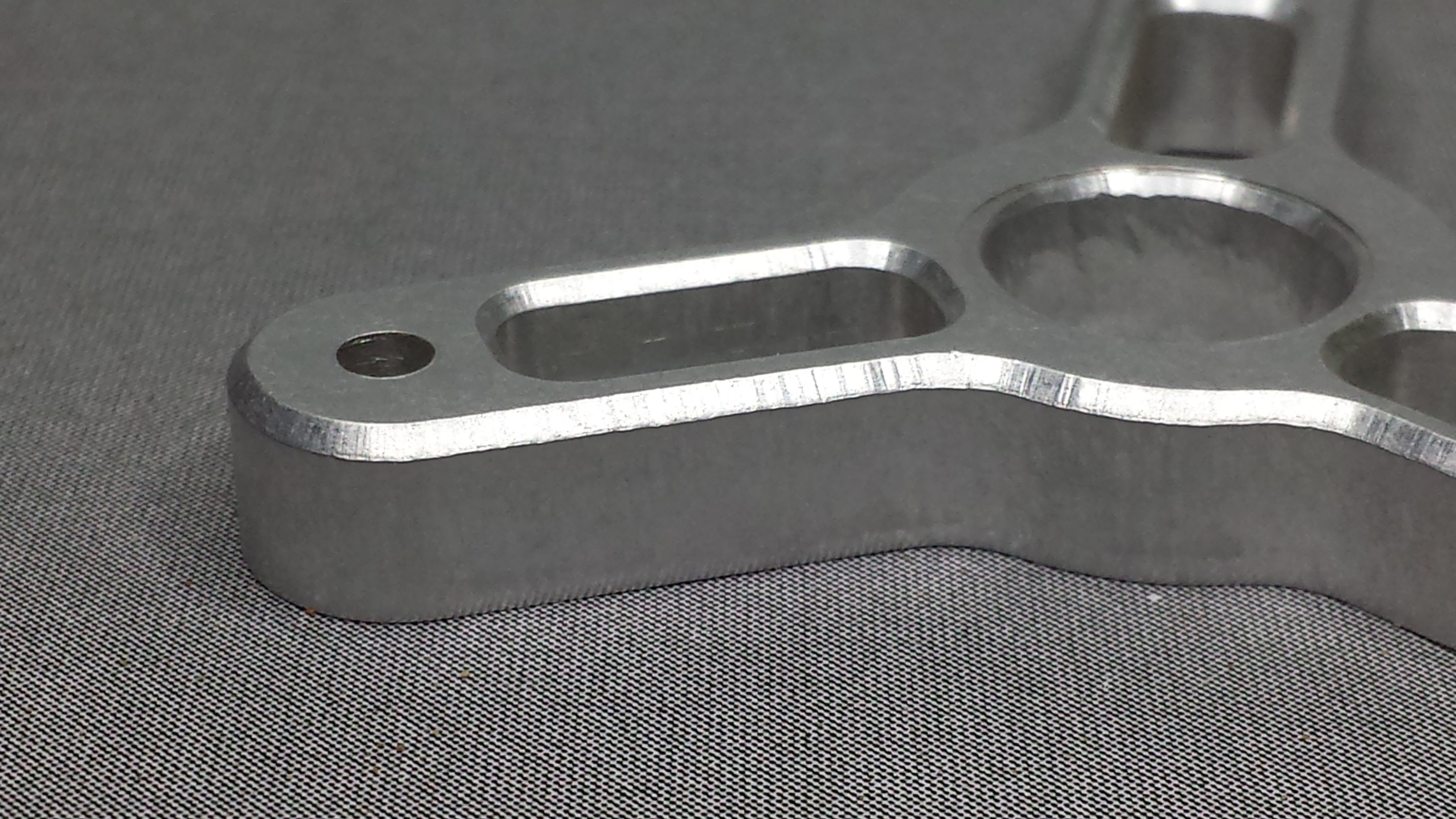

So I let the parts run for two more hours in the walnut media and then snapped a pic before I ran out the door to catch my flight. I will repost the before/after shot from before so it is easier to compare here.
This is before and after one wet and one dry stage. This piece was rush cut and the mill chattered so tooling marks were heavy to start
This is after one wet and two different dry media stages. About 6 hours total between the three.
I think a longer wet stage and maybe a tad longer walnut stage would give the part a very good finish with little to no hand work needed in the process. Moving forward this will be the finishing process of choice on the mounts.

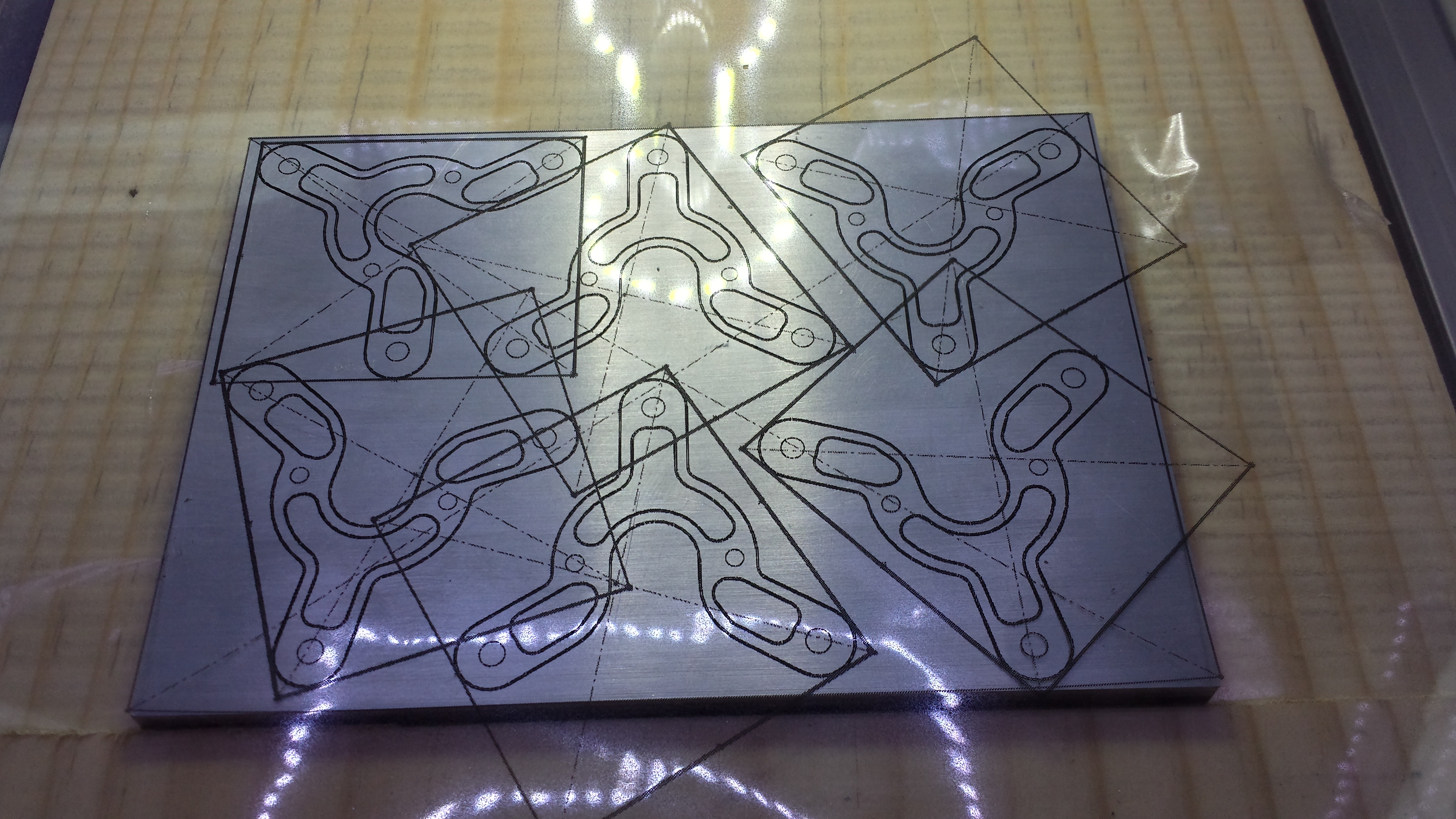

Today I am working on getting the BETA tester mounts milled and I hope, into the tumbler tonight. If all goes well I will anodize them sometime late tomorrow and try to get them in the mail by Thursday before I fly our for my weekend shoots. I spoke with E3d today over in the UK and I will be picking up a few V6 heatsinks without the brass bowden fitting inserted to see how well they anodize also. Once they are anodized I will press the fitting in place (I hope) I personally like the idea of anodizing my volcano a nice red or deep orange just for the kicks of it. It will be a week or more for that result though as shipping will take a bit since I did not choose the fastest option they had as there was no rush.
getting the BETA tester mounts ready to mill out of 6mm 6061
