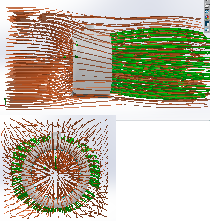

Presently working on optimizing the 3D model for the bladeless fan. Some CFD shots will be printed in coming weekend.

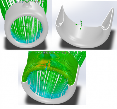

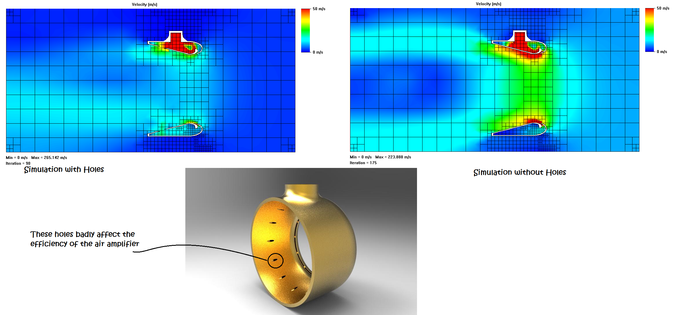

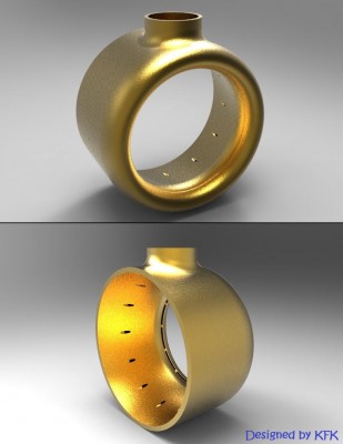

Added 3mm tangential holes to see the flow affect.The CFD in progress ..
Khalid Khattak
Posts: 276
Re: Air-Amplifier
Post by Khalid Khattak »
CFD reveals the holes worsen the flow pattern.

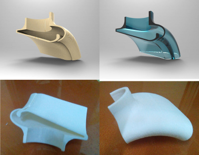

Thanks, Due to intricacy in the geometry i have to split the air duct in 6 pieces. The first piece has been printed.

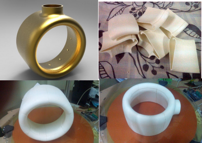

somehow managed to assemble all the six pieces of the duct.

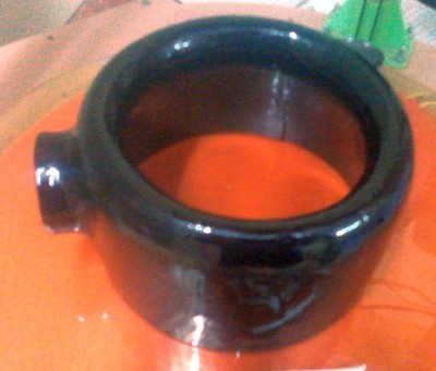

Here is a little updates on the blade-less fan duct after primer application, lot of wet-sanding and finally spray paint. Check the glossiness... It just look out of injection molding machine.

off-course smoke test as well as "Sewing Threads" hanging near the suction shall be tested to see the efficiency of the system. Presently designing 3D part for 40mm x 40mm x28mm computer fan duct attachment. Yesterday i just tested it with tap water to see the pattern of flow at the trailing edge which resembles with the results obtained from CFD.
