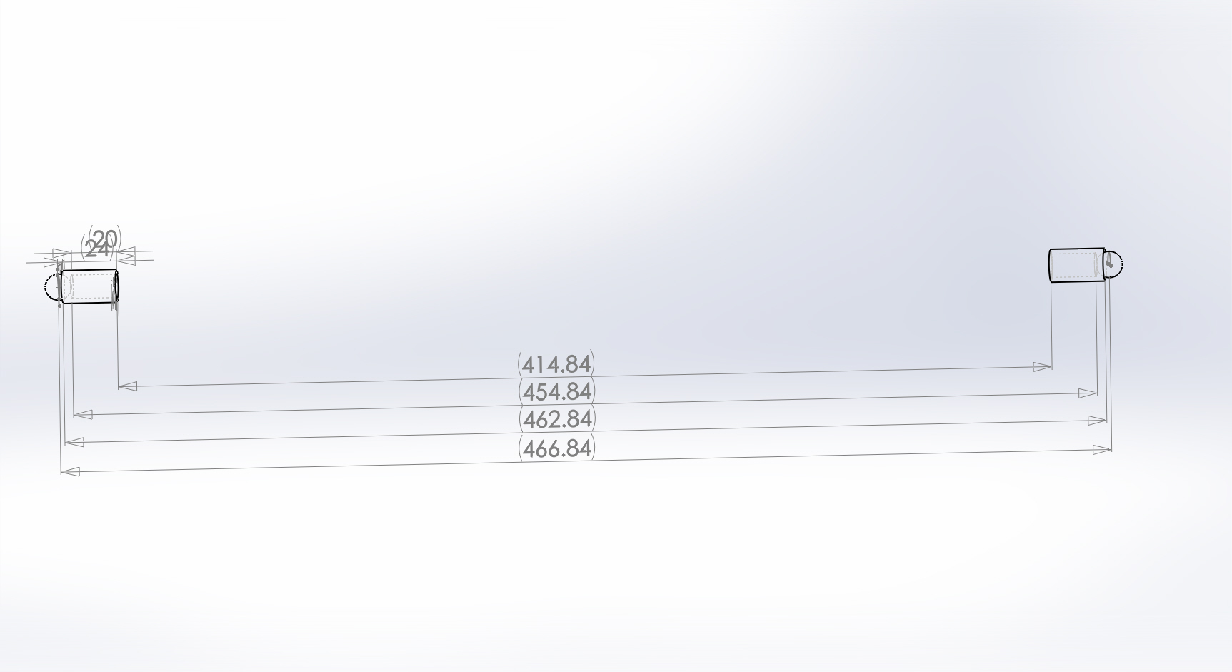

[img]https://lh3.googleusercontent.com/-MdQB ... 212809.jpg[/img]
So for determining arm length, should i be aiming for a angle when the nozzle is on the edge of the print radius? i noticed the max is almost horizontal at the edge.
Re: man sized
I believe the optimal length is an angle of 60 degrees from the horizontal with the effector in the middle of the platform.
Re: man sized
I'm designing my own sooper-kossel right now, and when I get to arm length, I'm going to try out somewhere between 5 and 15 degrees from horizontal at the point opposite each tower at max radius.

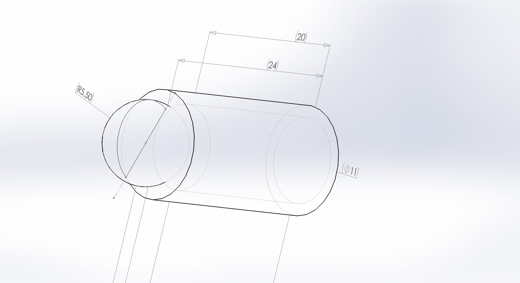

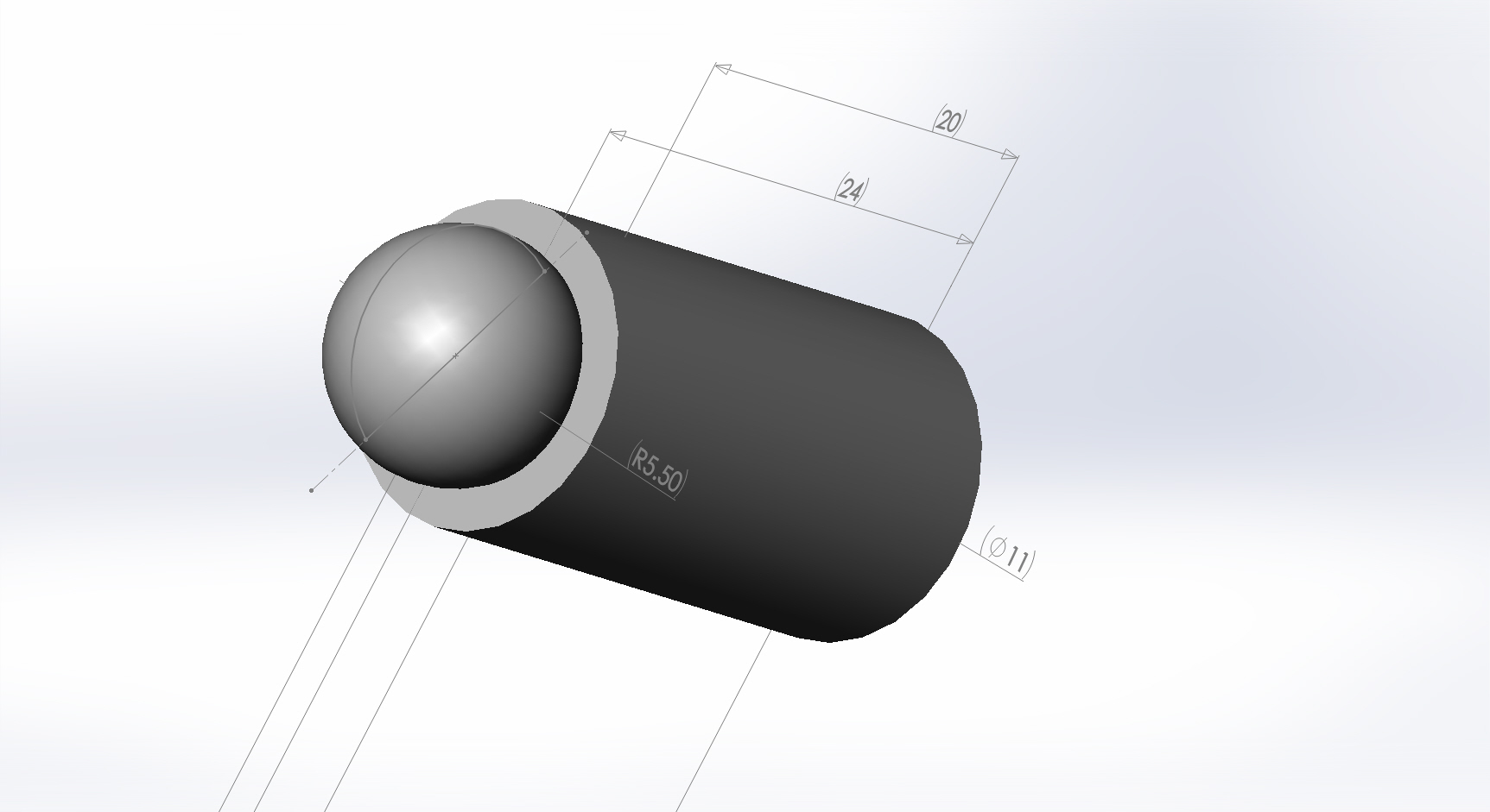

here are my rod arm lengths used with traxxas mag ends
3/8 x 3/8 n52 cylinder mags
Re: man sized
Which STL did you use to print the Rod Ends?bubbasnow wrote:here are my rod arm lengths used with traxxas mag ends
Which slicer did you use?
Aren't I nosy?
