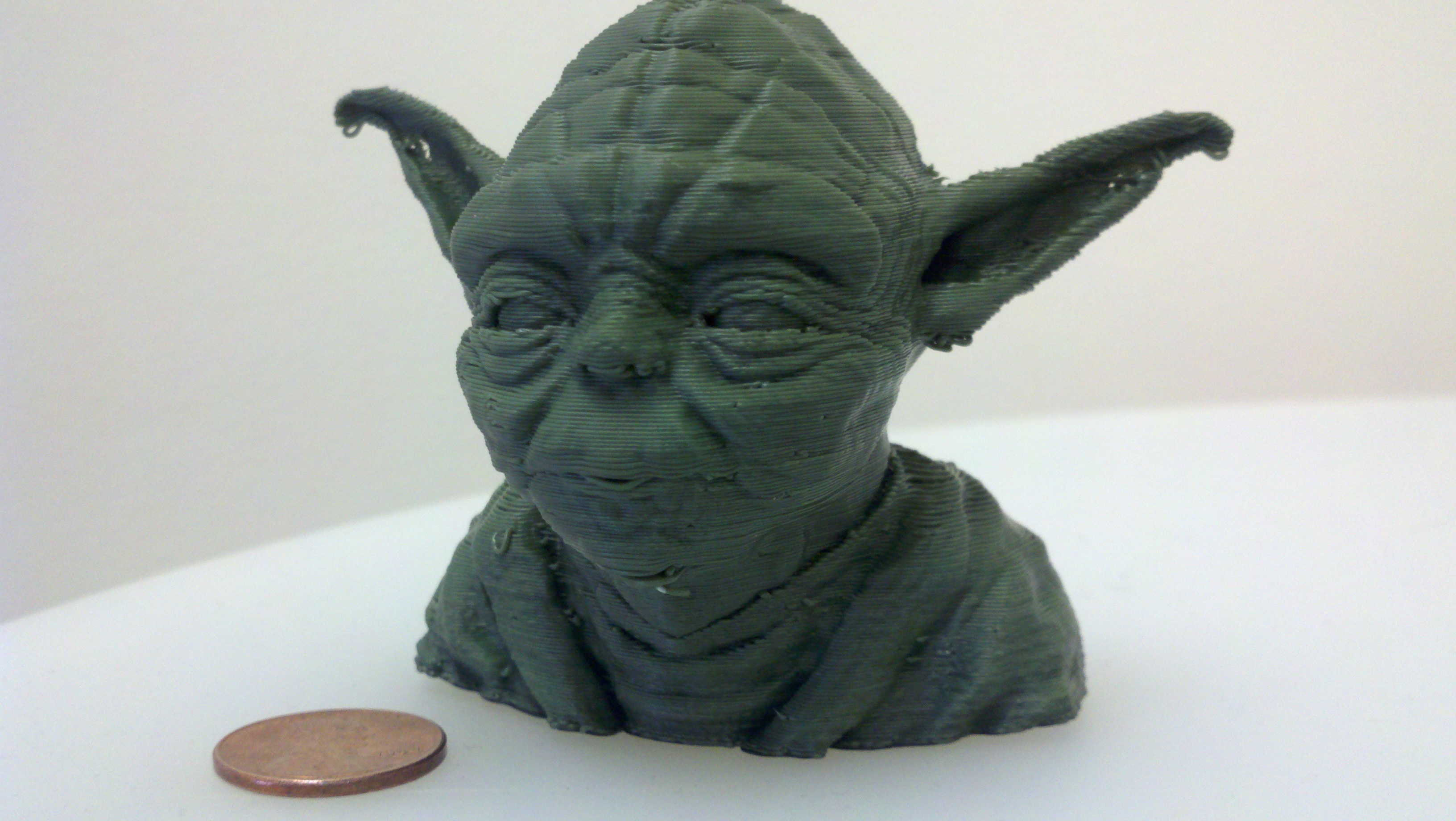

Printed surprisingly well considering some of the overhangs, when you watch it print it's clear that support would be nice and at least some infill would correct some of the flaws.
I couldn't get Slic3r's support for this model to stick to the table, it's so small, and skeinforge generated extremely odd infill, so I printed it without.

That looks really good for no infill. I may try that on my next large print to see how it goes.

The only places that really suffer for lak of infill are the very top of the head, and the top of the shoulders, and the inside of the ears, but I was stunned how well it came out considering
He even has nostrils, and without the infill it was a relatively "fast" print.
Certainly the biggest thing by volume I've printed.

What flaws? for no support of infill that looks fantastic.

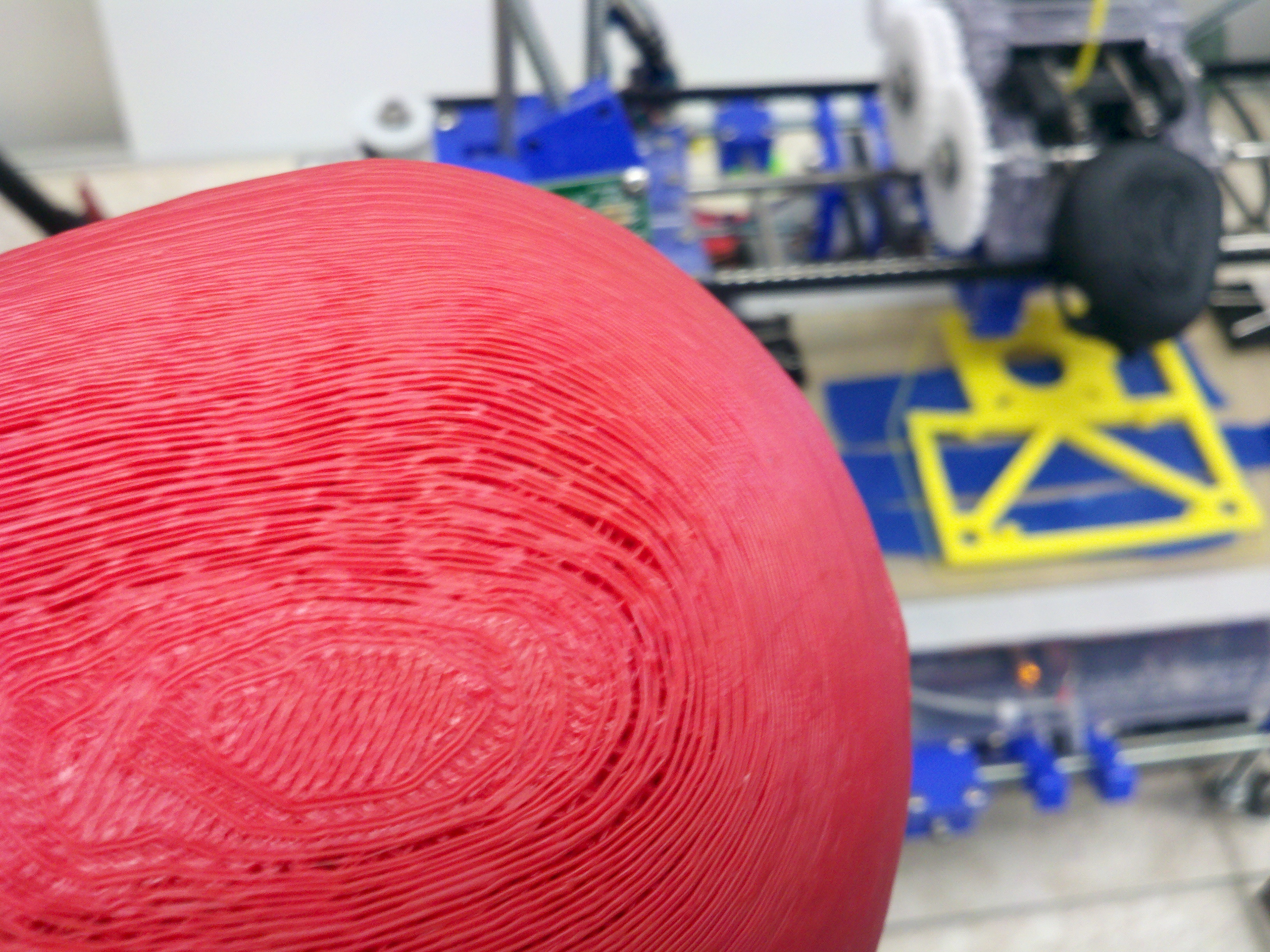

Don't get me wrong. This is a good looking print. Better than I can do! Perhaps you can post your Slic3r settings? (step z, speed, etc)
Basically what I'm talking about is how the step over becomes too great as the angle gets shallower. Then gaps begin to appear. If the program detected a threshold angle, it could adjust step up and step over so no gaps appear. I think this limiting angle (or whatever you want to call it) would allow a more perfect print the first time.
Maybe you guys can give me some advice on my Slic3r settings. Look at this Skull picture from the top. As the Z continued to step up, and the part surface angle got shallow, the step over becomes too much.

About all you do AFAIK in Slic3r is increase the number of perimeters.
Skeinforge has a bit more control, but I don't pretend to understand the majority of Skeinforge settings
Re: Yoda - because I can
Right.
That skull looks like about two perimeters. Maybe 4 or 5 would get better results as would changing the layer height to be smaller.
Lee
Yes, the number of settings are impressive. And mind boggling. However, it's nice to have the control when you want it.
I picture a setting like the Z step for the X Y. Maximum XY step over. That's fairly simple, just don't ask me to write the algorithm.
In the mean time, I'll continue to add perimeters. I don't think I've done 4 yet.

OK. Tomorrow, I'll print the skull again from the shop live. I'll bump up to 4 perimeters on the skull, add support, and lower my infill.

I printed a horizontal half cylinder 40mm dia 40mm long with a 20mm hole in it. Slic3r .25mm layer 3 perimeters . I had the same problem with gaps as the angle reduced at the top of the hole and at the top of the print. I agree it would be great if we could set Slic3r so it reduces the step over as it reaches the top of the part.

There are several recent bug fixes that may at least partially address this:
https://github.com/alexrj/Slic3r/commit ... 23d408bd13 (some nearly-thin walls were discarded.)
https://github.com/alexrj/Slic3r/commit ... 019daaa7b4 (New automatic detection of additional required perimeters for better quality with domes and sloping walls.)
https://github.com/alexrj/Slic3r/commit ... 14cd8317fe (Fixed regression causing poor adhesion of rectilinear infill to perimeters)
Except for regex I not much of a hand at Perl ( http://xkcd.com/224/ ) so I won't try to do a code trace; and I'm still not printing (no working controller, and waiting for a Printrboard to drive) so I can't test myself.
These fixes are all after 0.7.2b, so you'll either have to build it yourself to test it or with for the next release of an installation package.

I did look at some of the Slic3r code and he does have some concept of angle between layers, so limiting the step over should be possible, though it would likely have to be a complete pass over the sliced model. You should file it as a feature request on the github page.

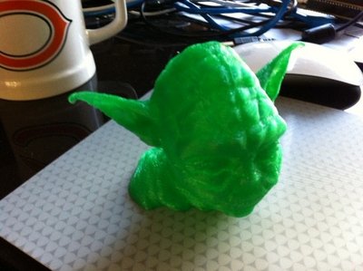

Because I was supposed to post a Yoda here...
