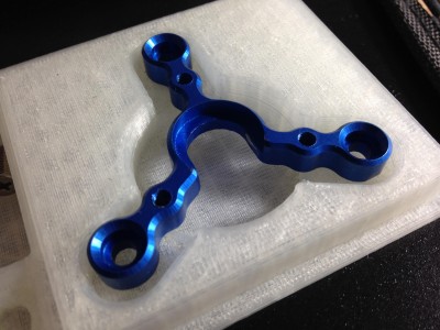

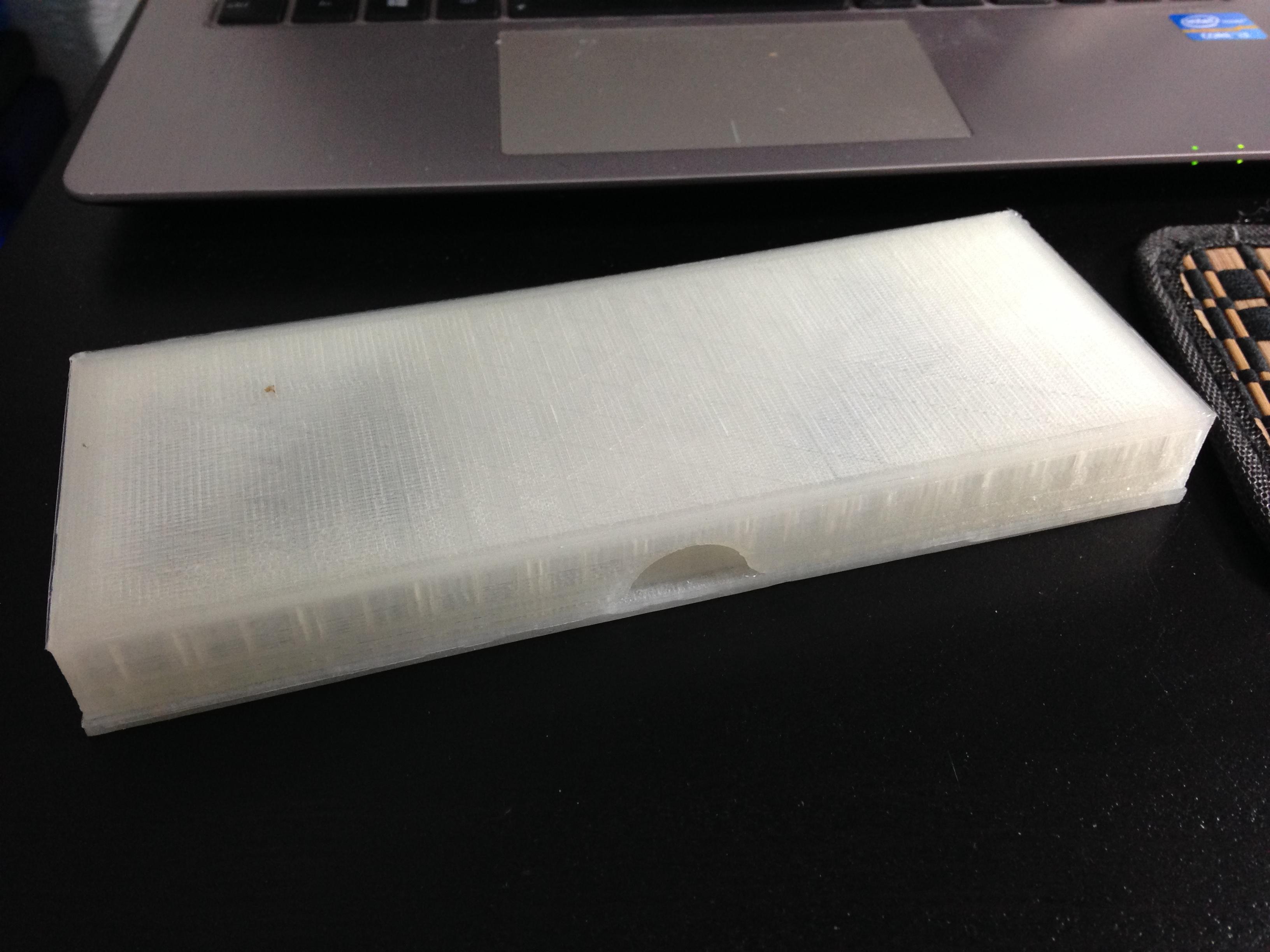

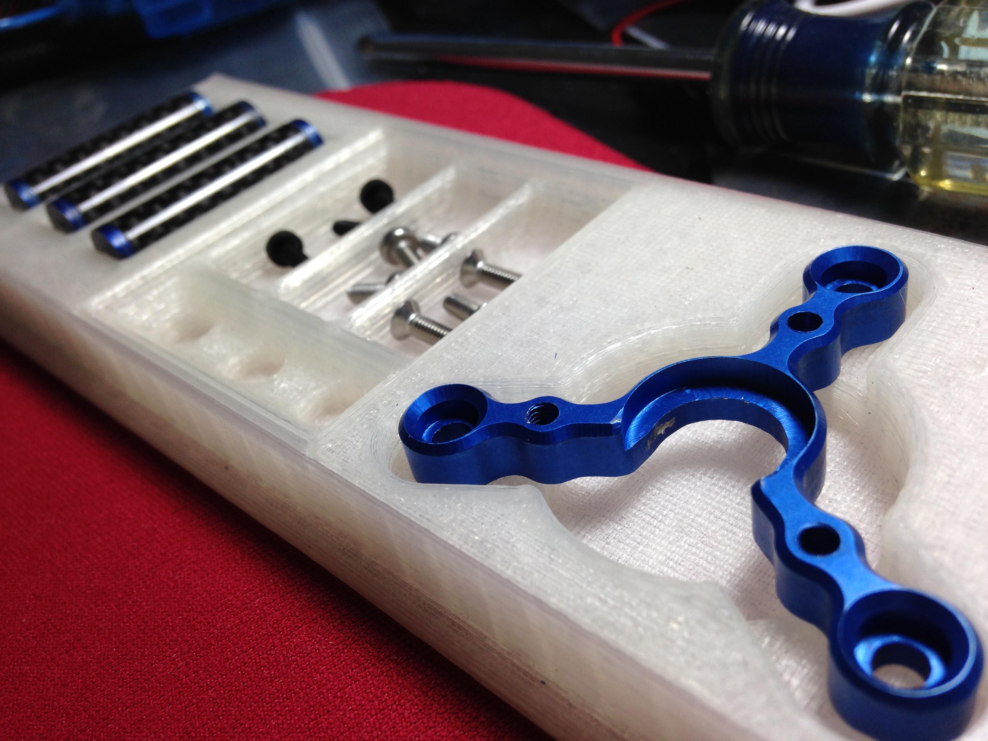

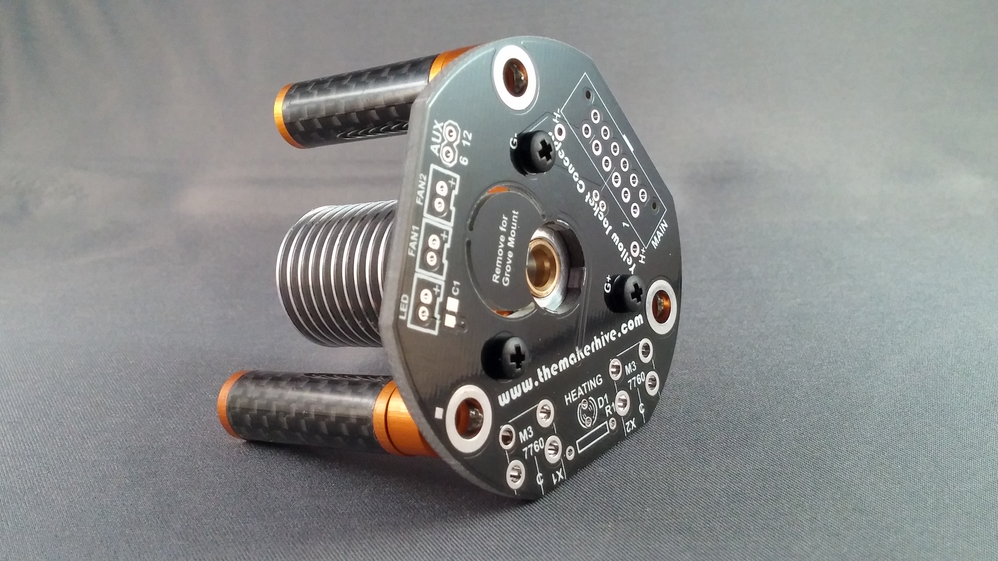

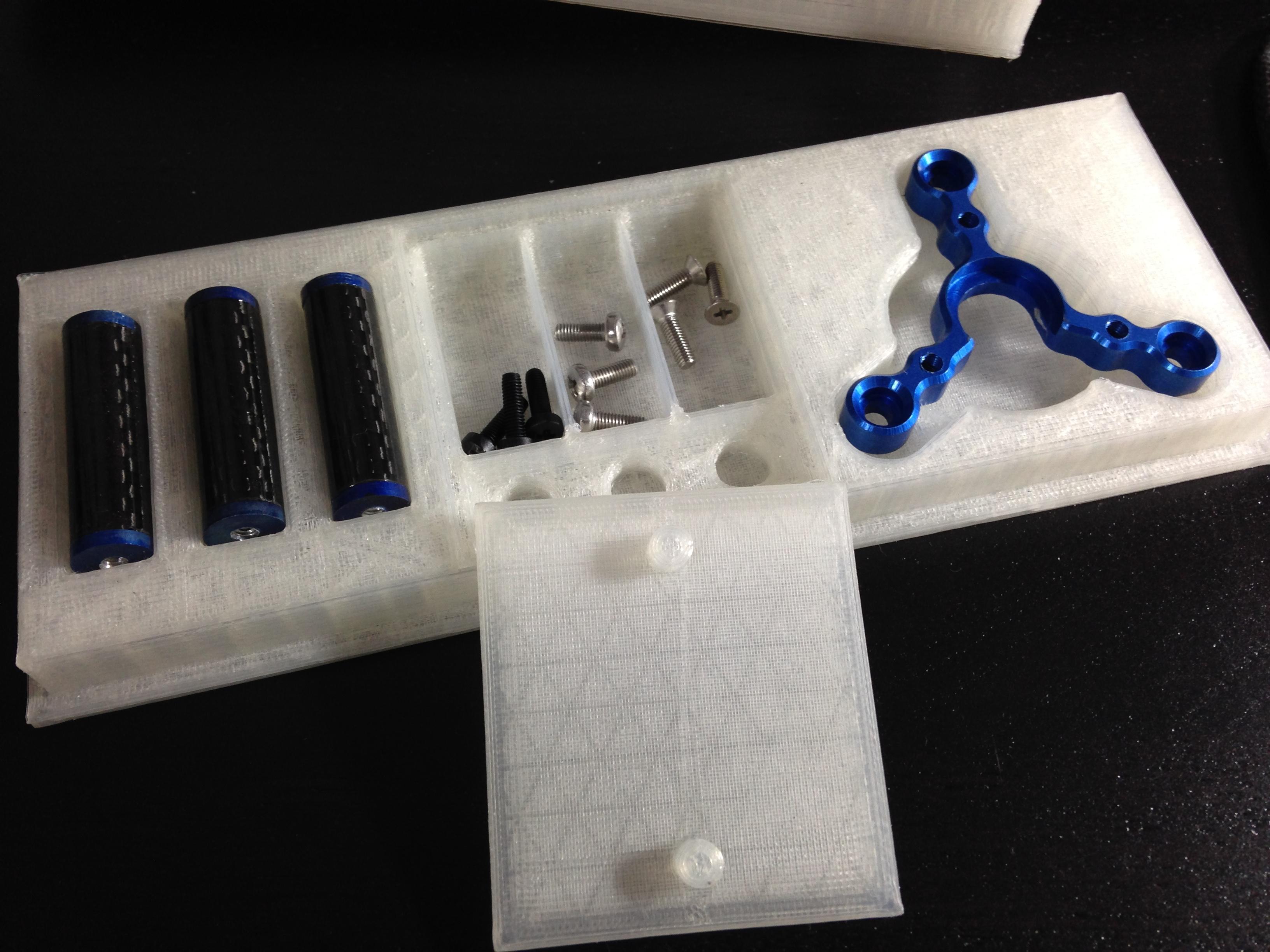

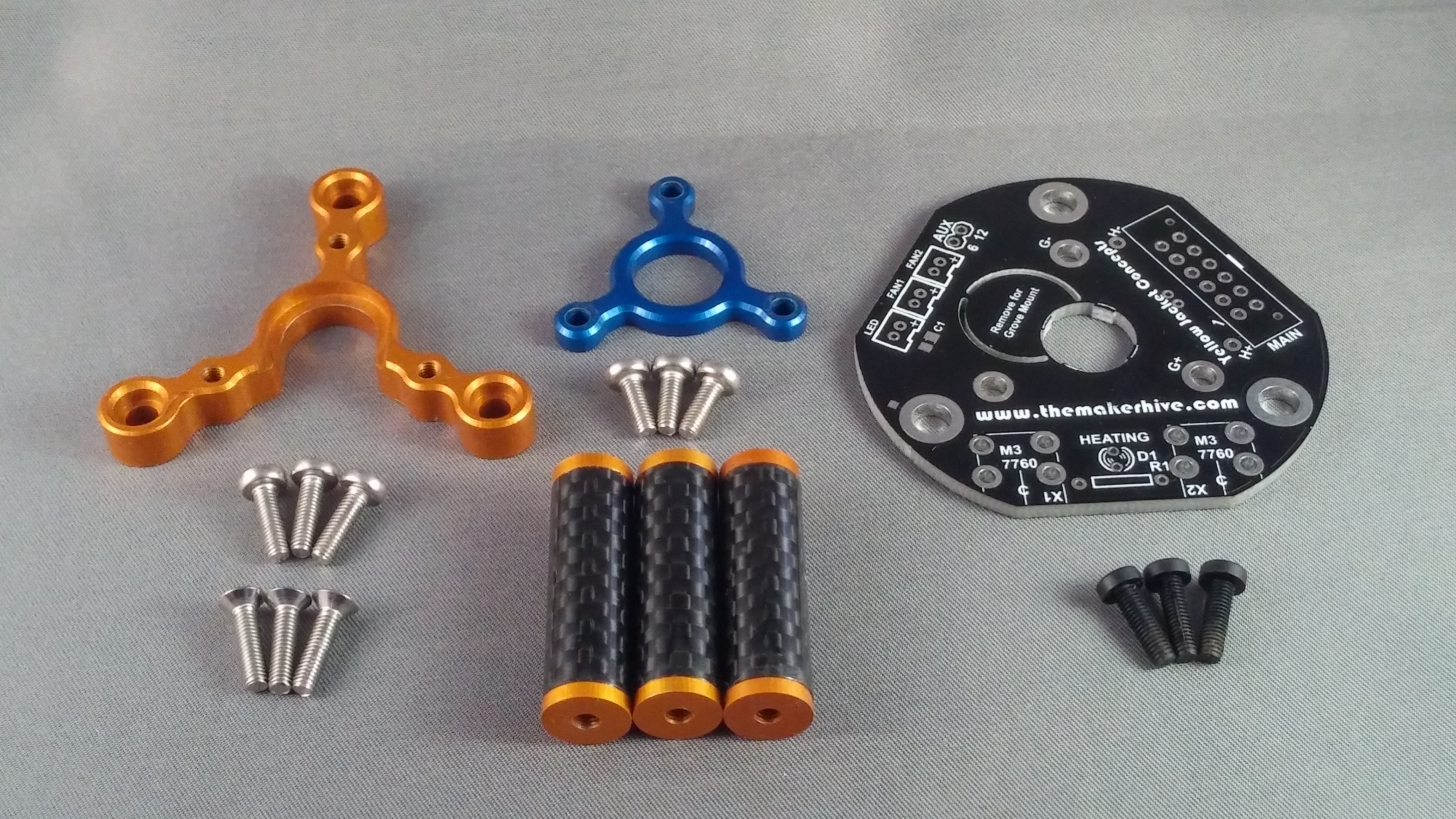

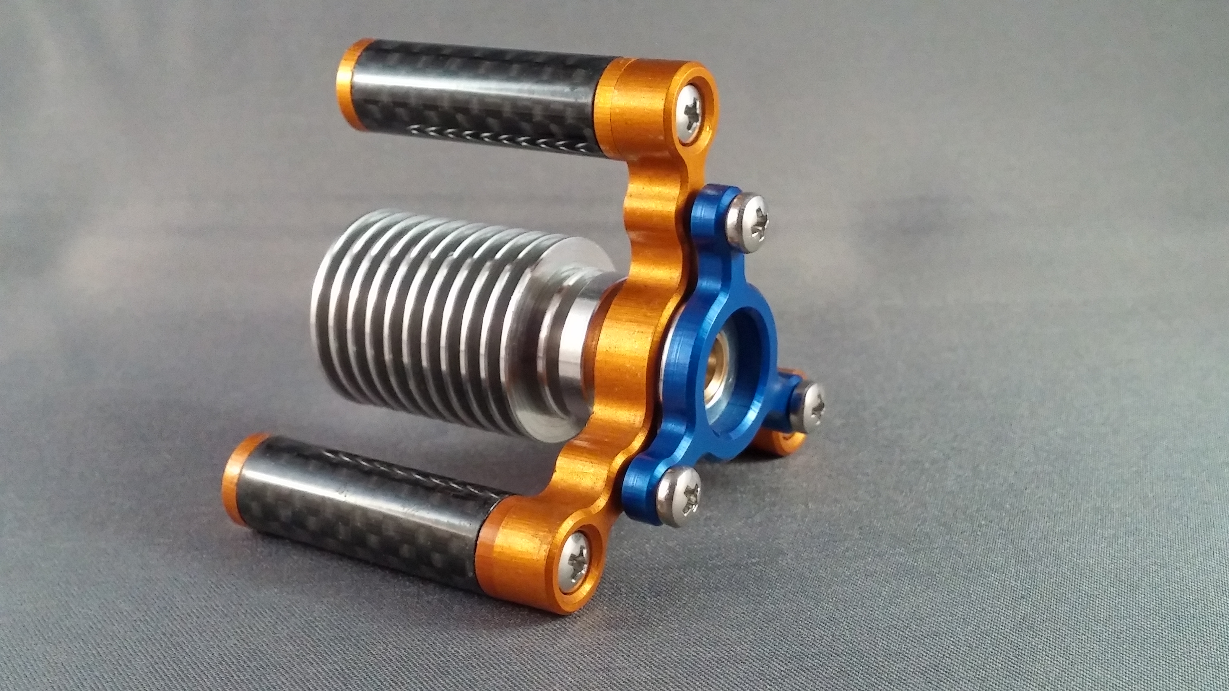

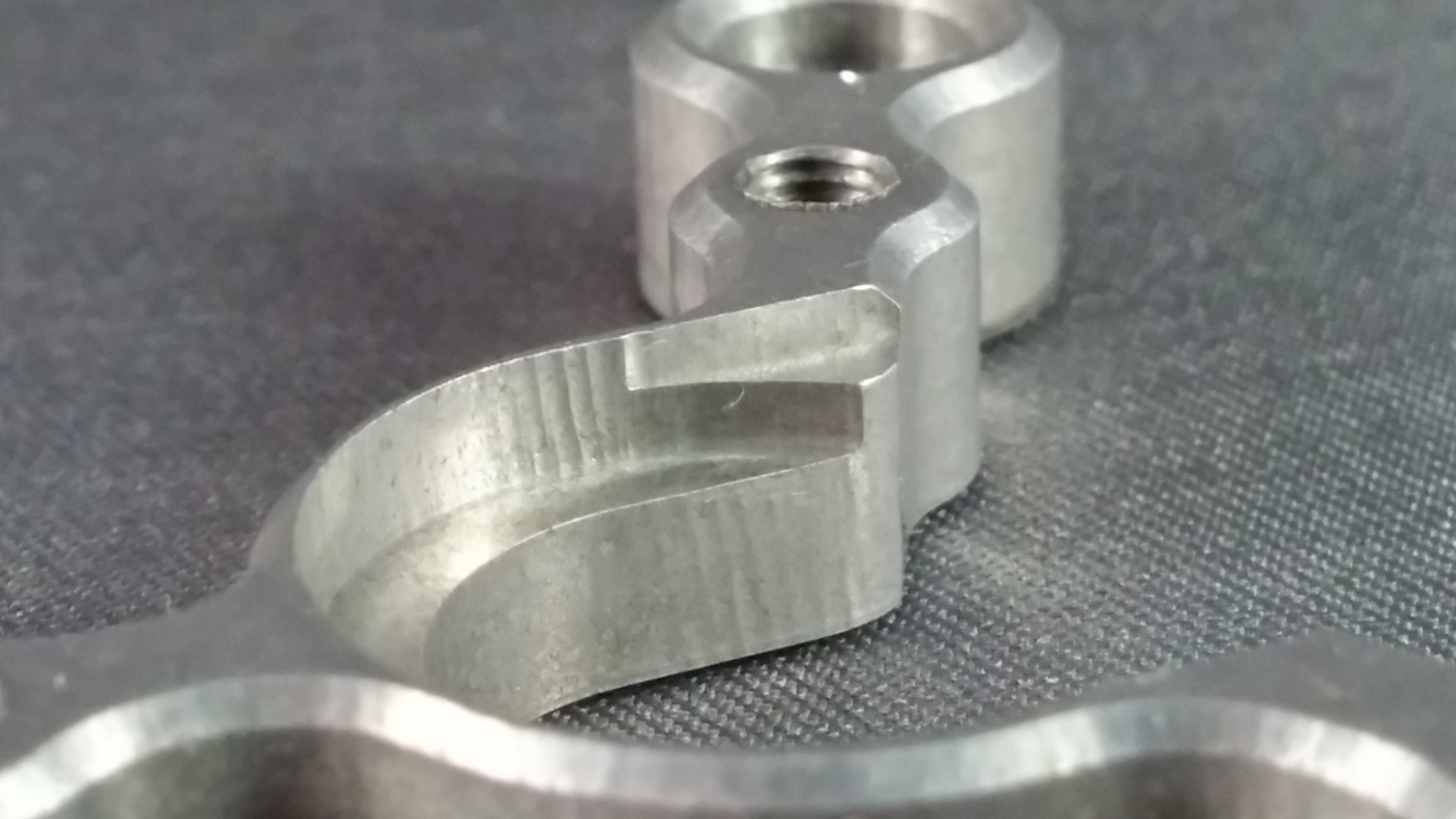

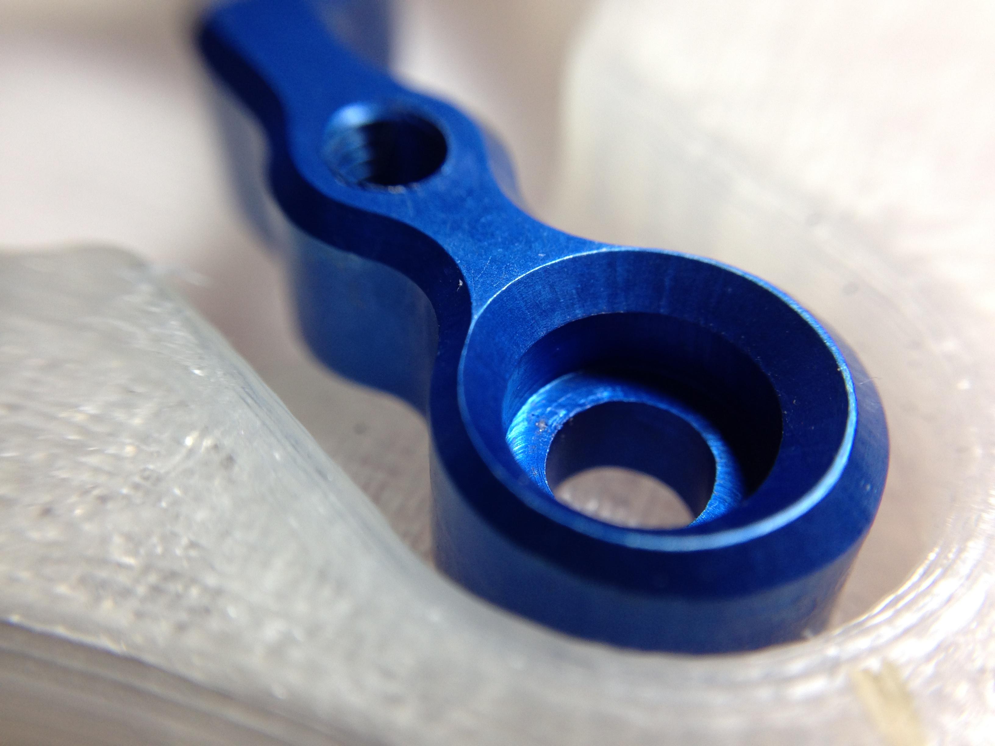

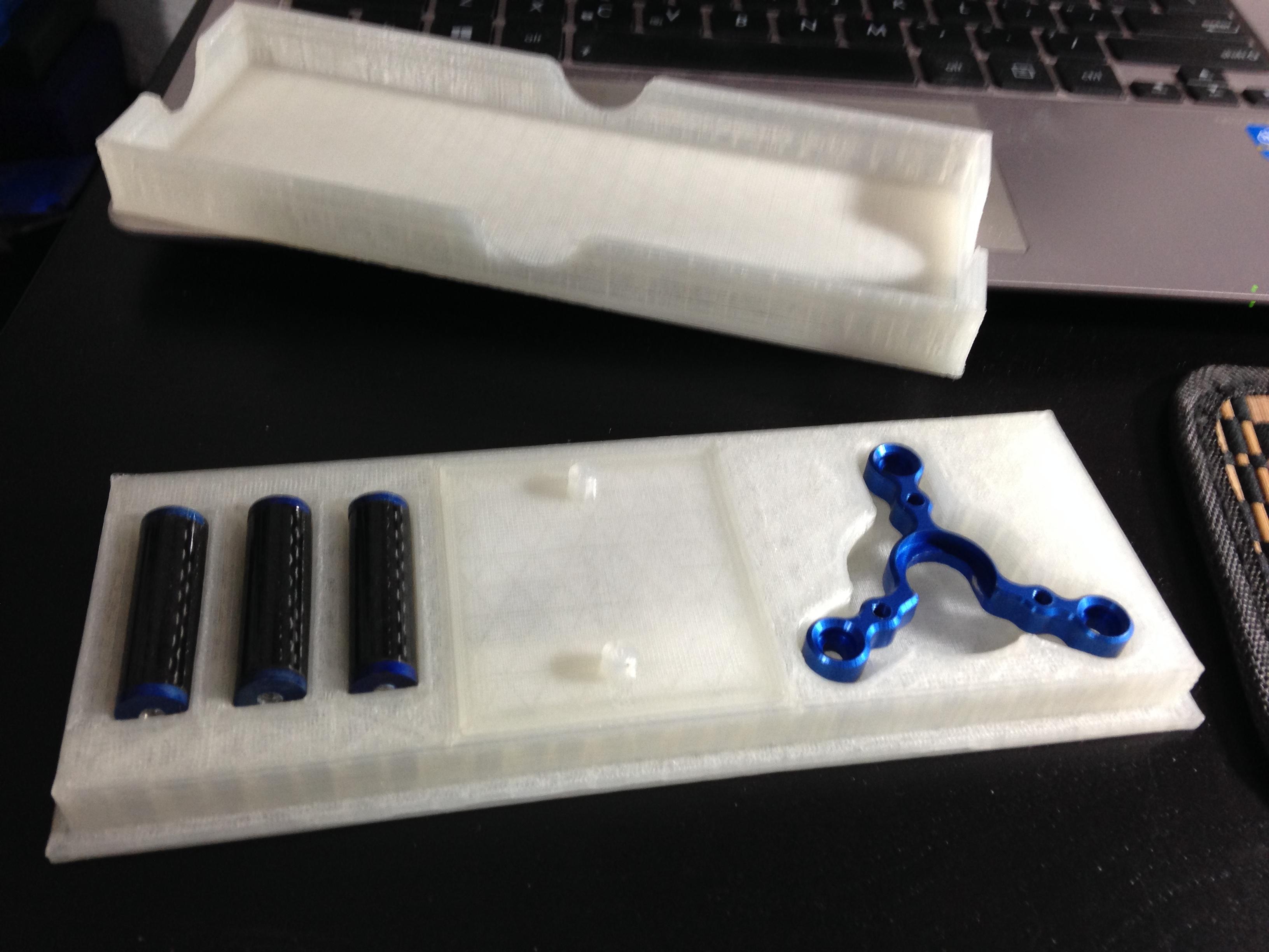

I received the first production prototype today, and wow! These are expertly made, very sharp, and the presentation in the box is awesome!
[img]http://i.imgur.com/NeI31tV.jpg[/img]
[img]http://i.imgur.com/a9QWfpI.jpg[/img]
[img]http://i.imgur.com/JMqY3YT.jpg[/img]
[img]http://i.imgur.com/cdODEHz.jpg[/img]
[img]http://i.imgur.com/JiA3TXY.jpg[/img]
[img]http://i.imgur.com/iUWyNkN.jpg[/img]
[img]http://i.imgur.com/BhOR9mv.jpg[/img]
[img]http://i.imgur.com/Omlw3S0.jpg[/img]
The plan is to do the install at The MakerHive on Thursday. I'll have some more pictures then, as well as a report of how everything fits and installs. Stay tuned!
I'm impressed with how well the ShapeOko did, I'm definitely going to have to start playing with mine more!

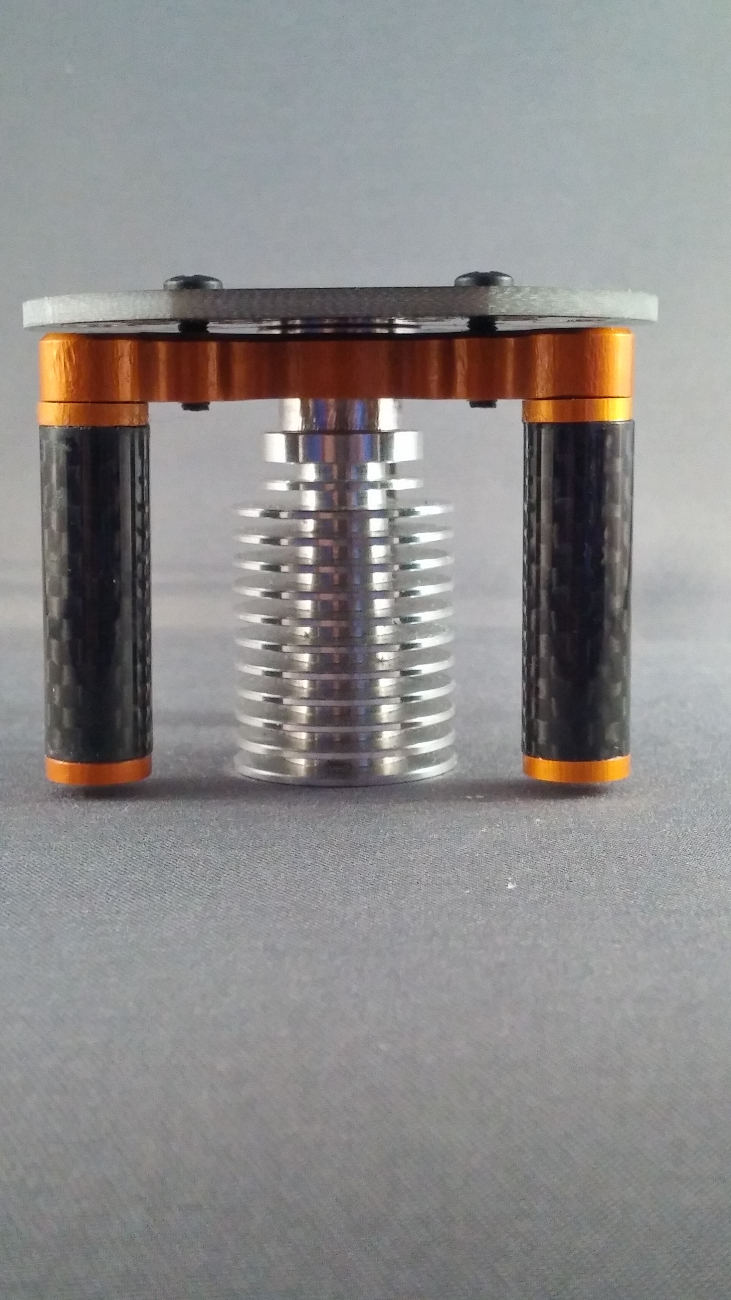

Hey Everyone,
I am back home for a few days and working hard on the mill to get some of the last test mounts out the door and also to make corrections from the first beta tester worked into the tool paths. I am only home for a few days again this week but I plan to mill as much as I can while I am home. The new custom CNC mill is just about ready to be ordered. It will take a week or so to get it made and then about another one to get it installed and dialed in. After that I hope to catch up much faster as my cycle times should be greatly reduced so I can make better use of my limited time at home each week for milling. I also added a few new colors to the anodize selection to now include Gray ,Green, Copper, Bronze and another shade of Yellow. We already had bare aluminum, Bright Red, Orange, Deep Red, Black, Yellow (touch of green to it) and Sapphire Blue.
I also got in the first shipment of carbon fiber sheet for the carbon fiber mount I was working on. Once I get caught up with everything here I will start working on it. I am not sure it will work with the YJ as it is more designed to reduce weight as much as I can and also to appeal to the CF lovers out there like me.
To be realistic I will remain a bit behind while I am awaiting the new mill to step into production. The cycle time for each mount alone (not including spacers or lock ring and anodizing) is over 26hrs if all goes well. I am still running the Shapeoko 24/7 while home, but the new mill will reduce the cycle time to about 6hrs or less which will really help me to get caught up with everyone. I thank every for their interest in the mount and I hope everyone knows I am working hard to get caught up and have mounts ready for order shortly.

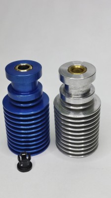

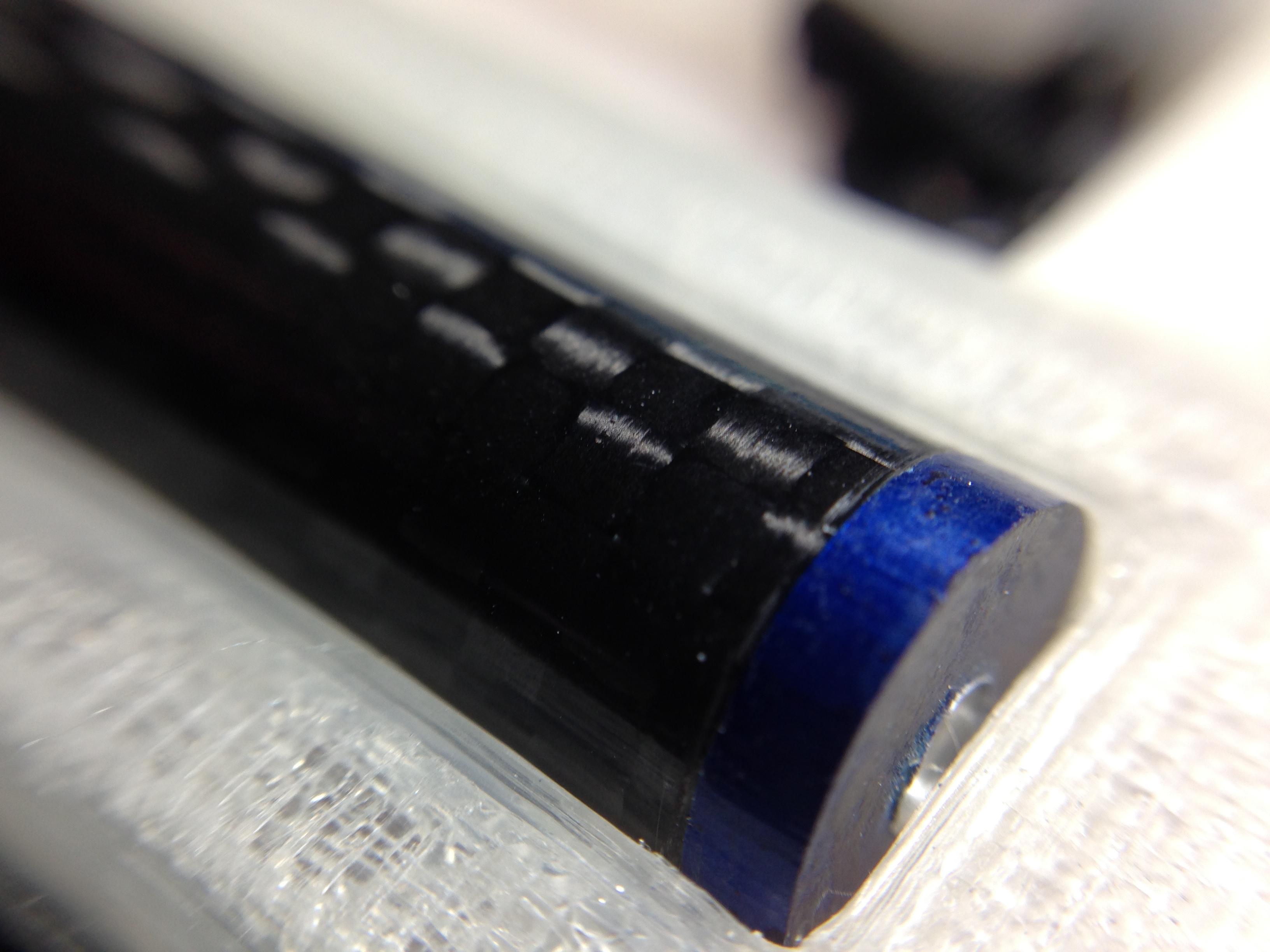

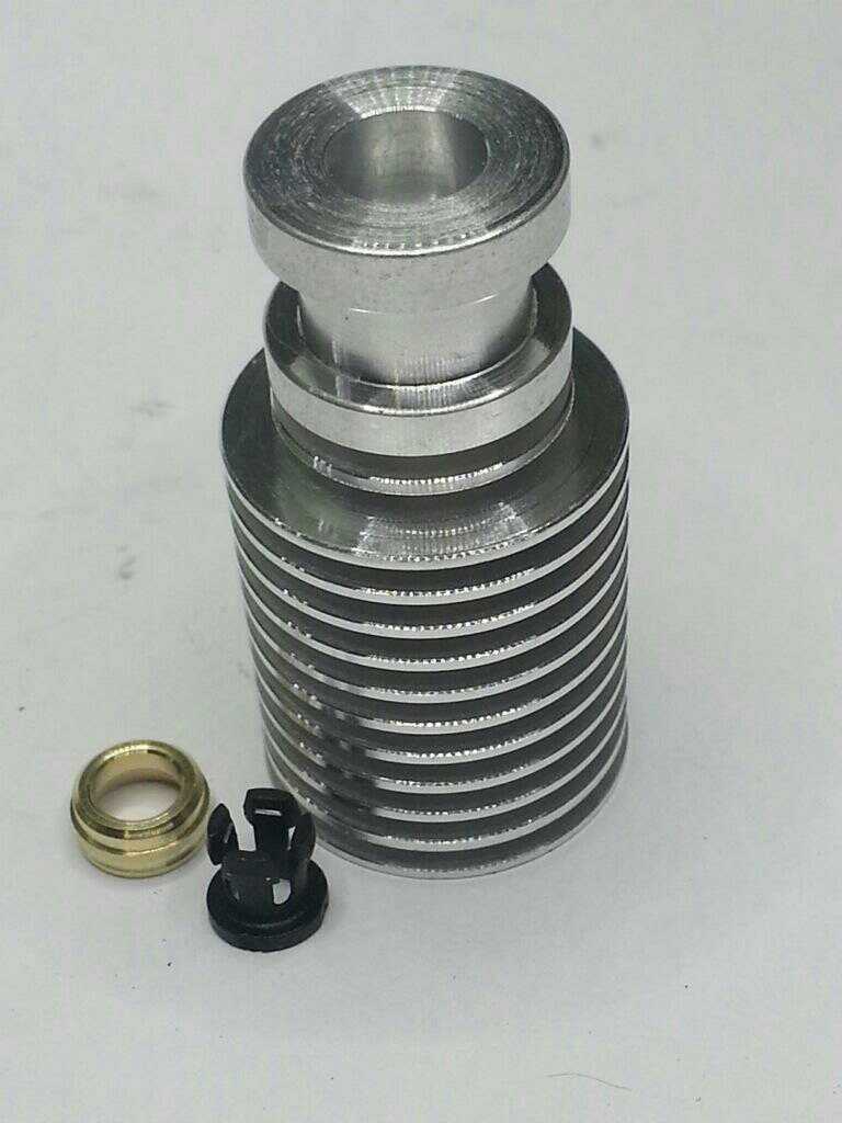

The new E3D V6 heatsink arrived today for the anodizing test. Should know early next week if it will anodize well or not. Looking forward to finding out and hoping for the best. Kills me to be across the country for work and know that this is waiting for me to test back home.
- Posts: 2631
I hope these look as amazing as I think they will!
Tell us more about your new anodizing deal. Can you make these in chrome or clear yet?
- Posts: 398
Jimustanguitar wrote:I hope these look as amazing as I think they will!

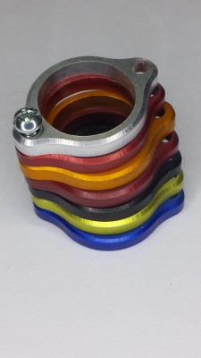

Man you are fast! The ink on that deal has hardly dried yet! Well the cat is out of the bag so might as well talk about it. Anodize dyes are hard to find in small patches. Most places want you to buy a large amount of dye or not even call them. For the larger shops this is fine and saves them a good deal of money to buy in bulk. But for the smaller shops or the hobbiest this just does not work well. Caswell does ofer smaller sizes (roughly 2 gallon tank sized patches) but some of their dyes leave a bit to be desired. I personaly dislike their "black" as I find it to be more of an "eggplant purple" type black in sunlight and not a true coal black. So I set out to find a place to get smaller patch sized amounts of good anodize dyes. My search ended at anodizeworld.com which is a small shop out of Canada. He is in fact a maker of high end bike parts who anodizes his work in house much like I do my stuff. He dyes are from a US company, but again must be bought in bulk. So he repackages the dyes into smaller sizes for hobbiest and resales them. I have used his dye for over a year and never had a dye related issue. He ships pretty fast and does not charge an arm and leg for shipping ether. But there is the rub... Shipping to the USA is a pain and costs him more than he charges for shipping.
So he has approched me to keep stock on hand and full his USA orders. I will have pretty much the same range of items he does (more as time goes along) and I will fill all the USA orders and offer a flat rate shipping with tracking here in the USA. There is not many sources for these small patches of dye and we hope to offer a service that will allow more people to anodize thier work in their own shops of they choose. We are still working out all the details and it will be about 3 - 4 weeks before I have stock on hand. But the plan is to offer pretty much the same items he does but here in the USA to save on shipping cost and shipping times.
I am in hopes this will allow more folks to explore the world of anodizing and I think it might also allow a few makerspaces and such to approch anodizing without being stuck with huge amounts of dye just to get started or to knockk out a small project or two from time to time. By offering the needed supplies in smaller batches I think more folks will be able to enjoy the hobby with muuch lower upfront costs.
As far as your opther two questions about chrome and clear coating. I have not had a chance to look into any sort of plating tech yet for my work. I have been testing with some powder coating stuff for a client and so far things are going well. Their are "chrome" style powder coatings that might do what you want. But i would not think it would be wise on the heatsink. A plating might be OK but I am not set up yet for something like chrome plating. That being said, there is a plating place just down the street from me which I could check whit but I am sure they would want a good sized run to make it qworeeth their time. I think the clear coating falls into the same area of coatings, which is not something I think I want to mess with too much as I think it ight remove some of the cooling effect of the heatsinks. For now I am just going to be testing anodizing them and seeing how that works.

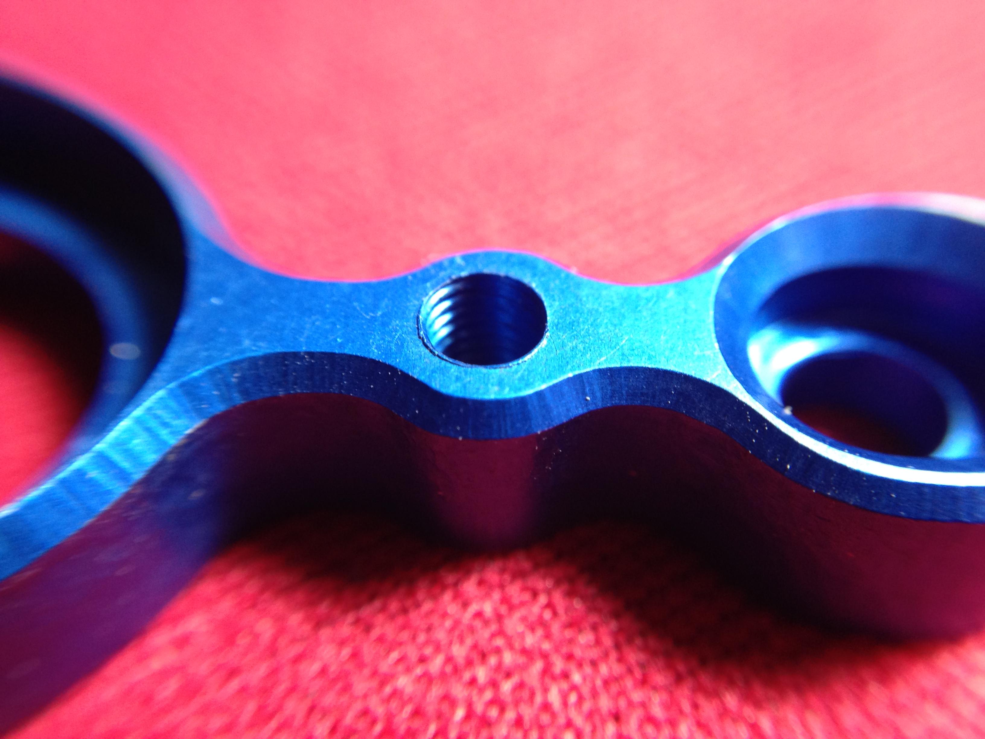

So the E3d V6 heatsink anodize test was a 100% success! I will be doing a few limited runs of these and heater blocks in the coming weeks. I also will be looking into the Chimera and Cyclops heatsinks and possibly heater blocks. BUT these must be new units as the brass fittings in the stock mounts can not be anodized. I source these direct from E3D without their brass fittings installed and install the fittings after I anodize.

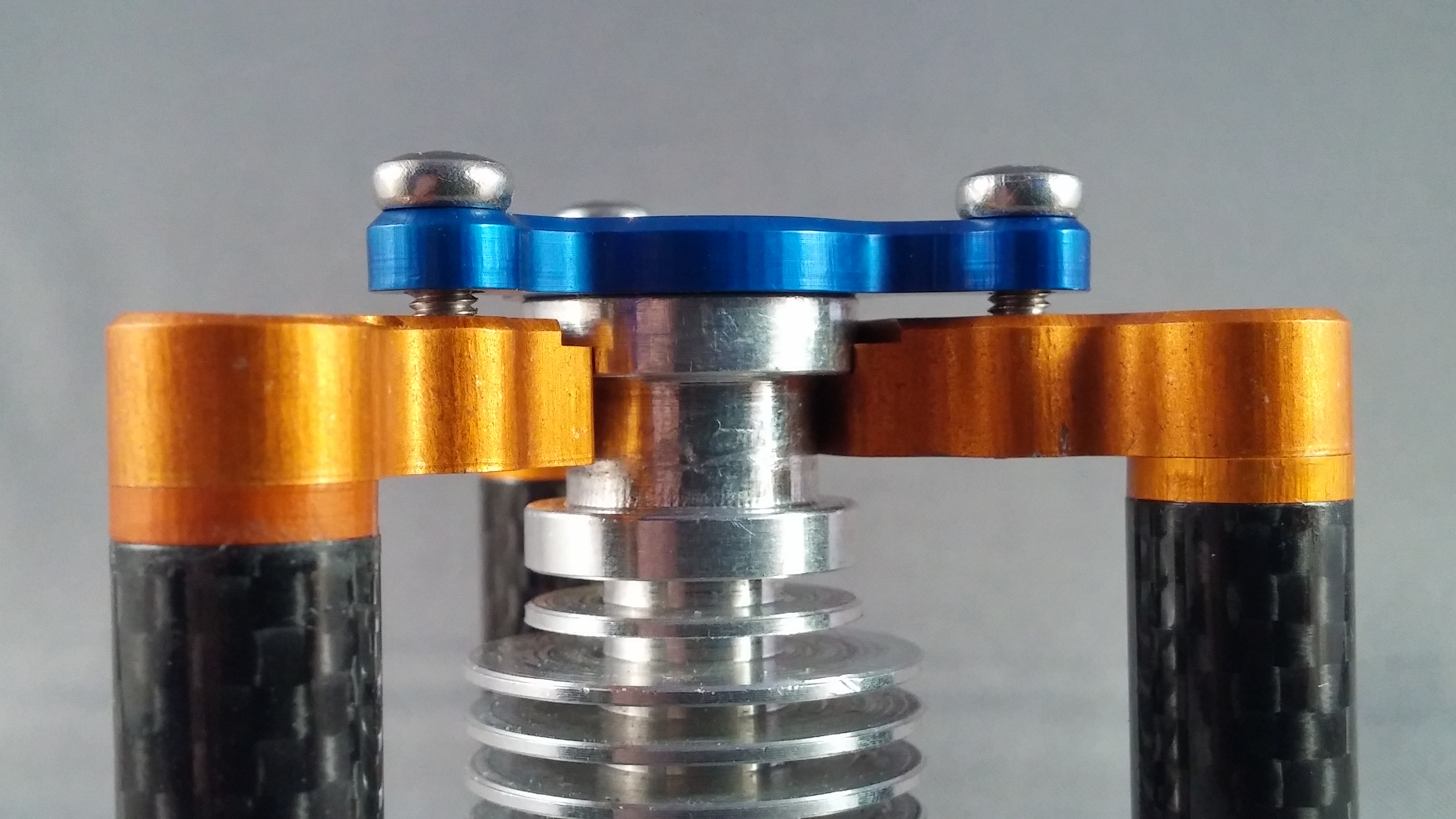

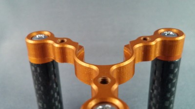

So I have been working on the what I hope will be the final version of the mount. It has been expanded to cover working with and without the Yellowjacket board on both the E3d V6 and a standard J head mount print head. I listened to the feedback from my BETA testers and worked as best I could to make the changes they asked for.
The biggest change to the mount is a small notch cut into the side to allow clearance for both the E3d V6 and the standard J head style to fit into it with ease. This should allow me to just have one mount style in stock for both the E3d V6 and the standard J head style hot ends. The new notch allows for mounting either style to the same mount without any changes on the users end other than switching out the hotends and screwing down the screws once more. The mount works both with and without a Yellowjacket board. If no YJ is used then an anodized aluminum locking ring which stands on top of the hotend mounting flange is included along with 3 M3 8mm screws for securing it in place. A Yellowjacket board (http://www.themakerhive.com/shop/viewit ... oductid=20" onclick="window.open(this.href);return false;) may be attached with the provided nylon screws so all versions of the Yellowjacket board with work with this mount. Each kit will include the following: 1 anodized aluminum E3D /J head mount, 3 custom length carbon fiber spacers with anodized aluminum end caps, 3 m3 8mm screws for mounting the mount to the top of the spacers, 3 M3 12mm flat screws for mounting the assembly to the effector plate, 1 anodized aluminum lock ring, 3 M3 8mm lock ring screws. 3 nylon M3 10mm screws will be included if requested for mounting with a Yellowjacket board. (mounts and lock rings can be anodized in a wide range of colors, custom length spacers can be almost any length.) We are looking to sell the above kit at $35.00 + shipping (flat rate USPS priority mail).
I am still working to get back logged orders and a few samples out before I can start taking in new orders. I will contact everyone who has asked about buying a mount shortly when I have them in stock and ready for anodizing in your choice of colors.
