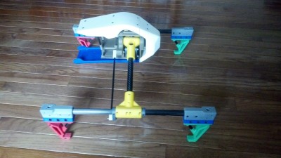

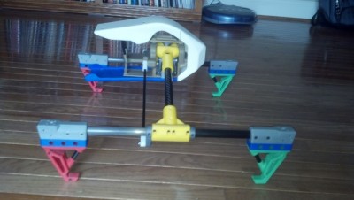

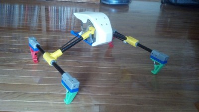

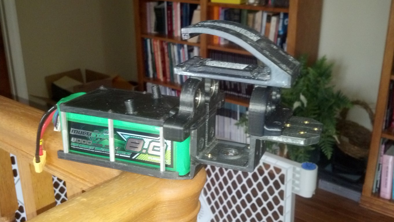

After sitting on the fence for a while I have decided to build a QuadCopter. I was really attracted by the DJI Inspire 1 when it was introduced but the $3000 price tag made it not a possibility. I then saw rchobbiesuk.com version of the machine and saw that it was designed to be entirely made by 3-D printing with a smattering of Carbon Fiber and other expensive bits.
Purchased the .stl files and away we go. The design is very well executed with parts fitting exactly after printing. Parts like the Tail Canopy bridge three printed parts with 6 screw holes and line up perfectly.
So I am printing the air frame primarily from HIPS. Weight so far is about 600 grams but the final weight with a battery on board is likely to be in the 1900 gram range. The arms rotate to transform between landing and flight and pivot on the same bearings used in the Cheap Skates.
Hopefully it will fly as good as it looks. One change I will likely make is to add a battery pod below the existing frame and canopy. The space inside the frame is just too close to fit in a 6S battery of ample size.
The photos so the state of the air frame this morning. There are several more parts to print including two more motor pods, the arm linkage and remaining canopy parts.

Re: DJI Inspired Quadcopter
Very Cool, I'm looking forward to the final product! Great project.

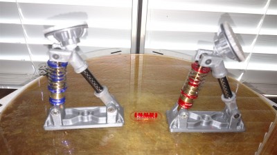

Is the retractable landing gear worth the extra weight? I guess it sounds like you're well under the stock weight of the DJI anyway, isn't the Inspire more like 3KG with a battery?

The gear is also the arms for the props. They swivel up out of the camera's way while in flight.Jimustanguitar wrote:That's an awesome looking build, great job!

It is including the 4K Camera and Gimble and a large quick change battery pack. Biggest problem with this design is the limited space inside the canopy. The retractable gear takes up a considerable space and limits the battery size. I and several others are working on a "long wheelbase" model that relocates the battery to the lower bay and extends it to 142mm. This allows a 6S 6000ma battery which raises the weight quite a bit. Also requires reevaluation of the CG location.Jimustanguitar wrote:That's an awesome looking build, great job!
The machine may never fly but it sure is fun to build and assemble. There are 72 screws hold this together and so far all have lined up with there respective hot set bushing or helicoil. Bearings were a snug press fit as printed. Kinda cool to see things actually work as they are supposed to.

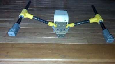

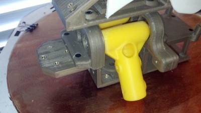

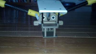

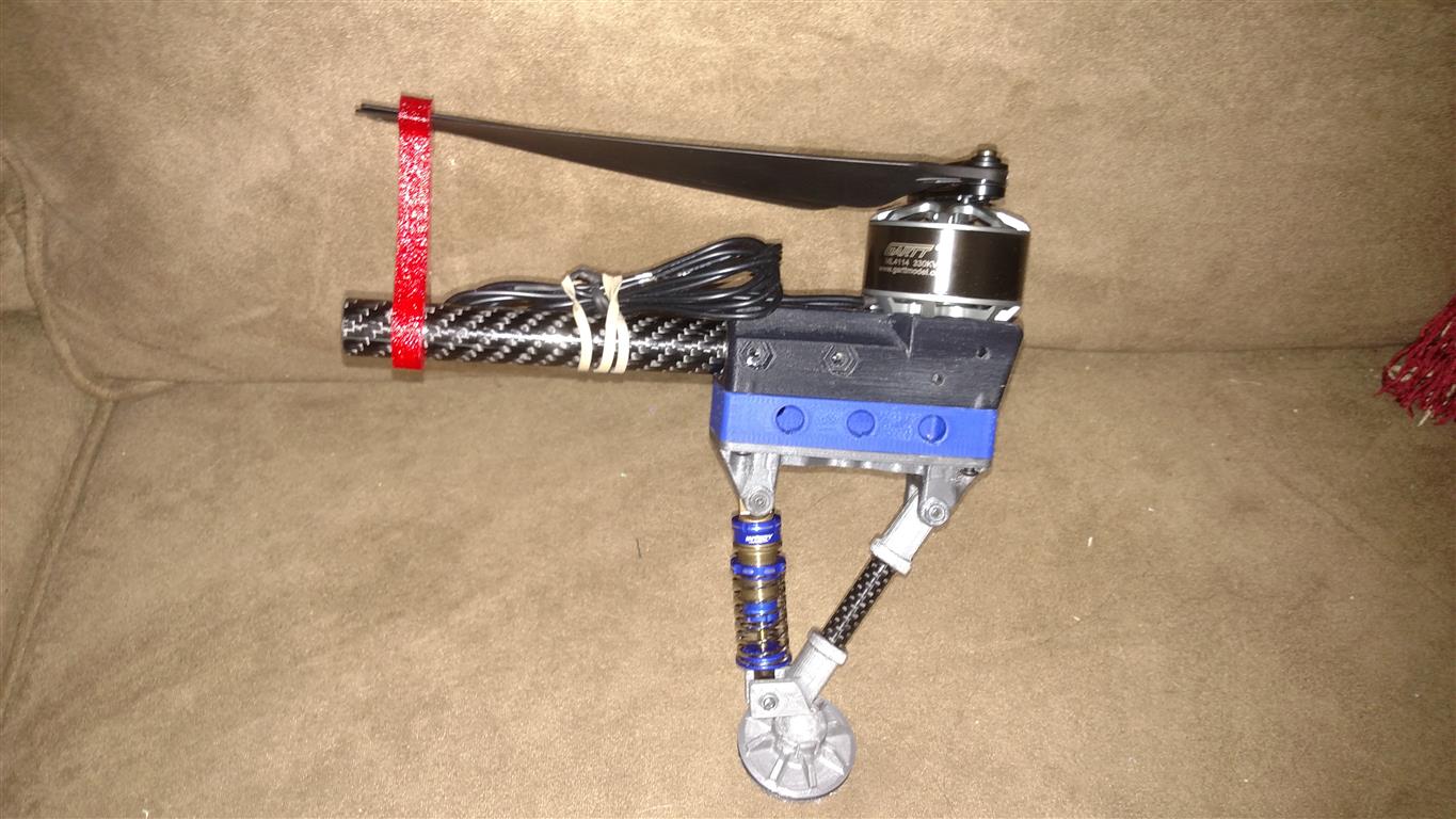

A little more progress. It is now apparent that there is not enough room in the frame for the "stuff" required. The current battery bay is 35mm high x 35mm wide x 65mm long. I have redetailed the frame to expand the bay to 55mm high x 65mm wide x 145mm long while keeping the same canopy outline.
The pictures show the as-furnished frame. I am now starting to print the 3/4 Ton - Long Wheel Base Model.
It is coming together. Looks like the AUW will be 2750gr +/- with an 6S 8000mah battery. With 3508-380kv motors and 1447 or 1550 props the available payload should be about 1300gr. We will see.

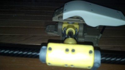

By the way, what drive system powers the handing gear retract? Does it use some kind of worm gear or something?

The original design uses a 5mm screw coupled to a continuous servo controlled by either a pair of limit switches with directional diodes or an arduino processor or a 5mm screw powered by a stepper motor and arduino processor counting steps. I have the later system inbound and would like to interface it to a sonar sensor to deploy upon landing approach after gear down is selected. The other popular mod is to use an 8mm trapezoidal screw for fast deployment.Brian wrote:That looks really amazing.
At this point mine has a screw in place to hold the lower lifting block in place. It can be turned by hand to raise the rotors above the top of the canopy for stability and clearance in the camera field of view.

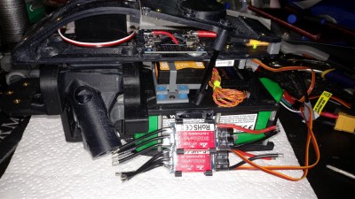

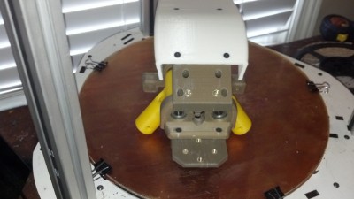

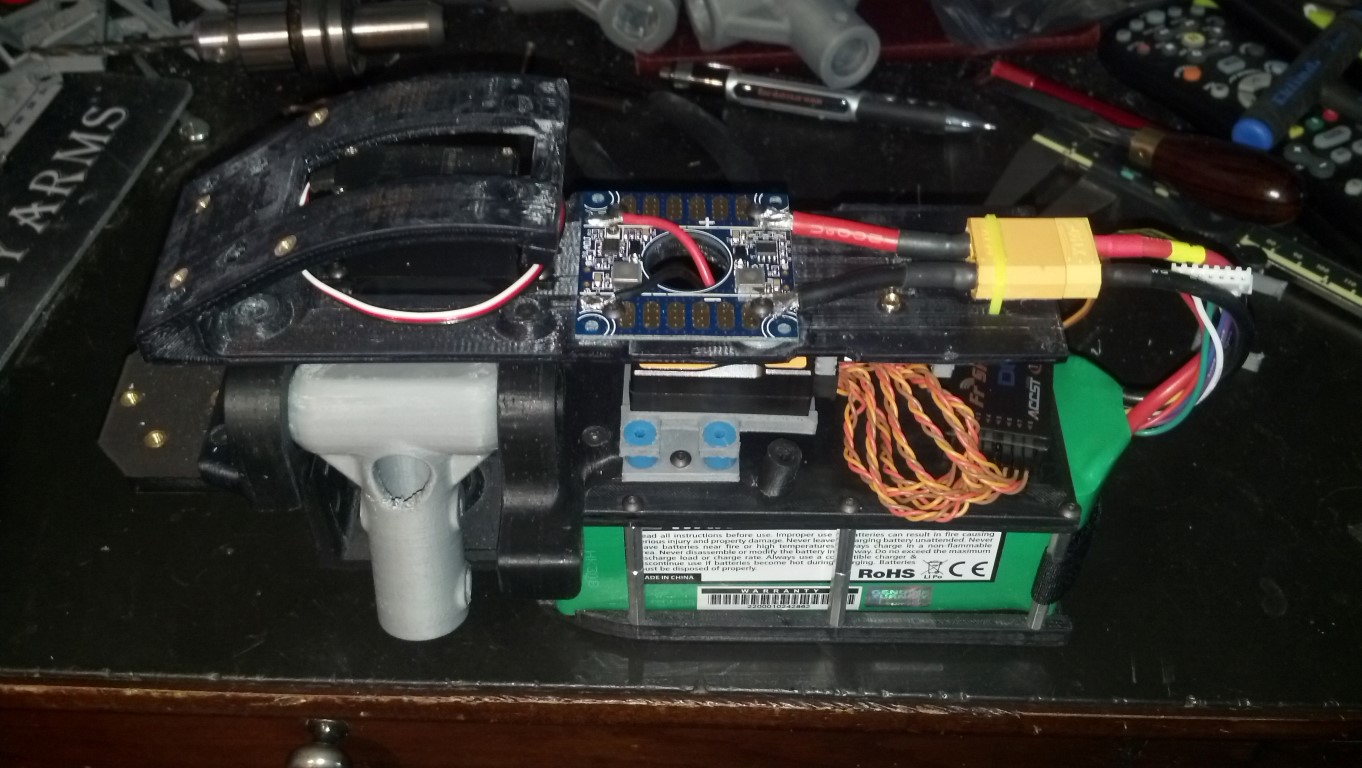

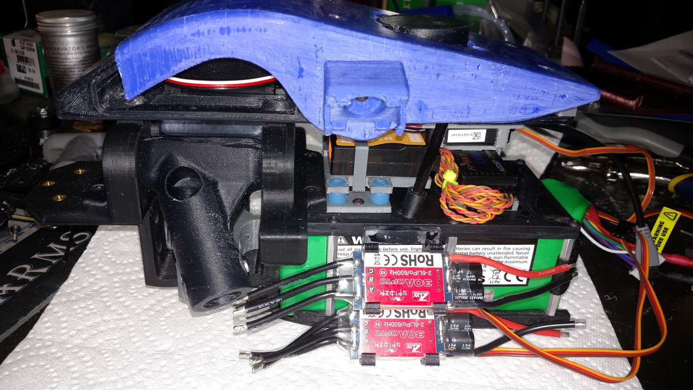

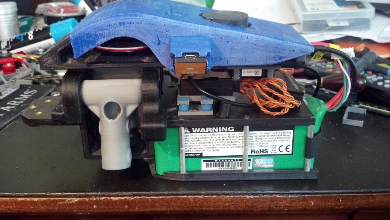

Thought I would update my progress status. Travel has kept me from making as much progress as I would like but it is coming a long. The first prototype was printed from whatever was in the printer when the time allowed. Because of the mix of materials and colors, it was nicknamed "box of crayons". After evaluating the prototype, several areas requiring attention showed up. Primarily there was no room for the required electronics and the battery area was VERY small.
So many parts have been resigned/modified by me and several others to improve the breed. The lower deck has been widened and extended to accommodate an 8000mah 6S battery. The second deck has been expanded to provide room the require electronics, a NAZA V2 Flight Controller and Telemetry Receiver. The third deck was extended to provide space to mount a Power Distribution Board and the NAZA Power
Module. ESC's have been rack mounted between deck 1 and deck 2 and will be later cover by a printed cowing. The arms have been swept 20 degrees to compensate for the CG shift resulting from the added battery weight. Booms and Arms have been extended to allow the use of props up to 16". The diagonal Motor Center to Motor Center is 690mm. All Up Weight is 3.2kg, I am using Tarot 4114 330KV motors with 15.5" props and eCal predicting a Payload of 2+kg.
I have a large box of rejected printed parts, these include obsolete parts, design iterations and not so good quality parts. Many parts have gone through several iterations. I have replaced the rigid landing struts with landing gear made using a spring coil over shock. The printed parts are on rev.10 and the design on rev.16.
This has been a lot of fun, however, if my time was considered to have any value, I could have bought a DJI Inspire for less.
I have several days to a few weeks to finish depending on travel, I am in Perth now and return to leave for Amsterdam but the quad will finish this summer.
Now just hope it will fly.

Naza is much smaller and in my opinion better plug and play modular solution. The modules for power supply, GPS, OSD and a data buss can be split and mounted almost anywhere. Plus I had some bits already. Even after significantly increasing the frame however, space is still at a premium.Khalid Khattak wrote:I am very interseted in your build. Can you tell why u not going with Ardupilot APM?
Travel has kept me doing as much as I have wanted to but there is still slow progress. Attached are photos of the landing gear struts. Printed from ABS with Integy Coil-over shocks and TPU foot pads. Blue for front Red for rear. They are upside down sitting on the engine pod connection flange. One photo shows a front engine power plant assembled to a short piece of tube. The blue box helps identify front from a distance and serves as an electrical junction box for the motor wires which are run inside the tubes. On the printer bed between the two struts is a wire loom for arranging and bundling four electrical wires. These are printed from TPU as is the red Prop Strap seem on the Power Plant. These were designed with Design Spark which is starting to work very well for me.
