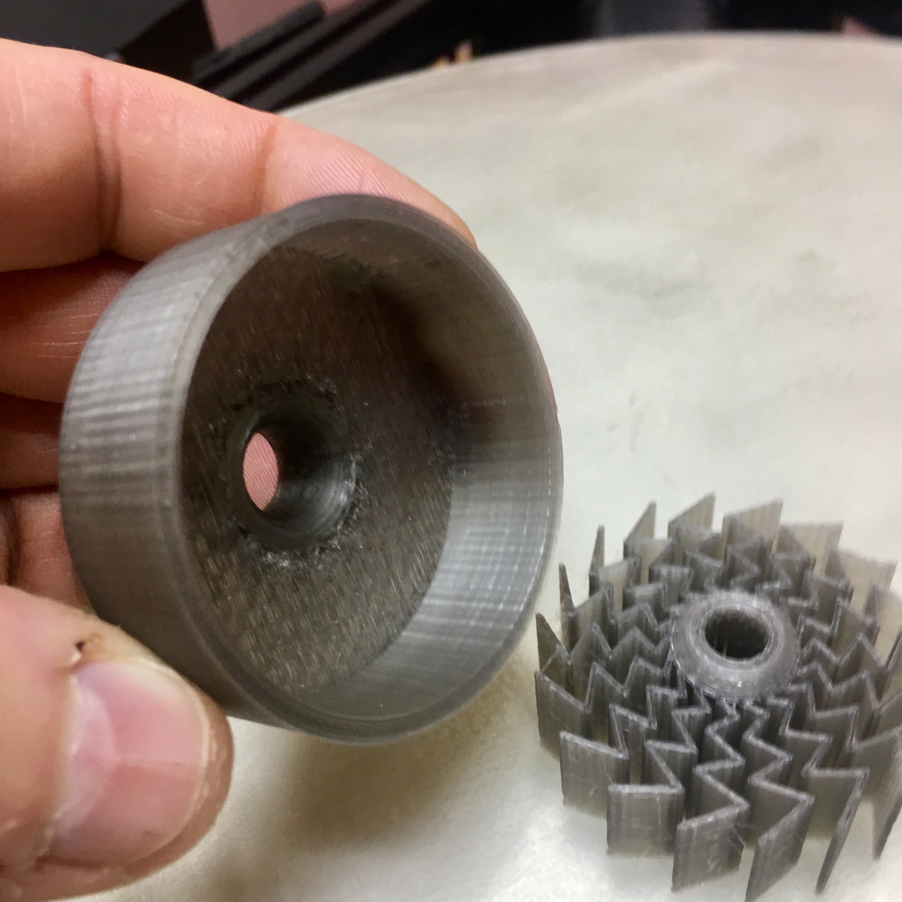

I get asked this all the time so here's a little overview on how to go about designing purpose-built supports for your models. You can also use these techniques to add supports to STL models in exactly the same way, all it takes is a CAD program that can open STL files and can generate meshes and save them as STL files.
Modeling supports is easy, all you have to do is learn to "think like a 3D printer". What I mean by this is, when you are designing your parts think about what the printer need to do to print them. Many times you'll discover other simpler options to design the part so no supports are needed. But in the cases where you have no choice but to use supports, thinking like a 3D printer will help you design them. Let me start with a few simple, what I call, Supporting Rules. First, explore all options to obviate supports. Think about reorienting the model, breaking it into several parts that can be printed without supports and then fastened together, or even rethinking the design.
A couple of tricks I like to use is to use zig zags like the support in this photo: You can either make the entire support structure the zig zag like the one in the photo or put a 1 or 2 layer hight zig zag on top of a more solid support platform in order to cut down bonding surface area.
All of the above can also be used to add support to an existing STL file. Organic shapes like figurines (Yoda!) might be more challenging so auto generated supports might be a better option. I design primarily functional and mechanical things so the "Supporting Rules" work well.
