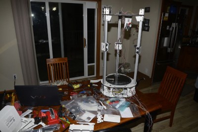

Okay, my Max v2 arrived Friday, but I didn't touch it until Saturday afternoon because I was finishing putting a clutch into my sons car.
So here is where it stands after about 10 hours of work:

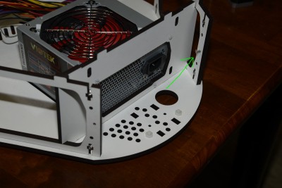

In the supports that go between the base bottom and top there are some flat head screws that are not screwed in all the way on purpose so the smoked plastic can grab on them.
your manual says to install them that way, and then the pictures in the manual don't have them. I took pictures of the same angles that include the missing screw.
This would be a new Fig. 4-11

Also, there is a spot where you talk about using the #4 pan head 3/8 inch machine screw [I think that's what you called it],
but the provided screws are a self-threading type (which work much better than a machine screw would)

Here is the photo attached. This would replace fig. 4-11 in the manual

Looks like you've made a fine mess of that kitchen table. I think it's impossible to have a clean area when building one of these things.
Re: Tonkabot's Max V2 Build
I was thinking that a large percentage of these things get put together on the kitchen table. The office is already full, and the basement shop is already cluttered.Tinyhead wrote:Looks like you've made a fine mess of that kitchen table. I think it's impossible to have a clean area when building one of these things.

I decided to go with bolded text that clarified that the 1/2" screws should be present, but were not in the photos.

is it that hard to substitute pictures in the manual?
I'm not complaining, I have already built past that point. But I did spend extra time looking for the supports in Fig. 7-1 that have a new shape, and someone else mentioned they mounted the base supports
shown in fig 4-11,4-12, and 4-13 either backwards or left the screw out [like the current picture shows] and had to disassemble it to fix.
And a few of us have 'friends' that messed up their cheapskates because the manual is less than perfectly clear. Although in my case I followed the manual and then mounted my u-joint supports on the wrong side anyway.

The photos are difficult to switch out once they've been formatted and it screws up the layout of the following pages until it gets fixed. A photo replacement has to be _really_ critical for me to want to go through that.
The effort IS appreciated though.
As I said before, the installation orientation of the Cheapskates was explicitly spelled out a few weeks ago. I also updated the section that described the top supports and showed what the "new" shape looked like at the same time.
There's really no excuse for leaving those screws out because I cover their installation a few pages prior and the orientation instruction is highlighted in yellow. I could understand if you're only going by the photos, but that's the reason for the admonishment to read the whole text - the photos don't tell the whole story.![Very Happy :D](./images/smilies/icon_e_biggrin.gif)
