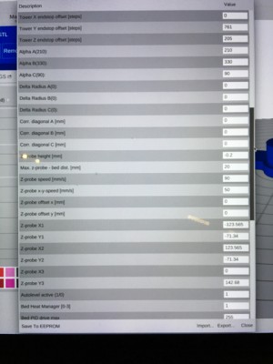

So I did more research last night and looked at my EEPROM settings I think there is a problem. First off after doing a auto calibration with the HE280 ran the end stop macros and then did a paper test. X tower 1.2mm Y tower .82mm and Z Tower 1.1mm Center of the Bed was .18mm So even with the HE280 doing it's thing we are not level. then I looked at the EEPROM and got these numbers.
Tower X offset 0
Tower Y offset 761
Tower Z offset 205
what is going on?
also should I not have the same X,Y,Z arm lengths?
any ideas?
Thanks again for the help here, without this forum a lot of us would be lost

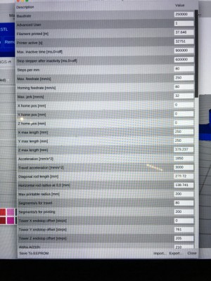

X/Y/Z "arm" lengths - are you referring to "X max length [mm]"? If so, that is correct and are the X/Y/Z Cartesian coordinate for the hypothetical cube for the build volume. Which, the firmware knows is actually circular so the 250/250 for X and Y are a circle 250mm diameter.
Did you clear the EEPROM before flashing the new Repetier firmware? If not, do that and recheck. Otherwise, read on...
Your tower offsets are horrible! That is almost 10mm on Y. Can you physically see an issue? Can you get a square and check the towers like I show in my build thread? When the printer homes, you must see the Y carriage drop down that nearly 10mm!

The towers are square to each other and the build surface, measured with a square and a digital angle meter. The travel is the same tower to tower when homing BUT when you start a print and it homes the print head moves to the Y tower and then back to the center it doesn't drop
I'm going to clear the EEPROM again and reload the firmware again.

Nevermind, with the help mhackney we figured out that it was a carriage offset issue. Little bit of work and its printing beautifully

He meant to say "endstop offset". His stop screws at the top of the carriages were very far off. So he manually adjusted them as per the procedure in my build thread.
