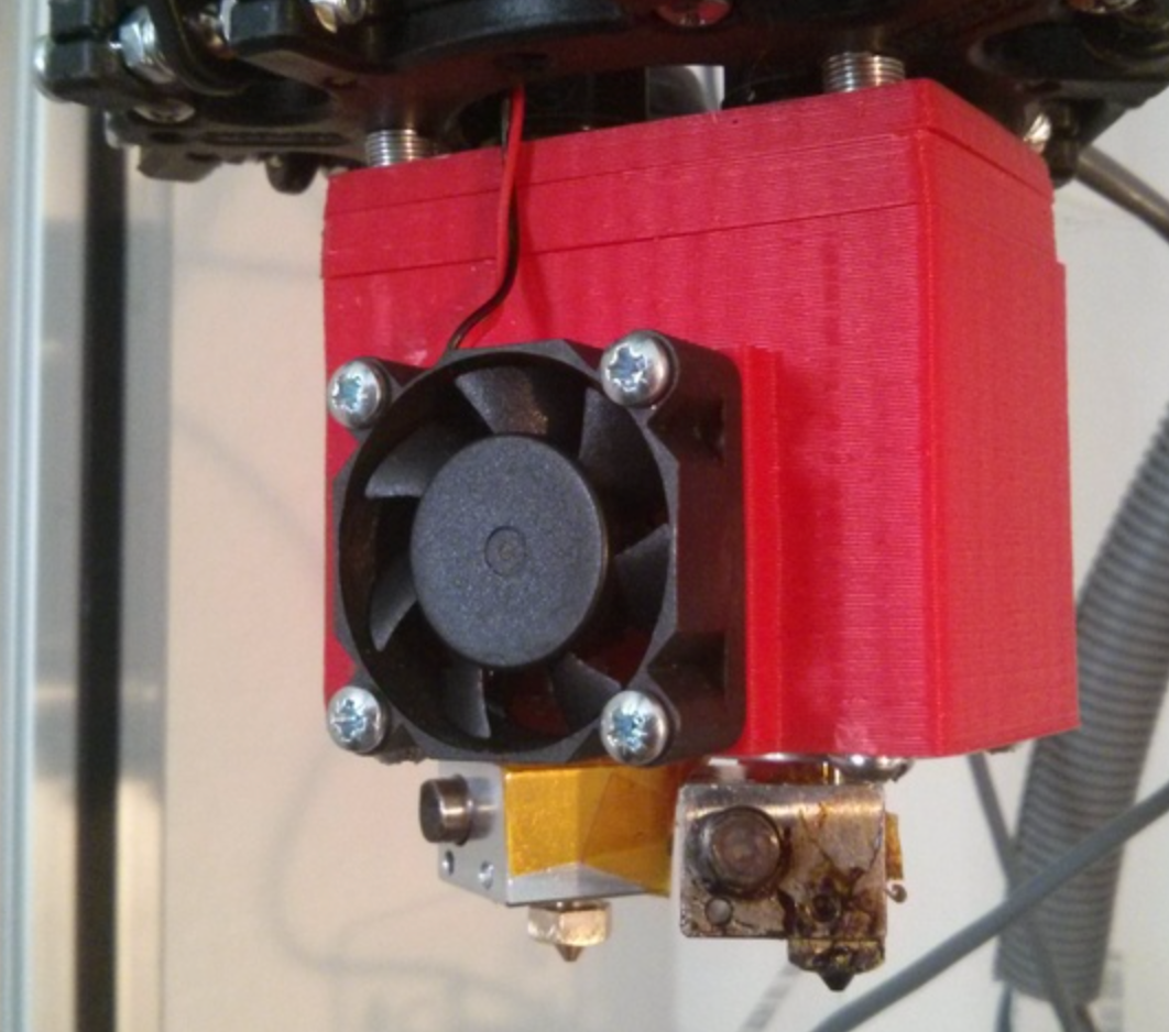

I agree with McSlappy about using 1 single fan. I had printed and used all three known (by me at least) dual mounts for E3D V5. Among them, dpmacri's version (http://www.thingiverse.com/thing:217662" onclick="window.open(this.href);return false;) sports a single fan. It works very well, not over-heating problems at all.
This is my print

Wow, glad someone has working proof on that. What size is that fan?artexmg wrote:Very nice indeed!atoff wrote:Work in progress... I have no idea if this is going to work, but my V6's are on their way, so I need to get this finished! One of the hotends will be height adjustable by a couple of millimeters (hopefully).
Lots to redesign / re-do, and lots more to do, but this is the gist.
