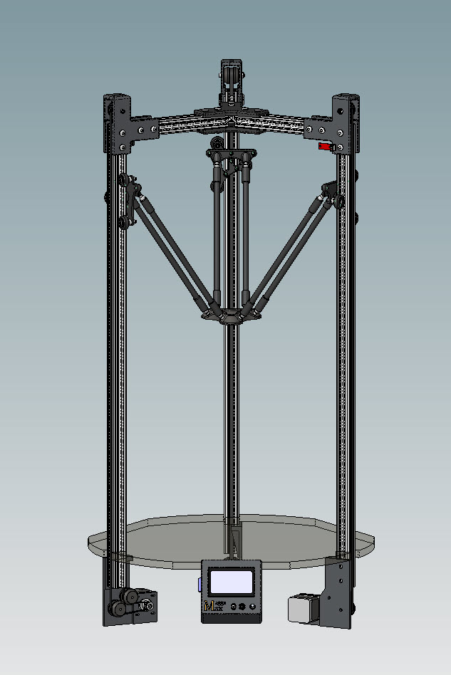

Pretty new to the forum, this is my first post but I've been lurking for a while now. I bought a TAZ 5 and so I have, as you can imagine, been reading everything I can on 3D printing.
I was having a LOT of problems with my TAZ, but I have that all sorted out now, thanks in no small part the mhackney who of course is also a member here. Anyway, in reading all I can on 3D printing I came upon these things called Delta printer and I thought, I have a 3D printer I could make a Delta printer. I'm of the opinion that there's no better way to learn than to do.

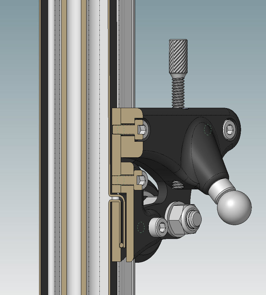

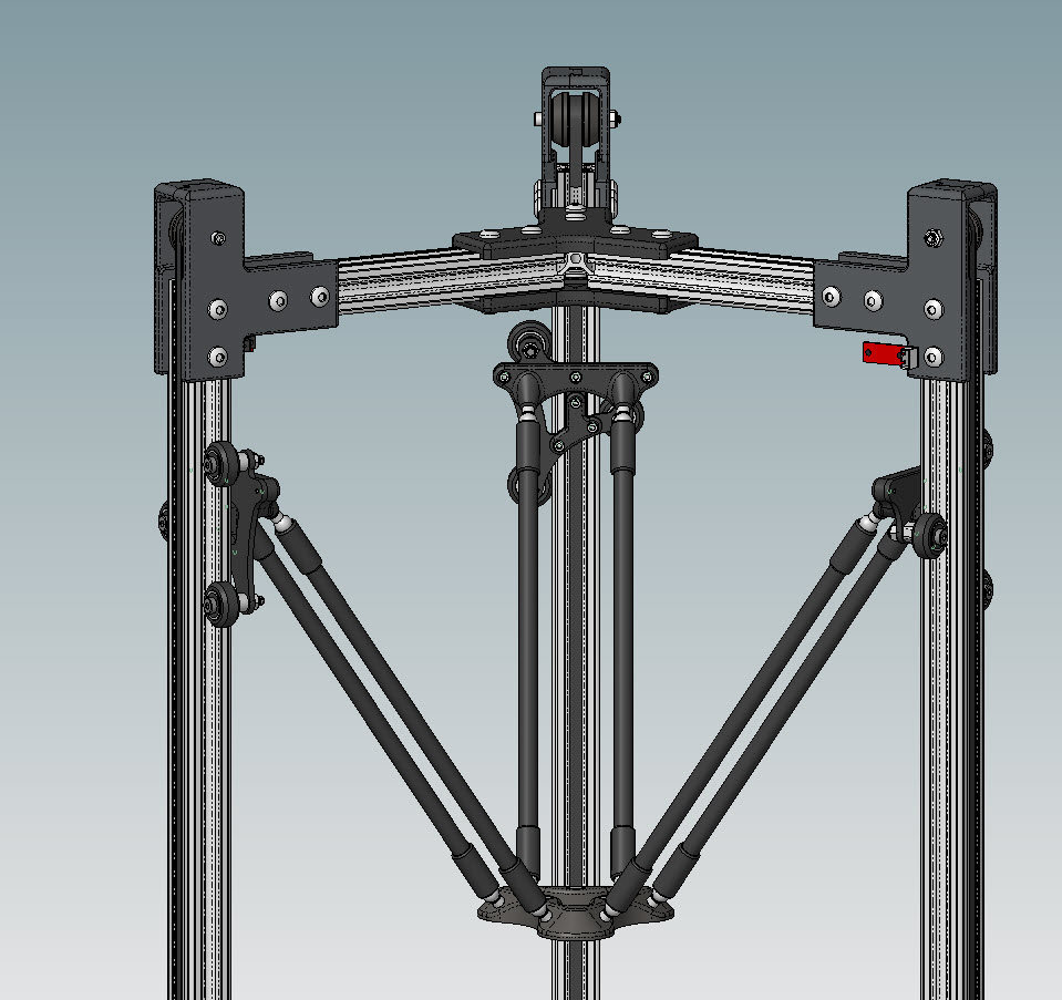

I'm a designer and work for myself. I use SolidWorks everyday inn my job, so I thought I would draw something up and see what I could come up with.
And rather than reinventing the wheel as it were, I thought I would start with, in my mind, the best design so far, the RostockMAX.
So, without further ramblings... Not finished by a long shot but it's a start.
I have bought and made a lot of what I need, but I have some questions on some other items, that I thought the nice people here could help me with. Please speak up if there are any obvious flaws in my design.
Mostly right now I not sure what to do about the bed so overall diameter is not set, nor could I get a definitive length of the rails (32"?).

Re: MuggsMAX
The length of the rails can be as long as you wish.
The diameter is limited by the size of the heat bed you can obtain.
I see no glaring issues with the basic drawing but you must be careful with the details such as rail placement, etc.

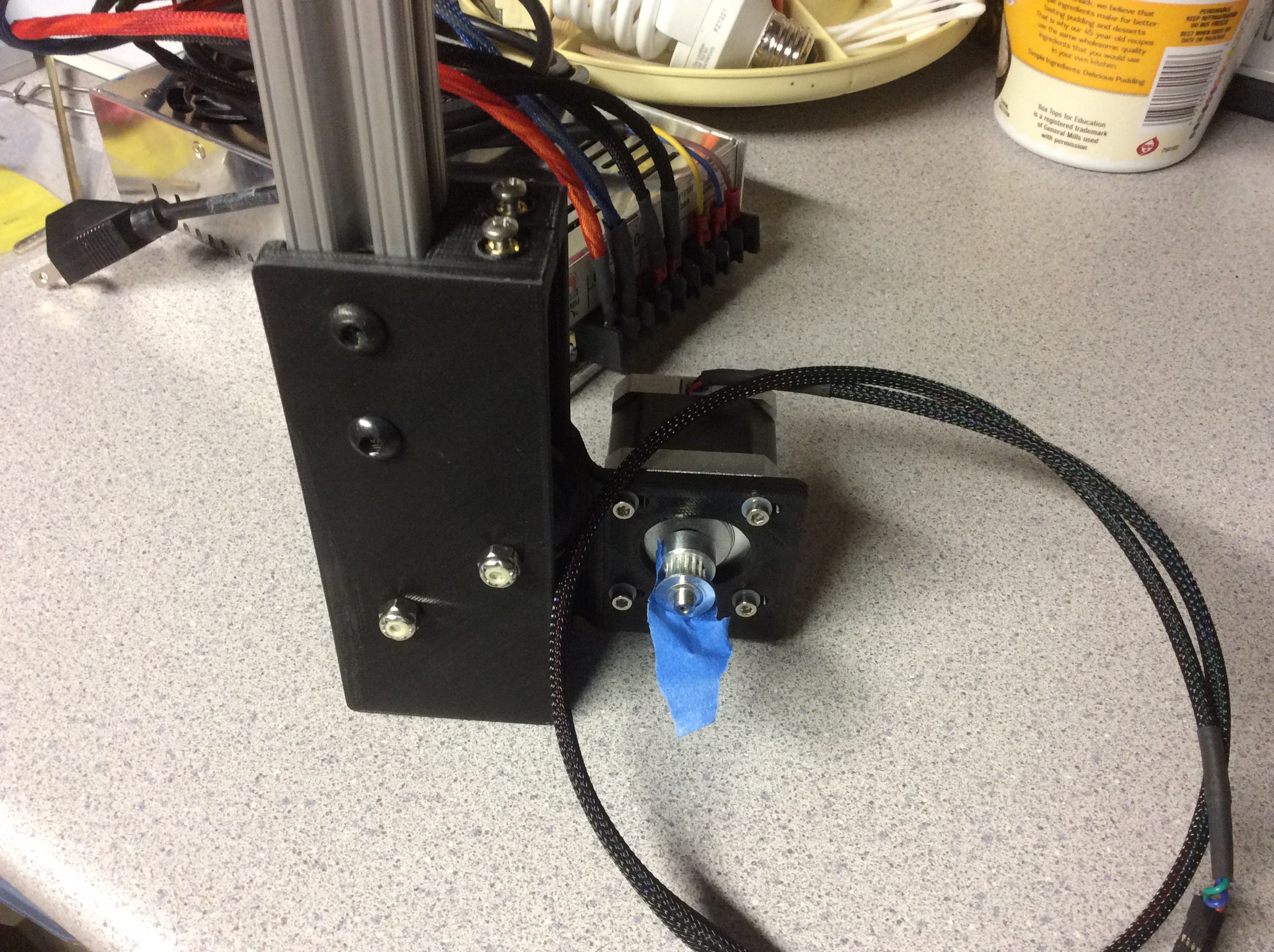

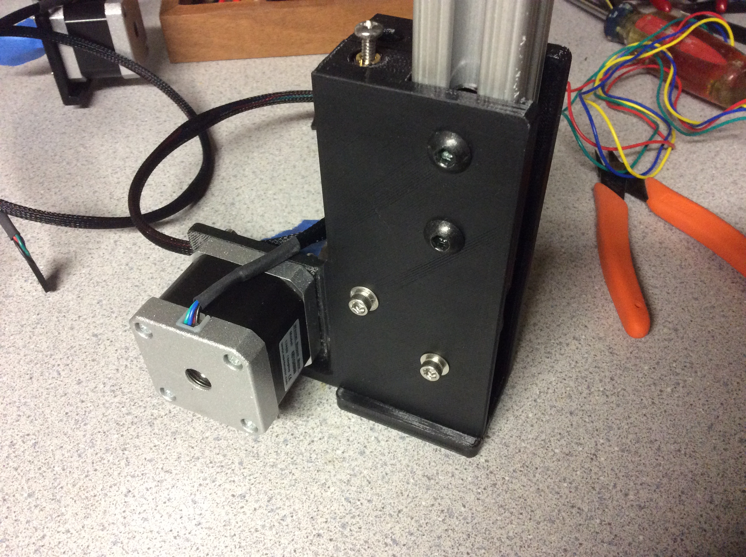

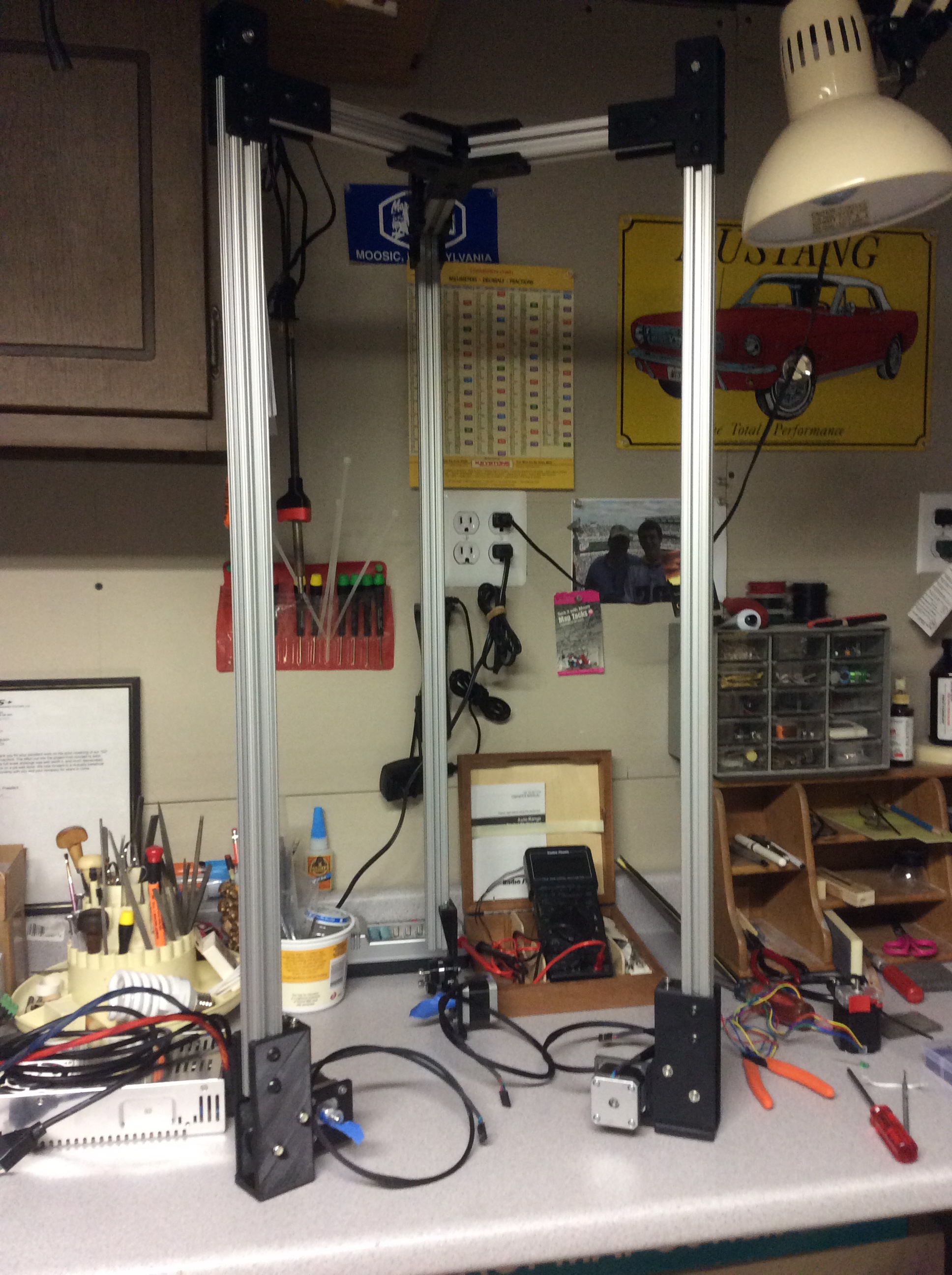

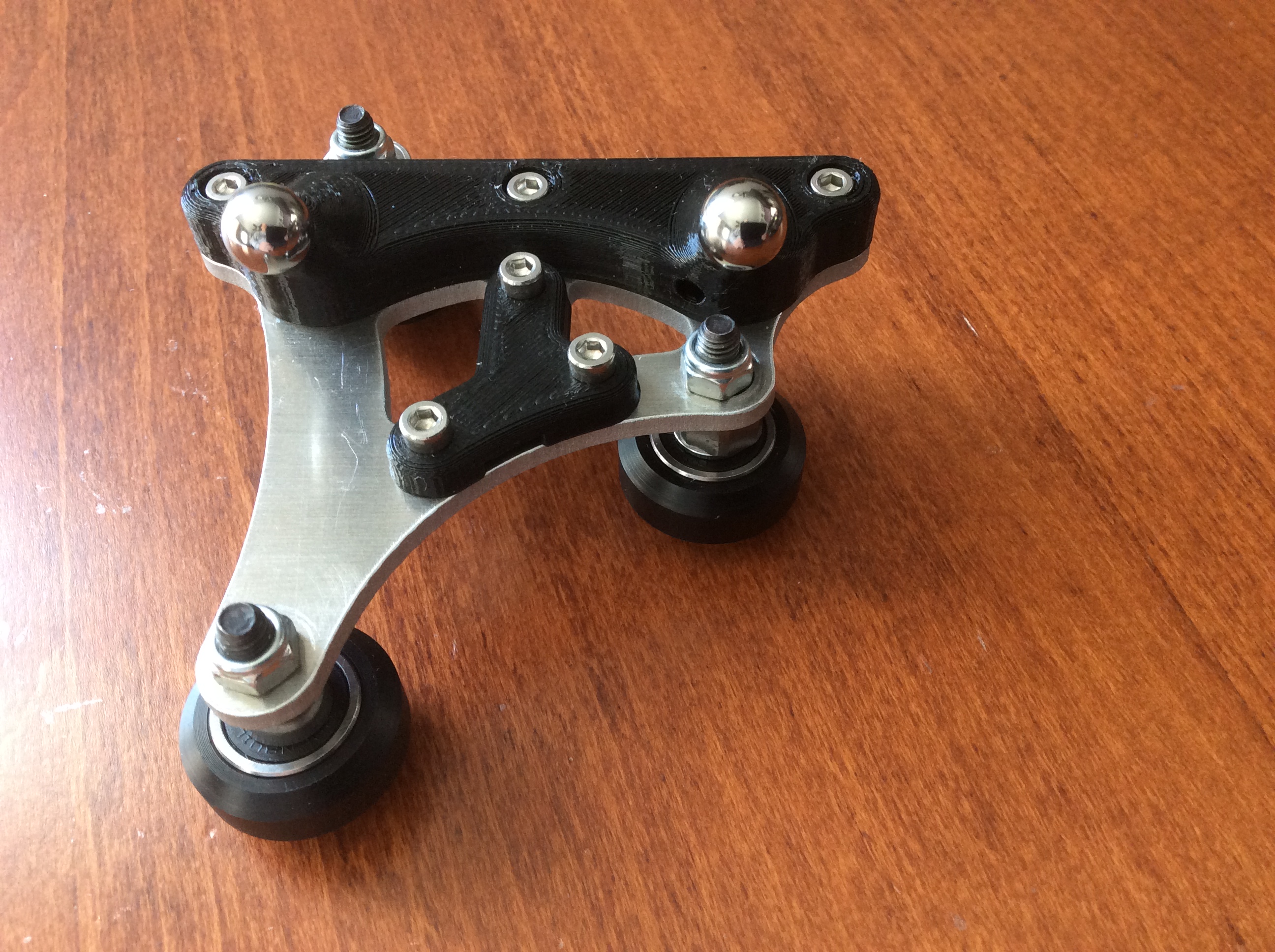

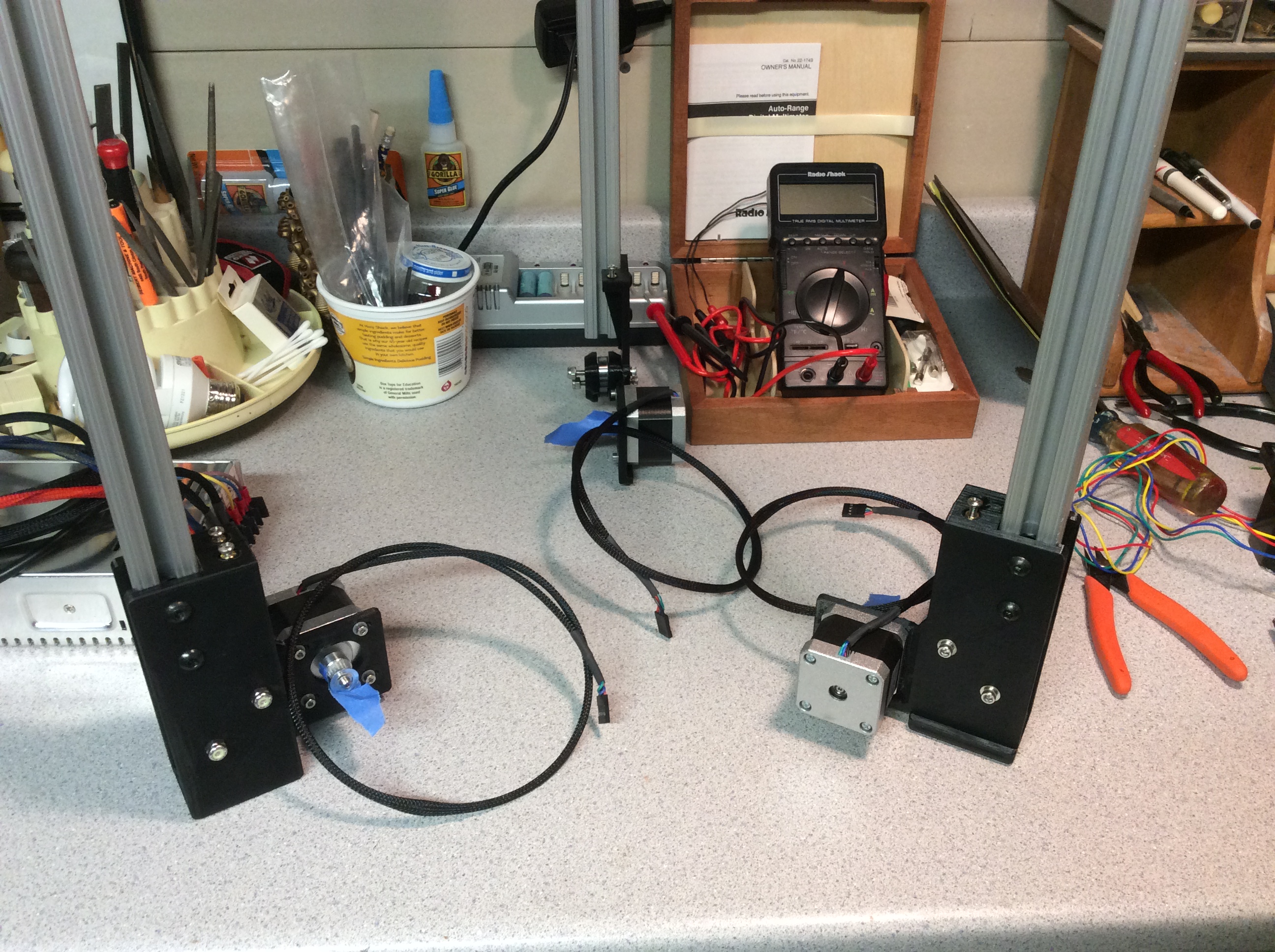

Hello Gents!

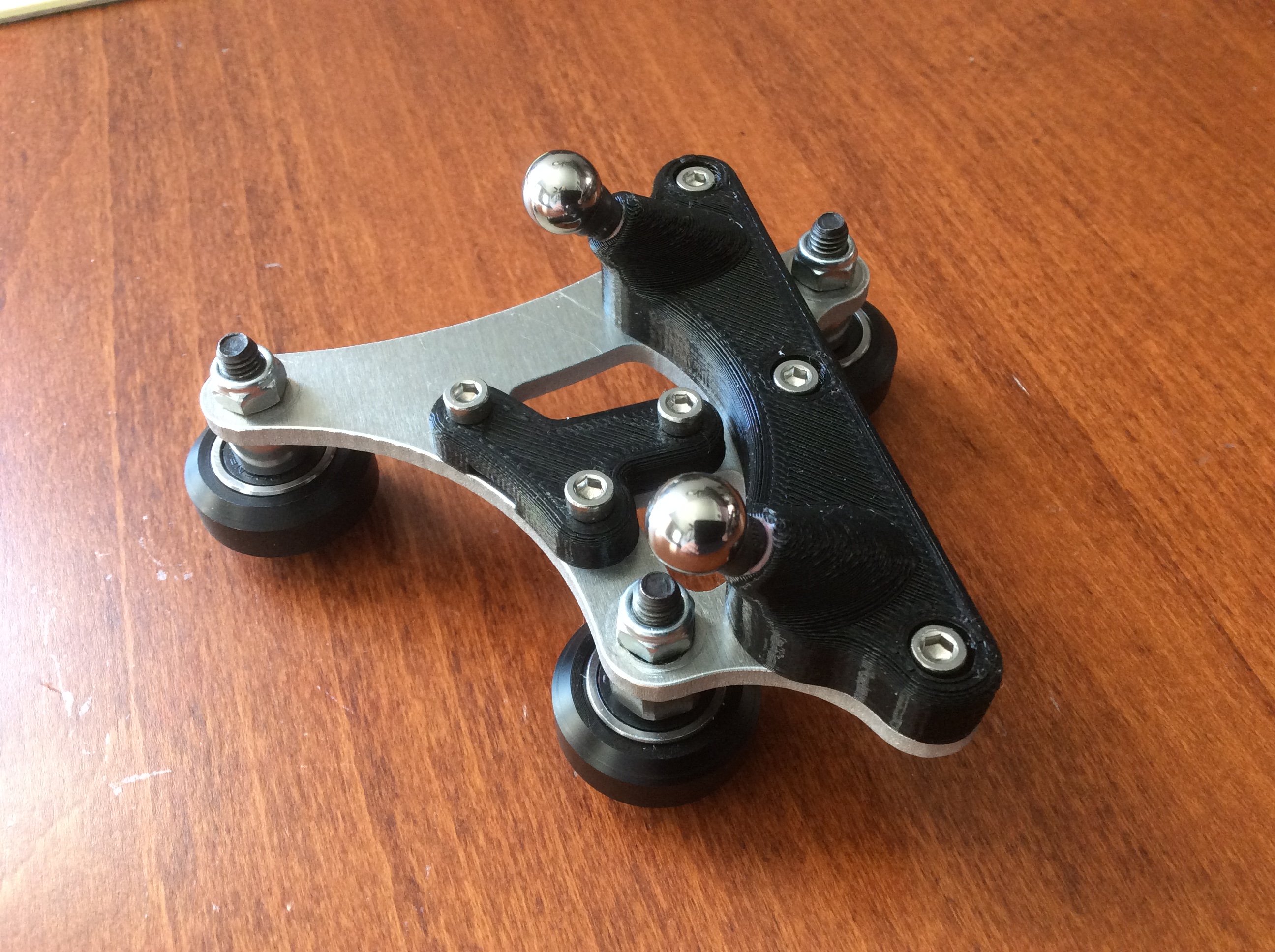

So I had some time to work on the MuggsMAX today. I've been printing parts (when my TAZ 5 is working, but that's another story) And I was able to do some assembling today. Some details: I decided to go with a 12V power supply. Also I upload my Repetier firmware to the arduino/RAMPS board and everything seems good to go.
More to come.
More to come.
