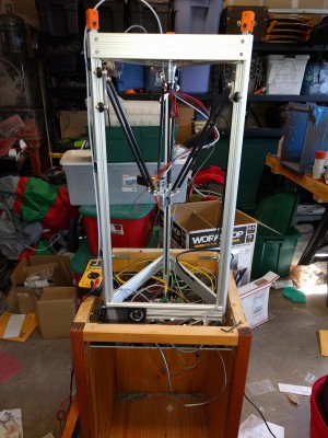

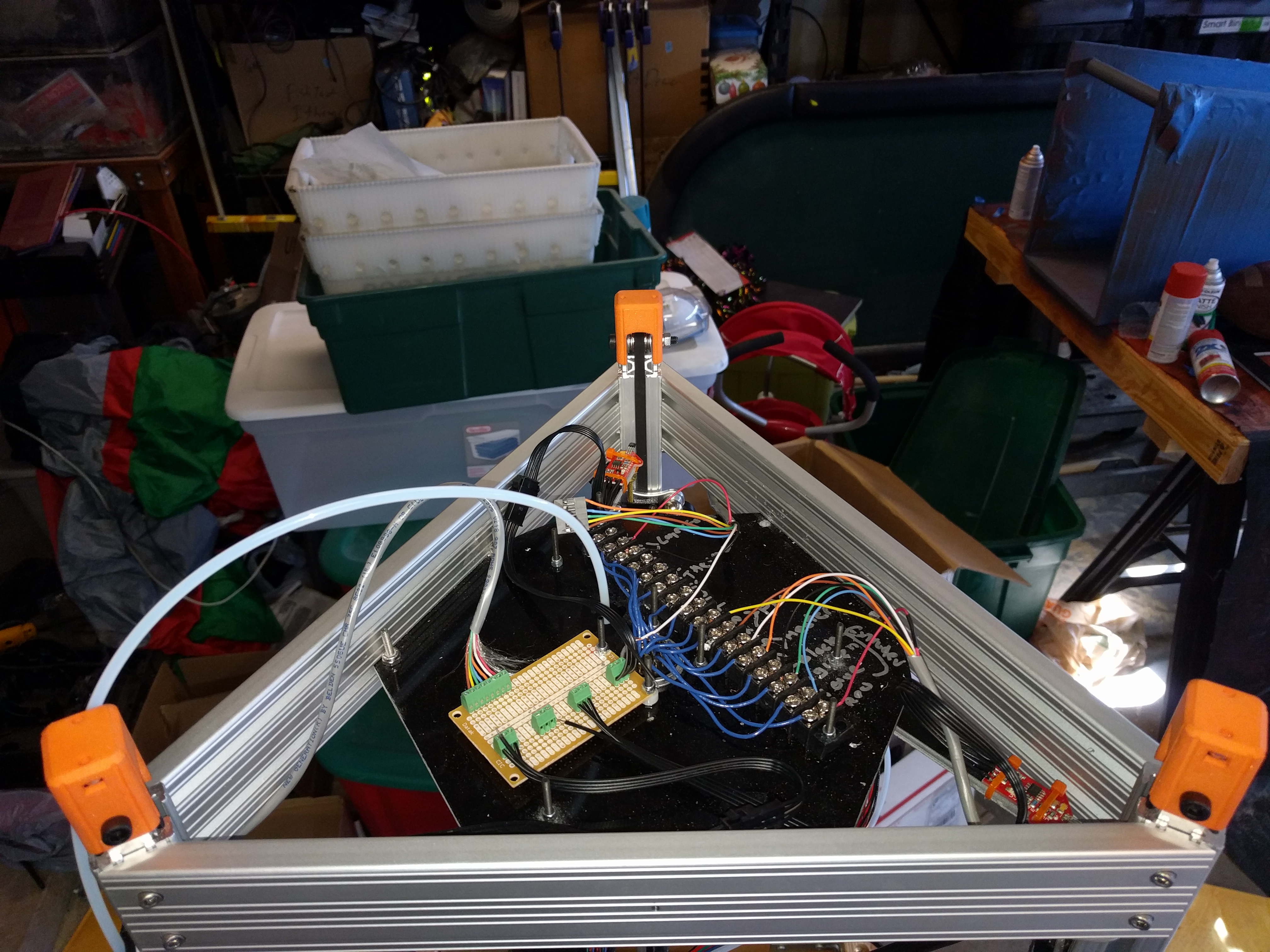

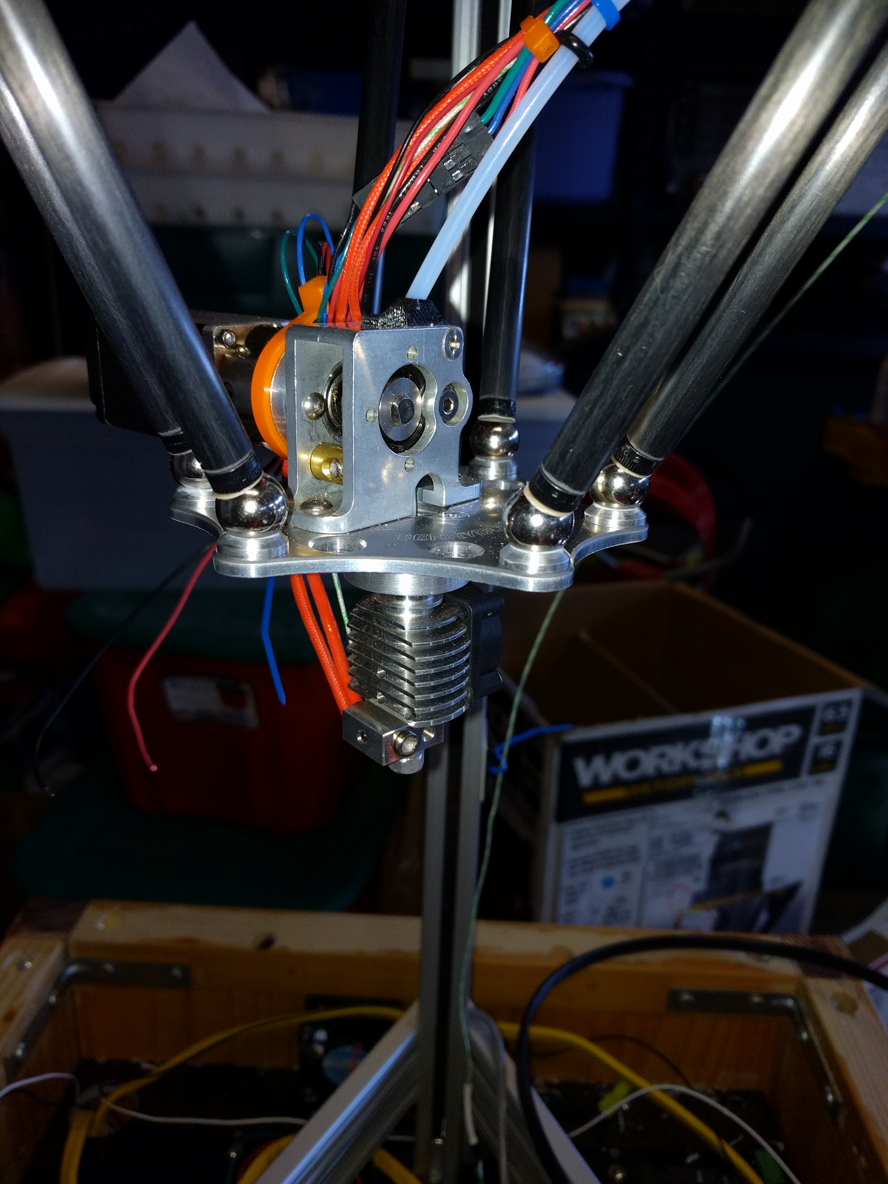

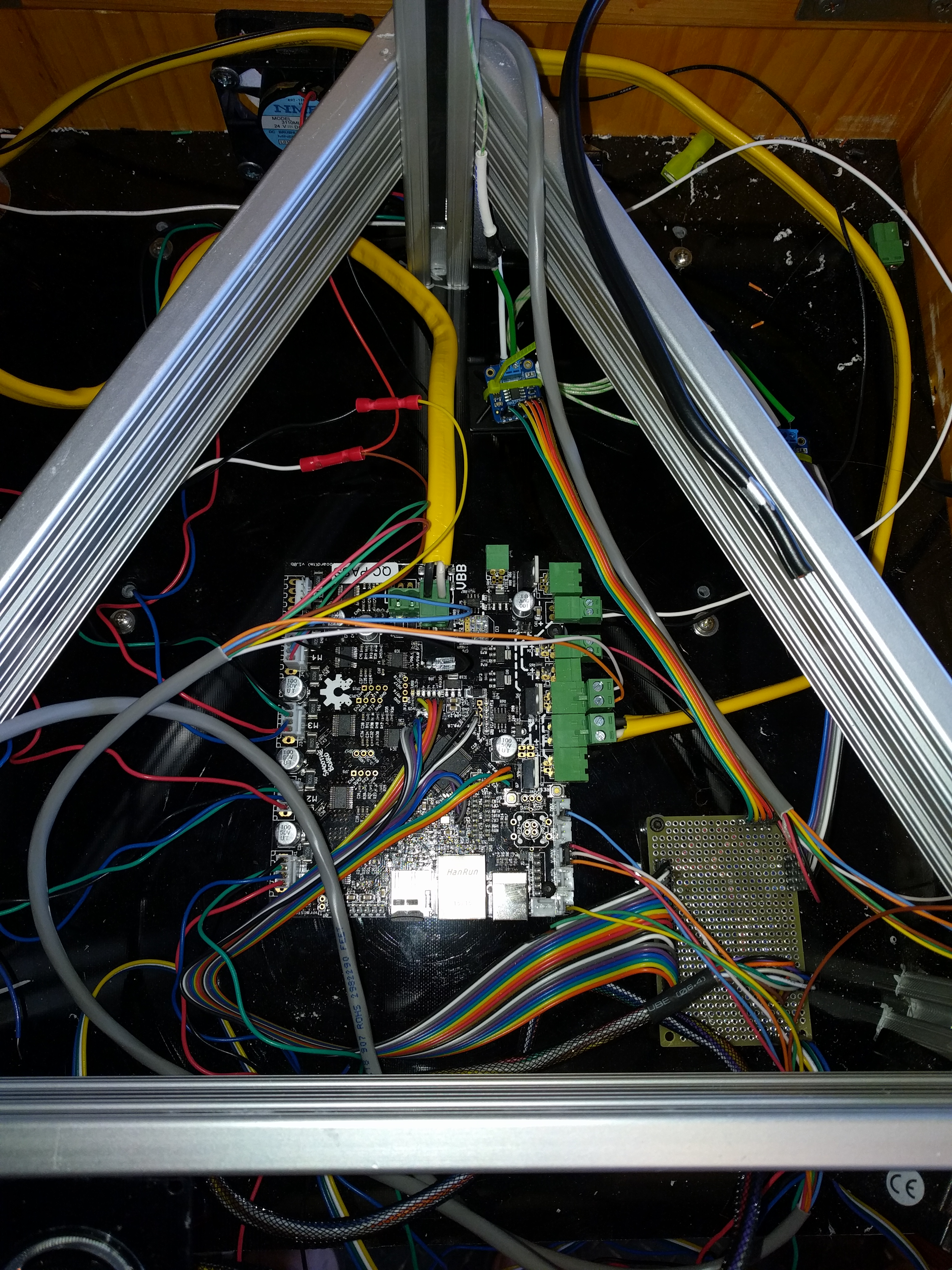

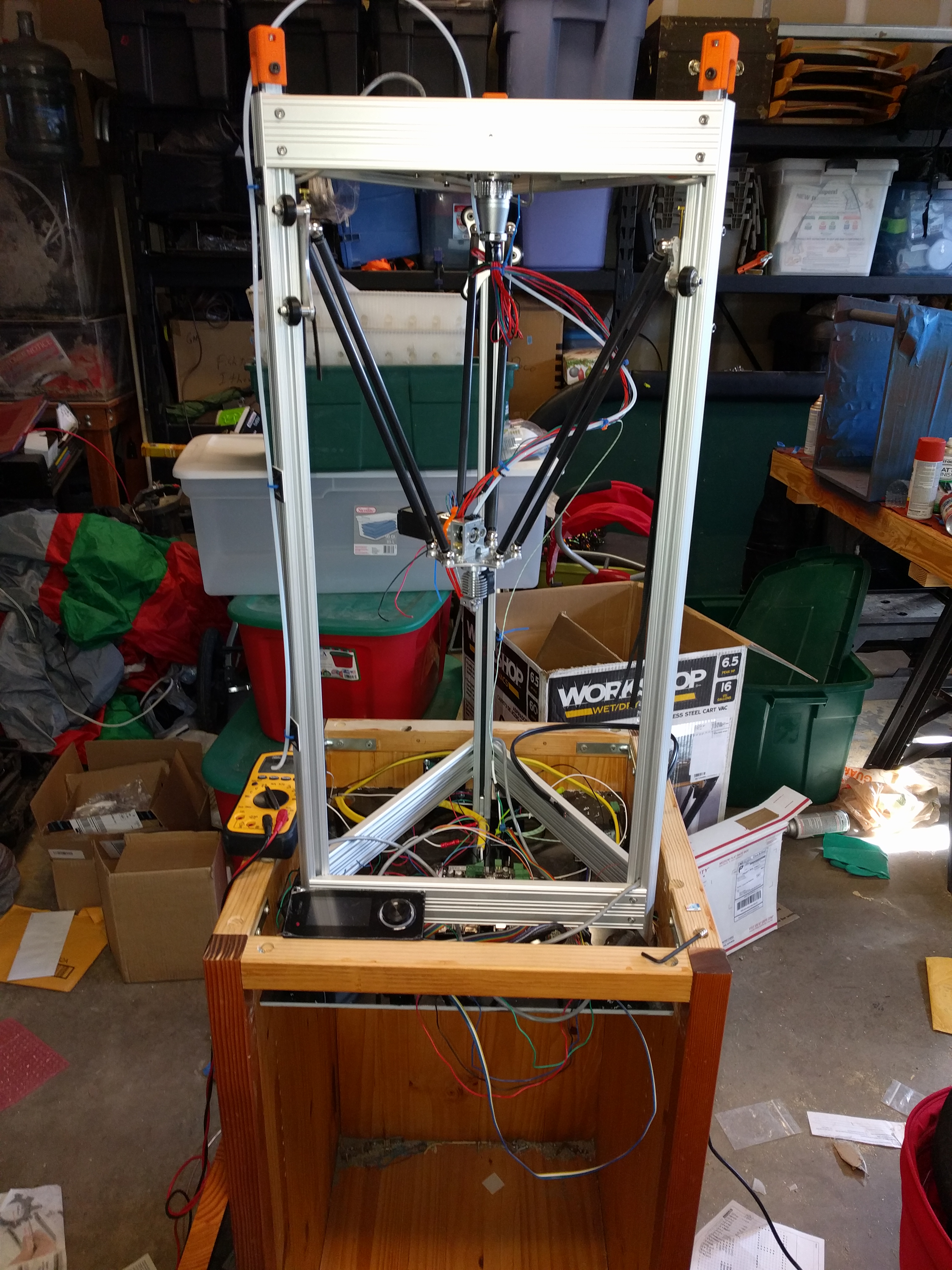

Finally took some pictures. My build is almost done. The only thing I'm missing is the fsr mounts which a friend of mine is milling for me, once he finishes those I'll be able to finish very quickly. I have tested all the motors and heaters and everything seems to be working
