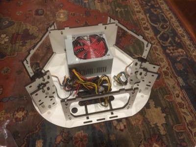

built from the ground up
Bottoms together. Kids are about to get home, so that's it for today.

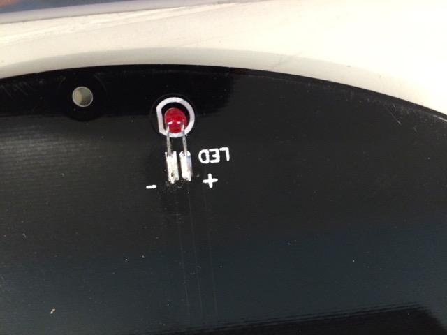

solder? really? why the "L"
My first solder! I'm more proud than I should be I think.

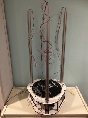

Tower 1
Tower 1
the 18 gauge wire did not have the secret "fish" inside the wire. I ended up using filament
Tower x3
Tower x3
only to find the secret fish hiding in the 22 gauge wire. And it was most helpful too!

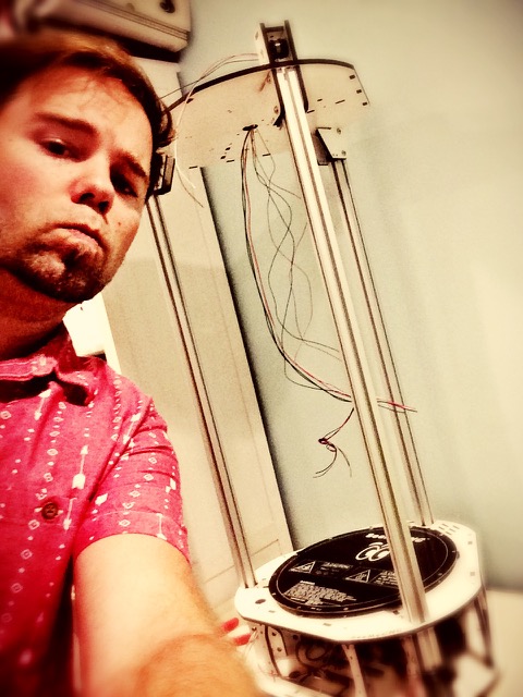

THUG LIFE
THUG LIFE
Obligatory selfie with a major milestone completed. This thing is WAY bigger than I thought!

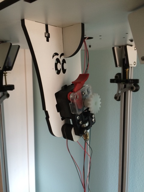

Extrude life
Extrude life
I realized later that I installed this extruder backwards. This extruder is pretty danged cool. I think I might need some dampeners for it though. I put cork on the other motors, but the kit only came with 3. Maybe some squishy washers on the bottom screws would keep it from rattling.

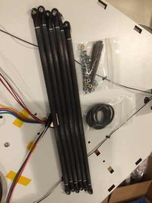

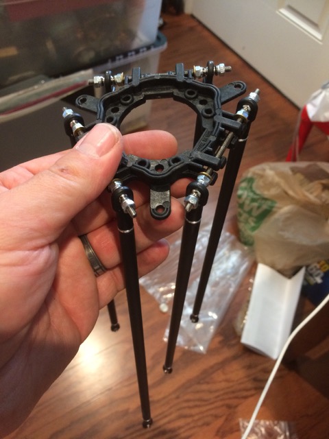

CARBON FIBER OOOOOOH
Now these things feel niiiiiiice. HOWEVER, they are the absolute hardest thing to install!

You didn't install it backwards. :)

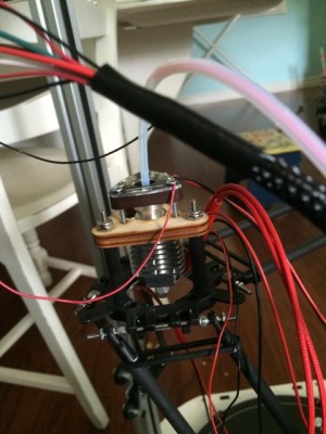

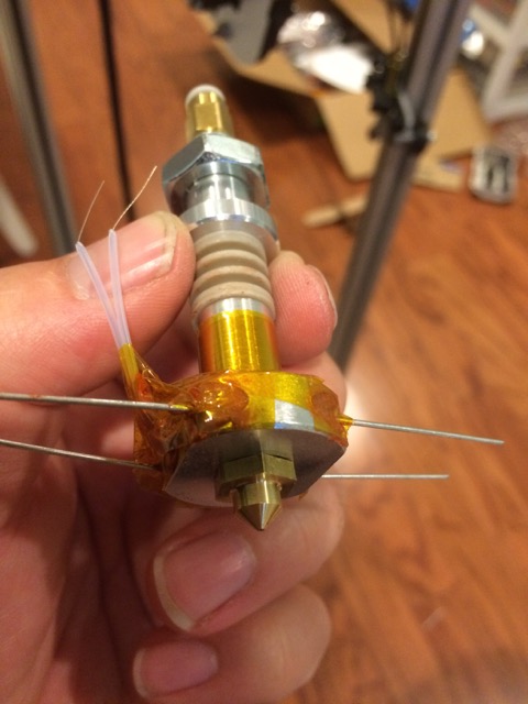

"Big things have small beginnings"
And here is the prometheus installed. This thing is slick. You don't need any ATV, there is a customizable heat zone, the PEEK fan bolts directly to it so you don't need a shroud, and it just looks awesome!
Also, I have here the carbon fiber standoffs. I'm thinking about nixing them though and dropping my hotend as low as it goes like all the cool kids are doing.
piggy back ride!
piggy back ride!
This shows the LED top hat hitching a ride with the heating resistor wiring.

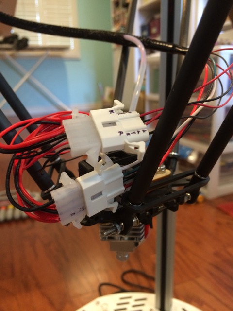

"click click aaaaah"
So instead of soldering the wiring, I opted for the detachable method. 4 pin molex connectors x2 means I can change my mind later :D
One connector is for the hotend and thermistor, the other is for the fans.
'Beware; for I am fearless, and therefore powerful.'
And behold, the thing is done. It took me a long time to do this, but just deciding how I was going to do it took the longest. I also piggy backed the LED light ring onto the peek fan wiring.

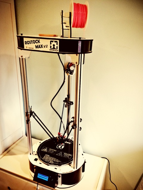

Finished!
Finished!
Yay! It took my waaaay over 20 hours. Haha, I'm slow.
Go pig or go home right?

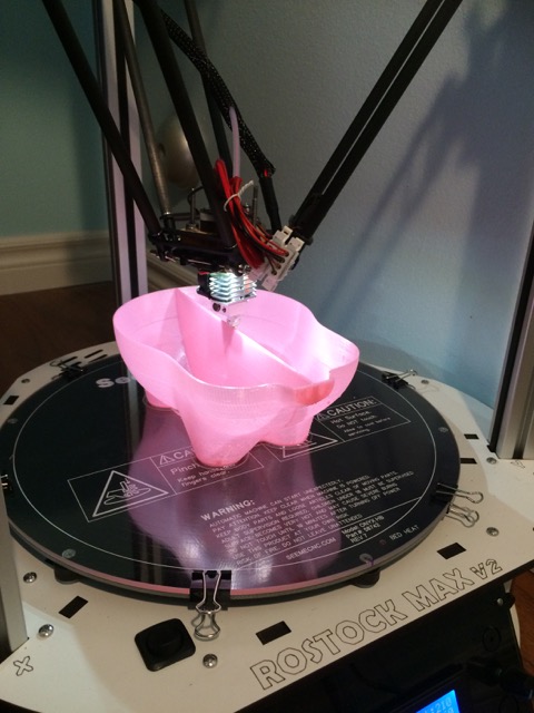

Calibrated, and now for my first print! This is a piggy bank for the kids to collect their coins.

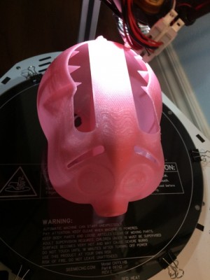

How has it not fallen off?
I am SUPER impressed by this printer! How did the pig make it this far??

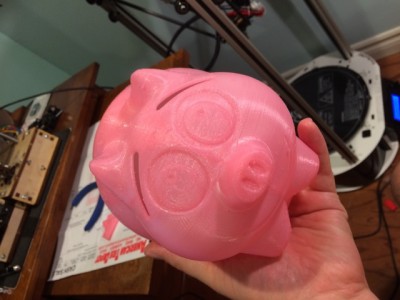

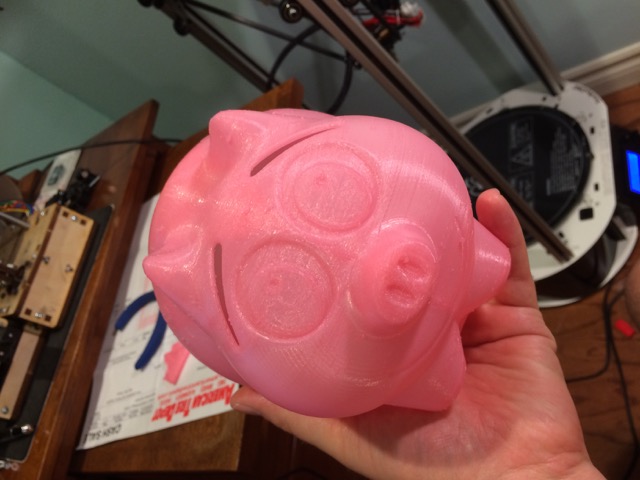

piggy piggy piggy piggy
And we made it! That last like 30 minutes of a super long print is torture. I had to leave the room because I couldn't take it. I thought for sure it would get kicked off the plate during the last few layers.
I didn't yet print the layer fan, but I can only imagine it would improve the print. This pig aint too shabby but I do notice a little rippling on some of the steeper angles.
