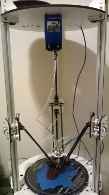

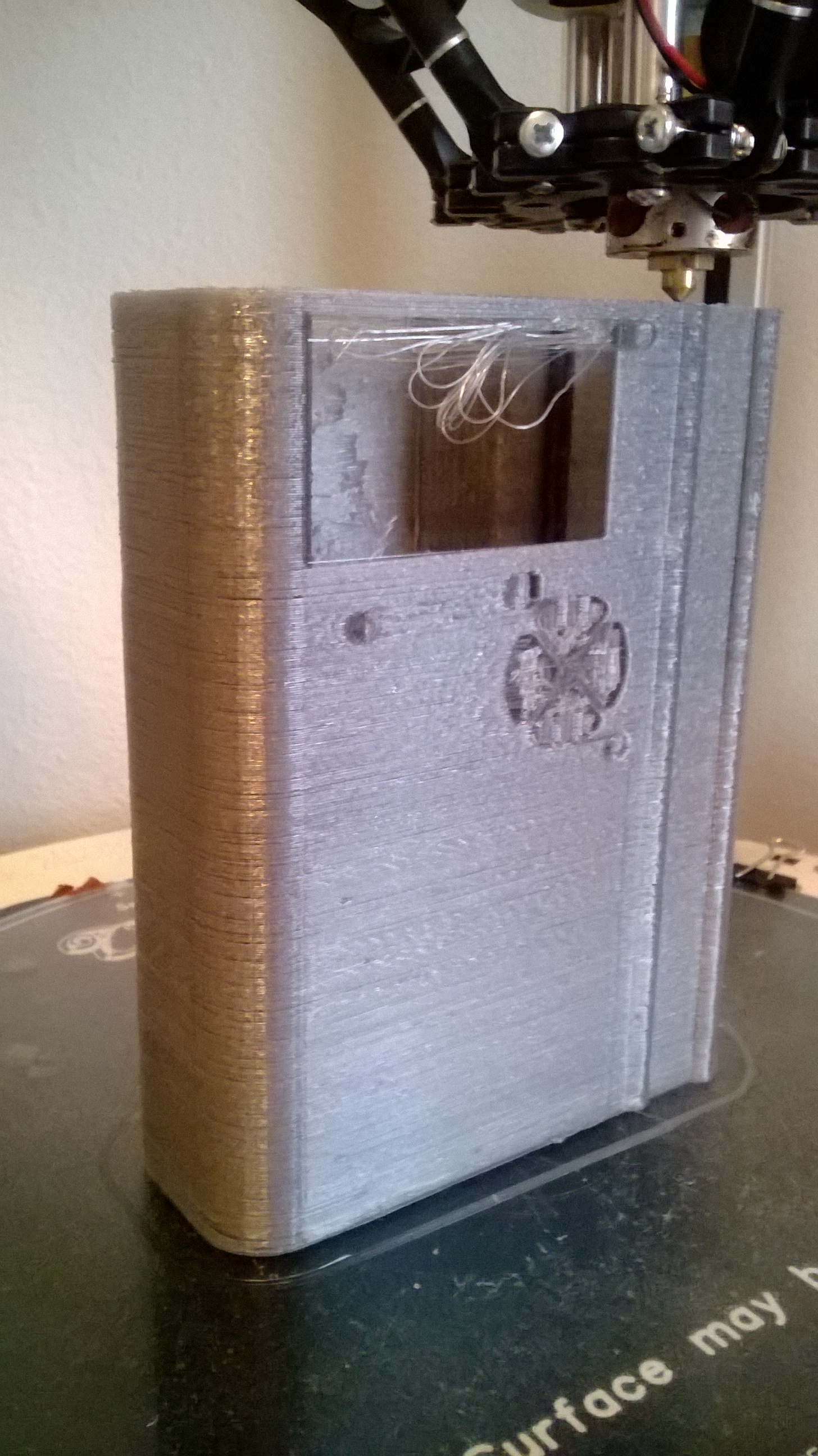

This is my first print with the new hardware. So far I've installed the fans, EZStruder and tricklaser arms. I LOVE THE NEW EZSTRUDER! So freakin' easy and reliable. This print took ~12 hrs @ high-speed. This enclosure prototype is 6.3" tall. The quality is much better when I slow things down.
The only thing I did to "calibrate" the rostock for my new hardware was change the number of steps per mm for the extruder and the Z home for my new .35mm tip.
Any suggestions on calibrating are appreciated.

The best idea on how to calibrate is to download the latest copy of Geneb's assembly manual and follow the calibration instructions in the manual.
Your print looks good for not being calibrated except for the strings, just think how good it will be after you do a complete calibration.

Thanks, that's what I'll do (follow Geneb's instructions). About selling it, right now I'm happy. I've printed about a dozen things since I posted last and nothing horrible has happened.Eaglezsoar wrote:The best idea on how to calibrate is to download the latest copy of Geneb's assembly manual and follow the calibration instructions in the manual.

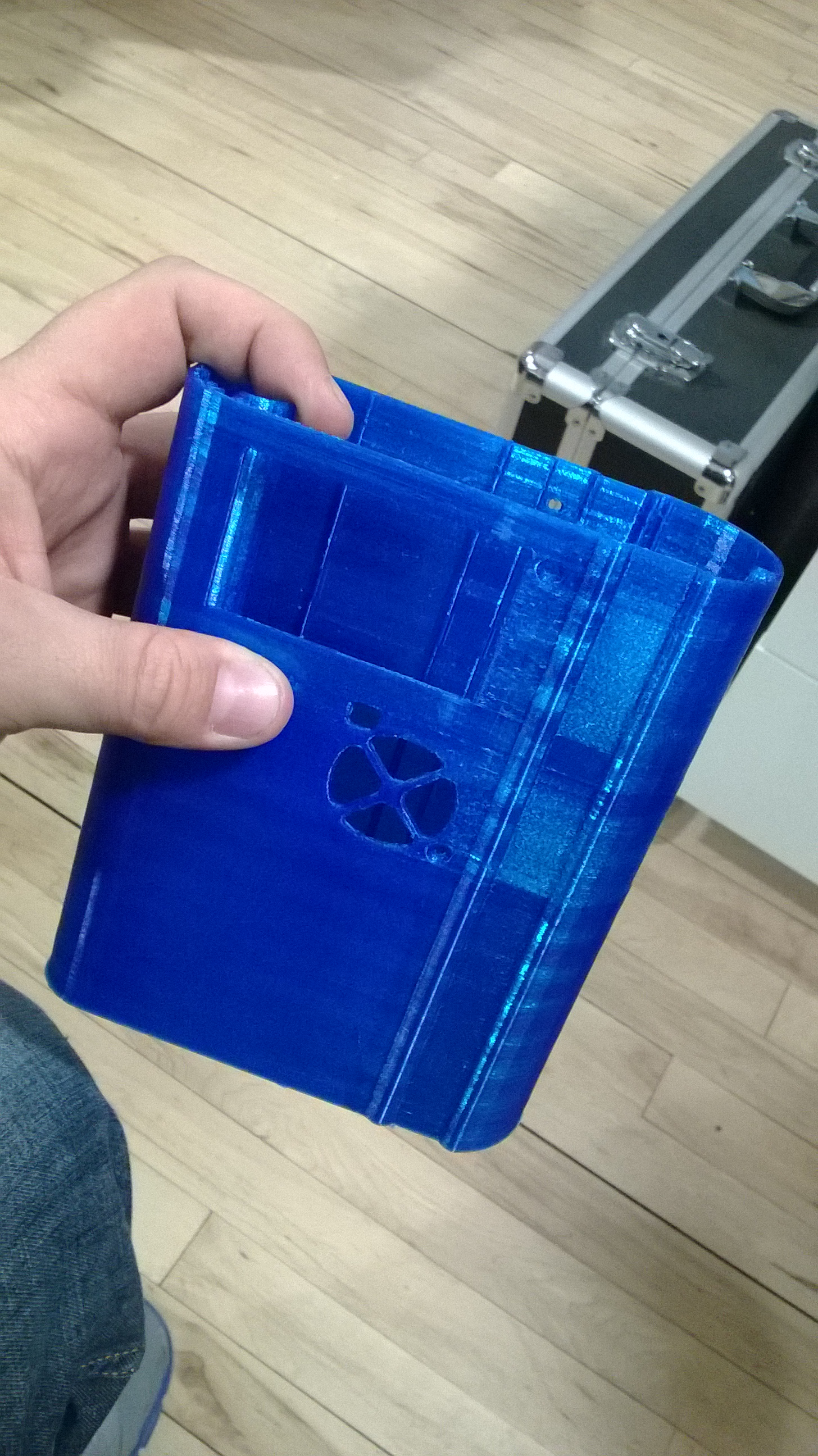

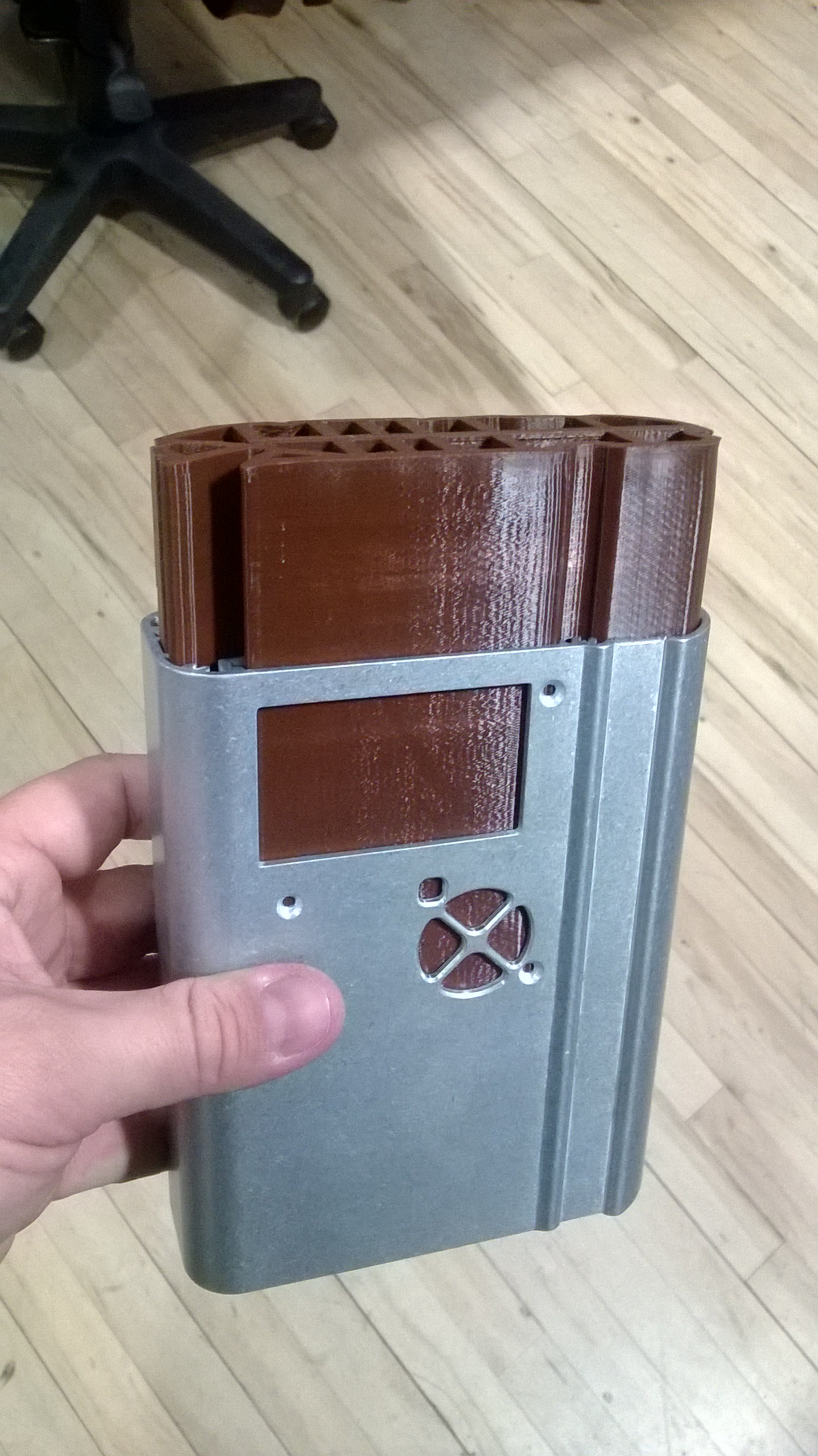

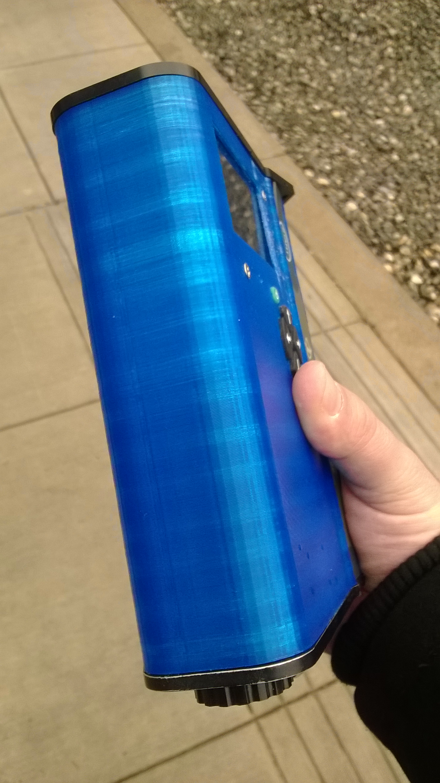

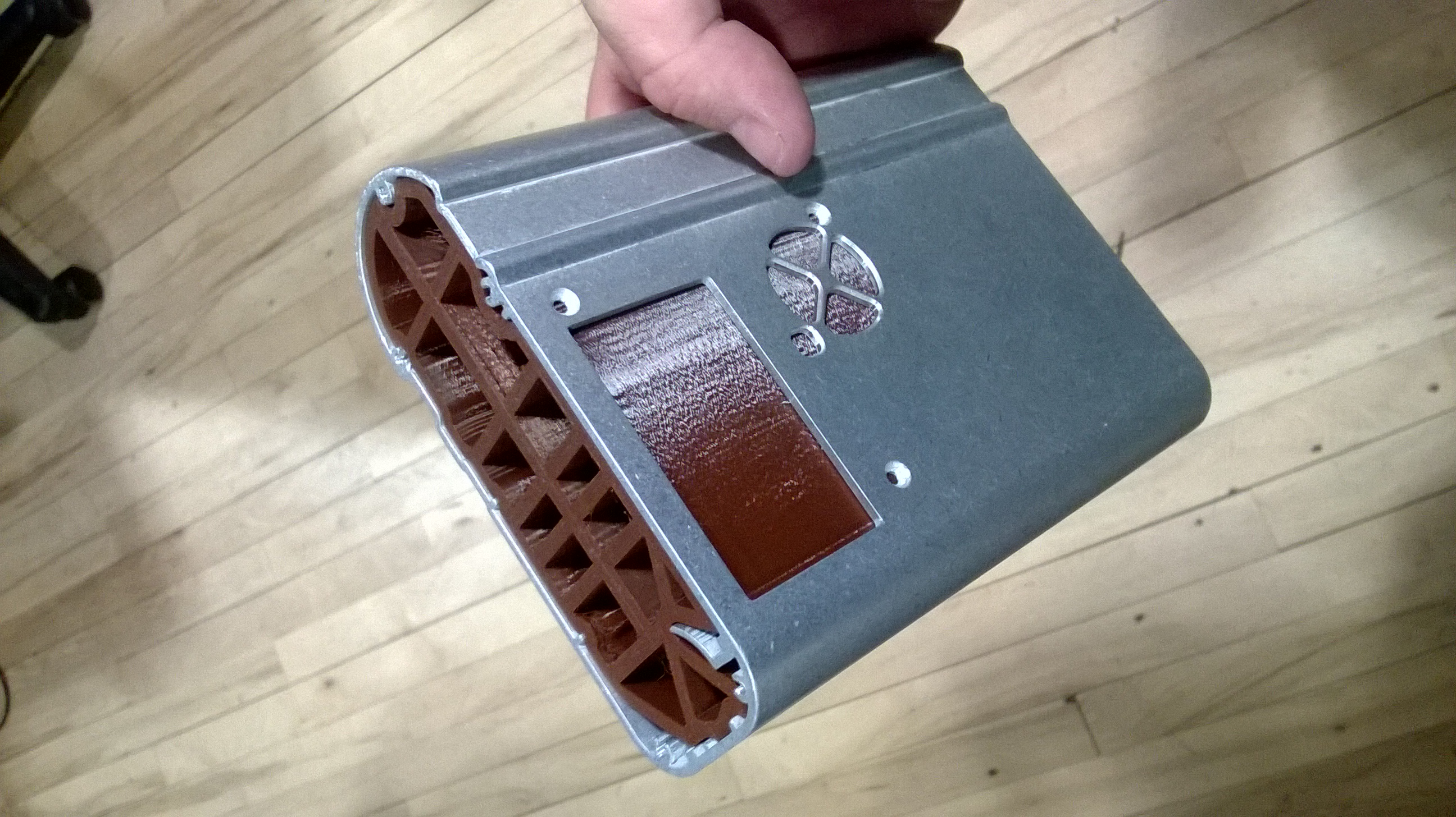

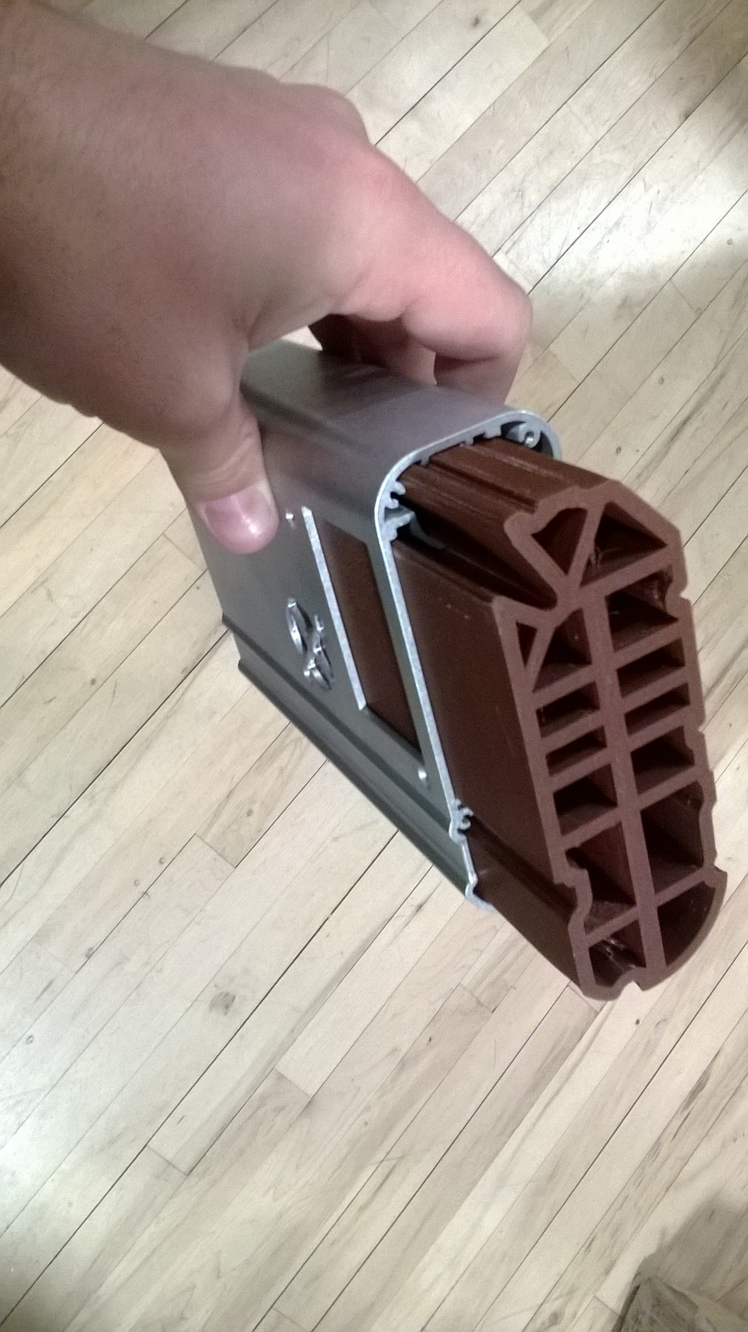

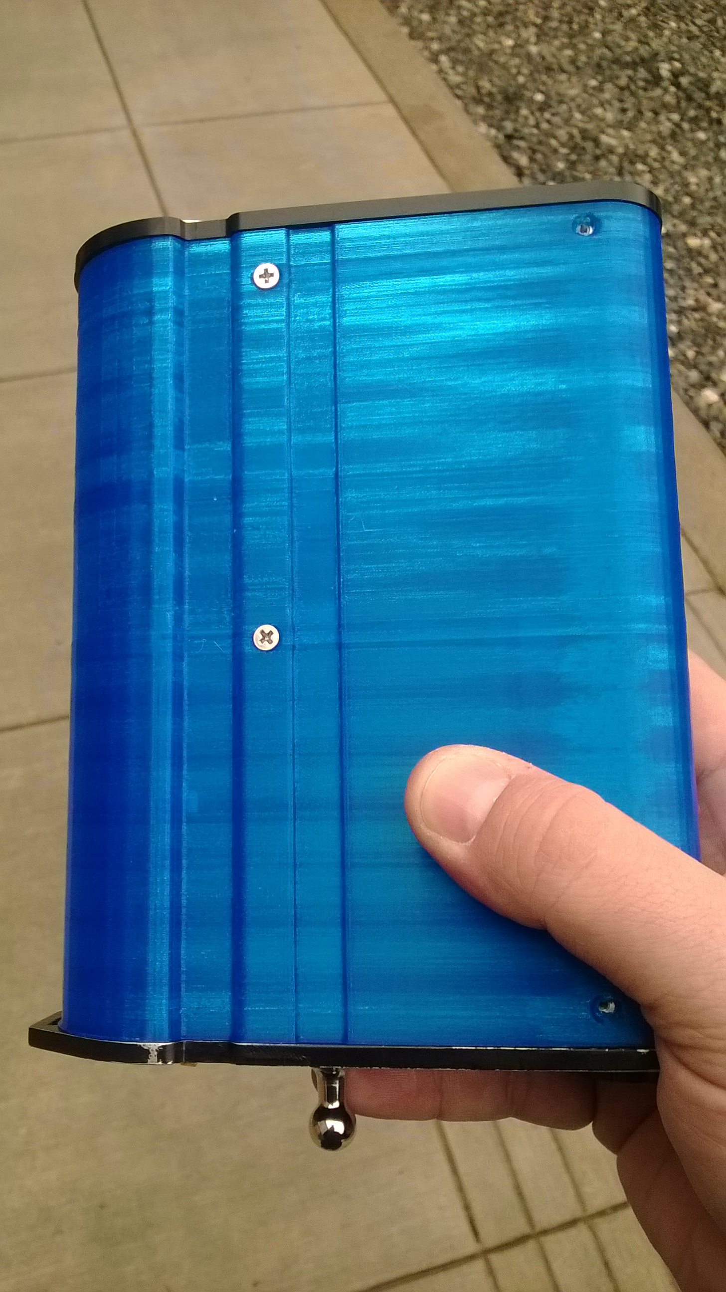

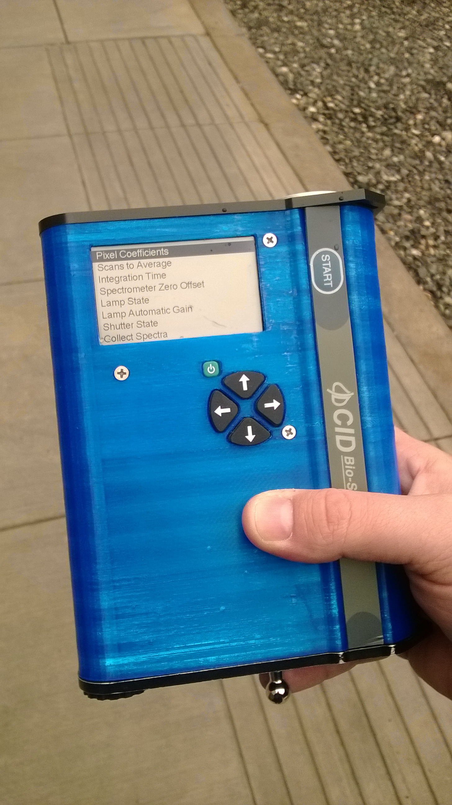

Attached are images of my latest creation (the blue enclosure for a new instrument my employer is building). I bought my Rostock Max to make useful things to boost my career. And at least in some small way, mission accomplished!
As you can see I had a little problem with my PTFE fittings. I've ordered replacements but until they arrive I've found duct-tape and zip-ties get the job done.
EDIT:

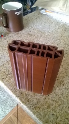

1) FYI, that brown object being printed is a Stiffener. The PLA enclosure was just for development. We had the actual enclosures extruded out of aluminum. The guy in our shop tried to cut the features (holes for screen, keys, etc.) but the aluminum was too thin and bent. So I was asked to print this stiffener to place inside the extrusion which worked great for the guy in our shop. ...Kindof a cool use of a PLA model IMHO (my bosses idea).
2) Obviously this is the case after a lot of use and wear. The thing my employer likes the most about the models I print, they're plenty strong for what we do. We had a couple of prototypes printed by Shape-a-ways and a local Z-Print operation. Obviously the Z-Print model fell apart right away. The Shape-a-ways model (plastic) worked great, but was a lot more flexible. The PLA feels different than the aluminum models, but it's the closest by far.
EDIT:

I came across this thread a while ago and wondered what ever happened. Glad to see everything worked out for you! The case looks slick!

That case looks great. this is exactly what these printer are for proto type work. great job and glad you did not sell.

Oh neat! a real tri-corder!
- Posts: 42
- Joined: Thu Feb 07, 2013 3:10 am
Re: Upgrade or throw away?
I would say no, because in my mind a tricorder captures and analysis every useful wavelength and can be used from a good distance (several feet at least). With our instrument fruit on the tree/vine, etc. need to be placed right up against the glass. And our device only covers 390-1190nm, that's only a tiny fraction of all the useful wavelengths.Chrissi wrote:Oh neat! a real tri-corder!
But considering that Georgia Tech called their simple multi-spectral device a tricorder, it seems like I should be able to call ours one. Our device uses a very expensive low-noise spectrometer (think hyper-spectral not multi-spectral) it does real-time analysis and it's programmable.

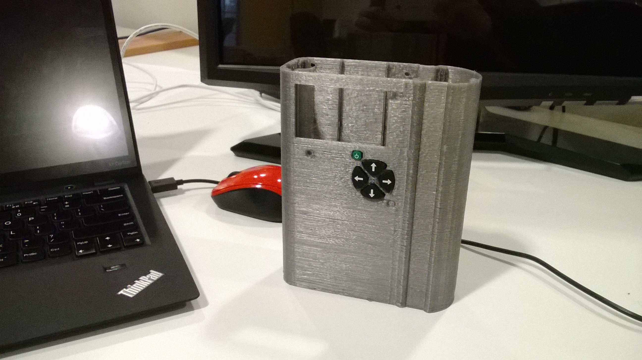

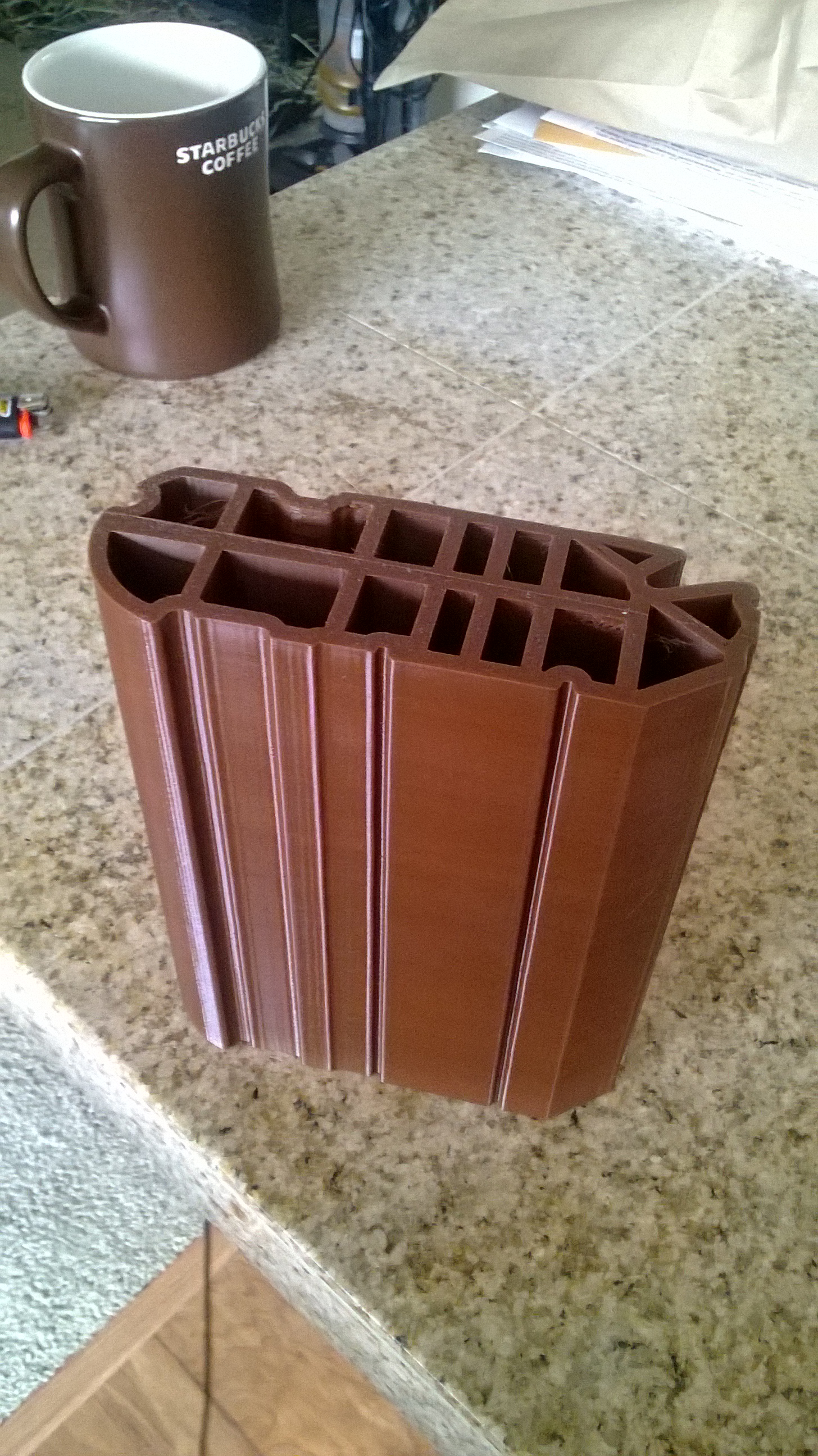

Nothing really. In that shot of my printer you can see I squirted out one of those EZStruder fixtures (also a spindle for the spool up top). I love the EZStruder.McSlappy wrote:Wow that case kicks ass! What else have you made?!!?

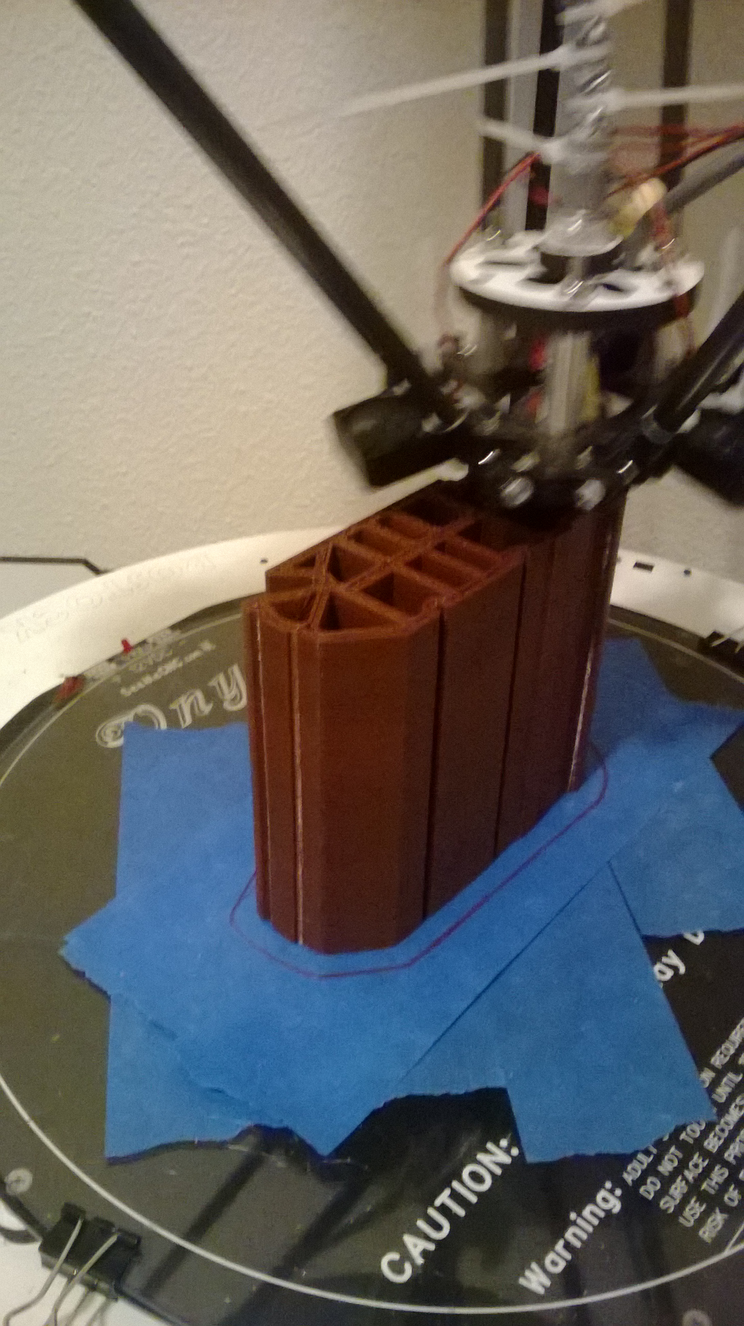

Right now I'm printing more a few more stiffeners for the shop (they wanted a few to speedup their process). Next I'll probably print some ducts for my fans. Right now they're just zip-tied on.
I'm using 75mm/s and 230C (my thermistor is probably wack) with PLA. It takes me 12+ hrs to print the stiffener (~7x4x2") included in this shot. Is that normal? What's the fastest I can realistically print?

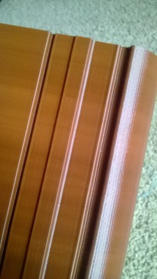

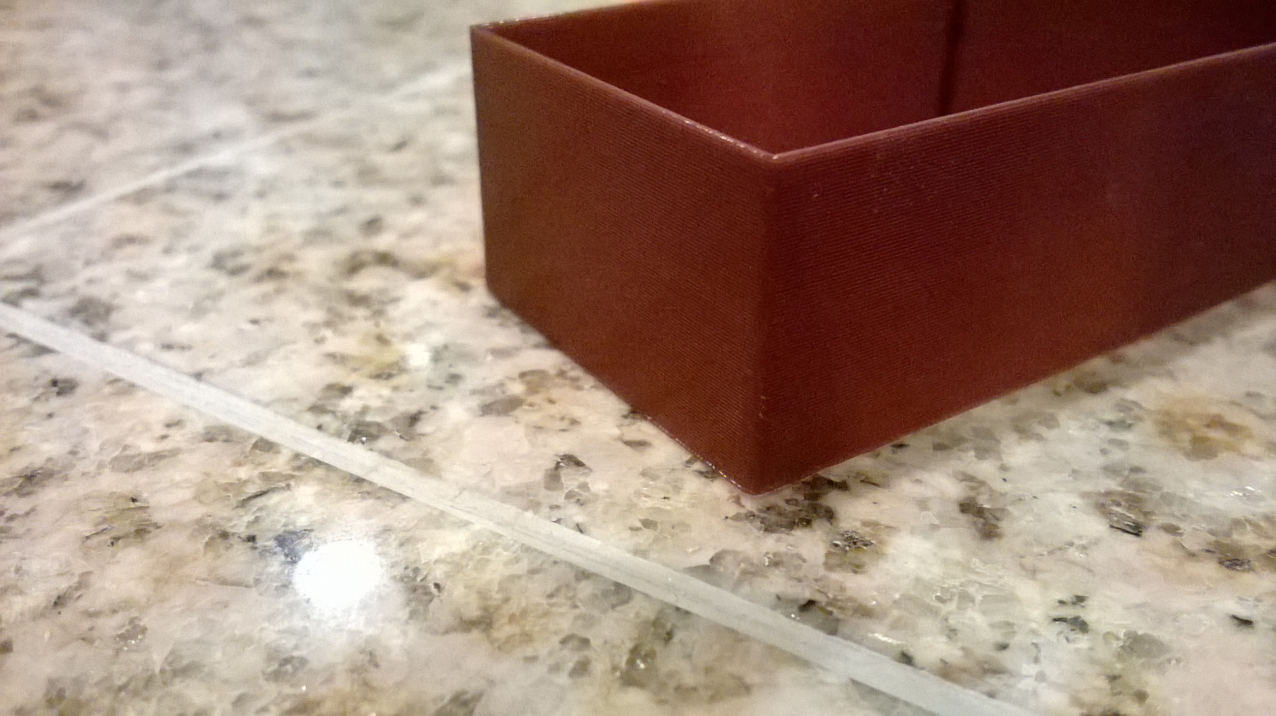

That last post makes the stiffener look low quality. I'll upload a close-up when it's done printing.

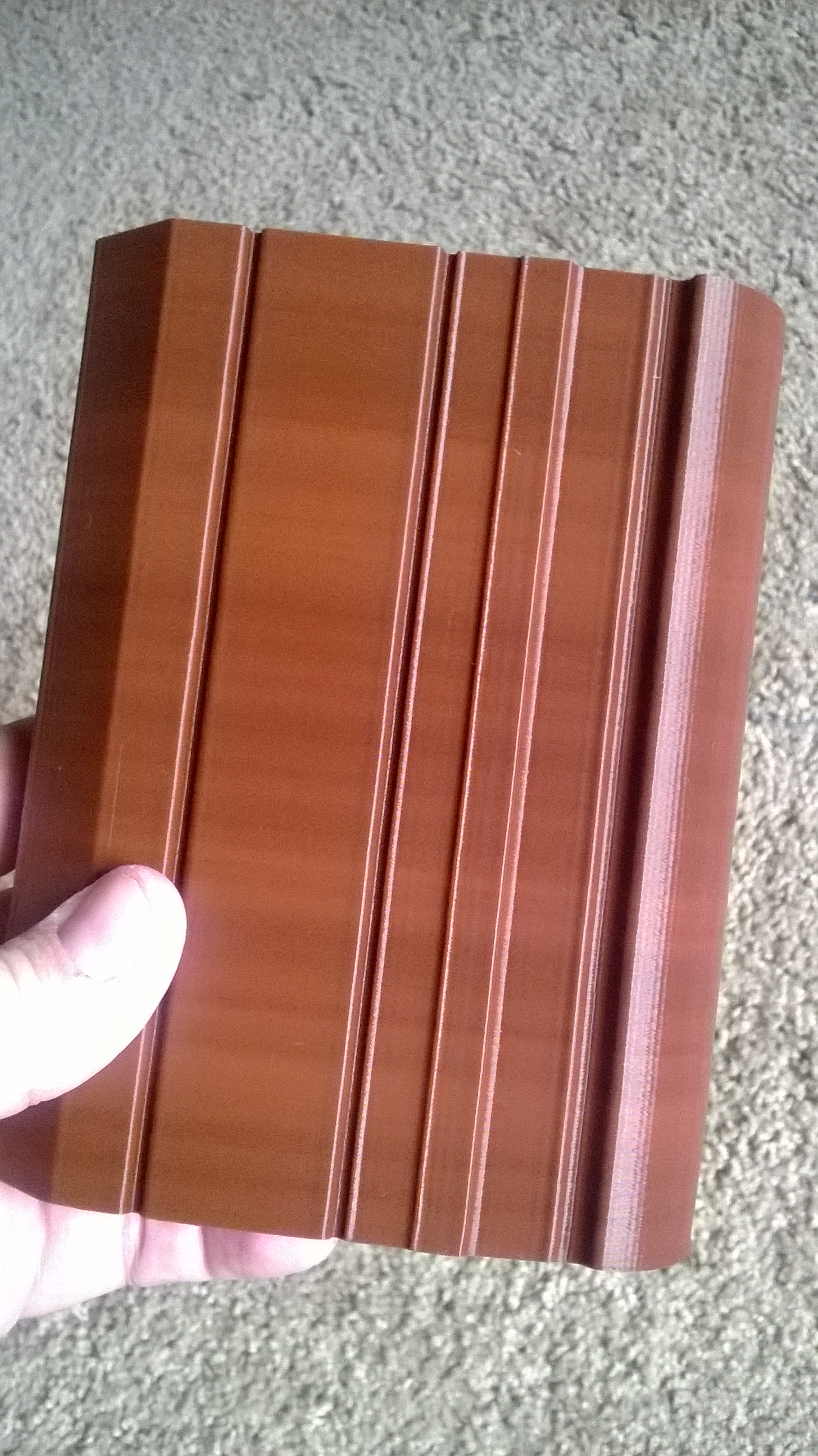

This is just something I printed early today when I was fiddling around. This is the kind of quality I see at 75 mm/s even on my large 6-7" models.
That looks great!

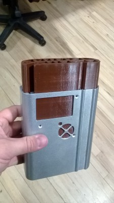

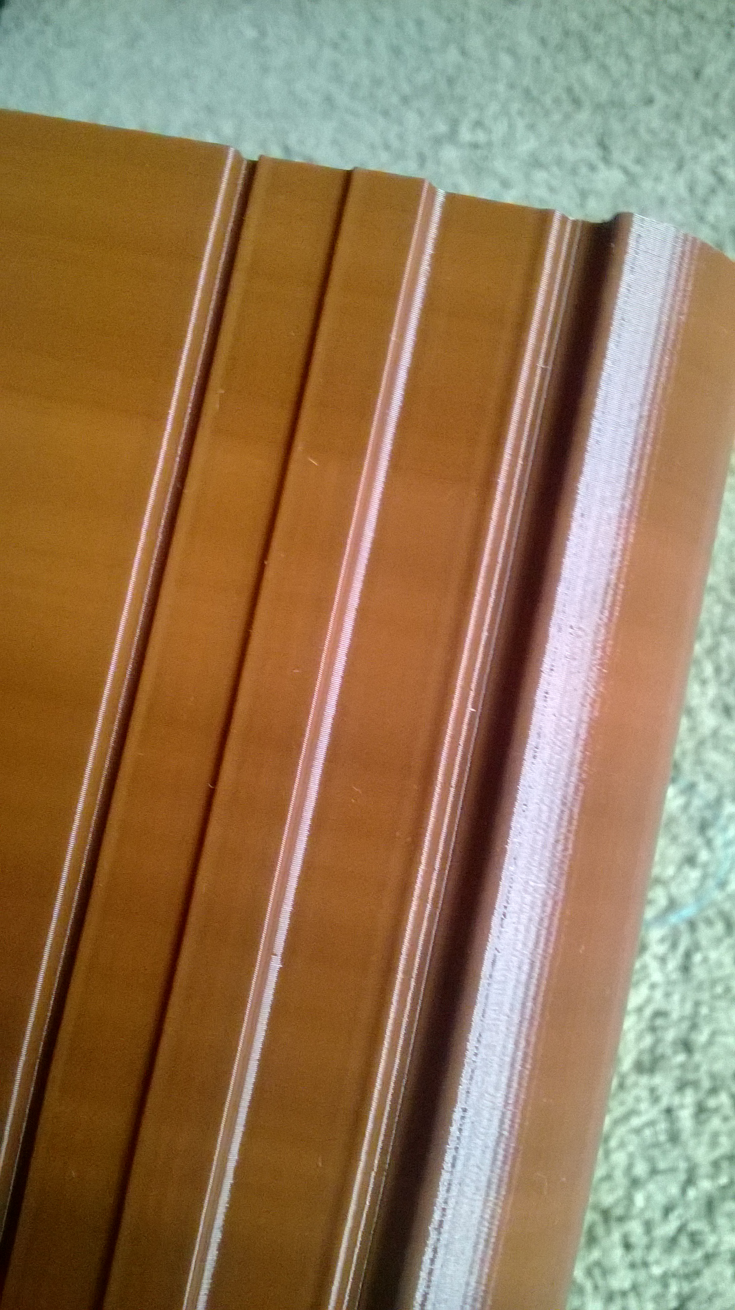

I printed this yesterday. The PLA doesn't like my camera phone. It looks much better in person. More importantly, it fits PERFECTLY in the aluminum extrusion it was made for.
