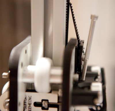

I'm a complete novice trying to finish my Wood kit build from where the UStream videos left off. Here are my endstop questions:
Question 1:
From the Reprap wiki page: "Endstops are actuated and adjusted by screws located on the cheapskate u-joint mounts."
I'm guessing that's the 2" 6-32 socket head screws. But I can't get the screw in vertical because the belt clamp is in the way. I've attached a picture. Is it supposed to be hard up against the belt clamp?

Barnett. We were alerted to the belt clamp issue. We have since made the change, the u joint mounts now have two holes, one further out to allow clearance around the belt clamp. You can drill a new hole using an 1/8" drill bit, its a good size for the screws to self tap into. As for endstop sires, there is a small slit in the upper t slot mount and thr bottom. This allows you to fish the endstop wires thru the hole in the center of the tslots. We will get that fact noted on the wiki page. Weve been pretty jammed om getting all the kits done, so I havnt had much wiki time. Remember guys, its all editable by you as well, so if you feel there needs to be something added, dont be afraid to jump on and add it too! Jassper has been a huge help, even though he has the black/yellow machine that everyone keeps asking about. Lol

Thanks for the quick reply! I'll drill new holes and run the wires as you suggest I was worried the wires would be too close to the belt at the top there. If anyone has a photo of what it's supposed to look like up there it would help me. I'll post mine once I do it (probably this weekend).

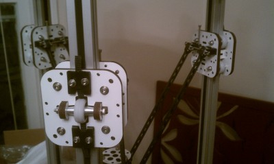

I also had this problem with the end-stop bolt hole. I found it easier to drill holes in the back cheapskate plate and move the belt clamps there so that they no longer interfered. You can see what I did in the crappy cell-phone picture below.
