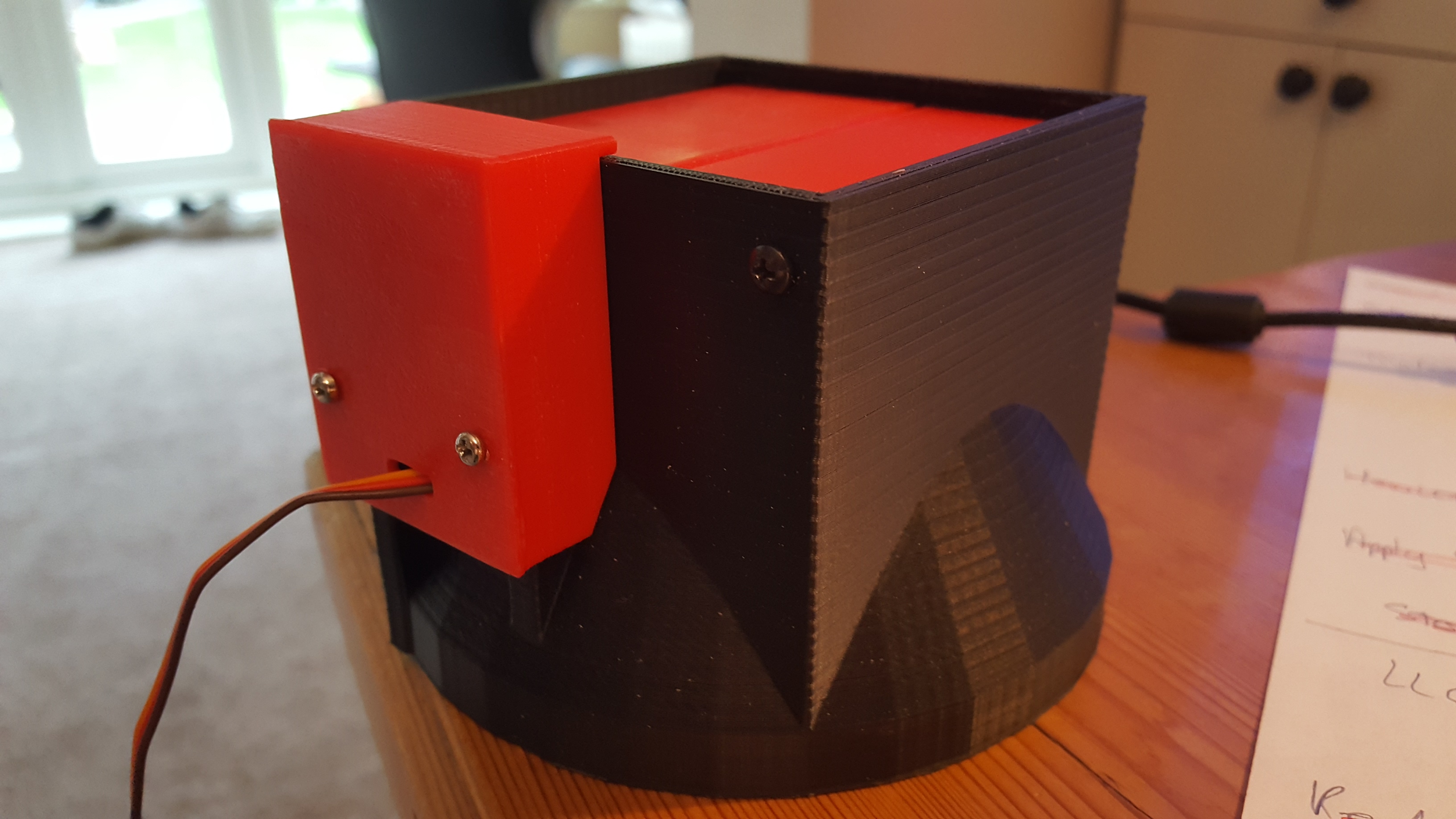

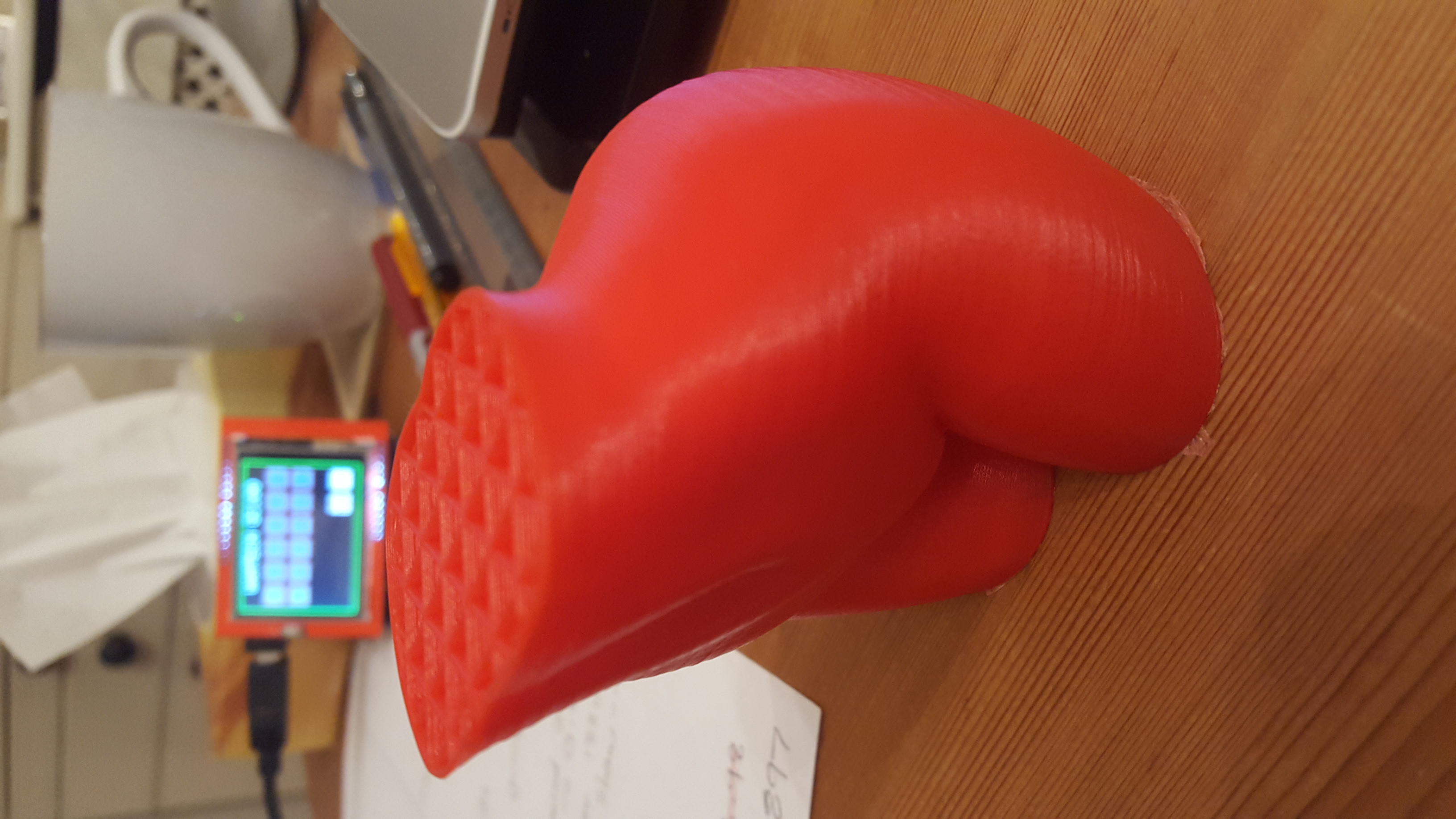

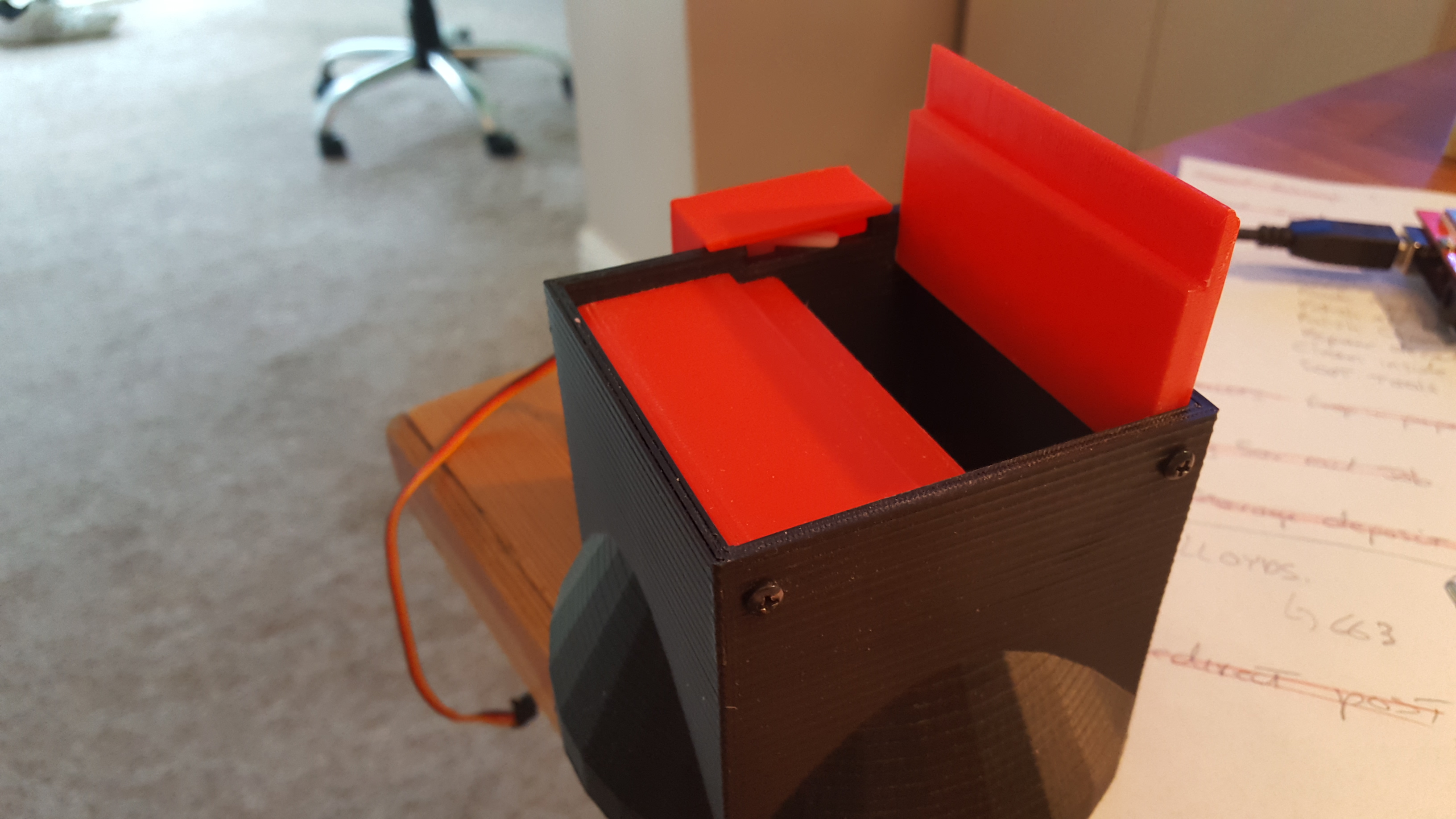

What... its.... printed.... something.... correctly
I am sure it could be better, but finally.... something that actually goes together and works (servo operated release valve)
Its the best quality I have had out of it by far

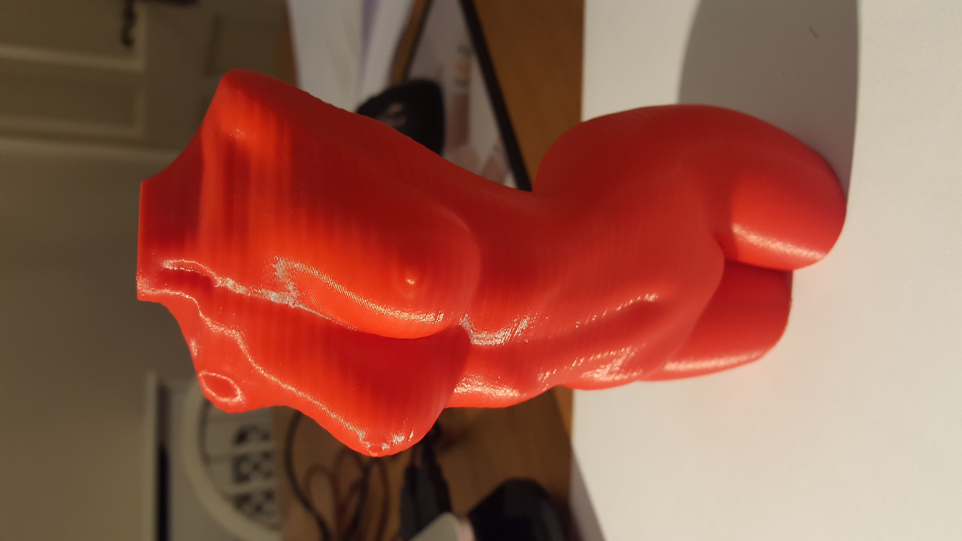

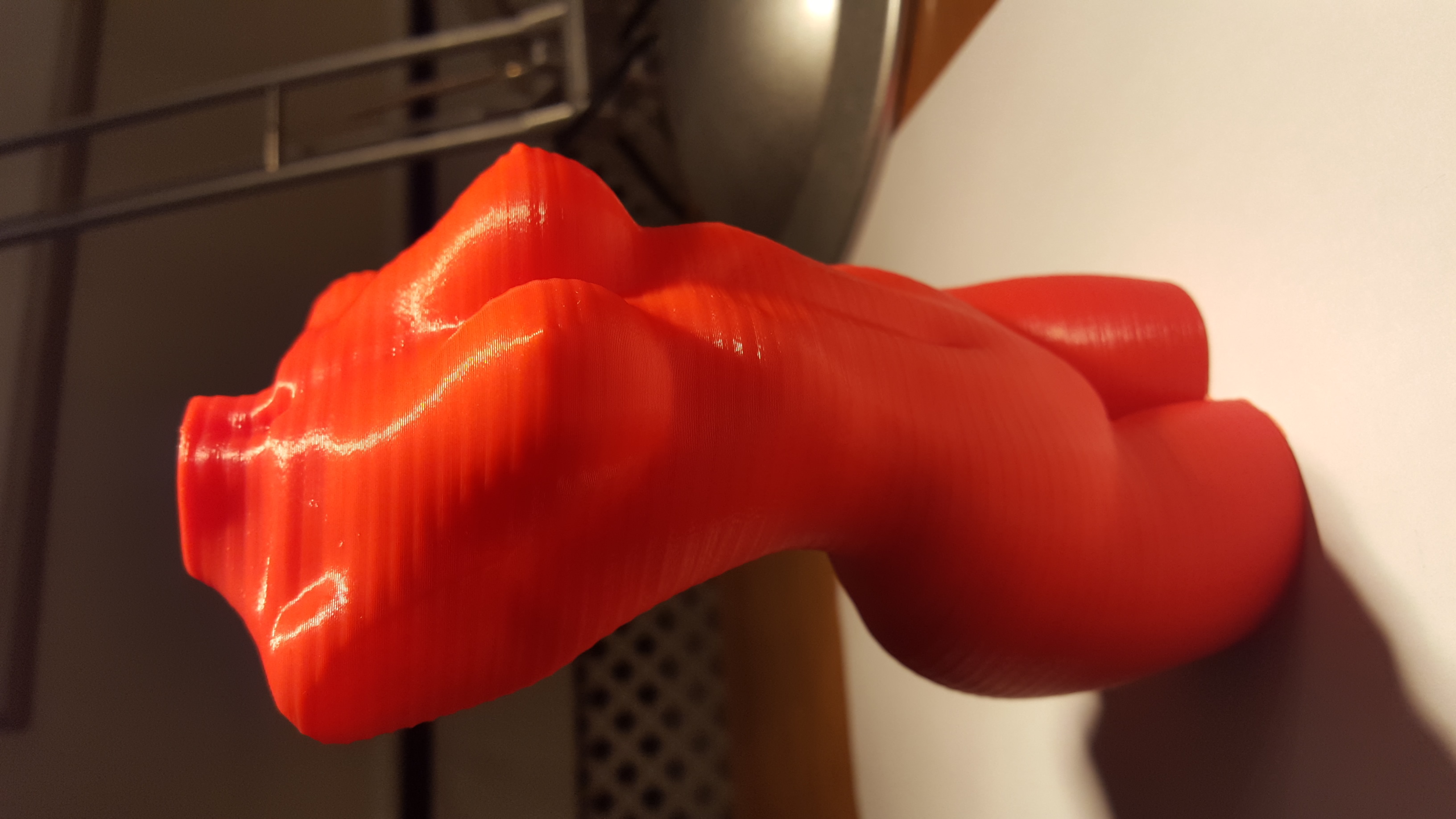

Was printing very well and then the print head just stopped with no warning. Just sat there. Hotend stayed at full temp, it just seemed to grind to a halt.
Is there a limit to the G-code size that can be read off an sd card? I checked the slicing before putting it on the card and it sliced fine.
Just seemed to lose the G-code commands.
(edit - just checked the G-code slicing in an online viewer and it seems fine and complete)
