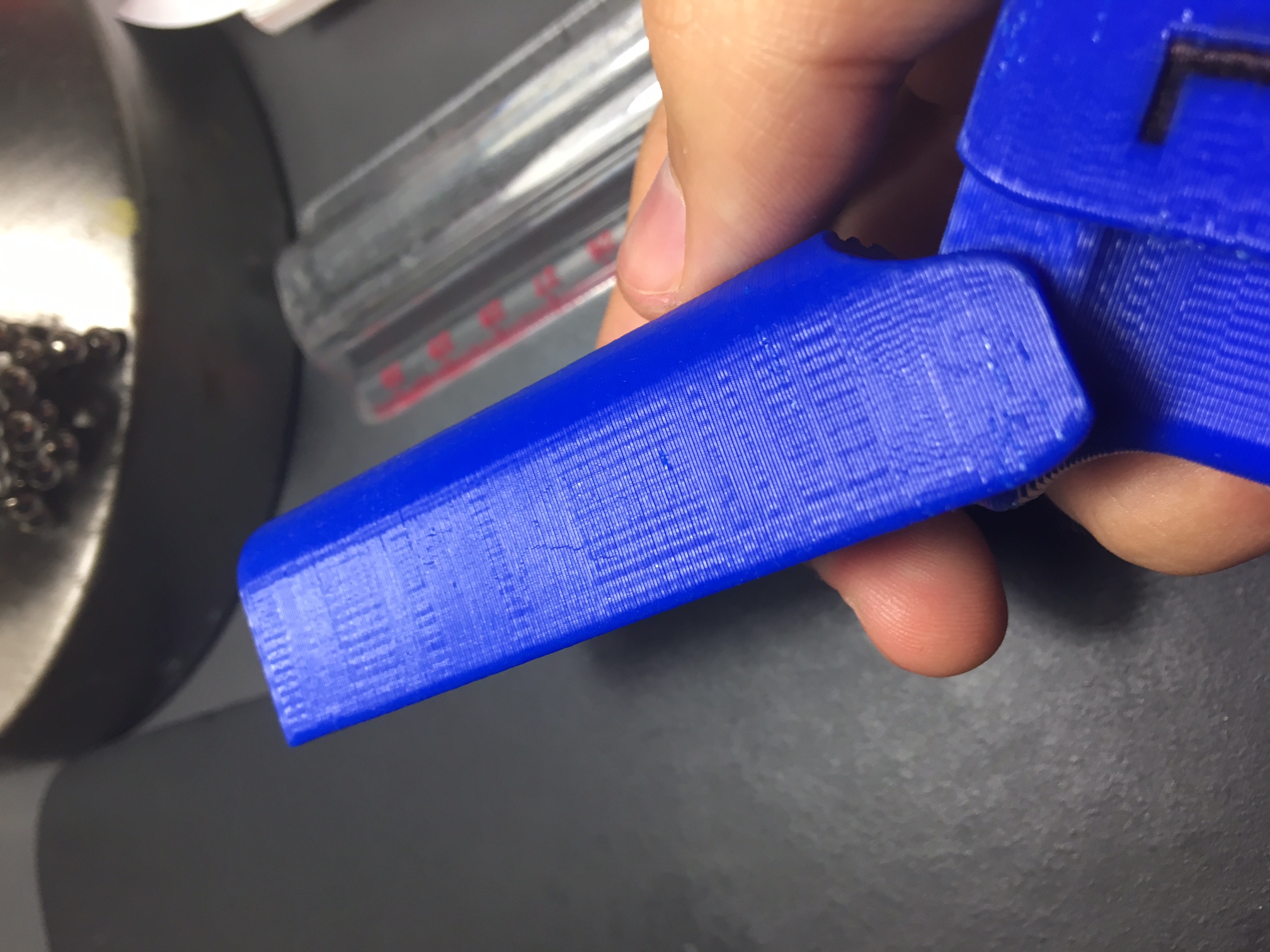

I was looking at 3D Hubs earlier today and i noticed that the in the cons of the Rostock Max v2 it says how the printer "lacks precision." Why is this?
I was thinking that maybe it could be because all Rostocks come standard with a .5mm nozzle and I was wondering if that could be it?
As in maybe the increased nozzle size does not allow prints to appear as detailed or precise as a cartesian printer that comes standard with a .4mm nozzle (such as the Prusa i3) which is praised for its ultimaker-like accuracy and quality.
I noticed that the prints I produce don't come out as accurate as I'd had gotten used to after using my friend's makerbot for a time before I bought the Max. But I still think that this is because I have not fully calibrated every single part of the printer, considering I see a lot of rippling in the straight edges of prints and I can only print at 27mm/s.
So i was thinking that maybe if i bought a .4mm nozzle for the printer, maybe my prints would turn out better than they are now? I really want precise and perfect prints and I can't seem to get that right now.
Thanks :)

There are a few reasons a quick review might say that. Firstly, the nozzle size as you noted. The fairly standard E3D style nozzle should fit in the HE280, and there are .4 nozzles available from Seeme for it as well. So you could go down to .2 for nozzle size if you wanted to.
Secondly, the precision achievable by the drivetrain is not exactly equal over the entire bed. The center is most precise, while the edges gradually drop off in precision (Admittedly, they do pretty well for minimizing error, but say, the Orion, would have much more issues working a Rmax style bed if you could even fit one in it.) The closer you are to the tower radius, the less it has to work with on at least one axis of travel. It's inherent to the mechanism.
Thirdly, the Rambo and Repetier are not very powerful computationally. In order to handle the kinematics and step generation, and work at a relatively high rate of speed, it has to segment paths somewhat. This causes your rippling you're observing (Note that the deviation from specification is very minor and it's more noticeable visually than with a straight edge due to the way plastics behave). Other boards with other firmwares, most especially the Duet WIFI (and to a very slightly lesser extent, the original Duet board), have segment-less kinematics for delta printers, as well as much more powerful CPU's and the Smoothie 2 pro promises a massive improvement due to dedicated co-processors. However, these require changing the controller boards and firmware, as well as often the wiring harness. Eventually, we may see Ultimachine release the much rumored Archim (a name I've heard thrown around but never confirmed for a 32 bit RAMBO successor), which may well be a drop in replacement. These improve performance in a number of ways, but are expensive changes to make.
Fourthly, Deltas are MUCH harder to calibrate completely, and most people are not going to take the time to perfectly dial in their printer before reviewing it, especially when it takes so very much time. This has some negative effect on the reputation for precision (Although it also makes people who can achieve perfect prints every time like Mike look like wizards).

So say if i wanted to get rid of these ripples that I have on all of my prints, would you suggest that I wait for this "Archim" board to replace my Rambo? (or get a Duet Wifi... maybe?) The ripples only appear on certain layer heights, and considering I am going to start selling prints soon, I find this to be quite a bad way to start. (check picture)

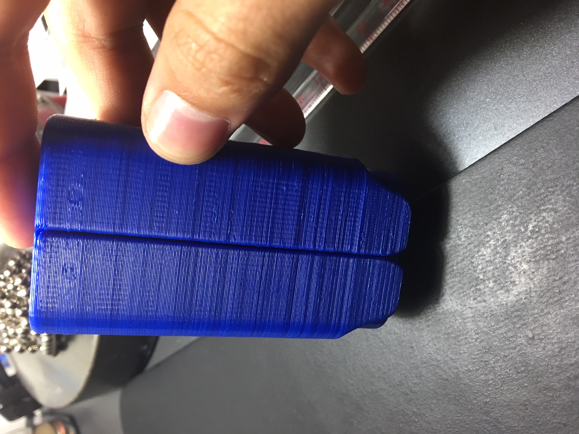

I have also been getting a lot of uneven layers but again, I think this is might be from not calibrating my printer well (though i'm not very sure how i'd be able to fix this)

Looking at the surface, that looks to be the processor artifacting (The faint vertical lines), in addition to either a series of travel speed changes or heated bed over/undershoots. It could also be that the hotend is having some difficulty getting to the ideal temperature (Likely due to a goofy PID, as the autotune is far from perfect).
I would go for a Duet of some stripe myself (I did in fact). This will eliminate the vertical banding, but that's not the worst artifact. I would use a host that does temperature graphing and determine if any of the horizontal bands line up with variations in bed/hotend temperature. I might also build an enclosure for the printer, in order to keep drafts from opening and closing doors or AC from affecting prints.
There is also a possibility of resonance. This would occur at certain speeds while printing and could cause any number of artifacts. If the G-code for those models shows a similar travel speed for the ranges where the bands occur, try changing the speed around to see if they move.

Resonance is typically more likely to arise at higher speeds rather than lower speeds. However, if you print 2 objects in a row with the same G code (I suggest off an SD card to eliminate slicer/communication weirdness), and the artifacts remain in the same relative position between them, rather than being somewhat randomly distributed, it would point towards resonance.
