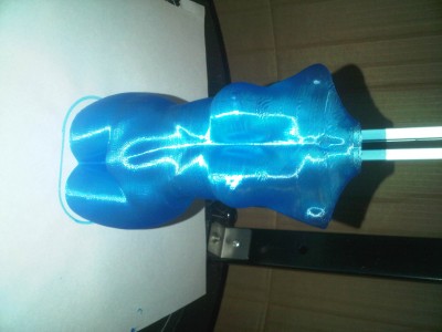

Gene you say it is not for deltas but it worked awsome for me this morning when I tried it and made monstrous difference ran the seeme exe that john posted. When I ran thru the calibration sequence mine also during one step didnt hold the paper like it said but I believe that it was because the unit maxed out at 0 but I didnt change the endstops just continued the sequence and ran it. I figured that I would print the lady bust figurine in pla which I have never used till this morning and holy toledo it ran sweet as all get out ill post pic tomorrow laid down immediately and never skipped a beat. Im curious does software allow you to watch on screen I seem to miss where that is, i always seem to have my chin glued to the base watching under the effector instead but reptier you couls see on screen also. Please dont bust my bubble Gene sya it does work just for me.

- Posts: 99
- Joined: Wed Jun 06, 2012 3:59 pm
Re: Matter Control Software
Aw isn't she transparent hmmm seems familiar.
