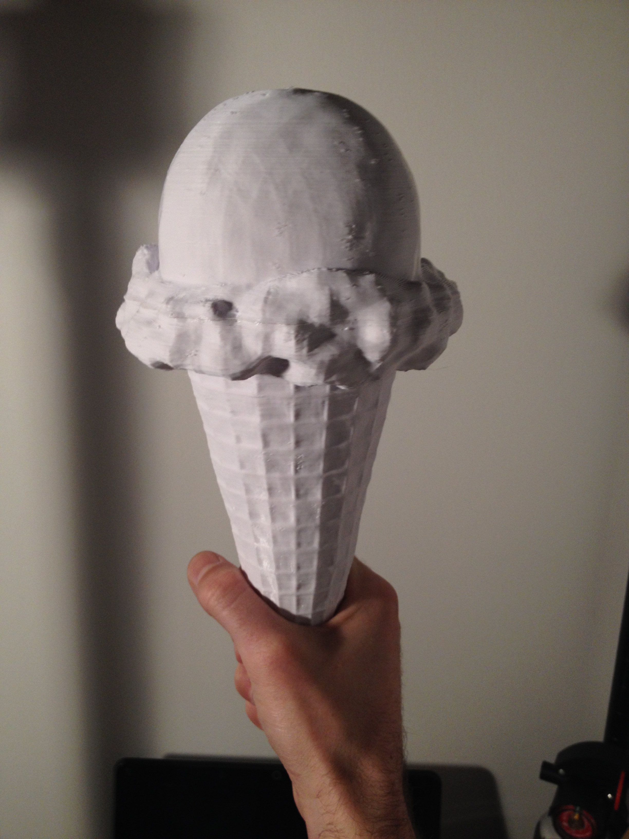

Re: Goodbye Orion
I hate to beat a dead horse, but...
Today I switched from a .35mm nozzle to a .8mm for a different print. I forgot to check my z-height calibration. As you can expect...
It worked perfectly. Didn't have to re-calibrate a thing, even though I switched the nozzle AND material...

I meant .7mm nozzle in my last post, btw. (I set it to .8mm though, oops.)
In my experience, if you don't knock the thing around too much, it requires zero adjustment after a move. I took it from my apt, to another apartment 5 floors down, and nothing required adjusting.

Re: Goodbye Orion
But I mean, I did this first try without calibrating after changing nozzle and material... SeeMeCNC is doing something right. (This is still all stock, haven't added my e3d yet)
*not actually a robot
Re: Goodbye Orion
bot wrote:But I mean, I did this first try without calibrating after changing nozzle and material... SeeMeCNC is doing something right. (This is still all stock, haven't added my e3d yet)
That's a great cone. Could you provide a .stl? Or a link? My wife would love that.
