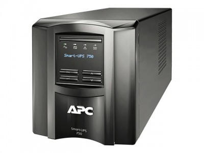

Hmm, I was thinking about a UPS also, mainly to troubleshoot the PSU shutting down. Or mainly to deduct that it is not a flaky mains that cause it ;-) How heavy a UPS would I need to be able to give out enough power?

If you're talking about the 24V supply, it is likely that you'll need ~90W+the wattage of the 24V supply (for the other stuff if those still use a 12V supply, otherwise just use the wattage of the power supply as a guideline with ~15 minutes of capacity. This should be a 600-800VA unit, with at least 200Wh. However, knowing you're in Europe, I won't make specific recomendations, since almost none of the UPS's here are designed for 220V. Be aware though that most UPS's put out a pretty crappy sine wave, so if you think it's a mains issue, go for either something like a power meter (the Kill-a-watt type devices are relatively common in the US, there should be a european equivalent), or a pure sine wave UPS (These are much more expensive than the equivalent without these functions).

Thanks. I am driving the whole 12V and 24V through the same PSU through a stepdown converter. The wattage of the PSU is 600W (with a start capacity of twice that for 5 seconds). I think the Smart UPS like the one below are said to generate pure sine wave. In our IT company we have some minor experience with the cheaper ones, that cannot even get a HP server started because of the crappy sine (HP server PSU's seem te be affected by this greatly). I wonder why they even make these things... I guess the Smart-UPS 750 is a little on the low capacity or this experiment then? That's a shame, because we often have some of these laying around.

That model is actually line interactive, you would only see "true sine" when the power was off.
http://www.apc.com/us/en/faqs/FA157448/

Thanks for the info. On that APC page explaining the different type of UPS's they sell, there is no mention of the term "true sine" at all. Why is having true sine important if the usual mains equipment runs on does not provide that either?

Because there are a lot of cheap UPS that use a square wave, or modified sine that can't power certain equipment while it IS in use.

morgandc wrote:Because there are a lot of cheap UPS that use a square wave, or modified sine that can't power certain equipment while it IS in use.
Yes I know, but if also the mains does not provide True Sine (of which my understanding is limited, hence the question) which I deducted from your phrase
morgandc wrote:That model is actually line interactive, you would only see "true sine" when the power was off.
Then why should a UPS do that? After all both mains and ups output are used to drive the same equipment? I guess a "block sine" is another deal compared to that what comes out of our wall outlets ;-)

Line interactive means that the UPS in some way modifies the current coming from the wall. In some cases, this is to avoid having to use a fast relay or MOSFET to switch from wall voltage to battery, as it will always run off the battery, which may occur in units which have charge and discharge circuitry suitable for continuous duty.
As far as true sine versus block sine, and all the other stuff:
Sine waves are smooth curves that alternate between two identical peaks and cross a zero voltage (As far as we're concerned at least). This smooth curves are hard to make with digital equipment such as you would find in a UPS, as it's a lot easier to just supply a voltage that is alternatively positive and negative (Or just a DC voltage at the RMS voltage, as was mentioned earlier). Producing even an approximation of the wave requires more precise control of the switching, as well as no end of inductors and capacitors to clean the power up, as well as no small amount of monitoring to ensure you're actually getting close. Thus Pure sine units are expensive, and for many many years largely weren't available at standard pricing.
However, modern power supplies in some increasing number of cases are becoming more intelligent, and are attempting to correct for the phase angle (Power factor, essentially), of the wall voltage, through some amount of trickery with adjustable capacitors and inductors, and other sensing. These largely assume that you're actually feeding wall voltage, AKA, a sine wave to them. Which means that easy DC voltage at the RMS voltage goes out the window, as well as severely missing on the square wave. Thus "Pure sine" UPS's came into more common use. Now, if you're experiencing reliability issues from the power supply and suspect either a brownout (Fails when load suddenly increases), or other issues with the wall voltage causing it to fail/shut down, as you mentioned, then it may be that the power factor in your area is bad (Unbalanced capacitance or inductance causing the phase angle of the power delivery to be out of whack. This is most easily measured with a power meter such as a Kill-a-watt, as I mentioned, and alternatively with an oscilloscope or a scope-meter (Not cheap, and check that they support mains voltage), or that the startup current is so large due to inductance or capacitance as to cause a momentary voltage sag that causes the unit to cut out. In the first case (Brownout), it is easy enough to check by plugging the machine into separate circuits in the house, although this may require an extension cord if there is only one circuit in a room, which I am given to understand is more common in Europe (And indeed, I've heard of some circuit designs where there are only a small number in the house, typically lighting, kitchen appliances, bathrooms and wall outlets), or by removing as much load as possible from the circuit if the printer can't be spread (As in your case). You could also use a multimeter with a hold function to check the lowest voltage across the power supply input terminals. A multimeter typically cannot measure power factor, as that requires reading the phase angle, which would require tracking current and amperage at the same time, and with a sample buffer suitable to store at least 1 cycle worth of data (It could be done with less, as you could potentially determine it from a single set of peaks, however it is more typical to use more samples to improve accuracy). Instead, dedicated meters are required unless you feel like buying a scope suited for mains voltage.
