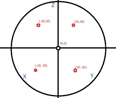

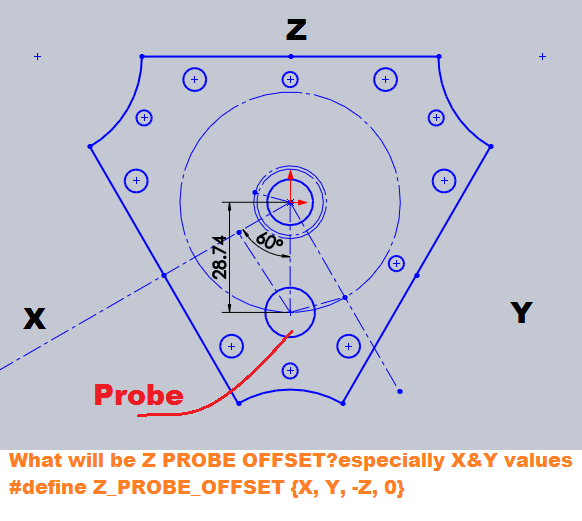

I need help from forum... I want to implement autocalbration function. Can someone see the attached picture and tell What will be Z PROBE OFFSET?especially X&Y values in the following expression:
#define Z_PROBE_OFFSET {X, Y, -Z, 0}

Re: My DELTA-1
I don't personally use a Z-probe myself, but I believe that the Z-probe offset will be determined by yourself in where you decide to rig up your z-probe. You will need to directly measure the offset (x and y) of the Z-probe you install, from the X,Y of the center of your printer and/or your nozzle's (0,0) position.
Edit: in looking at your diagram, your offset value would be (0,-28.74) assuming that your X and Y towers sit similarly to the SeeMeCNC towers as the "front" towers of the machine with the Z tower being at 0 degrees or 12' O clock position.
2nd Edit: any forum members with more knowledge than myself about this subject, feel free to chime in, as this is all pure conjecture on my part since I don't use a Z-probe.

[quote="lightninjay", your offset value would be (0,-28.74) [/quote]
I agree that your probe is offset 0 in X, -28.74 in Y, and in Z that is something that you need to determine. You have to calibrate your Calibration probe before you can calibrate with it .
The 'problem' with a contact type Z probe is that while you are using it, it needs to have a Z position lower than your nozzle, and then when you print it has to be raised out of the way so it does not hit your print. If your probe is a inductive pickup, it could have a Z position a few mm above your nozzle so that it is always out of the way of the print and does not need to be moved. However, that assumes that it can read distances of a few mm (which I think they can).

- Posts: 276
Re: My DELTA-1
Hi Tonkabot,
Thanks for reply. I am still confused with WHY the Probe offset for X=0?...
I am using inductive probe and it maximum sensing distance (gap)=4mm. I am using 3mm glass. I shall use Aluminum foil adhesive tape as shown in attached picture at glass back side ( non printing side). This way i hope i will get the inductive probe working. Else i am seeing for CS plate only to be used for one time calibration and then i shall use 3mm glass.
The inductive probe very easily detect the Aluminum foil tape.
As far as Z-height setting and probe calibration is concerned i shall just touch the hotend nozzle tip with glass plate and then measure the gap between the probe tip with glass using FEELER GAUGE.
I have to modify Marlin auto-calibration routine to work with inductive probe.

Re: My DELTA-1
Khalid Khattak wrote:Hi Tonkabot,
The coordinates for the delta printer are already translated from the delta arrangement, so the X,Y,Z are all cartesian. So X is left and right, Y 90 degrees to it forward and back.
And of course Z is up and down. The towers are unfortunately named X,Y, and Z but they have nothing to do with the cartesian coordinate system.
so the offset is in the cartesian coordinate system. and your probe, going by your image of the end effector, is at the same X=0 as the print head. The center of your print bed is at X=0, Y=0, and Z= 393.96mm (in my case for my rostock max V2 - yours is different). The home position at the top of the tower is at (0,0,0).
And as long as the pickup only detects the aluminum tape, it sounds like it should work fine. Although any bubbles or bumps in it will probably be detected. just a sheet of aluminum foil from the kitchen without any adhesive might be flatter, although it might not stay put. you can always pop the bubbles with a pin, but then even the pinhole might be detected.

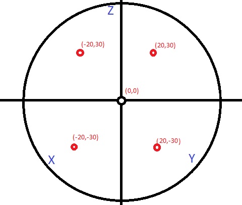

Re: My DELTA-1
Hopefully this helps clear up some of the confusion! The Delta build plate is split into the four positive and negative quadrants of an intersecting X and Y axis.
Here's a diagram to hopefully clarify
- Posts: 276
Re: My DELTA-1
Tonkabot..very very well explained...
lightninjay... Your diagram in connection with Tonkabot helped me a lot.
I am very thankful of both of you for such a great help.
Today i shall see the probe to work with Aluminum foil. Otherwise i shall use bare PCB board below the glass plate as in somewhere else i read that copper is more sensitive to inductive sensors and can detect at longer distance.

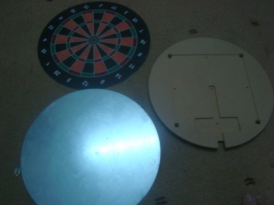

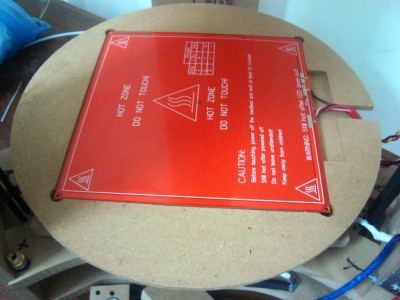

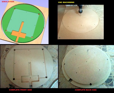

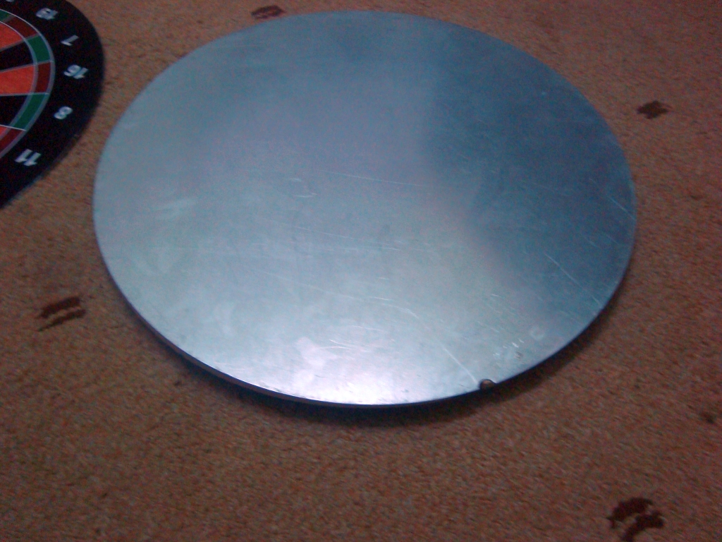

I needed a bigger bed to print large 3D models....so back to the drawing board (computer), spent an hour designing the bed that can capable of accommodating PCB heater and metallic plate 340mm diameter that i salvaged from DART GAME ... Fired my CNC machine, The bed was two sided machined out of 16mm MDF and took one hour to complete... I used 16mm and 6.5mm end mill cutters and 3mm drill bit .... The last picture shows how accurately the plate set on the MDF bed
I needed the 1mm CS galvanized plate on the bed because the inductive proximity probe shall be used to auto-level/auto calibrate the bed...
Will share some more picture of final assembly on the machine.
