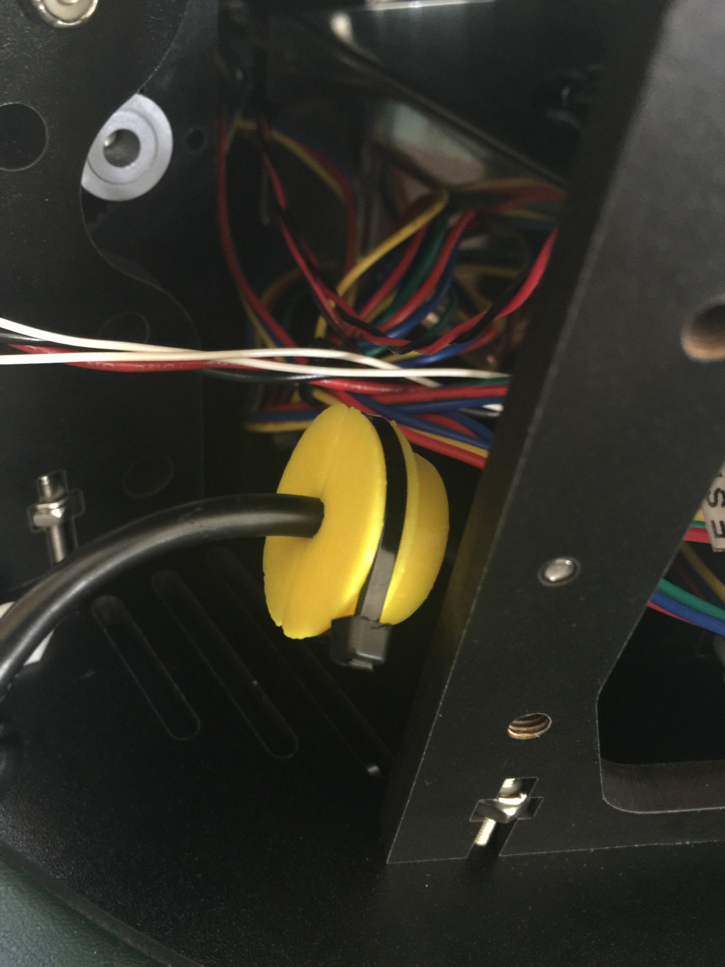

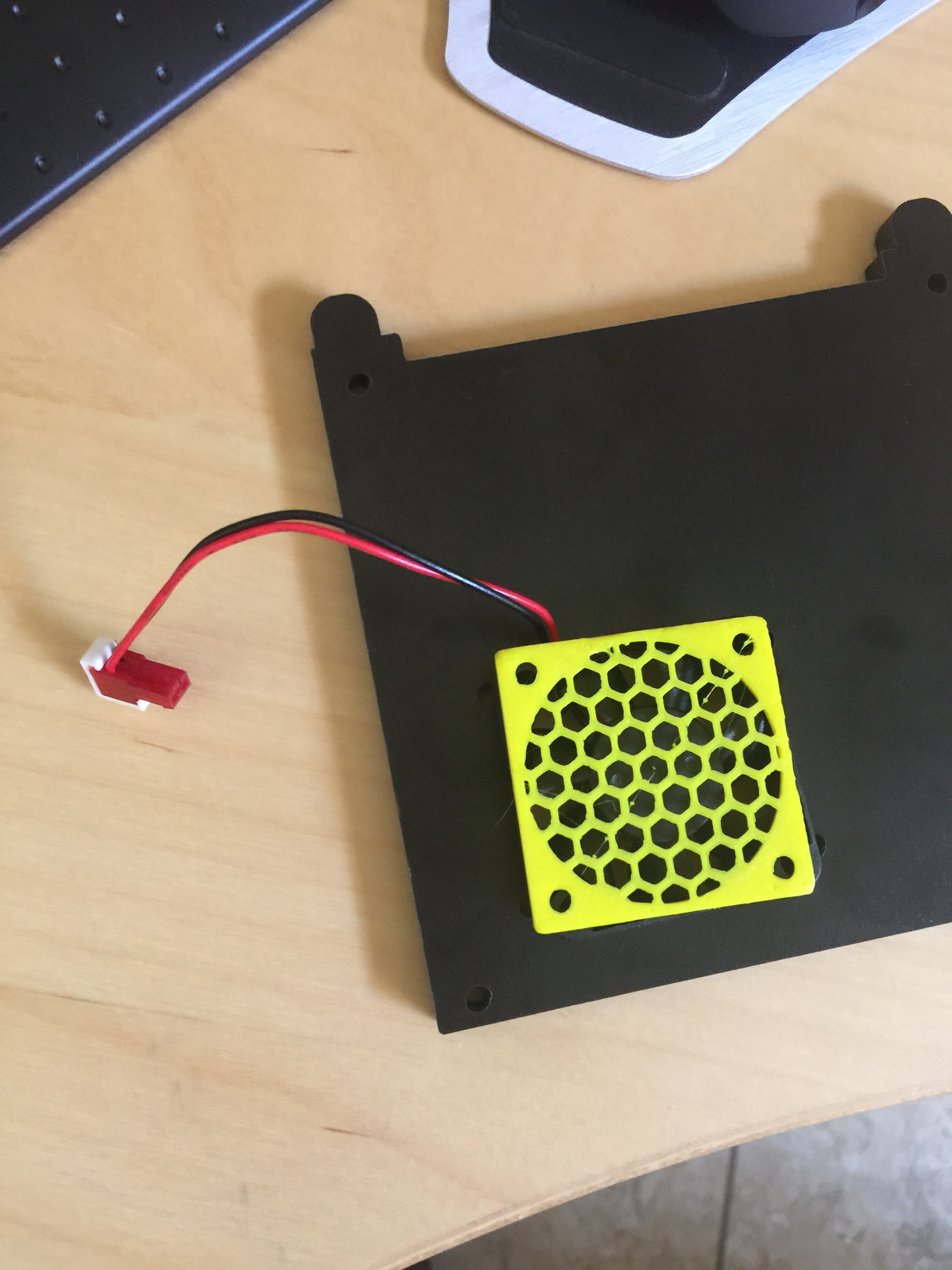

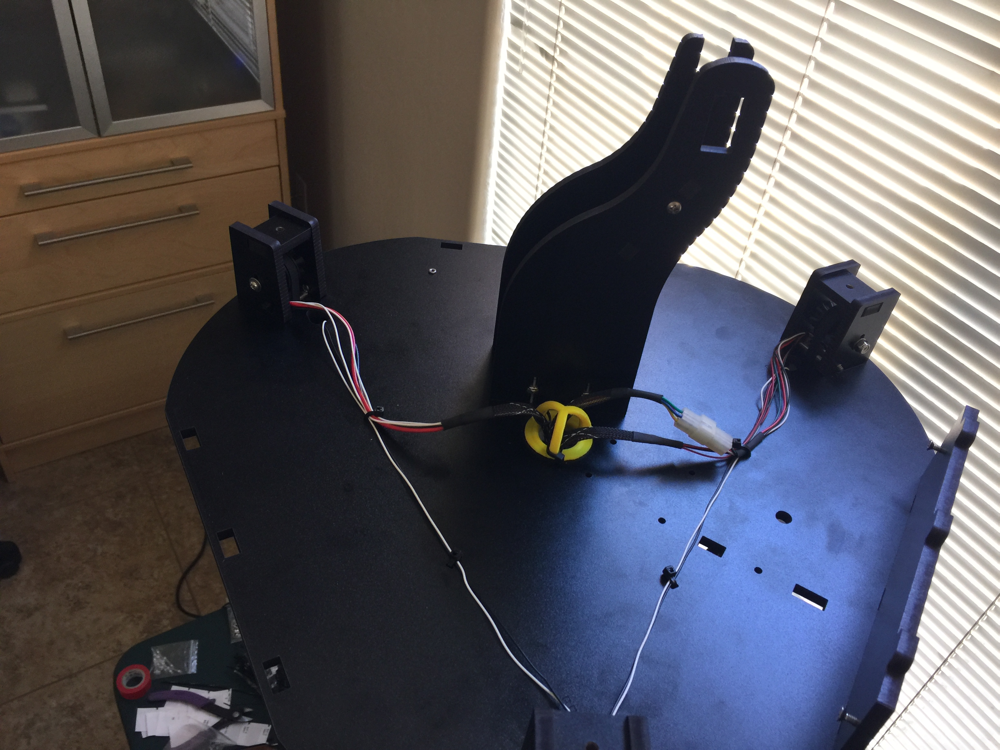

It took a while, but I was mostly delaying gratification. Paying attention to some advice I read, I kept it mostly stock. As such I don't need to post pictures of another Max, we know what they look like. I did add a couple of minor features
I added inner fan guards to both fans. I did not want a stray wire to be pinging my fan blades. I also added the little 2 pin connector and plug. I might want to change out the 40mm fan some day.
I added a little grommet / strain relief in the upper section
Just to make sure the wires didn't rub on the sharp edge and to give an additional tie wrap point.
I also added a strain relief for the USB cable
So I didn't do something stupid, pull on the cord and break Rambo.
Other things I have seen around like the belt tensioner, the USB connector, etc might be adds in the future.
