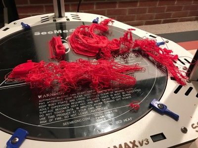

Printed in PLA. Would this be because my bottom layer did not stick? I used 210C for the nozzle, 60C for the bed, and sprayed aquanet hairspray before printing.

Get some Elmer's Disappearing Purple glue stick and try that.

Looking at the skirts he printed around the parts, it looks like the first layer stuck,,,, He may have gotten a jam from having to long of a retraction setting.geneb wrote:Get some Elmer's Disappearing Purple glue stick and try that.

I tend to agree. I've never really had issues with the prints sticking after the first layer. I will have to try out some Elmer's Disappearing Purple glue though, I've heard good things.Mac The Knife wrote:Looking at the skirts he printed around the parts, it looks like the first layer stuck,,,, He may have gotten a jam from having to long of a retraction setting.geneb wrote:Get some Elmer's Disappearing Purple glue stick and try that.
Is this a good guide for dialing in my retraction settings in matter control?
https://www.matterhackers.com/articles/ ... -to-oozing

I think I've seen Mhackney reccomend 1mm retract, at 35mm per second?

I know that I do 3mm @30 and it's always worked for me. I believe that MHackney's recommendation is a bit shorter and slower than that.

The HE280 has settings similar to the E3D - slow and short retracts.

Shorter yes! 1mm works well on both the E3D V6 and HE280 hot ends. You can see the results in the video I posted on Sunday in my V3 build thread. That was 1mm retract at 25mm/s. I have written extensively on why slow retract/advance for PLA here but to recap:Jimustanguitar wrote:I know that I do 3mm @30 and it's always worked for me. I believe that MHackney's recommendation is a bit shorter and slower than that.
You want the minimum retraction to clear the nozzle bore of molten filament but not so much that you leave a large cavity behind it that can and will fill with melted plastic and ooze. I've done the math elsewhere, calculate how much .4mm (or .5mm) filament is actually retracted when you retract 1.75mm filament 1 mm. It's a LOT more than you need.
Ideally, you want to retract relatively fast (and short) and advance slower. Only KISSlicer has this feature (and it was added at my request). The reason for this I've also experimented and written about extensively. Bottom line, molten PLA has non Newtonian properties - it "flow hardens" if moved too fast. I call this "hydraulic jamming". My recommendation for 20-25mm/s retract speed is a compromise because all other slicers retract and advance at the same speed. With KISS, I can retract at 40-50mm/s and advance at 20-25mm/s and get excellent results. The fast, short retract clears that nozzle bore but does not leave too large of a void that can fill. And the slower advance prevents the jamming phenomenon (non Newtonian behavior) and completely fills the (small) void that was left rather than plunge the filament out the bore.
In the PO's case, the filament starving could very well have resulted from too long/too fast advance but that is only one possible explanation, there are other contributors to filament starving but when I help diagnose issues like this I always start with retract as many people get it wrong and the slicers' default configurations are often absurd. The more frequent, short print moves made, the greater the likelihood that this issue will present. I discovered it when I first started printing parts with the "open mesh" pattern you can see in my fly reel avatar (the white part). There are dozens of very rapid, machine gun like retracts at certain places and I was consistently observing filament starving right after that. Sometimes it would clear up (but not before ruining the part). That's how I discovered the effect. 1mm retract at 20-25mm/s will eliminate problems even at these machine gun speeds. If you go higher in either parameter you can get away with it up to a point. But some day you'll print a part that has some tiny feature that requires a few quick retract cycles and BOOM, you'll have a problem and be left scratching your head!

Thanks for the detailed info. I did switched from 6.3mm retract (default setting in Matter Control) to 3mm retract and this seemed to clean things up quite a bit. I also realized that on the print that failed I was trying to print 4 different prints at once and it was printing all 4 prints a layer at a time instead of completing one print and moving to the next. I think I will try what you suggested next and slow down the speed a bit as well (I think I'm at 35-40 now). I am a novice to 3d printing as I just started this week, thanks for the help!mhackney wrote:Shorter yes! 1mm works well on both the E3D V6 and HE280 hot ends. You can see the results in the video I posted on Sunday in my V3 build thread. That was 1mm retract at 25mm/s. I have written extensively on why slow retract/advance for PLA here but to recap:Jimustanguitar wrote:I know that I do 3mm @30 and it's always worked for me. I believe that MHackney's recommendation is a bit shorter and slower than that.

3mm is still too high. Change to 1mm retract. I don't know why so many people think "more is better"! Think about retract as a poison. You want less so you don't die.h4lt wrote: Thanks for the detailed info. I did switched from 6.3mm retract (default setting in Matter Control) to 3mm retract and this seemed to clean things up quite a bit. I also realized that on the print that failed I was trying to print 4 different prints at once and it was printing all 4 prints a layer at a time instead of completing one print and moving to the next. I think I will try what you suggested next and slow down the speed a bit as well (I think I'm at 35-40 now). I am a novice to 3d printing as I just started this week, thanks for the help!
