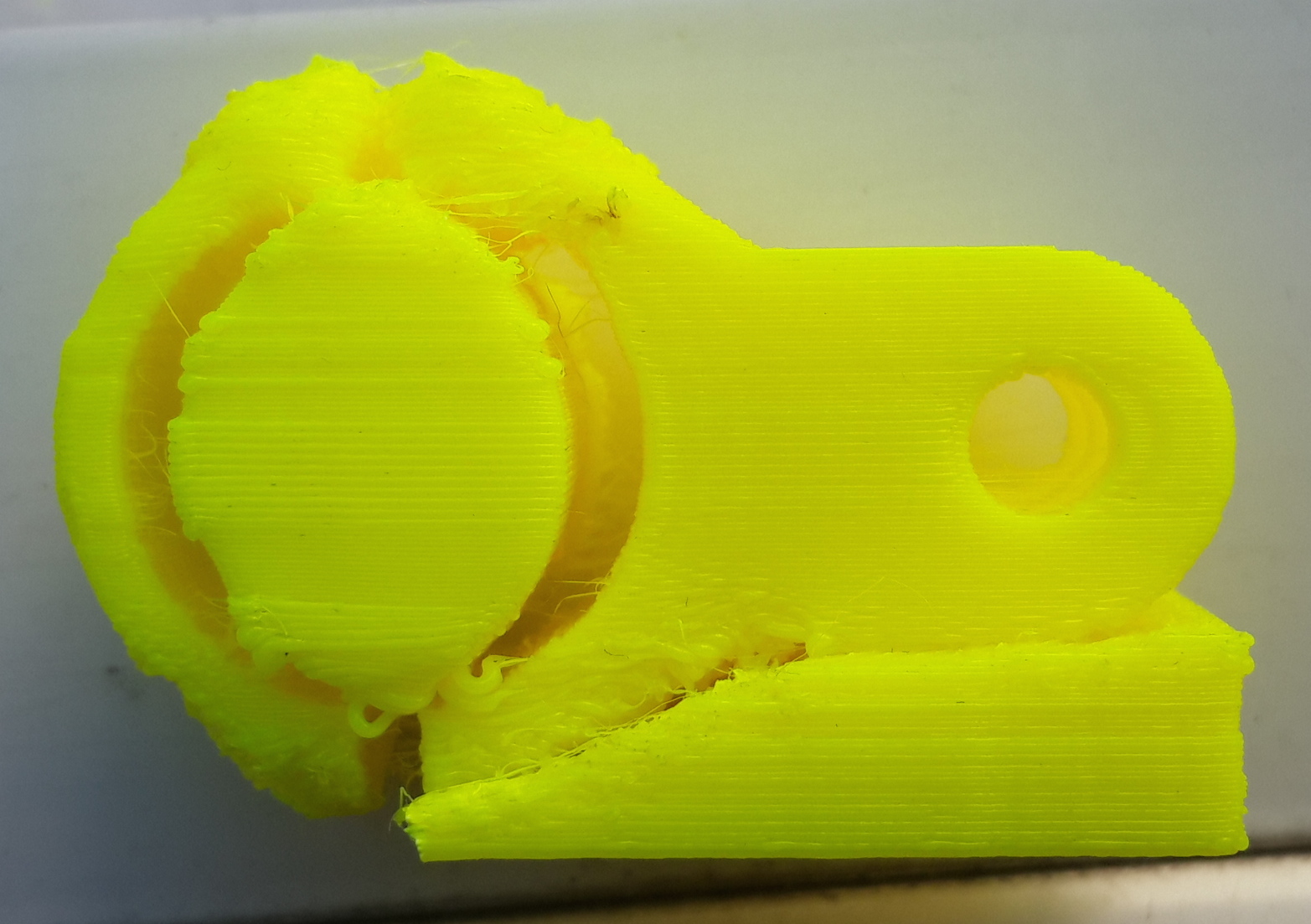

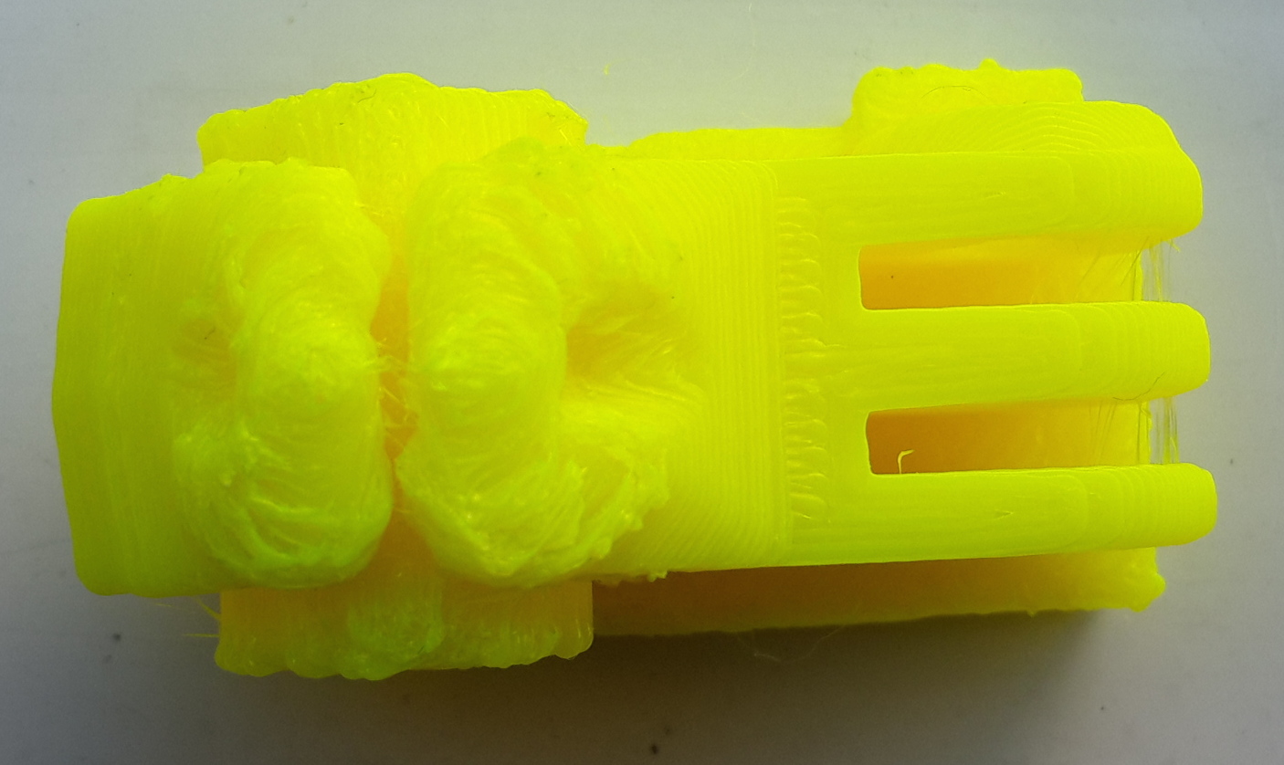

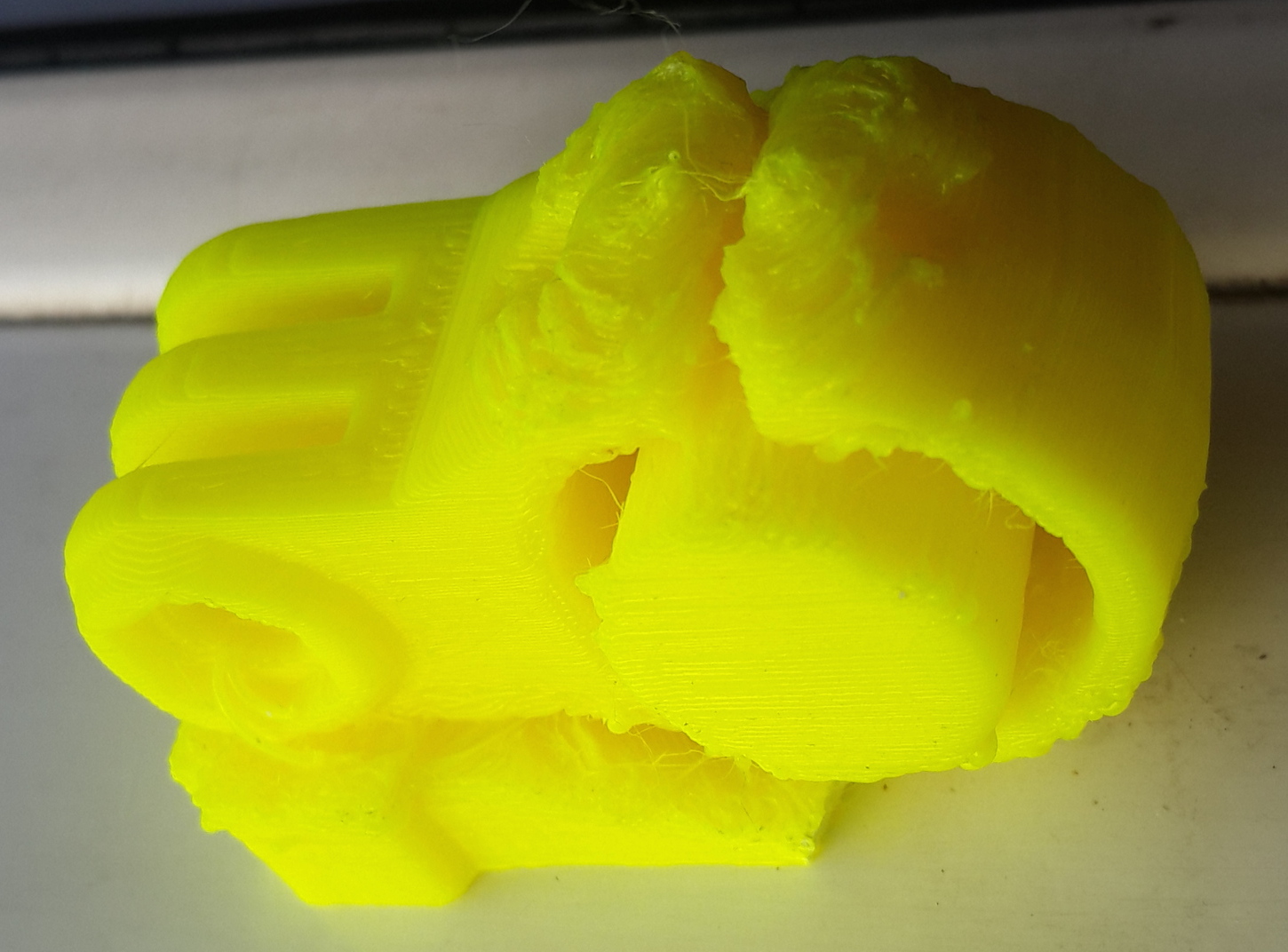

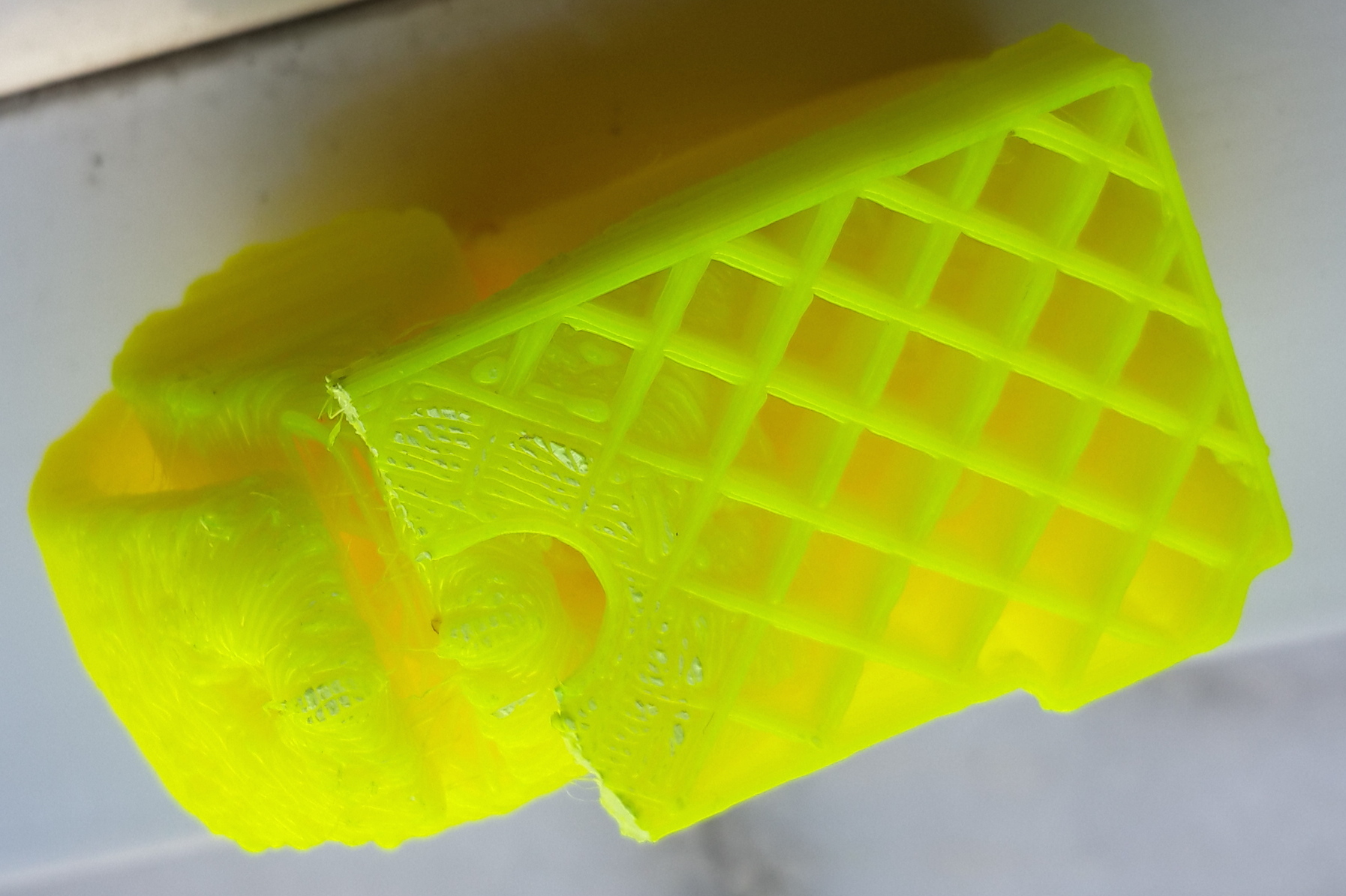

I was trying to make this:
http://www.thingiverse.com/thing:451116/#files" onclick="window.open(this.href);return false;
But somehow it did not turn out quite to be as nice as i wanted. Hot end temp is 232 degs. Heated bed is 90 degs.
Printed with raft. Filament is Octave. I removed a the raft and a bit of the support before i thought of taking pics and posting.
Side veiw
Side veiw
Bottom view
Bottom view

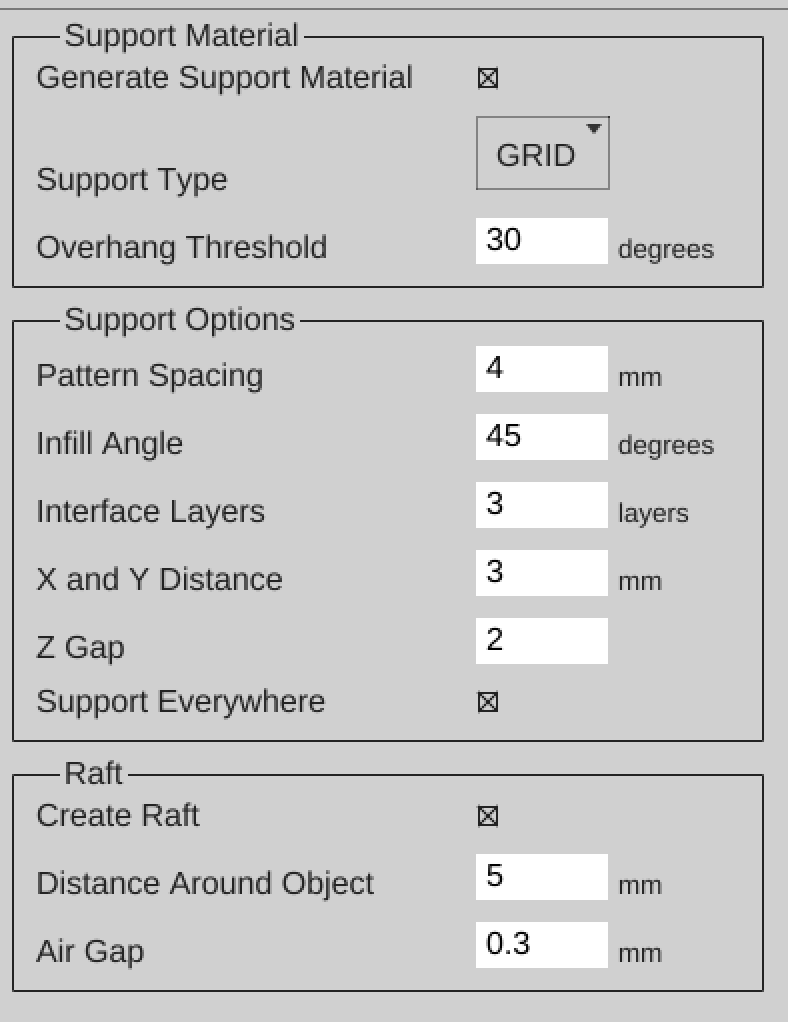

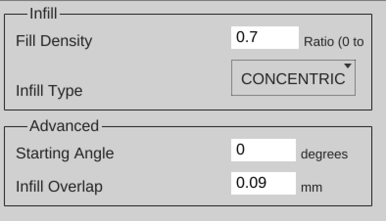

Settings
Settings
Settings
Settings

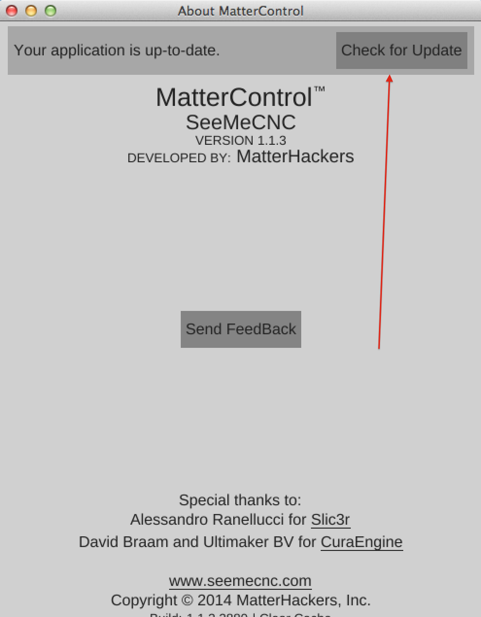

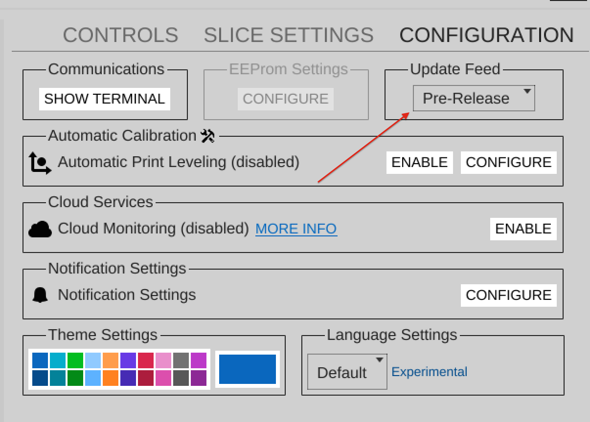

Matter control 1.1.3.
I updated to the latest version because it was mentioned that it had an extra configuration (interface layers) for support material.
And before you ask...
Getting the latest
Getting the latest
Updating it
Updating it

Which Speed you are printing?
Seems that when it Comes higher there is not enough cooling time for the ABS before the next Layer is printed.
In Matter Control there is a Option to set the min. Layer time. Try to set it higher and/or reduce Speed and Head-Temperature.
I often have this printing small Parts running Speed to high. Slow it down, take a coffee ;-)
