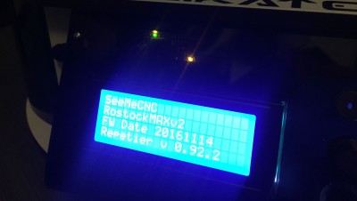

Hello everybody,
I wanted to give my Rostock V2 a nice upgrade and installed the new Cheapskate Carriage Set, the SeeMeCNC EZR Struder,
the HE280 Hotend, the Rostock MAX Ball-Cup Delta Arm Kit and the Hotend Whip.
I assembled everthing thoroughly according to the plan. But after I switched the printer on and installed the new firmware the printer does not react to any commands!!! The screen on the printer just shows firmwaredate and modelltype. The knob has no more function and if I try to home the towers through Mattercontrol nothing happens!!! The only thing running are the fans.
I don't know if that gives a hint but on the left upper corner of the ramboboard is an orange led blinking 2 times and then pausing.
right above a green one that is constanly shining.
Any suggestions what I can do??? I am so desperate...
Thank you

I'm guessing the whip wiring to RAMBo is not corr cut. We've seen similar lock up issues reported here recently and they all resolved to wiring. Specifically the red and black I2C wires and or the blue interrupt wire.

thank you for the quick response mhackney!!! that was a great hint!
I checked a little and it seems like you have a crystall ball.
there is a problem with the i2c wiring. I will replace that tomorrow.
by the way: which is the right machine to choose in the firmware? the v3 or v2?

I checked all the wires and found 2 failures!
...twisted the thermistor and the fan wiring with the TO!
I fixed everything and it seems to be good now.
But before I risk anything else...
Where do I have to switch the the Y stepper???
I didn't find anything in the instructions about that?!

Found it!!!
The white wire in my harness was open at one of the splice blocks that I'm using up top. (which are pretty cool, by the way)
I'm anal about never seeing copper on my wiring connections (fixed too many jobs where idiots have shorted things), so I tend to under strip wires ever so slightly, and that's how I shot myself in the foot this time with the spring connectors.
MHackney's right 3x. Check your wires!
The white wire of the harness is one of the ones that goes to the thermistor on the Rambo, and that one in particular is also what the accel board is using as an unswitched ground. Now everything makes sense. The thermistor was open which caused the odd temperature errors, and since the board wasn't receiving a ground signal, I presume that it was trying to ground through the i2c clock and data wires, which would explain the rapid flashing.
On to (hopefully) calibration!

The problem was that the wiring whip was shipped with the blue wire (PS_ON) wired incorrectly at the connector that connects to the rambo.
