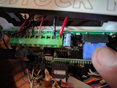

Hello there piece makers!
I been printing for about a year on my Rostock V2 - but I got a problem I cannot seem to fix.
The positive power wire from the rambo to the bed, melted in the green wire inserts. (See picture)
I peeled away the green bubble of plastic, but it is so melted I cannot get the screw out to remove the wire.
Is my board dead?
Any help would be great. I got a new roll of ABS and some DnD to play!
-Omnibus

I am sorry to hear about the melted connector. It is a known issue and it is why it is important to use bootlace ferrules on the ends of stranded wire that is inserted into screw down connectors:

This is very typical for neglected screwterminals. Like checking the bolts of your car rims a few kilometers after changing them, it is good to check on the screws of your screwterminals. It is not like they get loose by vibration, but by deforming of the wirestrands. This forum is full of pictures like yours (and much worse too!)

Omnibus, it is repairable. The Phoenix screw terminals in question are a standard part, and can be desoldered. If you decide not to desolder it (Plenty of tutorial threads doing the same thing for the same reason), I would replace it with a Duet (Ethernet, wifi, .8.5 is my order of preference, but I prefer wired to wireless) controller, which also fits in the same location (I have a mounting plate on Repables with 2 60mm fans for the back, it does fit, even with 20mm thick fans and a lot of extra wiring)

I think I am going to try to repair it.
I searched the forums for options.
I will head to Vetco tomorrow and see if they got some screw terminals that will fit and an SSR.
This will hopefully get me up and running soon.

You know I just removed the screw block terminal from the rambo - and dropped my soldering iron on the carpet. How did I put this thing together without burning down my house?
But, I think its going to work again. Board looks okay otherwise.

One thing to note thought is that the Duet boards use Molex KK type terminals, which while the same pitch as the existing ones, are not compatible with the Molex LP terminals, and use a different style of internal crimp terminals. The quick method is to cut the old ends off and reterminate them, but you can also make pigtail adapters if you'd prefer to be able to go back to a Rambo (I don't know why you would though). See https://duet3d.com/wiki/Connector_and_s ... rt_numbers for the connector part numbers.
