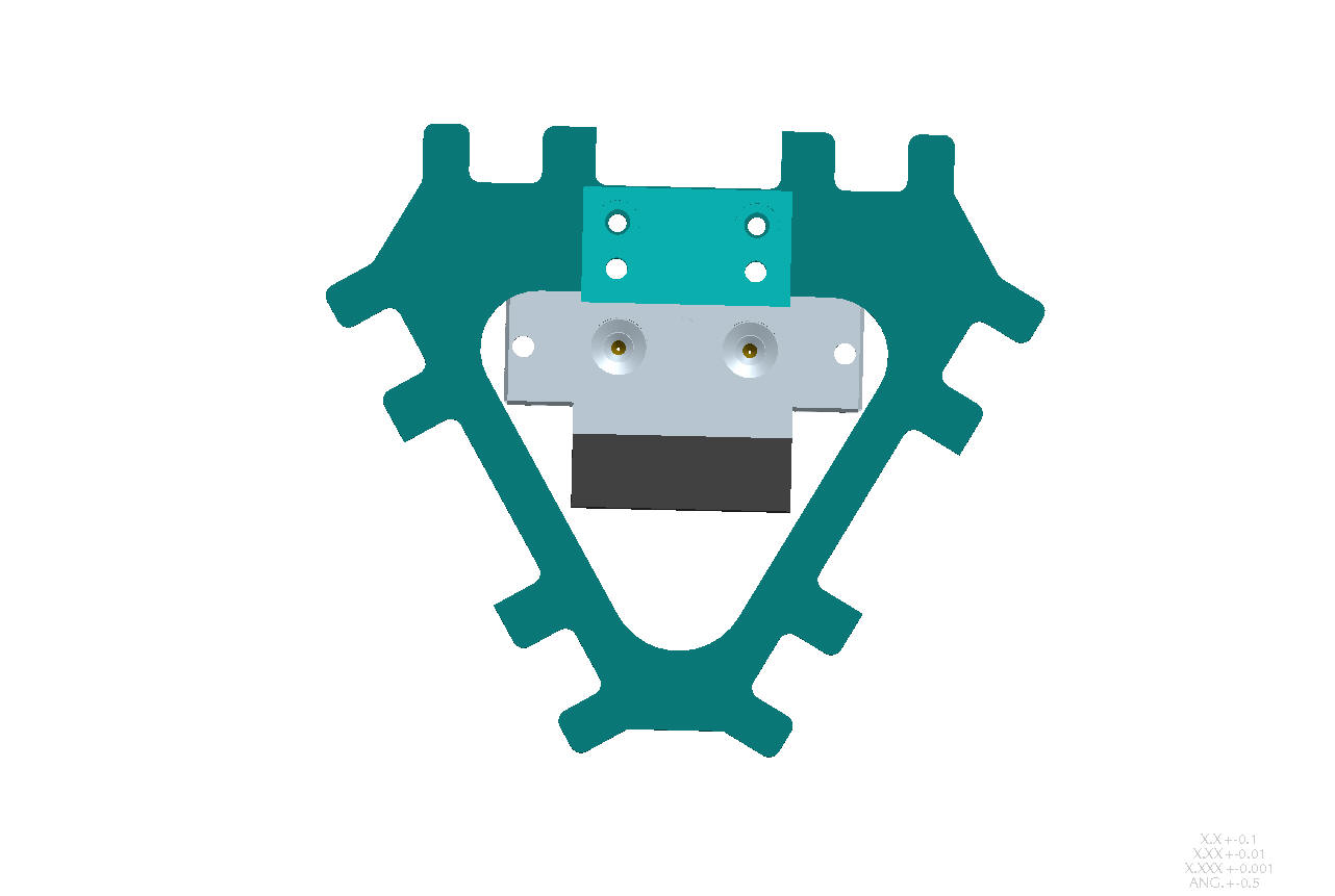

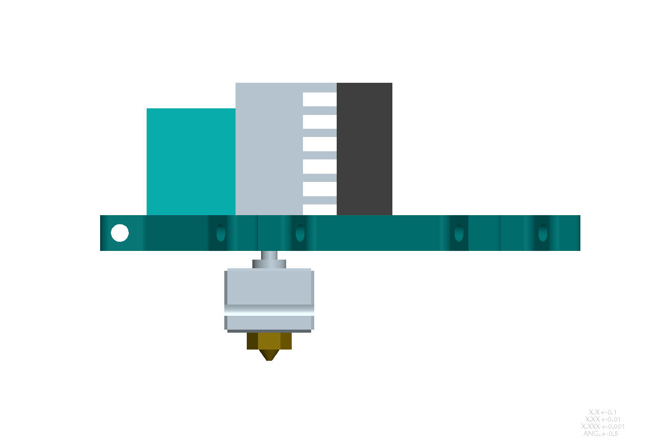

Designing a dual tool platform was reasonably straightforward if you can also print a new effector plate. (With all the important dimensions stolen from the SeeMeCNC STL files.)
This one is intended for the Trick Laser arm attachment, where I can screw the threaded rod through the blocks, then screw the ball end attachments on either side.
[img]http://gchristopher.net/3dprinting/cust ... st_try.jpg[/img]
The major difference to the effector platform is a larger inner radius. This pushes the support columns out a bit. Since this is printed especially for these hot ends, it wasn't too much extra work to integrate an airflow shroud into the design of the effector platform and tool attachment piece. The effector platform has a solid plate keeping the fans from blowing directly onto the hot ends.
The little extra printed material on the support columns is intended to help with getting the hot ends exactly level. I figure I'll file down a tiny bit off the left or right to get them as flat as I can measure. Sort of a one-time-adjustable setup?
I wish I knew if this was an intrinsically stupid idea before I print, assemble and test it all! Does anyone know if I'm missing something basic here?

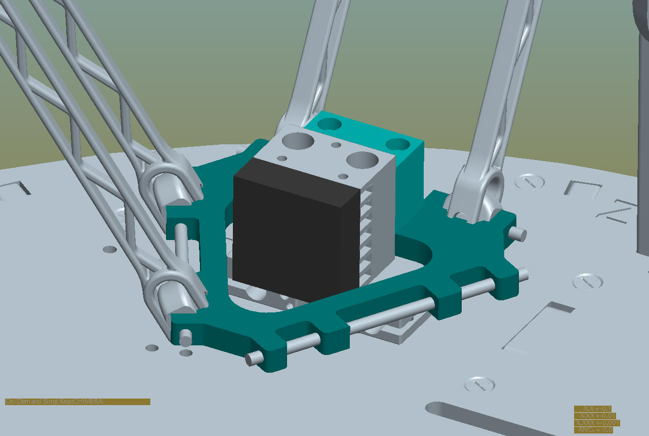

Re: Yet Another Dual Extruder Design Attempt

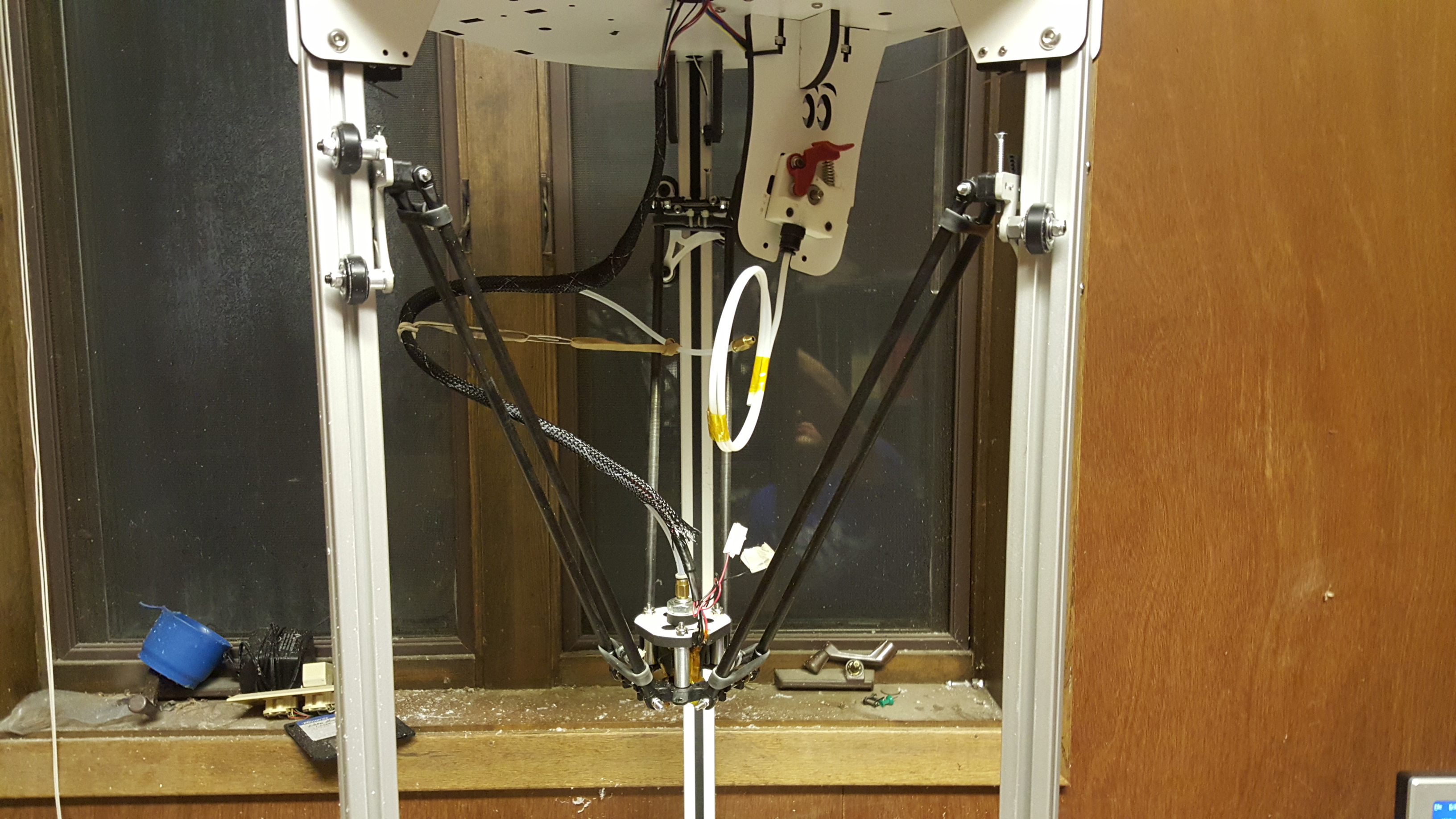

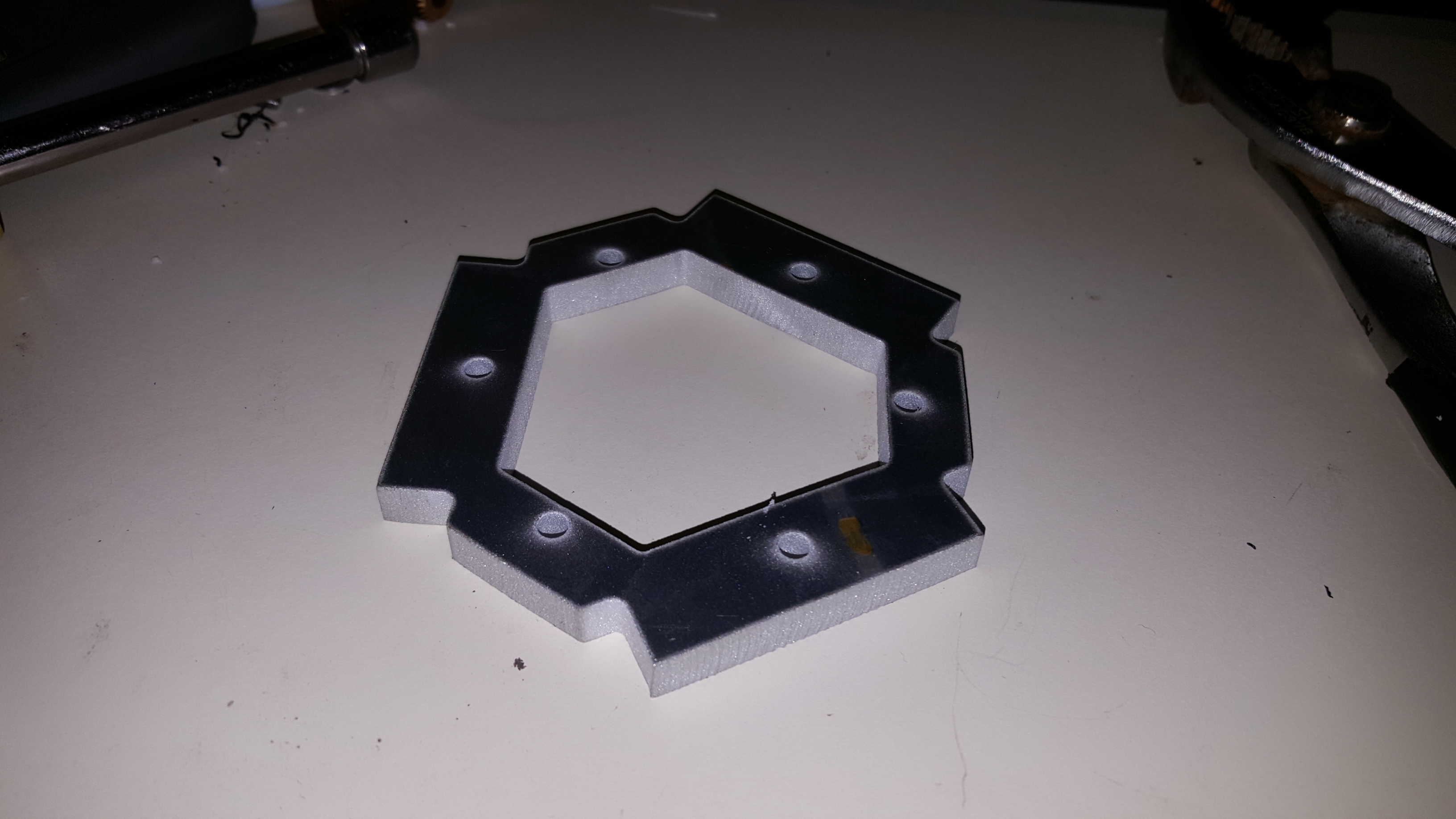

Everyone has found that there's just no way to cram two heater blocks through the opening in the stock effector platform. So one early goal of this design approach is to create an effector platform with enough interior space.
Aluminum would be the material of choice, but I don't have access to the machinery, so let's try to make a printable effector platform for the V2!
A few revisions down the line from the initial design above, here's the first version. It's printed with a E3D volcano, .8mm nozzle, and .6mm layers. (Btw, loving the volcano, my prints are faster than my bed heat time nowadays, need a 24V PSU, I guess!) The results are a little coarse-looking, but should be fine mechanically. The only part that needed any filing was the 6-32 screw holes to attach the tool holder, and that was intentional to keep close to 0 play.
Top View:
[img]http://gchristopher.net/3dprinting/new_ ... v1_top.jpg[/img]
Bottom View:
[img]http://gchristopher.net/3dprinting/new_ ... bottom.jpg[/img]
I ended up going with washers on 4-40 screws and captive nuts to hold the 3mm threaded rods in place. That was inspired by the Cheapskate design, and though it's a little more complicated, I like how there's no reaming of any holes involved, so there's no potential for the manual cleanup to impact mechanical precision. (In theory, the center of the threaded rod should be 33mm from the center of the platform, right? That's what I gathered from inspecting the STL file for the stock effector plaform.)
3mm rods are pictured, because I'm taking this opportunity to upgrade to TrickLaser carbon fiber rod arms.
Next up will be doing the arm upgrade, installing the E3D volcano on the matching tool platform. The upright screws to connect the tool platform have also been moved outward, to 32mm from center.

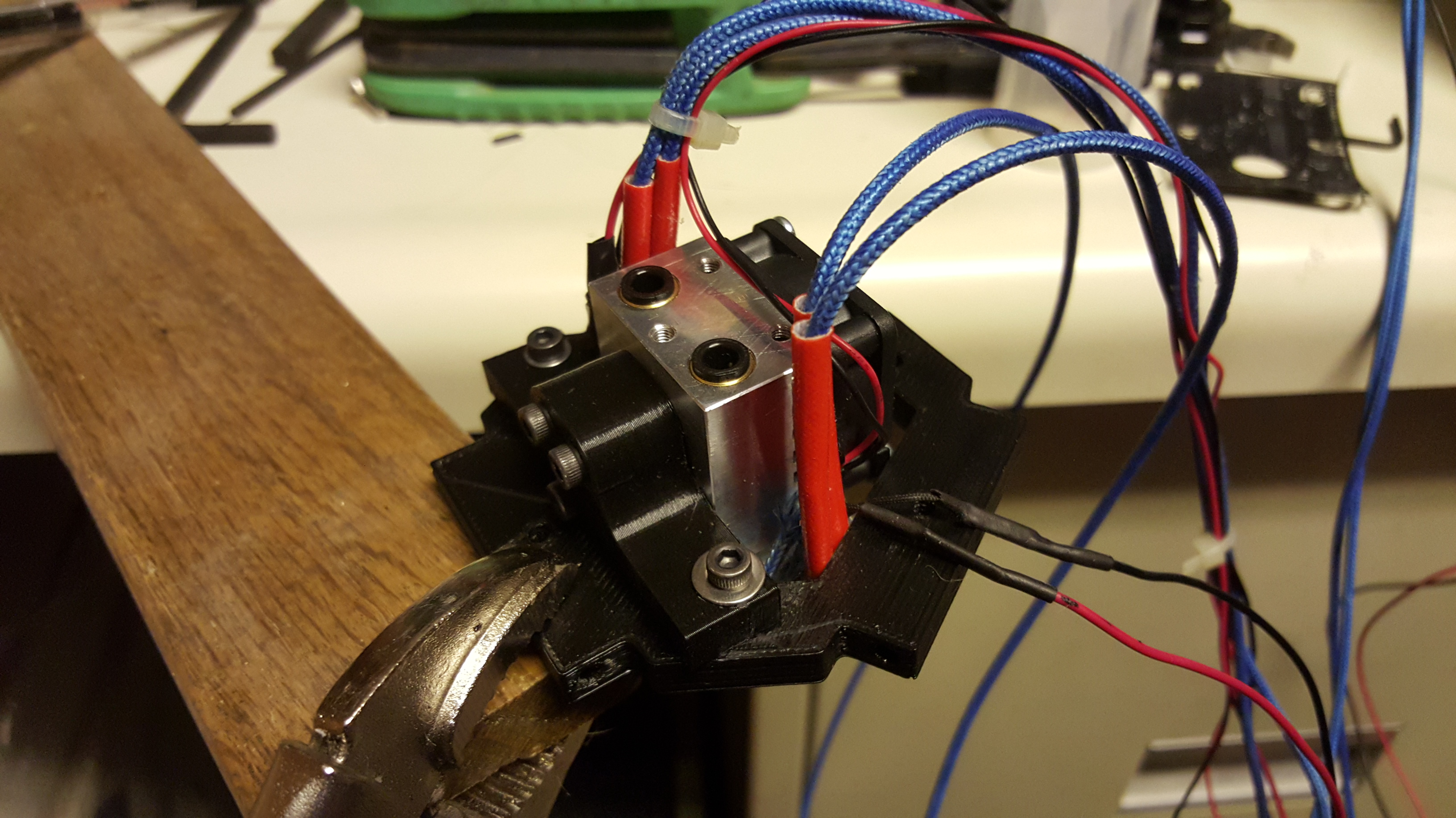

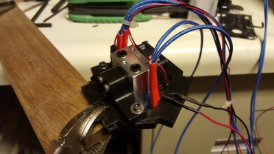

- Posts: 175
You were totally right! The ends are too close and the fan cooling blocks will collide. (The water cooling blocks would fit, but that'll be a ways in the future.) I'm reprinting the holder blocks to go back to the 45 degree mount angle and move them a little farther apart.ZakRabbit wrote:That's what this is all about, finding something different! Looks great. It appears the motors will be end to end: if you're worried about heat, why not design a fan shroud that will actively cool both motors? We can all guess and give you our opinions, but you'll never actually know until you try it. Give it a shot and let us know how it worked out.
That should be great! Also, using the chimera is a more sensible option that I'd do if I was spending money on new hotends today.CaptainMerica wrote:I have been working on a new platform for mine to hold a chimera hot end, i plan to eventually have it machined out of aluminum. I'm going to be using this with trick lasers 325mm cf arms but in a double hung setup where they attach. So far i have it so that the mounting block on the platform can be removed and leaves the platform with 2 dowels and 2 tapped holes to secure whatever future end effectors i may wish to put on it.
Um, the E3D V6 specifies a 25W power draw, so that's a relatively small portion of the overall power budget. I think the bed should draw around 10A at 12V. (120W) The RAMBo maxes out at 15A, (180W). For those numbers the stock power supply should still be fine with an extra hot end, though I'm a little fuzzier on how you estimate the motor power draw. If I had to guess, (and I'm a relatively newbie too; I take my design orders from stuffed dinosaurs) I bet the most likely result would be the bed being even more anemic.CaptainMerica wrote: Noob question, but i suppose i will need a bigger power supply to run both hot ends? I want to do the 24v upgrade regardless, but just wondering how critical it is for hot ends.
I had very similar thoughts, though I can't point to either math or empirical testing or forum posts to back them up. From reading forum posts on other dual extruder attempts, the relative height of the head seemed to be a much more common problem moving the head around than positional accuracy. That seems like it would be less affected by hanging the heads below the platform. I suspect actual testing will be a lot more illuminating than analysis there.CaptainMerica wrote: Also, any opinions on nozzle distance below the platform? I realize the potential crashes if its too low and the part curls, but what I am wondering, is as far as accuracy, would having the nozzle as close to coplanar as the axi of the platform arm links increase the stability? I picture as the nozzle is offset further and further downwards, it creates a lever that amplifies any slop in the platform, as well as inertia that would possibly make it jump around as well. Or is my anxiety for machine design failures a little high for this?
Ultimately, I just wanted to take up the challenge of fitting dual extruders while preserving the aesthetic of having the heads near the plane of the arm junctions as possible. That irrational urge played more of a role than engineering analysis, because most decisions around here are made by a hyperactive Tyrannosaurus Rex.

Okay, here's a little bit back on the original topic!
The dual extruder holders are printed and installed. The big effort here was a substantial teardown to add t-slot trim and run all the extra wires to support dual extrusion. So far, so good! Here's the current revision of the holder, design view, and printed and installed:
[img]http://gchristopher.net/3dprinting/dual ... design.jpg[/img]
[img]http://gchristopher.net/3dprinting/dual ... t_look.jpg[/img]
I'm not sure I'll stick with them in this location in the long term, but I think those extruder holders definitely achieve the goals set out for them! After a couple more tweaks and some code cleanup, I'll be publishing those.
I need to either find a darker background or stop printing in black all the time. Also, they form a very solid frame; those suckers are some beefy rigid extruder holders!
Regression testing (making sure I didn't break anything) has started, and one test print turned out fine.
Next up will be installing the second hot end and working on firmware changes.
Here's the current design idea for the dual tool holder:
The immediate problem is fan placement. In the pictured position, they'll get in the way of the lash straps on the arms. It'll either have to change to a single fan, or else offset the hot ends some to make space, or both.
The pictured effector platform was been printed and seems to be working great after several prints. It differs from the test print above by adding some support material around the M3 threaded rods to keep them from being bent by the lock nuts when they're tightened down.
So, as far as printer modifications go, things are going pretty well. The wiring is in place and at least didn't break anything. The new extruder holders and effector platform look good to go.
