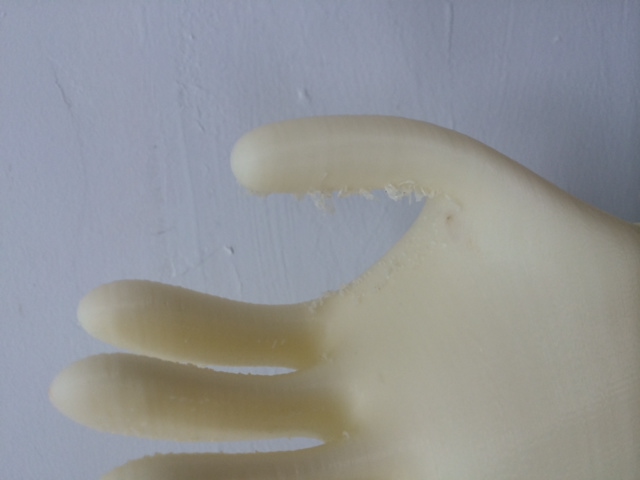

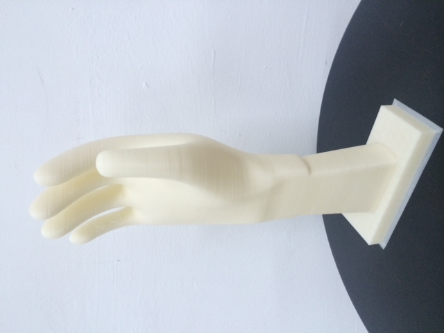

Managed to complete the 19hr print from the SD card. Print height 300mm. First time to print from SD card.
a. blobs (hope I get the name correct) between the fingers. I did not change any default settings so there is something to learn to reduce this. Advice will be much appreciated though. b. Delaminations found between layers (3 layers out of the 1200). About 1". They occur at the earlier layers. Comments appreciated.

Regarding your blobbing issue, most would contend that this is a retraction setting issue. I run a retraction speed of 100mm/s (pretty high for most people's tastes, but it works for me) with a distance of 5.4 mm for both prime and retract and I slice my files with Craftware, rather than the predominately used Mattercontrol, Slic3r, Kisslicer, etc.
Since you didn't mention what type of filament you are printing in, I am going to assume that your delamination issues are due to ABS shrinkage. One method to help combat this is to encapsulate the build area of your printer. Some choose to print brackets to hold plexiglass and other hard materials in place to insulate their build area, while other folks like myself and member Mike B prefer to go a simpler and cheaper route by velcroing a clear shower curtain, cut to size, around the printer (example found here).
