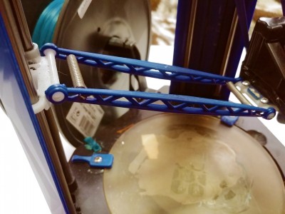

After I installed springs on the arms to take up the lash, and re adjusted settings in the firmware for the calibration rates, it has been printing pretty satisfactorily for me.

Hey, can you share a photo of the springs? Sounds like a nice mod to consider.

I'll post up a picture of them tonight. And I'll try and find my firmware file for it as well. Once I took out the slop with the springs, I had to make some changes, I think to the sensor sensitivity?, so that the auto calibration worked.

Here's the picture for the springs,,,, see my other thread for the McMaster-Carr part number,,,, and I had to snip the ends to change them from a loop, to a hook.
Also attached is the eeprom file,,,,, I think that's where I made the changes for the auto calibration? change .txt, to .epr when you download it.
