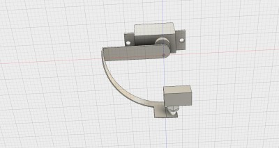

One really simple idea I could suggest is to move the extruder as far off the build area as possible while heating, and then doing an extrude and retract before printing to get that drool string to fall off and land away from the printed part.
Another idea I had was a cover for the nozzle that closes while heating and keeps the drool inside, then wipes it when opening.
Posts: 1561
Post by Xenocrates »
Both of those things would require the slicer to support it, which means at very least adding a chunk of code to the preamble. It could be done though. They are also pretty cool. I think that the Max might have trouble with a wipe area, due to the kinematics of the system already having issues at the edge of the build area. Admittedly, the longer arms they moved to improved this, and it is possible that a wiper could be added (Although unlike a gantry system, you can't have one built into the end of the gantry that moves with you for free). It would either be initial wipe only, or require an additional axis motor (To lift it), as the parts while not certain to obscure the area the arms would need to travel through, are likely to. Which would require more slicer support, as it would need to be iterated upwards after each layer, or firmware support (Where the Z-height of the hotend is matched by the wipe platform by the firmware. However, even if it were initial wipe only, that would be an improvement over nothing.
The cover idea is simultaneously more interesting, and more technically difficult. The failure modes would be potentially very frightening as well, depending on the cover material (If it's some form of plastic, it may melt, and metals add large amounts of mass to the hotend.). Not to mention that there would need to be some form of motor to move it, and even a small stepper or cam operated system would add an annoying amount of mass (Of course, you could drive it with a bowden cable, and have the motor be elsewhere). But then, you need to design it such that the cover is open at rest, otherwise if there is a system failure, you will ruin the part, fill the cover with crud, or break your glass. It would also need to be designed/adjusted for every nozzle, which I'm not a fan of.
There is obviously room for improvement in the space, especially on delta designs.

I had something simple in mind with a servo motor and a metal wiper/cover thing.
Excuse the crudeness of my model. I didn't have time to build it to scale or paint it.
