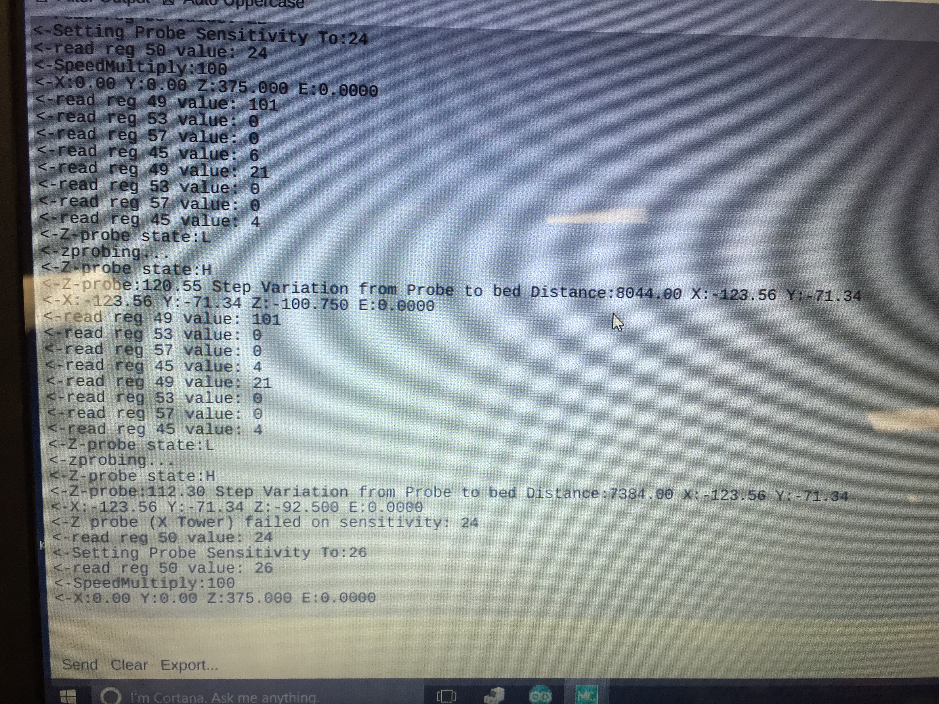

I a man having a similar issue. During the initial calibration hot end floats down as it should and then veers towards a tower and proceeds to run like a jackhammer. I took this pic of the messages it gives. I am completely new to this so forgive me if I have not described the situation well.

Re: Problem calibrating printer
Thank you thechewiestbacca for the suggestion. I tried it but no luck. It did the same as before but it did it floating in mid air about halfway down.
